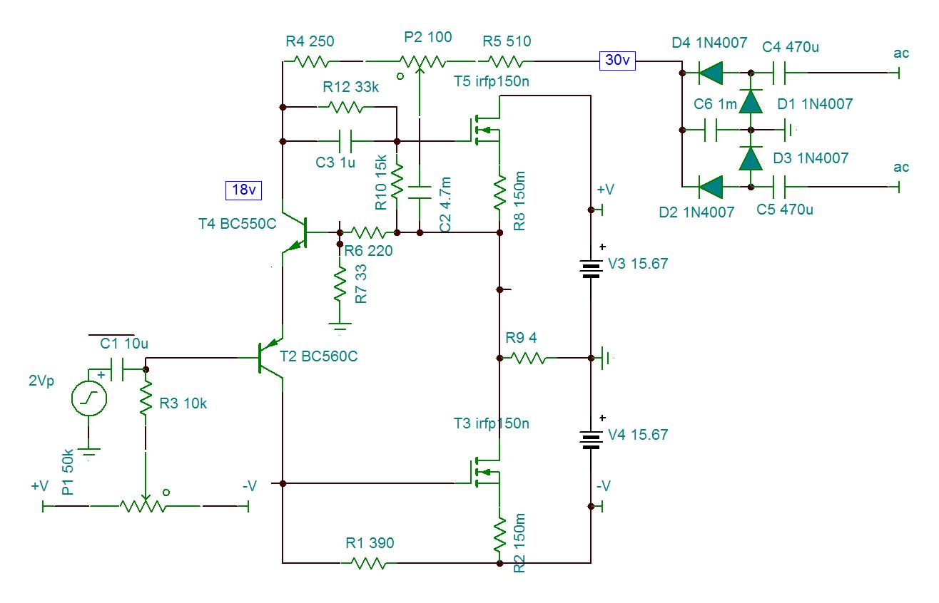

To answer that question correctly, I will say that the DC offset depends strongly on the scheme we finally use.
For example, the schematic of post 1 (the most basic of all) suffers from an important DC offset variation with the variation of the supply voltage.
For a nominal Vcc value of 15.67 V -> DC offset = + 149.361 uV (theoretical)
For a value of Vcc + 10% = 17.237 V -> DC offset = - 341.802 mV (theoretical)
For a value of Vcc - 10% = 14.103 V -> DC offset = + 334.415 mV (theoretical)
For example, the schematic of the post 13 (which has been compensated against the variation of the ambient temperature) does not suffer from significant DC offset variation with the variation of the supply voltage.
For a nominal Vcc value of 15.67 V -> DC offset = + 202.139 nV (theoretical)
For a value of Vcc + 10% = 17.237 V -> DC offset = - 33.928 mV (theoretical)
For a value of Vcc - 10% = 14.103 V -> DC offset = + 32,121 mV (theoretical)
All variations in the supply voltage suppose a variation of the current without signal (bias), unless the corresponding readjustments are executed to keep it within the design limits.
The DC offset values are the product of varying the rail voltages in a symmetrical way.
Best regards

I built he dlh super buffer using this schema:
counter reaction network has been replaced by connecting the base of the BC550 to the output.
PP/SS and bias pots are 1Kohm
To have 1/2 Vcc at output (15v) had to set the ofset pot (at the base of BC560) to 850Kohm
now the input has high impedance, and simply attaching a big coupling capacitor influences the bias (it goes down)
what should I do? put an extra resistor from base of BC560 to Vcc?
both bc550 bc560 have hfe of 550

The value of the input signal coupling capacitor is correct (it would give very roughly a lower cutoff frequency of 0.125 Hz, or something around).
There are delays in the stabilization of final parameters, without applied signal, which will depend on the time constants involved in the circuit. Basically, in your circuit there will be two relatively important time constants: the conformed by the input network (approximately around 6.37 seconds, neglecting certain terms in its calculation) and another constant of around 23.5 seconds (again, approaching rudely).
To set idle parameters, remember to disconnect signal source and short-circuit the AC signal input to the DLHSB. Wait for the times mentioned between each readjustment, until reaching the final parameters.

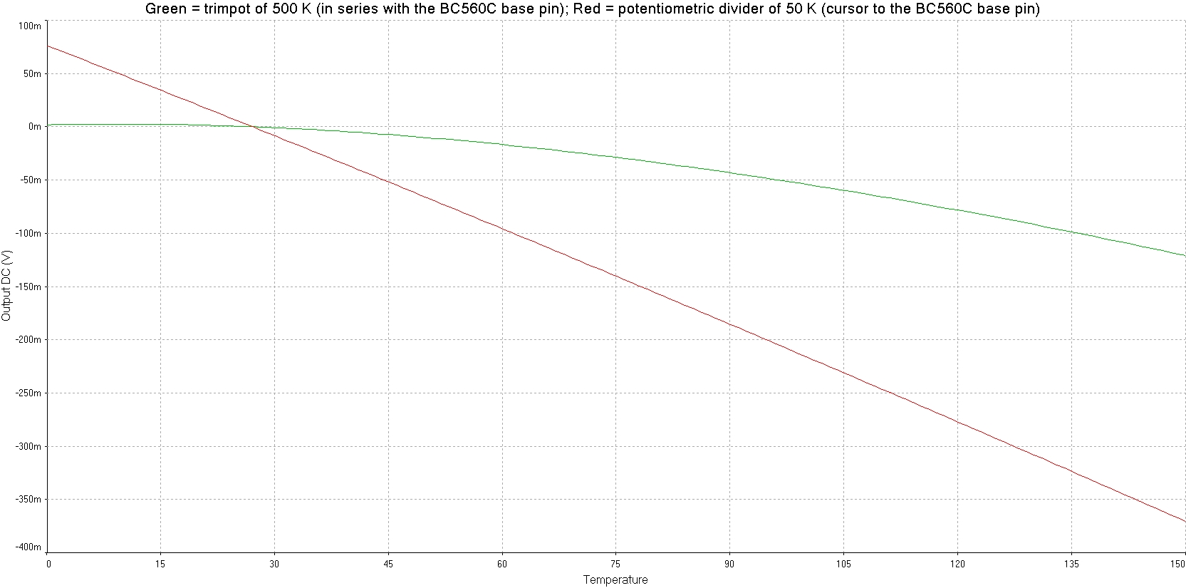

It would not be strange that you have to finally modify the nominal value of the trimpot for DC offset, in the very basic configuration for the polarization of the base of the BC560C, since it is a configuration that depends a lot on the parameters of that same transistor.
The design was based on a transistor model with hFE of 330 (the one that was available in my library when designing it). You claim to have hFE of 550. It is for this reason that the relationship between the values of trimpots tends to be similar to the relationship between hFEs.
Although very basic, this configuration behaves better against offset shifts due to temperature, than a potentiometric divider of lesser value that polarizes the base of the BC560C.
If the DC shifts with the temperature are excessive with this basic configuration, you can implement the compensation with two transistors that has been tested by XRK971.
