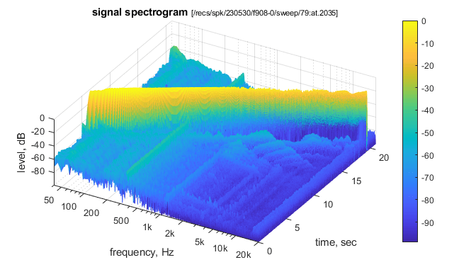

FYI: the left channel's measurements show a burst in odd-order distortions at 900Hz, going all the way up to 10 kHz, with 3rd harmonic at approx -40dB:
For these relatively high distortions, my subjective assessment of audio quality and the sine sweep measurements agree.
BTW, the right channel is smooth.
AFAIK, there are 2 drop-in replacements for 4K211: HM100C0 and HM100Z0. Both have been reviewed on diyaudio:
https://www.diyaudio.com/community/threads/audax-hm100z0.6367/post-4528750
https://www.diyaudio.com/community/threads/audax-hm130c0-opinions.153064/post-1944482
Alas, Z0 can not be crossed at 250Hz.
The measurements are nice in both cases (nothing like what is above) but the subjective opinions of people who used them are firmly on the negative side:
"I have used the HM100CO's, which I had crossed over to the tweeters at around 3200 Hz. They had a noticeable sibilance with certain female vocalists. The detail was incredible, but I couldn't get past the sibilance which I attribute to cone breakup."
"This is my experience of the Aerogels as well. They do sound good and have a very appealing type of sound to them. It's only when you get quite critical of the sound that you realise you can do better."
Enough for this particular case.
