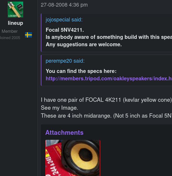

Speakers are Focal Spectral 908.1, ca 1994. Someone on this forum had exactly these midranges for sale - but in 2008. Unfortunately, Focal does not make anything suitable as a replacement anymore, I asked a local dealer already. I tried to measure some candidates in his shop (car stereo) ... no success. So... let's look at the other vendors, right? There are so many measurements published, right? But then you read the comments about how badly people disliked the drivers that measured so well. I got some drivers from solen.ca Again, no luck. There are acclaimed Purify drivers, but they are of much lower sensitivity. Little by little, I became very interested in the topic of measurements vs reality, and here we are🙂

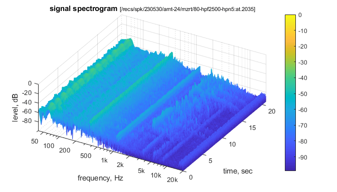

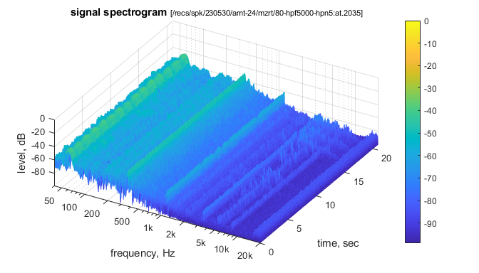

Regarding tweeters: let's consider ATM tweeter from ADAM. That's how it measures on a tone, producing 80dBSPL:
You can expect lots of distortions if you cross it at about 2500 Hz, right? on Mozart piano concerto it looks like that
... quite a lot. But if you cross it at 5000Hz, the residual becomes practically inaudible:
You can not expect such a difference from sine sweep test, can you?

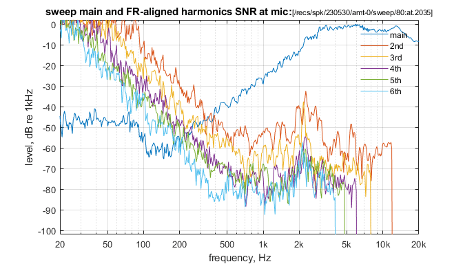

Shure you can.
The tweeter shows some 5% (about -27dB) of distortion products at about 2150Hz. Above 3kHz, the tweeter displays distortions at about -45dB ... -50% which is well below 1% and rather at a fair 0.5% and even a bit below that. This is what the sinesweeps shows.

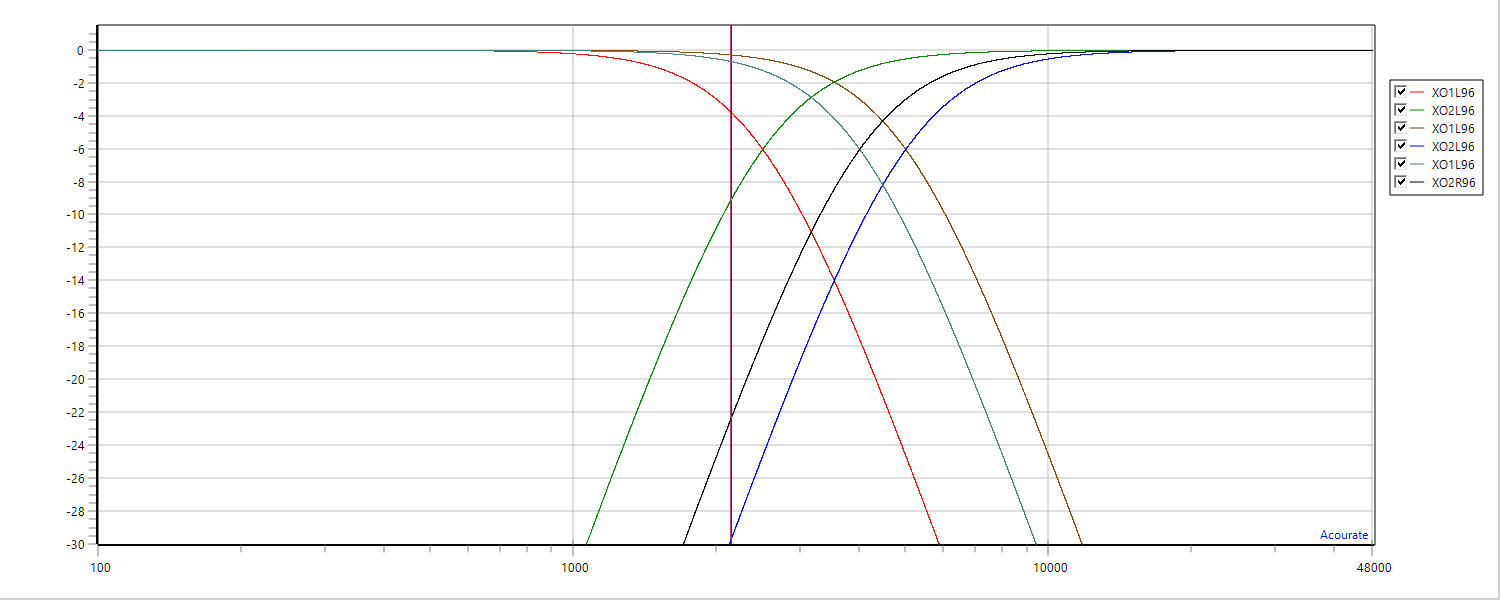

As you neither specify the filter type, nor show the logsweep of the mid, let's assume a standard 4th order Linkwitz-Riley filter and a idealized midrange with 0% of distortion.
Filtering at 2500Hz (red/green) is a misconception for this tweeter. The filter provides a delta of 5.5dB between the mid and the tweeter at 2150Hz, and so you get a distortion of -27dB + -5.5dB = -32.5dB for this frequency. Really not brillant at about around 2.5% of distortion. And you waste your tweeter's potential of 0.5% distortion by doing so.
Filtering at 5kHz (brown/blue) instead provides a delta of -29dB between the mid and the tweeter at 2150Hz. So you geet -27dB + -29dB = -56dB of distortion for this frequency, which is about 0.15% or so distortion. So this is overkill.
Target distortion for this tweeter might be at 0.3% to be sure not to waist anything. So you might rather aim at -50dB @ 2150Hz. This would be provided by an xover at about 4kHz (grey/black), which attenuates some -22dB at 2150Hz. -22dB + -27dB = -49dB. This would be the best compromize in terms of distortion v.s frequency optimizing. This compromize will result in a 0.3% ... 0.5% distortion figure for frequenies above 2150Hz.
See? No needs for fancy graphics for this kind of work. They might be useful for different goals. And sinesweeps, well applied, still are very useful.

My typical test bench's UI is 2 HD screens full of constantly changing pixel-wide graphics. I do not know how to make a user-friendly application. Making such apps is an art that is completely out of the area of my competence. I publish my algorithms as GPL. Please, anyone who is capable of it, feel free to port them and make them user-friendly!
Thank you for the reply, and for publishing your algorithms as GPL too. I appreciate the hurdles of user-friendly software design, there is a reason good programmers and graphics designers cost what they do.
The graphics that you have posted here do provide some encouragement that it could be possible to have useful data presented in a fairly simple way.
