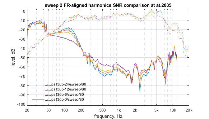

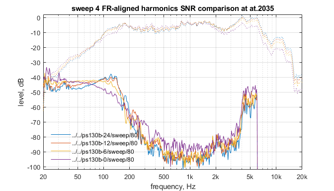

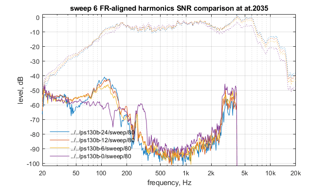

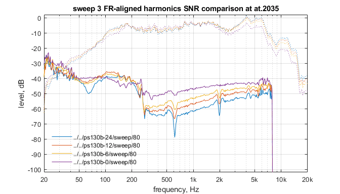

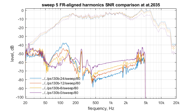

The comparison of voltage vs current drive is done by adding 6/12/24 Ohms, and adjusting the volume to match the loudness of 80dB SPL at 1m. The drivers are Focal ps130 and Sounderlink AMT-920.
For reference - ps130 on sine sweep:
as you can see, it's ... somewhat complicated.

Another, I cannot understand what the data in the images are? The legend of images differ only with sweep number, whats the difference with the sweeps?
Little critique though, the video is compliled so that it is easy to compare drivers, but not easy to compare how the resistor changes sound on any single driver because the samples are scattered all over the video. It's obvious that drivers differ from each other so not very interesting, I think it would have been more interesting to compare sound of same driver with added series resistance which would have been lot easier if sequence of clips was one driver 0/6/12/24.another driver 0/6/12/24... I don't want to burden you, I try if I can chop it up and rearrange.
The images are spectrograms of the tracks played. Yes, it would be better to organize the video as 2x3 cell table with arbitrary access - but I do not know how to do that. If you know video editing, a good way to build UI, and wish to help, I could send you the imagery and .mp3's. I am horrible with routine work:-(

I still think that adding 24 Ohms in series and calling it "current drive" is a misnomer. As it is so close a value to the coil resistance, "power drive" might be a more appropriate name.The comparison of voltage vs current drive is done by adding 6/12/24 Ohms, and adjusting the volume to match the loudness of 80dB SPL at 1m. The drivers are Focal ps130 and Sounderlink AMT-920.

yeah, but regardless of naming convention 24 series resistor would still slash some motor distortion from acoustic domain, quite a lot actually, enough to demonstrate what "current drive" is all about.I still think that adding 24 Ohms in series and calling it "current drive" is a misnomer. As it is so close a value to the coil resistance, "power drive" might be a more appropriate name.
