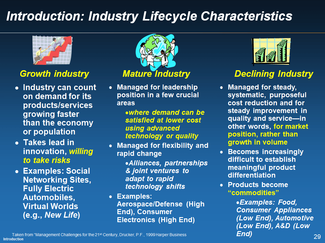

By the way, it's clear to me (at least) that the audio engineering industry is driven by "lower cost" solutions, and not nearly so much by higher performance products.
So all acoustic driver performance, as viewed by the manufacturers, is seemingly always accompanied by the notion of "at this price point" discussions. Many industries are in this sort of paradigm of thinking about their largely undifferentiated product lines. They don't want you to differentiate their products based on performance, but rather price. So they don't answer your questions about what to measure and just audible distortion levels.
So to talk about measured differences between drivers, and what those differences may be, you are really going against the grain of the manufacturers' intentions for their products. I.e.,
Only "boutique" acoustic driver companies try to vie for the very small market share that relates to diyAudio loudspeaker builders. I've found most of these type of enterprises operate on a shoestring budget in terms of real engineering capabilities; e.g., basically none of them own something as capable as a Klippel R&D system to educate themselves on "just audible distortion levels" and what each measurement type subjectively correlates to. They will typically not discuss these subjects with you.
YMMV.
Chris
