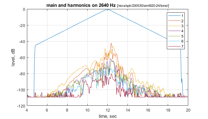

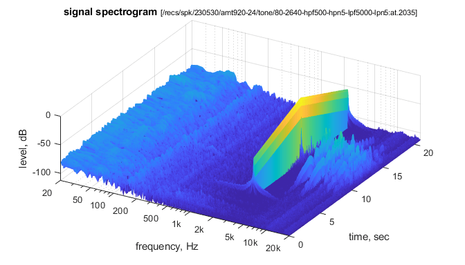

Oh, I almost forgot, on the validity of tonal testing:
Instead of swiping a constant amplitude tone across frequencies, lets swipe a constant frequency tone across a range of amplitude, up and down. The spectrogram would look like that:
and the flattening to time:
which is ... somewhat more complicated than some believers in tonal testing may have been used to expect.
Are the THD / harmonics / etc numbers the "scientific" properties of the driver or just the artifacts of a certain archaic methodic, a wild mix of whatever second-order effects?
