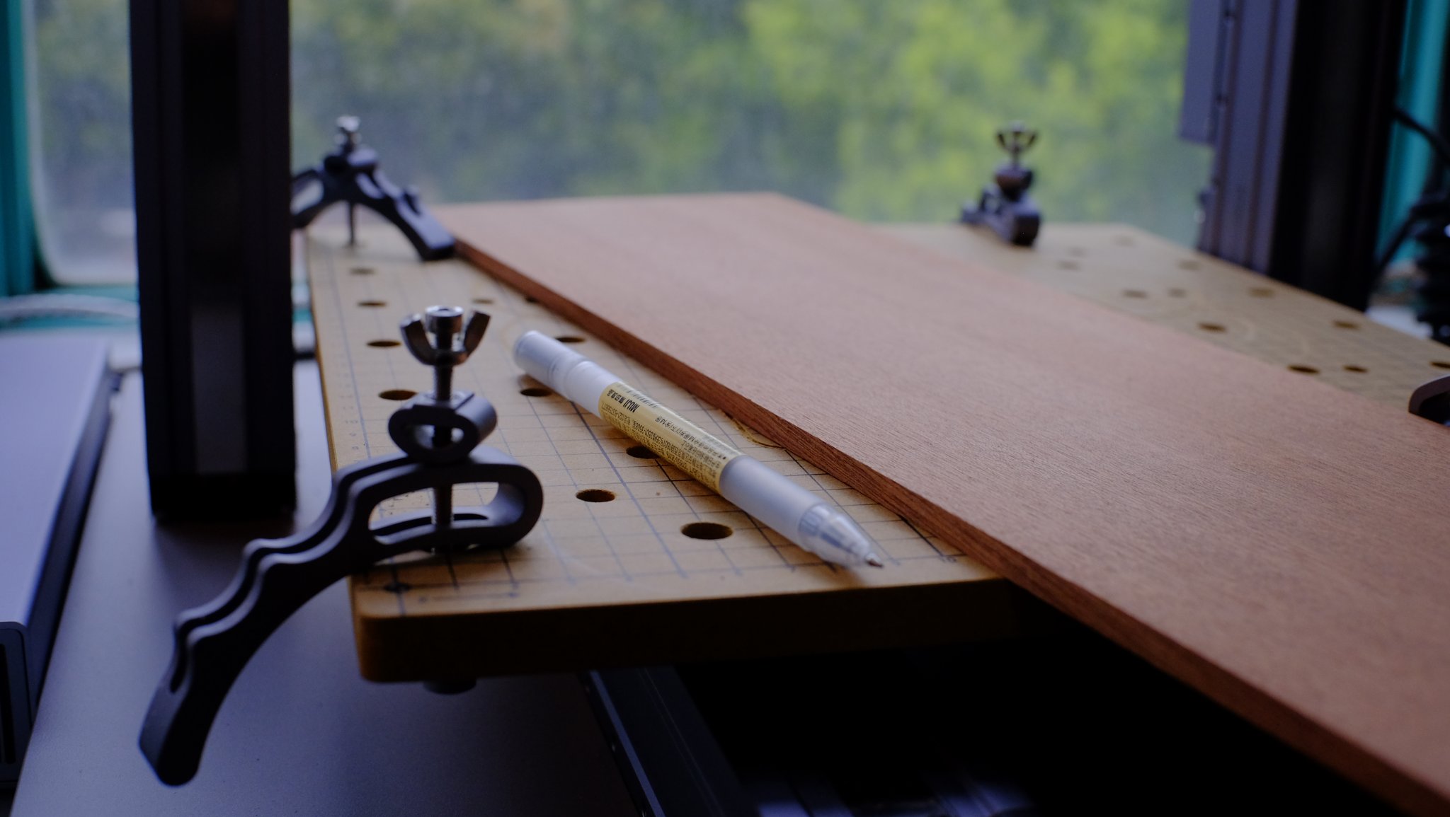

I am building bookshelf full-range speakers and I have these beautiful wood sheets that I want to use, however, the sheets are very thin like 6.2mm or 0.24 inches (1/4). Also, I want to use these sheets because I can work very easily with my desktop CNC Snapmaker. The sheets are very solid and stiff. Nothing bendy.
The problem is that I don't know if this will affect the sound and how it would be affected, do you have any idea?

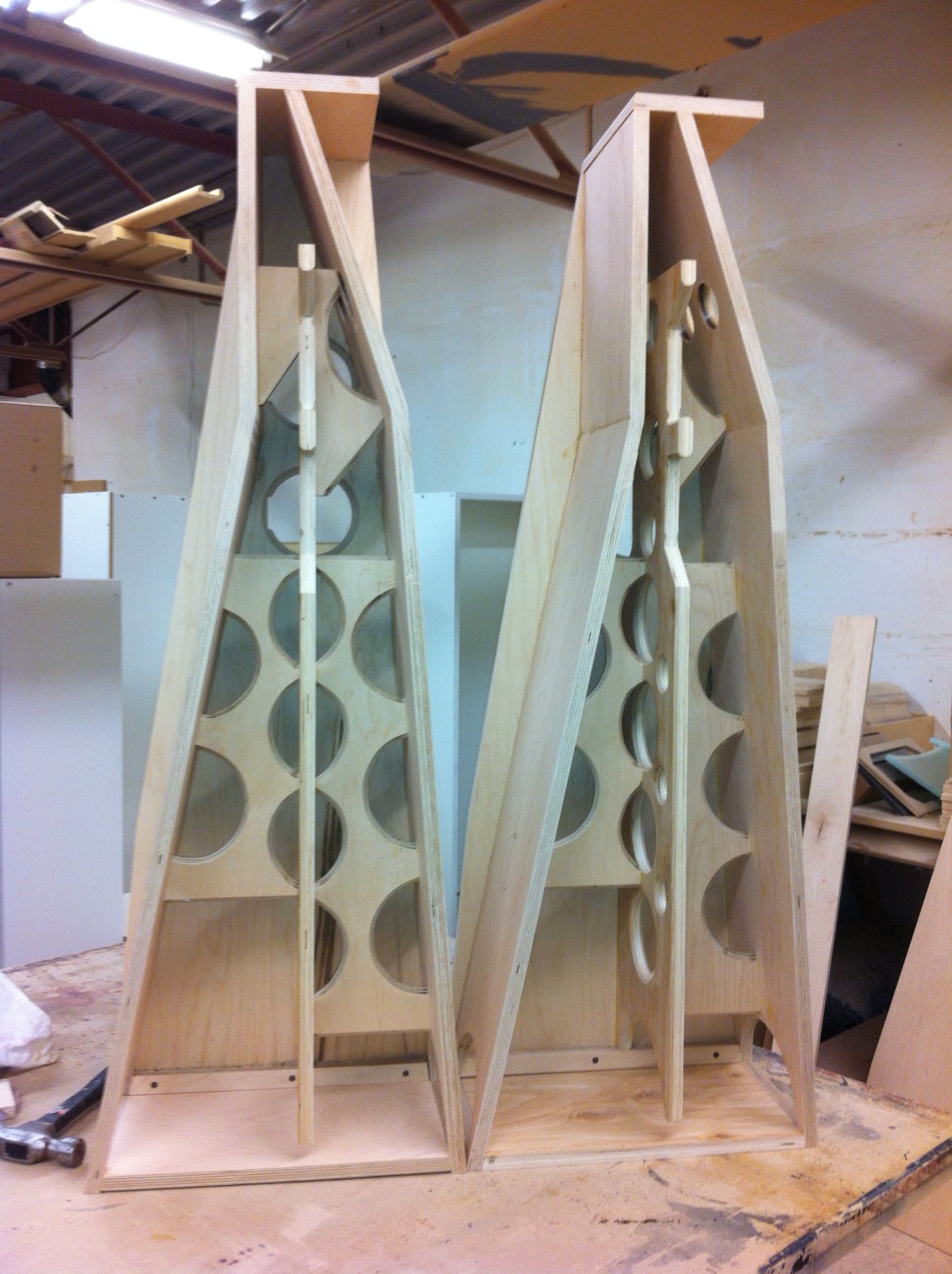

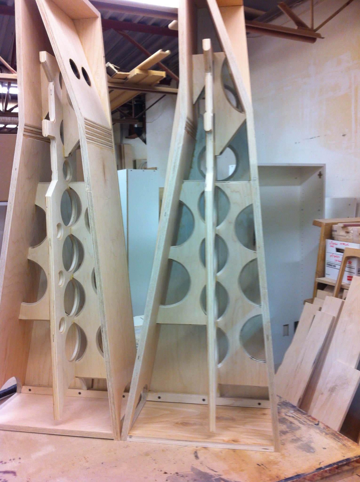

Let’s not forget that those bad boys had a fair amount of internal bracing, and IIRC the added mass of the Yew layer caused the lower of frequency - and even Q? - of panel resonances that required some additional fiddling to mitigate.

Yes, they went from good to yuck. An additional brace was added in the midTL.
Chris, you posted a picture of the insides i had not seen before, thot i grabbed it, but cannot find it, can you post it again?
