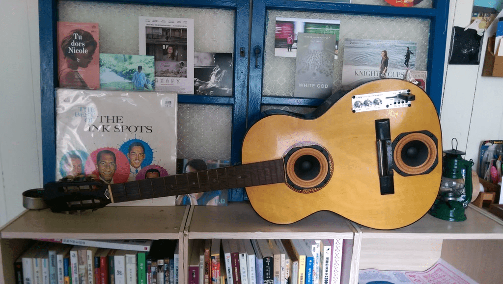

On classical guitars, I've found that the box / port resonance is about 110 Hz. This could be lowered perhaps to 80 by using a duct in the sound hole.
I wouldnt think the configuration pictured above is the best you could do. You'd want to put the speaker where the bridge was, with a slight offset on the top baffle. That would require getting the saddle off and keeping the wood underneath pretty; not an easy task. Plus, there's bracing beneath there, which would inevitably get disturbed by the driver cutout.
Perhaps instead of conventional drivers, an exciter mounted on the bridge area.
I've done that and you get something like;
You'd really want to use the guitar body as a ported air volume cabinet, versus attempt to drive its top as a speaker.
There's a couple octaves there that seem reasonably flat, maybe cross around that with lower / higher drivers

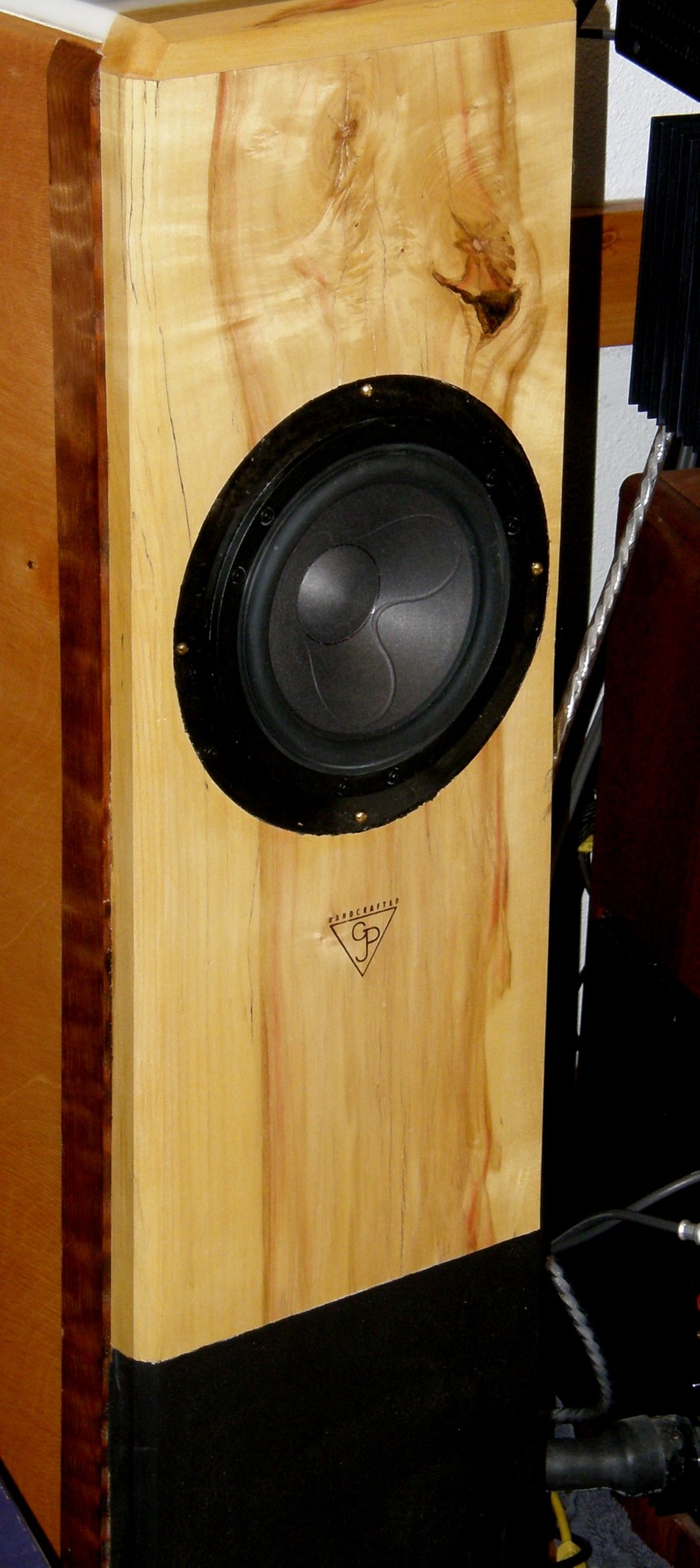

I think that’s too thin. Unless you are making extremely small boxes, that wood will tend to crack like an old cigar box in a few years time. I think you should get some 1/4-3/4“ birch ply or MDF, something more stable than plain 1/4” wood, and then laminate it. I make most of my speakers with a constrained layer. The toughest part is getting the panels to glue up evenly. I use a lot of tightbond and milk jugs full of water to press the panels together. the glue line has to be very thin for constrained layer to work properly. My usual method is 1/4-1/2” MDF, followed by 1/4-1/2” birch ply, and then cover it in thick 1/4” veneer. At a minimum you get 3/4” thick panels and they are very dead. I think it’s better than plain birch or MDF, and they look nice due to the veneer.

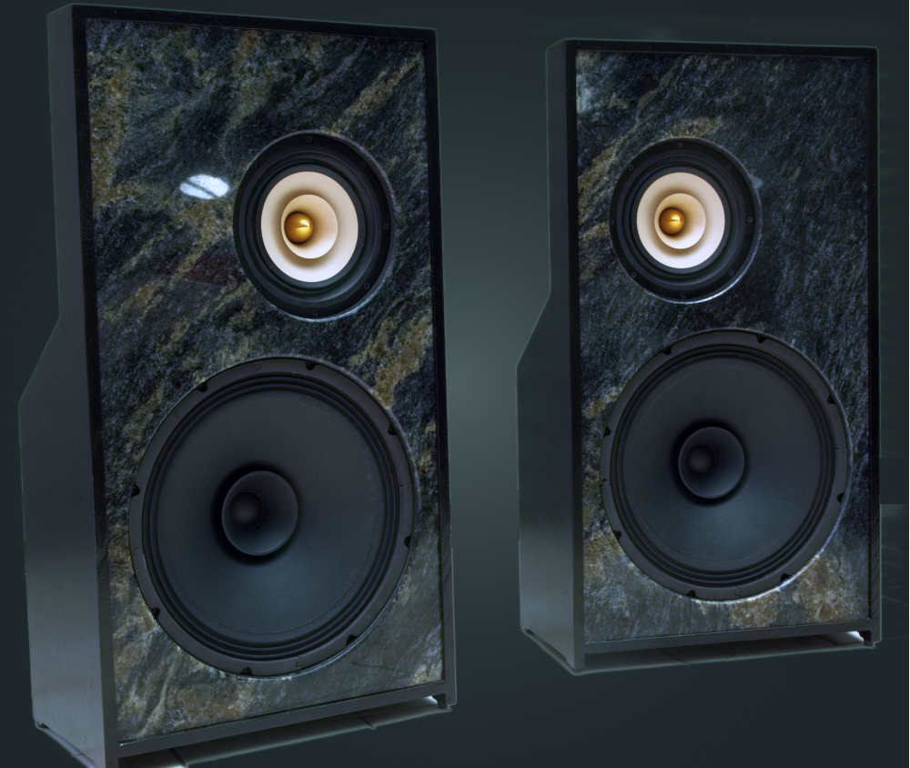

Shameless plug, I built these OB using a layering of 15mm plywood, 6mm honeycombed aluminium and 6mm stone panels.

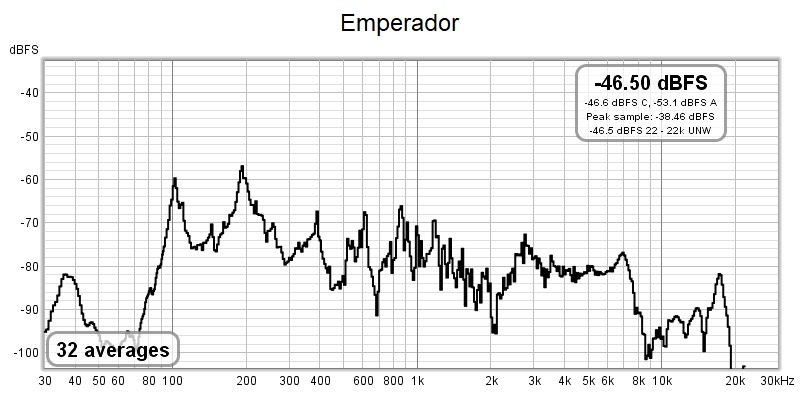

Even playing loud, the baffle doesn't vibrate at all, when placing your hand on it. Also shown in the distortion measurements.

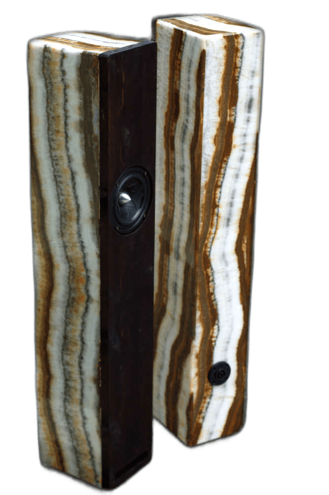

Also did a TABAQ pair using plywood and stone only, the box being so small didn't need the extra aluminum layer.
