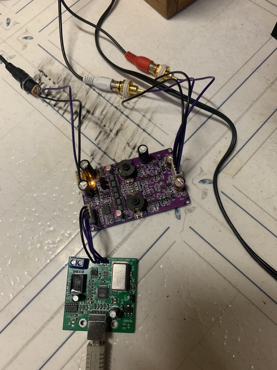

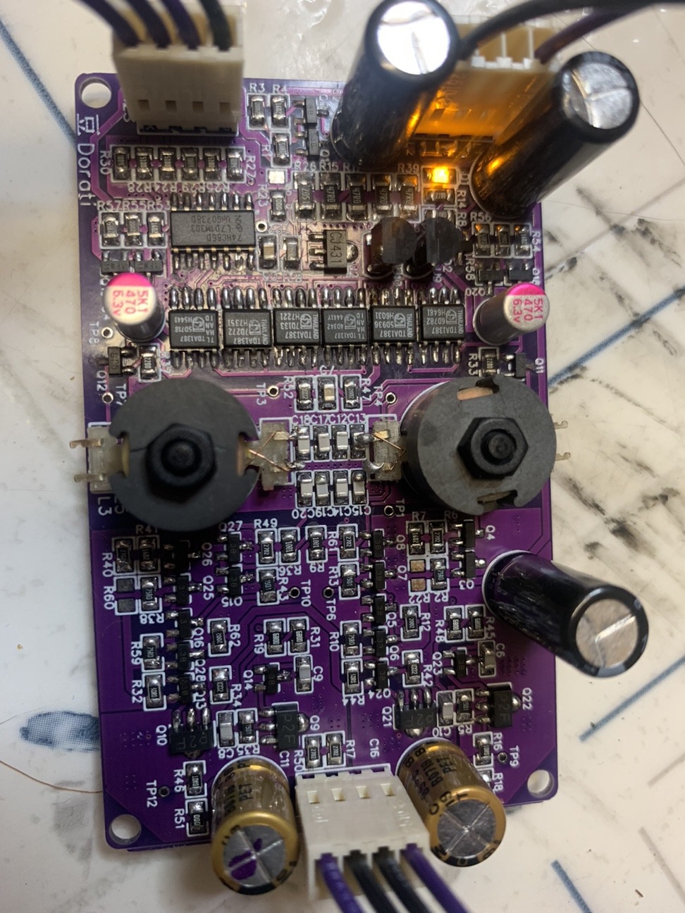

Picked up my kit from the post office this morning, and just got it finished! So far everything seems to have gone smooth, a couple voltages seemed to change after adding the caps, but its playing music and I cant hear any hum so I'll call that a win for now!!

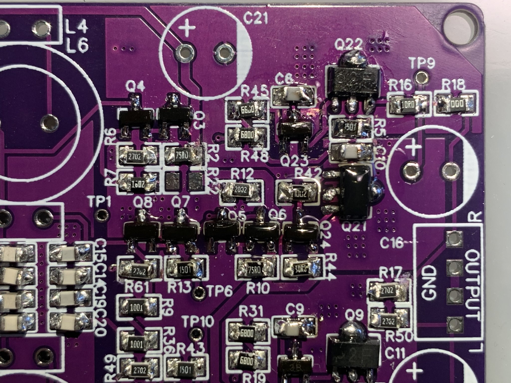

So here are my voltages, all taken while playing music. Using a 7022 i2s board. All voltages were in spec before adding the caps and inductors. That said, it sounds great on my little computer/soldering room system, but I haven't tried it in the living room system yet. I did not populate R22, R60, and I wasnt sure if it mattered which way the inductors went so I put them both with the magnet wire parts facing inwards.
TP1 4.817 - good
TP2 2.492 - good
TP3 1.664 - good
TP4 4.531 - a little low
TP6 5.69 - seems too low
TP7 4.333 - quite low
TP8 5.002 - good
TP9 6.885 - quite low
TP10 5.523 - low
TP12 6.702 - quite low
