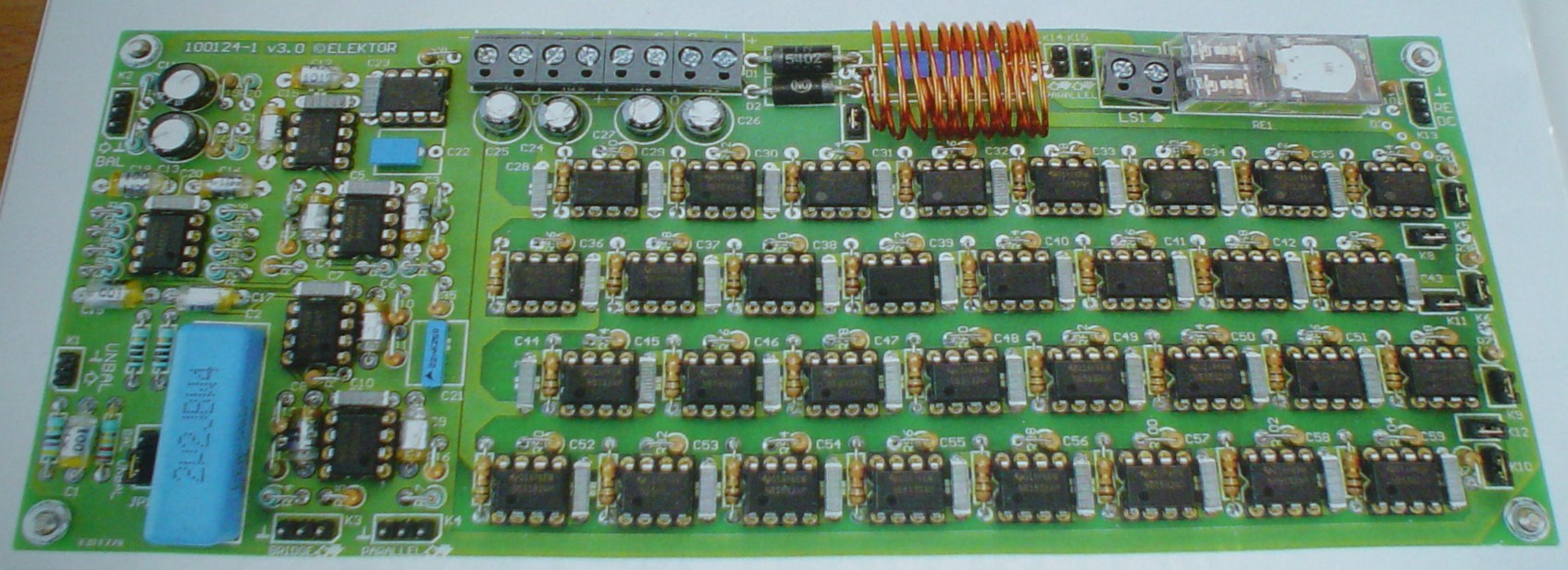

Quite funny, the most important word, the essence of your message indeed, is the word "sometimes". "Sometimes" Elcaps of around 100uF from each supply to ground. What is the definition of "sometimes" ? This, in the context of the Douglas Self NE5532 amp, where each NE5532 is locally decoupled using a small cap between the +V rail and the -V rail, without touching the ground.I do that all the time and it works just fine. I use only one 0.1uF cap and add sometimes Elcaps of around 100uF from each supply to ground. Even very fast chips like the AD797 or the AD8065 worked well done that way.
In the Elektor article they said that the original design contained two electrolytic capacitors that were removed due to "issues". I couldn't work out whether the Elektor team had changed the design, or whether Self did it himself.
In the later article where they tested electrolytics for distortion they came to the same conclusions as Self; they don't cause distortion as long as you make them 'big' enough. But, that being the case, they still didn't say why the original circuit was changed! Did Elektor change it for no good reason, and prove itself guilty of audiophoolery?
The original electrolytics were sharing some PCB tracks with other ground currents. That caused what we all have experienced (knowingly or unknowingly
So it's not an issue with the electrolytics, but of PCB routing.

Hi Jan, clear enough, this is why I'm a big fan of inverting power amplifiers, and inverting amplifiers in general. The signal ground path (quiet ground) only connects to the positive input of opamps, very high impedances indeed, no conducted ground current nor radiated ground field. You then get a robust behaviour, stable THD performance less dependent of the connecting environment. See the attached file as example.
By the way, I can't imagine Douglas Self mixing the decoupling ground with the signal ground on the PCB. Which electrolytic capacitors are involved ?
Are you sure the issue was not a class B supply ground current loop radiating at high frequency (say 20 kHz), then inducing a few microvolts into a neighbor track ? Will you investigate ?

Would you say that if you have local generous decoupling (one 220nF cap per opamp between +V and -V without touching the ground), that there is no real need for electrolytics locally placed between V+ and the ground and between V- and the ground ? This principle looks valid. Of course, you still need big electrolytic caps in the power supply PCB, next to the rectifier.If i use lokal Elcaps depends on the layout. Most of the time i have generous decoupling anyway so do not need the aditional 100uF caps. In case of a shunt regualtor it may be different because low impedance decoupling may make the shunt regulator oscilate.
Now consider the Compact Blameless amplifier.
The Signal Transfer Company: Compact Blameless Power Amplifier
We can see many electrolytic caps over there.
I'm in search of a near 1ppm THD amp, say 25 watt into 8 ohm, having no electrolytics on board, only 220nF caps between the +V and the -V without touching the ground. Do you know such design ? Of course, there are big electrolytic caps in the power supply PCB, next to the rectifier.
Twisting the supply wires between the PSU and the elco-free AMP would cancel the class B electromagnetic radiated field, isn't ?
In this context, there is thus less need for low-pass filtering the audio current flowing into the PSU-to-AMP wires, isn't ?
Better radiate a linear electromagnetic field, closely following the load current, than conveying supply spikes caused by elcos located on the AMP PCB, isn't ?
Elco-free power amps, this looks completely justified, imo. From the above considerations, it should be considered as a sign of quality.
Maybe adding only one elco cap at the PSU input terminals, between V+ and V- without touching the ground ? At the expense of conveying more supply spikes ? It all depends the PSU rejection of the amp. If the PSU is regulated and/or if the amp has a fine PSU rejection I wouldn't add such elco cap at the PSU input terminals.
Last not but least, once you feel happy with a PSU decoupling arangement, is it valid both for a single-ended load and a bridge-tied load ? In a single-ended load, where do you connect the speaker return ?

If you keep the power leads between regulator and opamp power pins short and use a very low impedance power supply, usually no need for electrolytic caps, so a good film cap between V+ and V- should be sufficient. Resulting in better sound if everything done right.
In this design there are too many opamps to satisfy either of the above - but it may sound good and I guess there is only one way to find it out - to build it and listen.
Say I manage to get an ultracompact blameless parallel amp like the one illustrated above (Kuroda_m) in post #44, using SMT devices and a x86 processor cooler. Elco-free. Only 220nF film caps for each amp (or buffer or quad amp).
Say I connect three different sorts of power supplies :
a) two 18V / 120 watt switchmode laptop power supplies making up + 18V and - 18V
b) one conventional unregulated + 18V and -18V supply using 4 x 4,700µF caps in total
c) one regulated + 18V and -18V supply like the one described in the Elektor-Self NE5532 project
What are the expected perceived quality differences ?
Can you describe ?

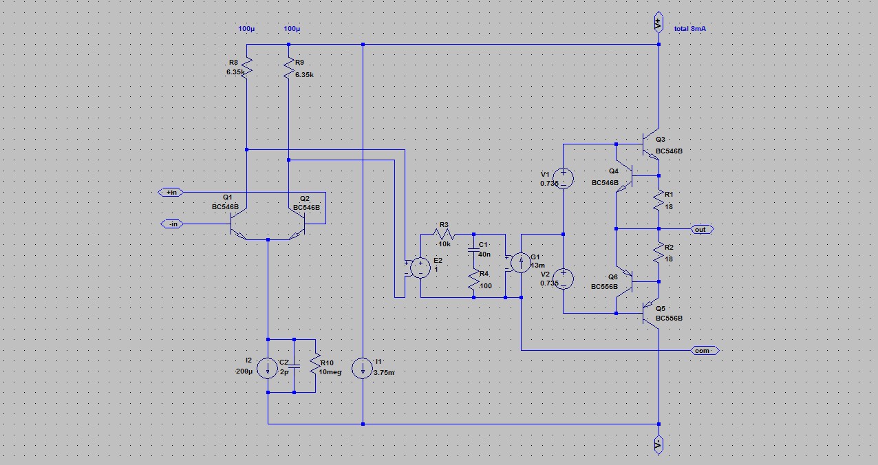

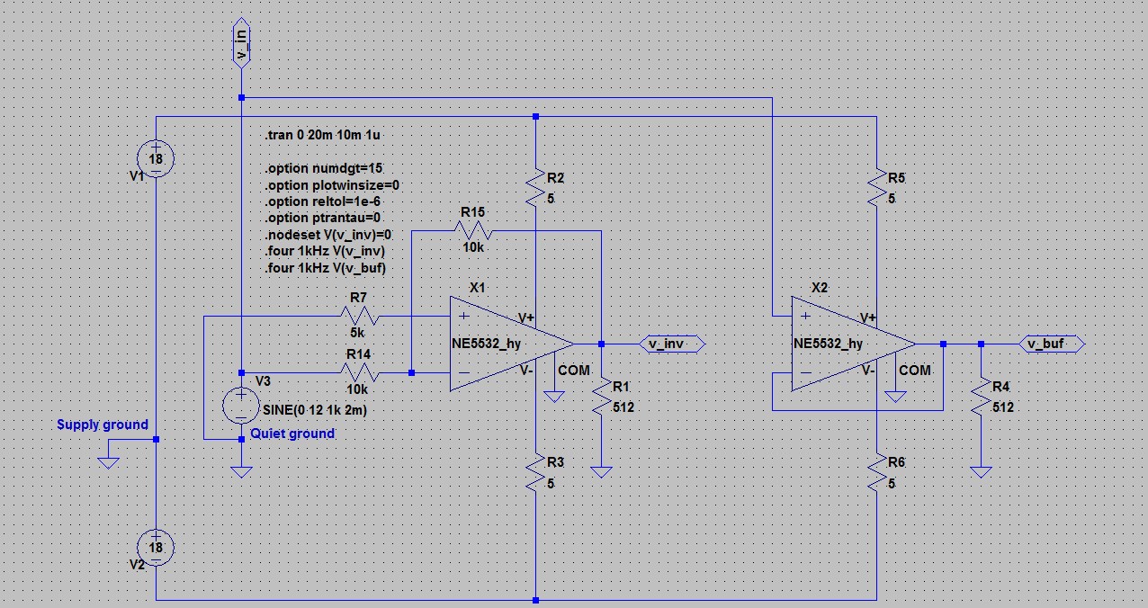

Can somebody check my simulation files and hybrid opamp models ? See attached .zip file. With those models, a NE5532 is not supposed to deliver the 5ppm THD claimed by the Elektor - Douglas Self NE5532 OpAmplifier, for 8 watt at 1 kHz into 8 ohm. According to the simulation, the non-inverting topology used by Self delivers less THD than the inverting topology, which is counter-intuitive. This newest Self design intrigues me.
