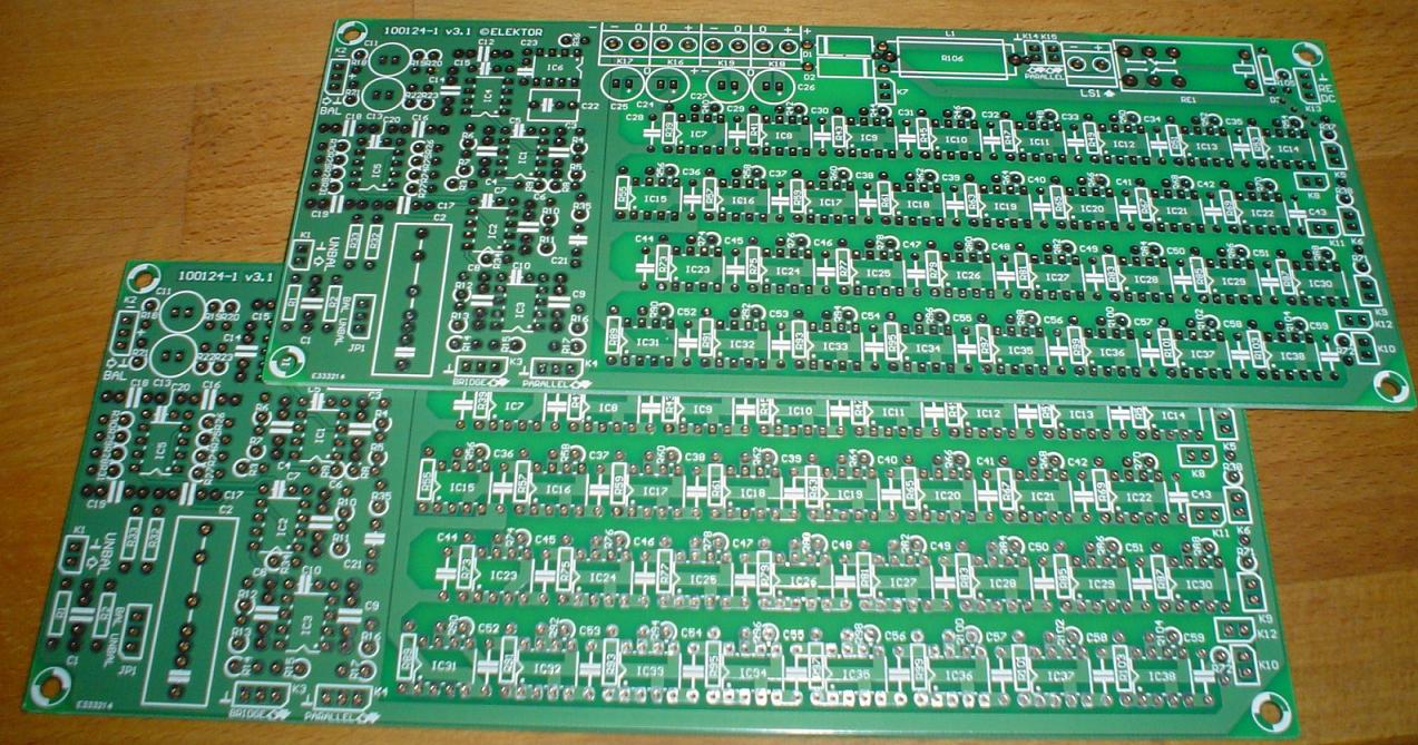

Thanks Don, I registered a few years back with Elektor. Tried the free download... no good! Then remembered I had signed up before so logged on and completed the registration process, and find I have 10 free credits. Had to log off and back on to "buy" the article with the freebie and then the download worked for free.
A set of boards arrived last thursday, half an hour before i took off to France for the ETF.
Ordered them the moment Elektor had them online, took +1 month to arrive, nice enough that Elektor is willing to offer such small demand items.
I can do up to 16" boards at home, but drilling ~1K holes to save a few bucks is totally bonkers.
Shame the agenda is too stuffed right now for amp time.

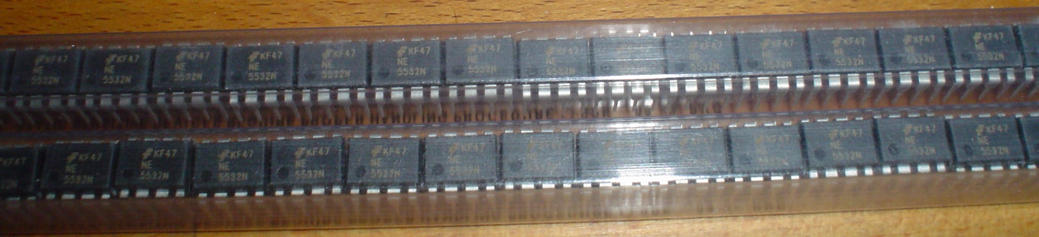

Fairchild opamps piccy.
Signing off, got Europe's biggest spender on RC model helicopters over for coffee (think €50k + NDA signature, just for the software)
Ah, the joys of catching a cold in France, if only till 06.00 hours tomorrow meurning.
