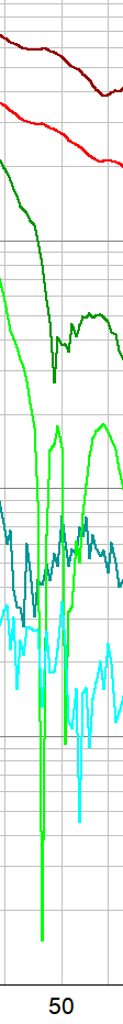

Please take a look!
Dark green is D3, with 0R
light green is D3o, with 20R
Hi, could you add legend to the lines, what I'm looking at? thanks!
edit. alright it is from picture on the first page, measured current and dark colors are with series resistor and light colors without.
Not sure how to read that, definitely the light green trace varies a lot around resonance, while the other doesn't. About at ~45Hz or something like that difference between light green and dark green trace is huge, while about at ~48Hz they almost meet, and then depart again.
Which driver is it? Also, what kind of Bl(x) plot there is? is there enough excursion in the measurement to get significant deviation in Bl? and how symmetric Bl(x) is which, would balance effects between even and odd harmonics? Also suspension asymmetry would likely contribute so not sure how to actually compare the graph. And we'd likely need both acoustic and current measurement to compare the two. Anyway, I'm not sure if there is enough data in this one experiment to draw conclusion one way or another. Interesting stuff nevertheless 🙂

I bet sound is better with the series resistor because the whole bandwidth is affected:
excursion at low frequency modulates driver parameters which affects the whole bandwidth of the driver, and thus high impedance anywhere on the bandwidth would reduce (some) motor distortion which ought to sound better. Even though acoustic distortion products originating at the resonant frequency were higher than they could, was it with or without resistor (series impedance), the sound should be better with the resistor assuming distortion was audible in the first place. I could speculate that around resonance either could sound just fine as it's room dominated sound anyway, for example, if Fs was 50Hz, 2nd harmonic would be around 100Hz and 3rd at 150Hz.
For this reason I'd say what actually happens is very interesting and fun to try figure out, not sure if it's worth losing night sleep though as sound ought to be better with resistor no matter what happens at the resonance 🙂
As has been said before, the described measurements are meaningless - or at least the 20R measurements are. The more the drive to the speaker is made "constant-current", the more any distortion in current is dominated by the effect of the series resistor.

Looking back on post #3 it fails a sanity check: The 20 ohm resistor linearises the measured distortion as measured through the sense resistor, but this does not prove any connection to the audio. That would still have to be done with a microphone.
