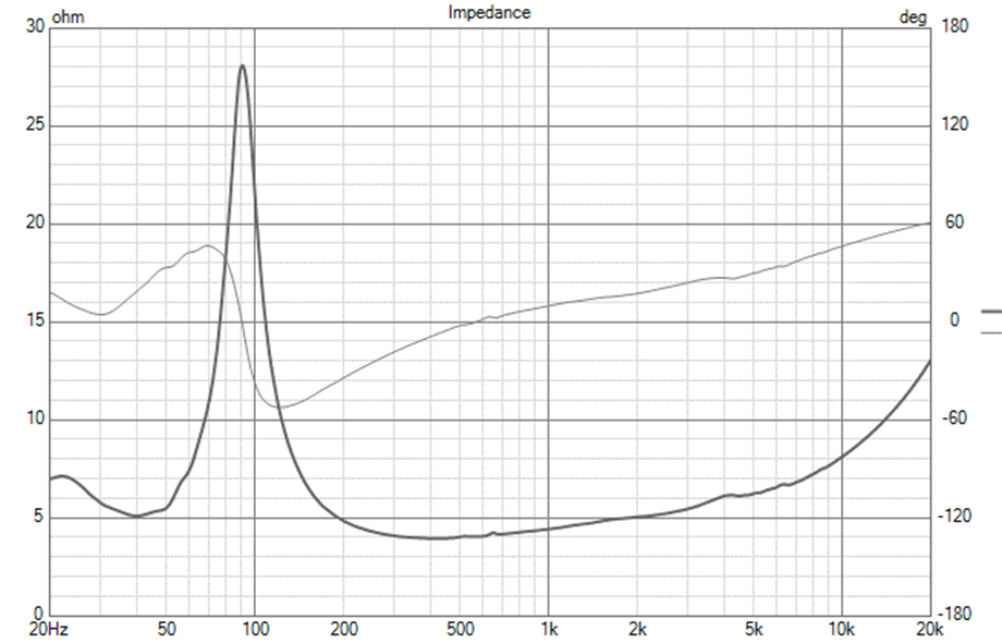

One thing I would like to get some opinions on is using an impedance curve to detect and assess resonances. For example

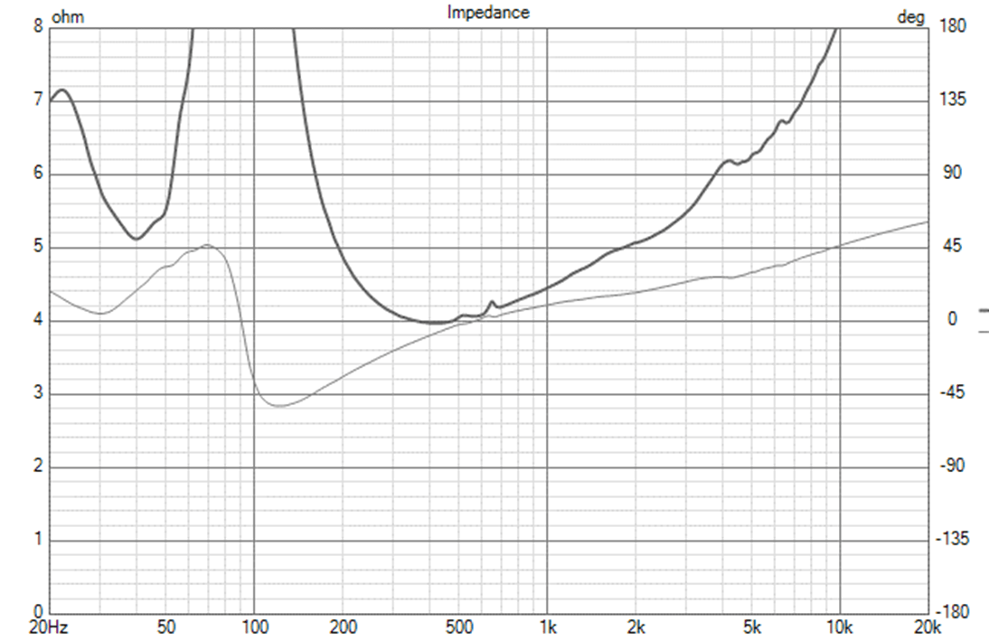

This is a small woofer in a sealed box. Notice at 640 Hz, there is a small burble in the curve. Zooming in a bit:
Here we see that the burble extends from 500 Hz up to around 650 Hz. After some investigation, I concluded that this was a small, insignificant cabinet resonance. My question is this: Is there a mathematic technique to assess this resonance? To assign a numeric value to it, based on the impedance curve?
Cabinet resonances are easy, they totally comply to f = c / (2*s) = 344/(2*s)
s here is the distance between walls in meters.
c = speed of sound 344 m/s
f = resonance (standing wave) in Hz
This formula is without a so called end-correction.
In very simply words, this correction is needed to match the theoretical result with practice because how non-linear acoustics works (not entirely correct, but it will do).
But it will give you perfectly fine ballpark figures.
These will also line up with burst-decay (= waterfall in periods) plots with a nearfield measurements without any damping material inside the cabinet.
For a ported systems, the same formula can be used (although the max and min values are at different positions) to also estimate the port resonance.
There are also resonances from the surround, typically around 800Hz-2500Hz,
This always results in a dip in the response with a corresponding blip in the impedance.
With bigger woofers (say roughly 10 inch and above) you can sometimes also see a resonance in the suspension/spider.
Which is typically lower in frequency, around 200-400Hz or so.
By far the best way to determine what resonance belongs to what, is to just simply measure the woofers impedance in free air first.
Or look at 3rd party measurements.
If you want to do it well, measure the nearfield response as well + distortion.
Compare this to the measurements inside the cabinet. (again incl distortion etc etc)
Any issues that didn't show up in the free air measurements are not part of the

I should have been more clear. This impedance burble corresponded to a small cabinet structural resonance on the rear wall... NOT an acoustical "standing wave" resonance.What resonances are we talking about?

So if we follow the step-by-step-guideand extracting information about the 640 Hz resonance based on its shape.
1 - measure loudspeaker in free air, incl impedance, distortion and burst decay (waterfall in periods)
2 - predict what resonances are to be expected inside the cabinet
3 - measure the same things with the loudspeaker inside an empty cabinet
4 - measure again with damping material
If the little resonance already showed up at (1), don't look further it's a driver problem.
If the resonance seems to be in ballpark at (2), use (3) to double confirm, especially waterfall/burst decay is leading here.
Even more so when this resonance gets a lot less significant at (4)
Additional there can be a step 2a with ported system as well as a step 5.

Also looking at the shape of the burble i cannot see a panel resonance, more a mechanical connectivity issue.
