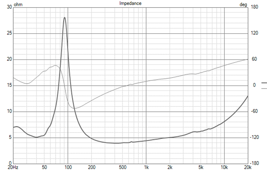

Except the measurement needs to be relevant, which may sound like kicking in an open door, but just the Rsense differences or voltage differences in otherwise identical measurement setup, shows it is not that obvious or straight forward at all.
My choice for Rsense of about 0.135 ohm (and 1, 2.8 and 4 volts rms) icm with Arta and an amplifier is based on:
- Is in line with how Purifi measures.
- Is "in line" with real world use of the driver.
It is my choice and gives me an understanding of the driver behaviour in its intended use. And if so needed a clear communication with the people of Purifi.
I personally give very little for standards if they do not match the real world use case.
Which f.i. in my view is the case with the TS parameter standard(s).

I think we should define which measurents (or parameters) are needed
1) for evaluation of drivers and choosing the most appropriate units for a project. Woofer/mid /tweeter duties ask for different properties...
2) for xo design/simulation with chosen drivers in a project, in the baffle/box being used. Both electrical and acoustic properties

One thing I would like to get some opinions on is using an impedance curve to detect and assess resonances. For example

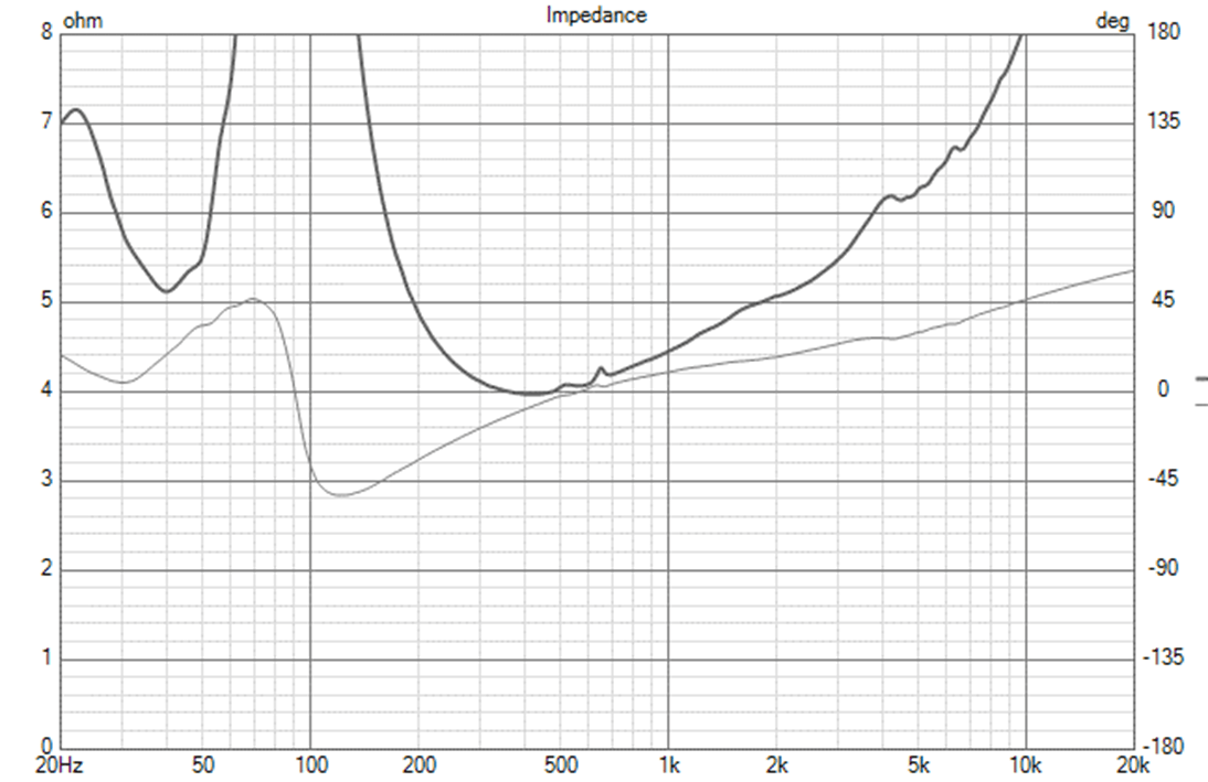

This is a small woofer in a sealed box. Notice at 640 Hz, there is a small burble in the curve. Zooming in a bit:
Here we see that the burble extends from 500 Hz up to around 650 Hz. After some investigation, I concluded that this was a small, insignificant cabinet resonance. My question is this: Is there a mathematic technique to assess this resonance? To assign a numeric value to it, based on the impedance curve?
