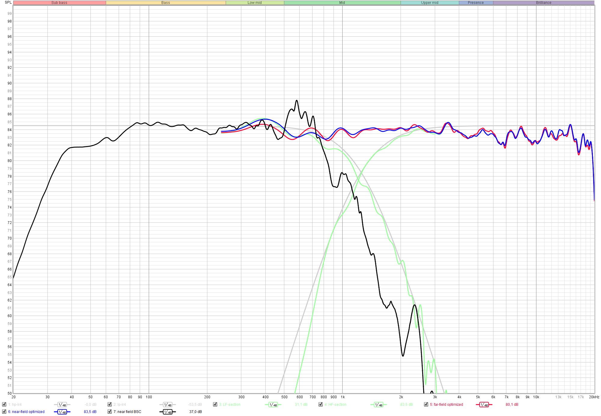

I thought my premises were quite clear: a PEQ which is applied to a combined response does not consider the system that is a bass-reflex port working together with a woofer. It only boosts the combined response as if it was linear. As port an woofer have specific slopes, Qs and efficiency, the effect of a PEQ on an assisted system is different from a PEQ that is applied to the combined response.
VCad bass EQ applied to combined response, nearfield woofer + port and spliced to far field (wrong):
https://www.diyaudio.com/community/attachments/sp68-power-di-png.954957/
Actual measurement result:
https://www.diyaudio.com/community/attachments/disagreement-png.956362/
If this is what you meant, yes: a PEQ that is applied to the combined response in simulation got nothing to do with an assist in a real vented speaker. The assist must be applied so that it effects both sources before summation in simulation.

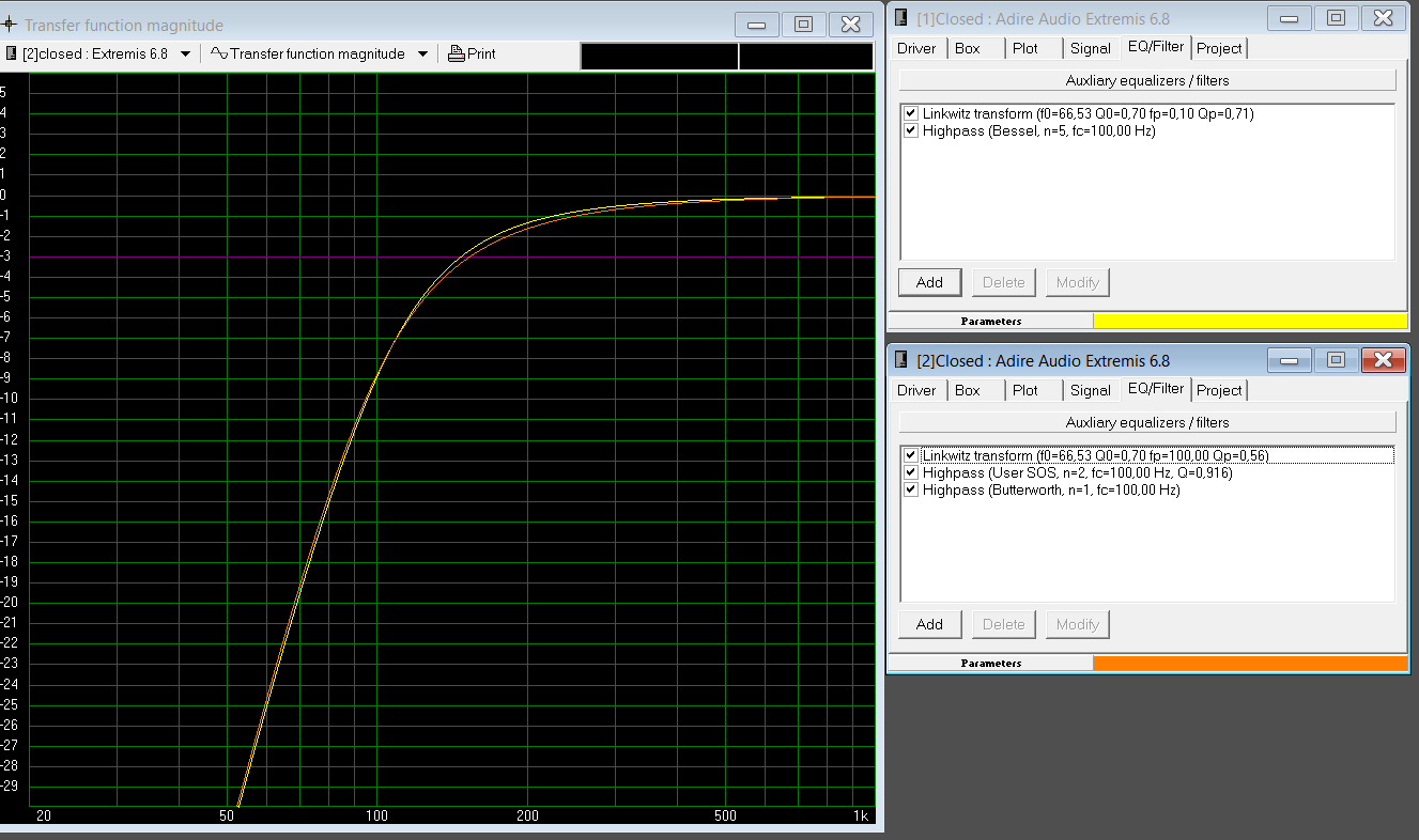

A Linkwitz-transform is only good for a 2nd order system with a 12dB/oct roll off.
So in order to get a 5th order filter, you just have to add other highpass filters accordingly.
In this case you need a 3rd order filter on top of the LT.
(or a 2nd order followed by 1st order, but that is the same thing)
A super and easy quick trick to do this in simulation software, is either work with a target curve.
Or otherwise when that is not available, first add a LT at like 0.1Hz (Q=0.707) and than add another 5th order Bessel (in this case).
The result is a perfect Bessel response down to 0.1Hz.
The rest is just calculating and summing Q-factors.
It has been a while ago that I did that by hand, mostly because I am lazy.

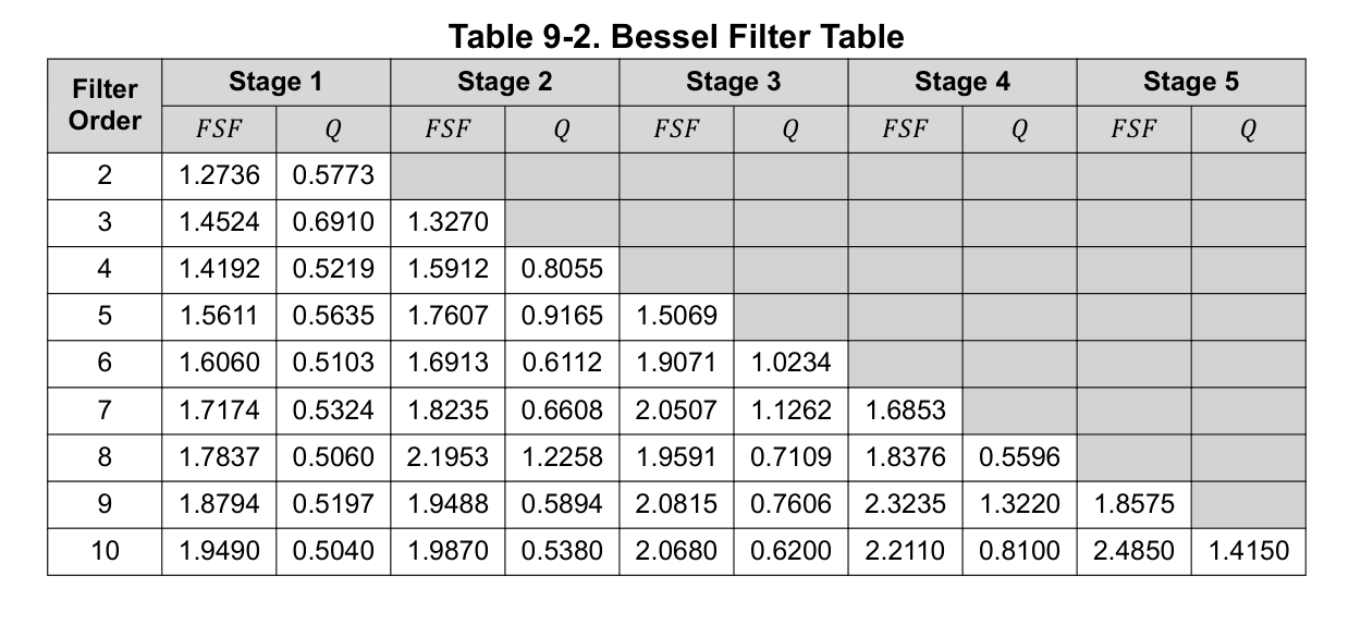

You can also just find the needed Q-factor combination in those Q-factor-filter tables.
So for a 5th order Bessel filter we need;
- LT with Q=0.5635
- 2nd order HP with Q=0.9165
- 1st order filter (doesn't have a Q)
Here is a random example (first one I had in the list)
Unfortunately you sometimes get a bit of a difference because of rounding errors.
Important note, this DOES NOT work in the newest WinISD, because of a major bug!!!
Obviously this can also be done with other programs like VituixCAD, I just find WinISD WAY faster and quicker with these kind of things.
In the end it's nothing more than just cascading filters.
A very important note from a practical point of view, is that you need to take very close intention not to boost to much to prevent clipping in either the stage or the power amplifier.
I personally take 6dB as a absolute max value, unless I know there is plenty of headroom.
This only happens when we extend the response of the driver obviously.
Btw, I very rarely use anything more than a 4th order total filter response.
Mostly because it won't give more benefits, in sense of max power and/or cone excursion, but the groupdelay goes up significantly.
For woofers that also do the low-end, I usually optimize to 3rd order filter (= LT + 1st order HP) even with a similar response.
