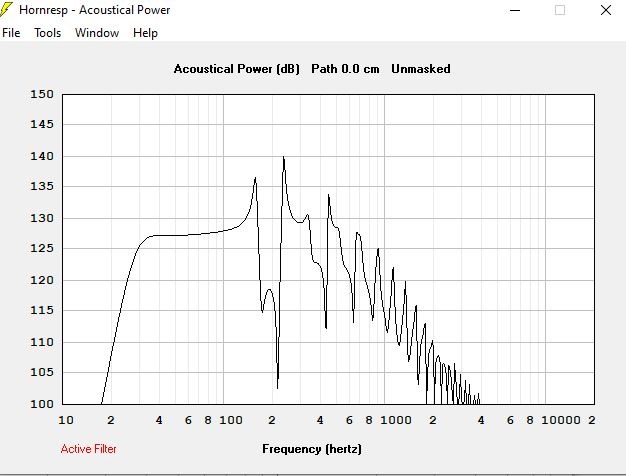

What about Big Port, tuned low, lost of damping material. In HornResp the Harmonics are tamed pretty well with a little bit of damping material.There is a highly informative thread on ports thanks to the experimental nature of @stv, that shows 'big' ports create specific issues too, midrange leakage.
Lots of damping material will significantly reduce useful bass output, but if that's ok for you it is a viable option.lost of damping material
If you use any of the good simulation programs you can apply high power and see what the port velocity is.@perrymarshall

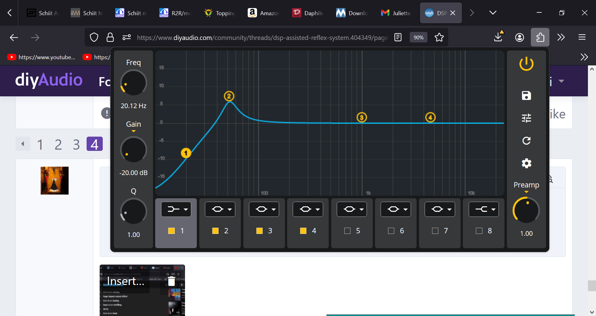

I think you'll like this......

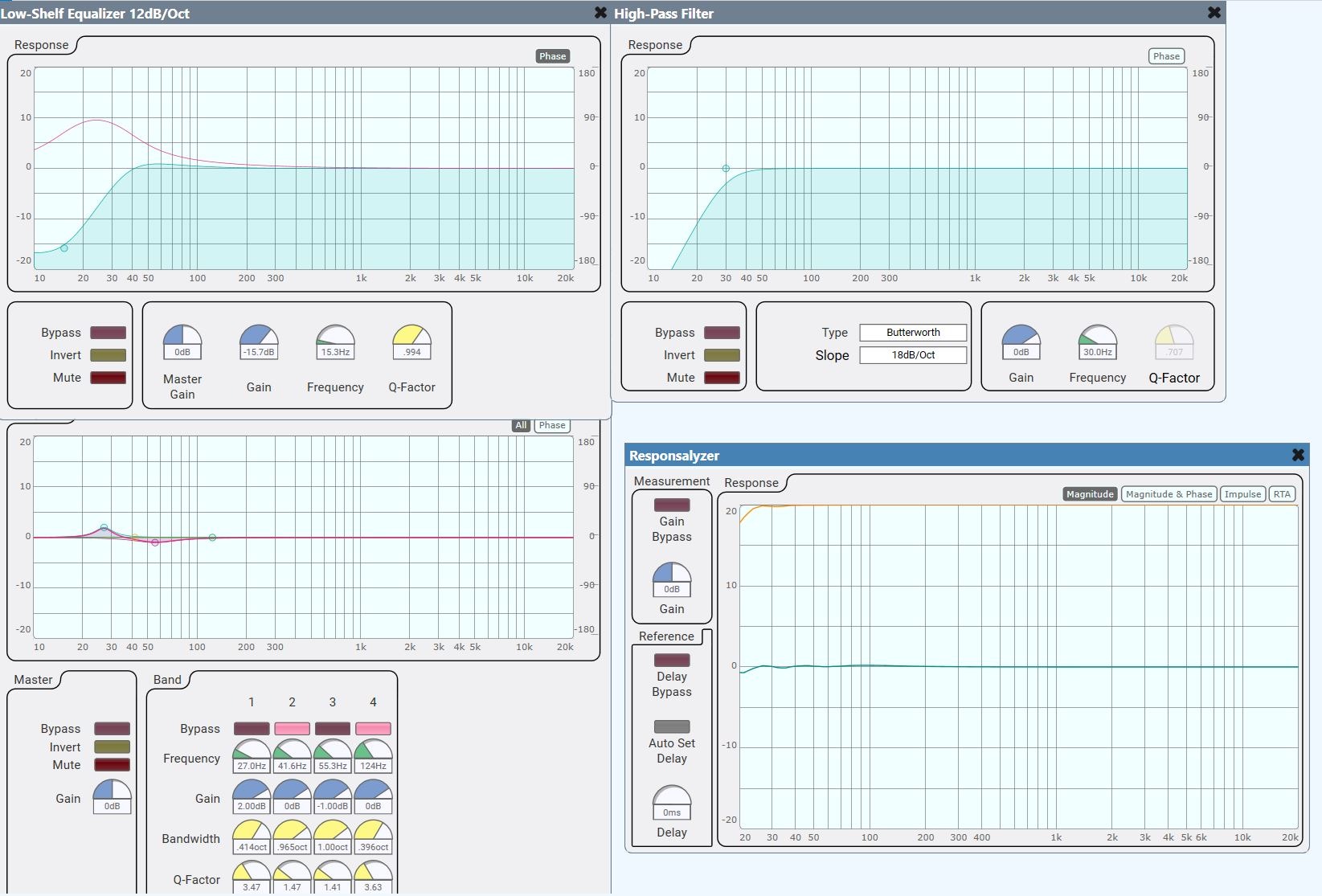

Here's a transfer function where the reference signal is a 30Hz 18dB/oct Butterworth high-pass; and the measurement signal is the shelving strategy.
I was trying to see how close I could get the shelving strategy to match the 30Hz hpf, and then compare their phase and group delays.
I didn't want the upward bump in response the Q=2 strategy gives, I just wanted to replace the 30Hz BW3. So the shelving Q ended up at about 1.
You can see the shelf settings and a couple of small PEQ on the left side screens. The 30Hz hpf on the upper right.
The lower right screen, labeled Responsalyzer is a dual channel FFT showing the magnitude transfer function between the two.

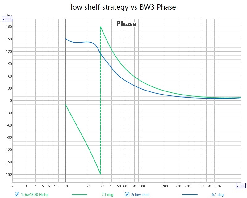

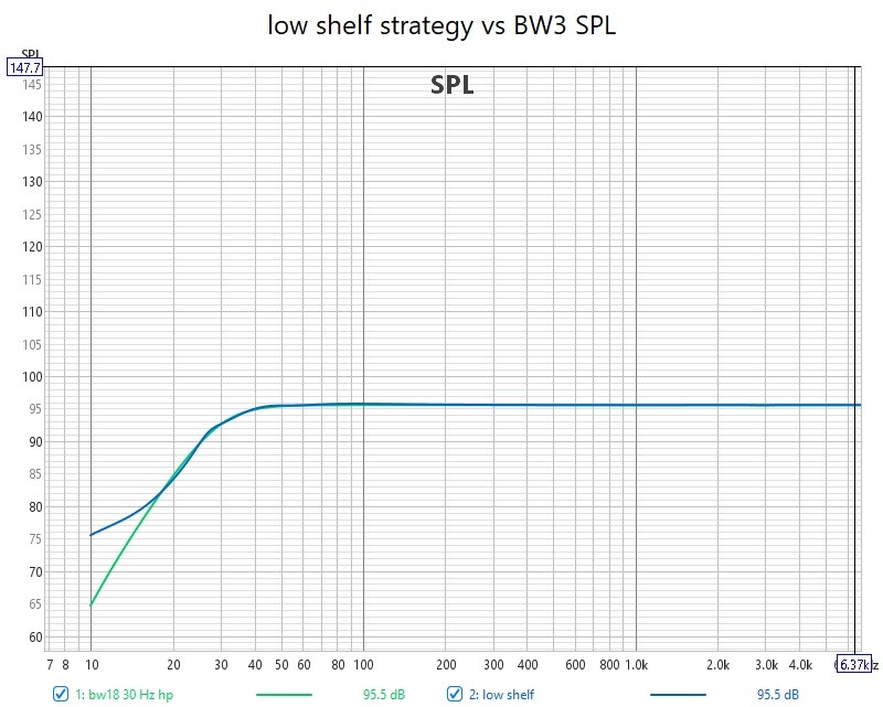

Here's some REW screens of the matchup.
SPL, phase, group delay.
![low shelf strategy vs BW3 SPL.jpg low shelf strategy vs BW3 SPL.jpg](https://www.diyaudio.com/community/data/attachments/1160/1160541-56623daf8092221110d09d7677350c87.jpg)
![low shelf strategy vs BW3 Phase.jpg low shelf strategy vs BW3 Phase.jpg](https://www.diyaudio.com/community/data/attachments/1160/1160542-75091d3aeae5018b24f24feeb3b25cc2.jpg)
![low shelf strategy vs BW3 Group Delay.jpg low shelf strategy vs BW3 Group Delay.jpg](https://www.diyaudio.com/community/data/attachments/1160/1160543-85bda4a12682f500dcbc359829eb2c62.jpg)
Must say i'm very intrigued by the strategy.
I can see that the Q=1 doesn't continue to closely follow the BW3 below about 17Hz, but I'll check Hornresp for excursion ...hopefully no issue.
If there is an issue I'll play with raising the shelf's Q and rematch.
'Cause I do like the phase/group delay performance.
Will say this though, if mag curves get perfectly matched to the very bottom of the spectrum...the phase and group delay have to be the same, right?

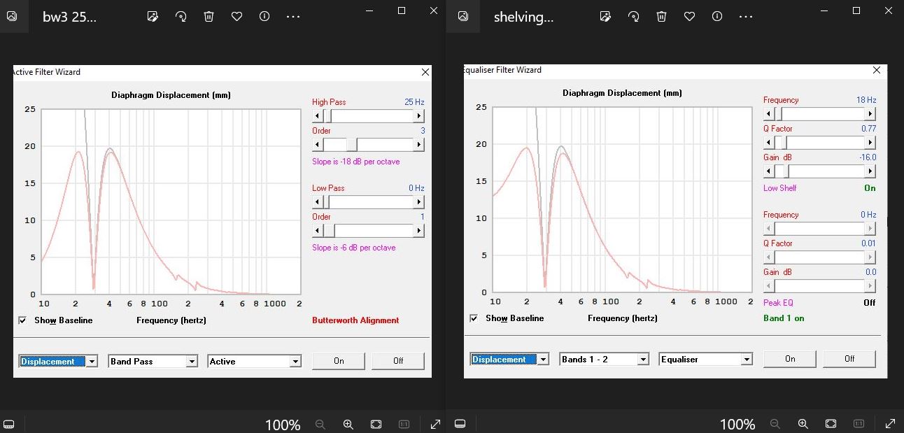

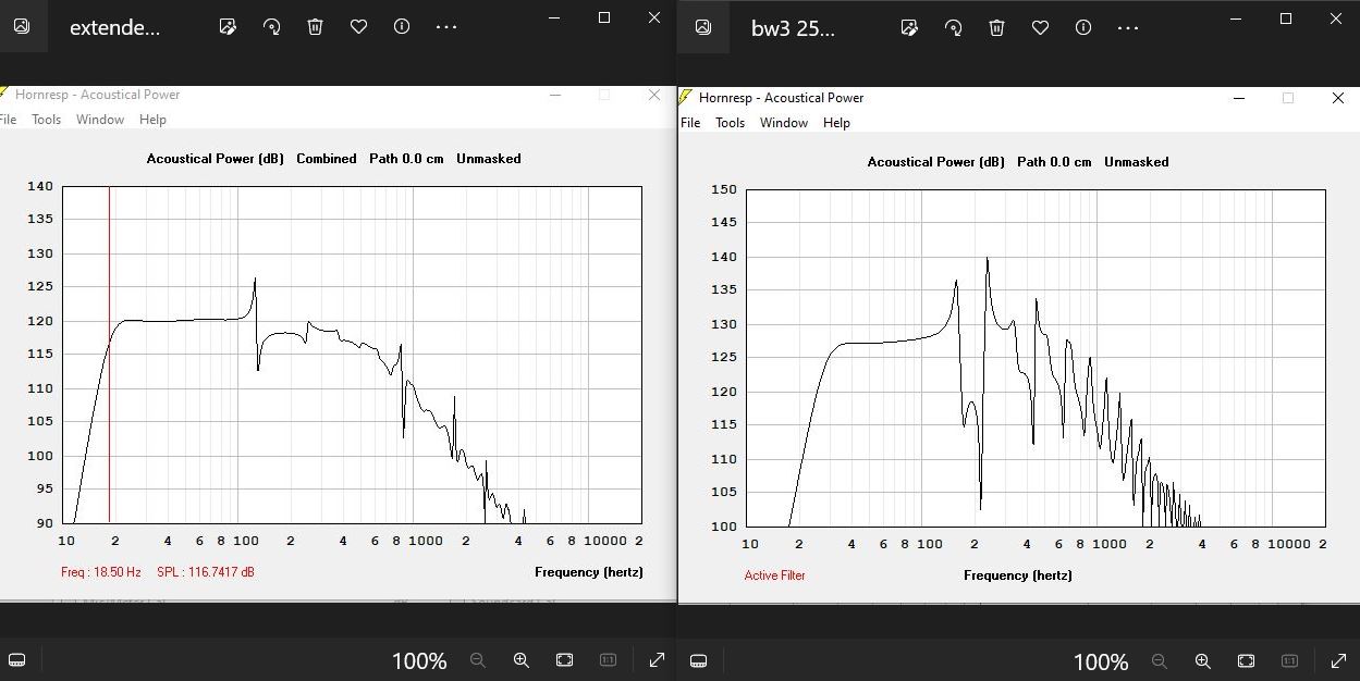

Hmmm....not what I'm see with hornResp. WHEN being used as only a HPF substitute.
Here's the same power response, whether using a bw3 25Hz hpf, or an 18Hz -16dB Q=.77 low shelf.
(sub is 18n862 in 190L, 100 in2 port area, 32 in long.) (19mm xmax)

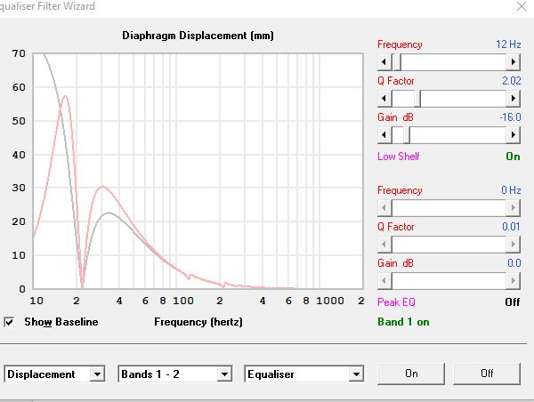

Here's the two filters and their displacement effect. BW3 on left.
You can see the shelving Q, with no bump needed dropped to 0.77. And subsequently, less attenuation below 20Hz.
Here's group delay compare. Small advantage to shelving...I figure due to lower attenuation below 20 Hz.....and will go away when attenuation matched.
So I dunno, I'm thinking the next experiment i want to try, is to see if a regular hpf with a PEQ bump, can exactly replicate a -16dB Q=2 low shelf.
Must admit, i'm thinking it can.......

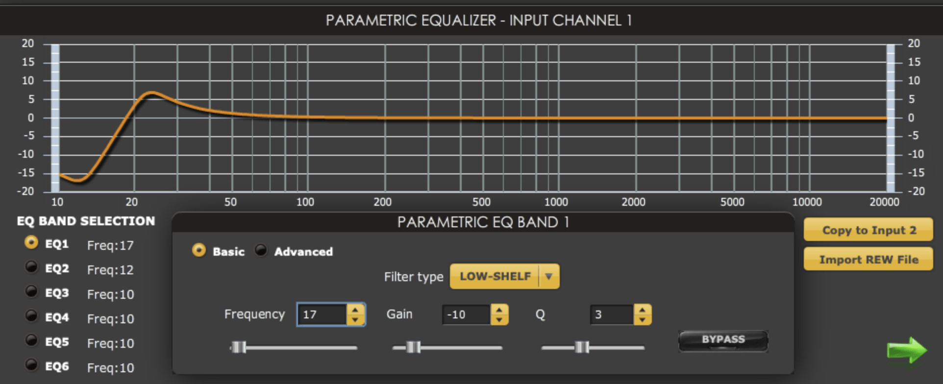

@mark100 Here is a very practical application of my DSP Assisted Reflex model:
1 - Re-tune your subwoofer Fb down to 22Hz instead of 29.
2- Instead of maximally flat, you'll get a tapered response downward starting around 50Hz. At 22Hz the system will be down 6-8dB.
3- Then apply a simple 2nd order shelf filter with a Q of 2. Make sure the +6dB peak of the filter sits at 22Hz.
4- Now your system is -3dB at 19Hz instead of 29Hz. You just added half an octave of bass response, and can still play louder while using less excursion overall than the old tuning without a filter.
It's fun to play with the filter Q and the tuning of Fb until you get the exact curve you're looking for.

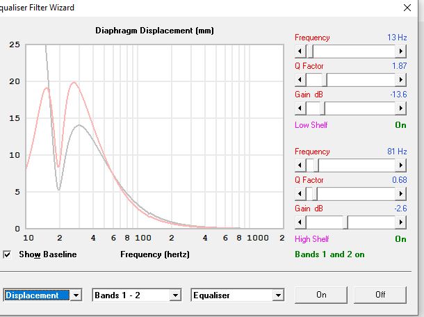

In response to below....

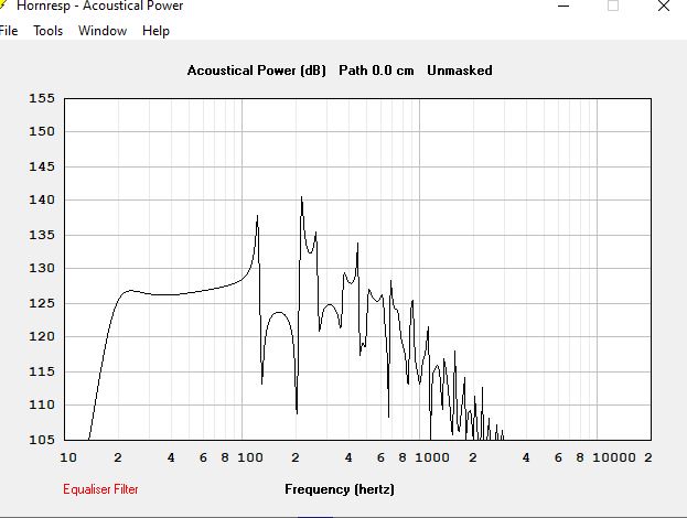

Here's the power output taking the steps you listed.....I likes the 'looks' so far !!!
But when I go to displacement....trouble in paradise..
I've tried adding a hpf filter, but by the time i get displacement below x max, power curve is about the same downward response as before adding shelving.
Maybe I'm misunderstanding / doing something amiss....

Hi Perry, I ran your last suggestion and have been playing around a bit, getting a feel for the shelving filter's effect, and interplay with additional high-pass etc.
Also updated hornresp to latest version as my 2yr old version was sometimes giving strange results when switching between filters tries.
Hornresp is really cool, in all the ways you can analyze the filter(s)' effects.
Anyway...I'm at the stage of two central takeaways.....one, an enforcement of the old adage "do you want loud, or do you want low?"
And two, the high Q shelving strategy is pretty neat

Here's just one version I came up with of going lower using the shelving...but I think it's a decent example of the "low vs loud tradoff" I've been playing with.
The referee named Excursion is the head official, huh?
On left is an extended low, 250L, that I see as a 120dB box with f-3 at 19Hz.
On right an existing 190L, .... 127 dB with f-3 at 29Hz.
Always the tradeoffs in audio, huh?
Anyway, what I really like about the shelving is this is the displacement and filter for the above (left)
Has no high-pass ! Very neat.

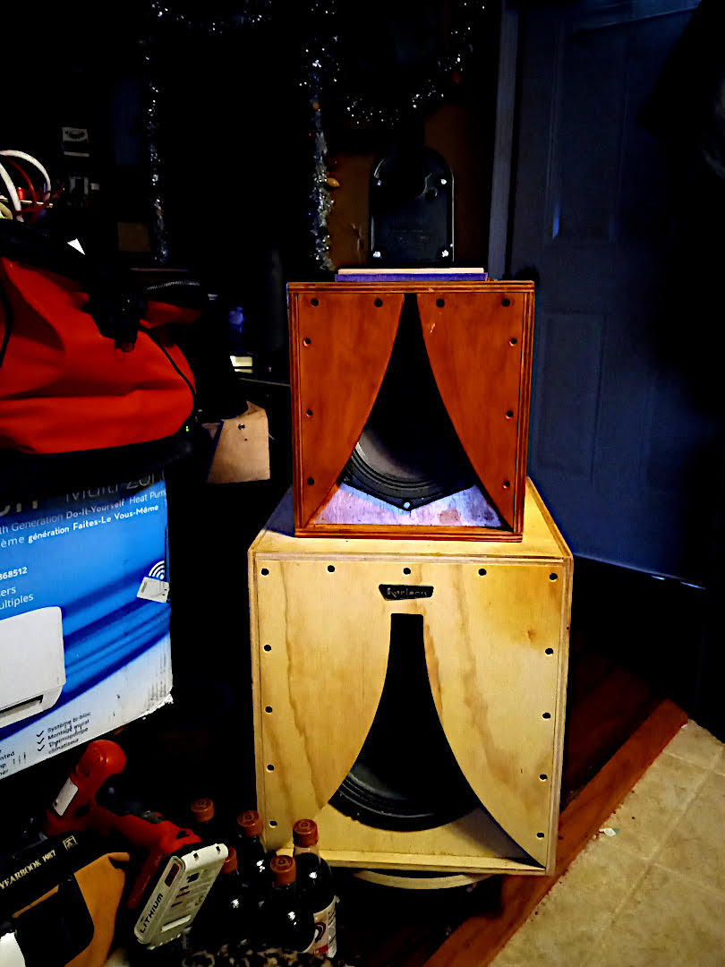

I'm definitely going to be simming the shelf idea for a new dual 18", opposed drivers, slot loaded sub, I plan to start in a couple of months.
