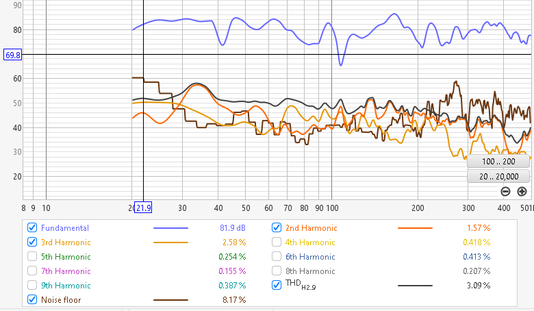

When I simulated what was needed to push my driver (PHL 3411) in WinISD to 43 Hz f3 in 30 a liters box, it never matched my measurement results. I had to use considerably more boost, which was no problem, because it is an efficient driver and I have 250 Watts powering it.
In any case, I was wondering if you could actually match the Hornresp simulation with your measurements?

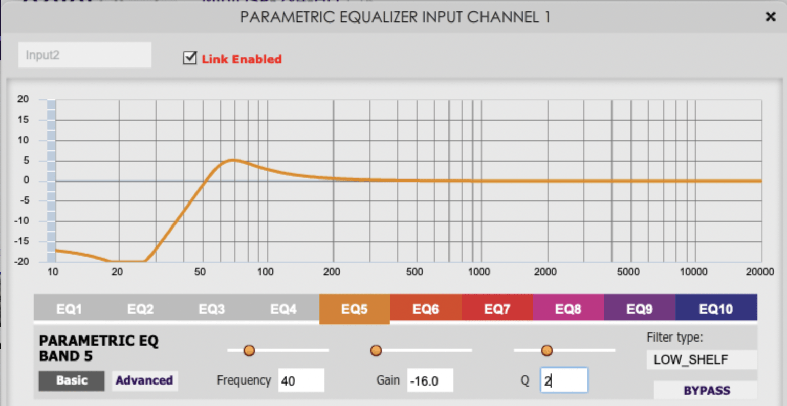

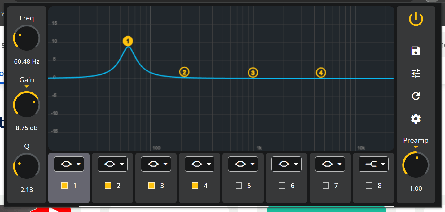

Actually, the BR tuning is off compared to the HR model (due to port shape). I used -16 dB , Q=3 low shelf, I moved the frequency until I got the peak aligned with the BR tuning.
I do not think I can do any distortion plot at home, I would need to take it out, but not before the winter ends. Or maybe I just do not know how to do that in room...
I cannot see any movement of the 15" cone while listening, so I do not expect amy distortion that could be noticeable.
Same with the 10-inch. At levels beyond acceptable in the city, no cone movement at all (only af shifts/refocus):
Have no x-ray eyes, cannot see the voice coil working though.

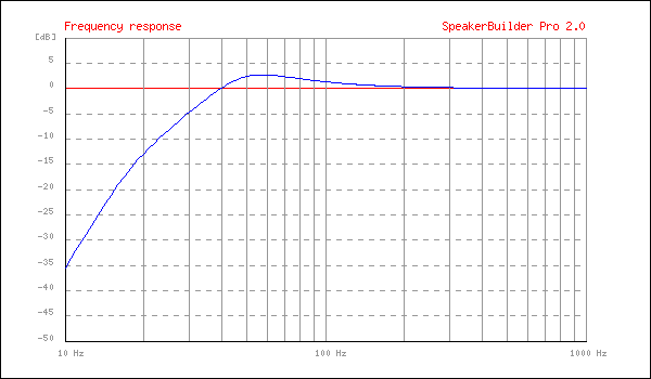

You used speakerbuilder website in the article but on my computer it doesn't download driver data from server. You guys also experience this problem?

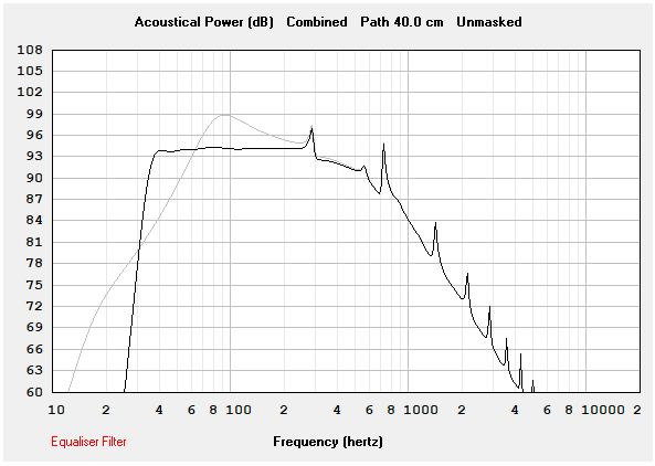

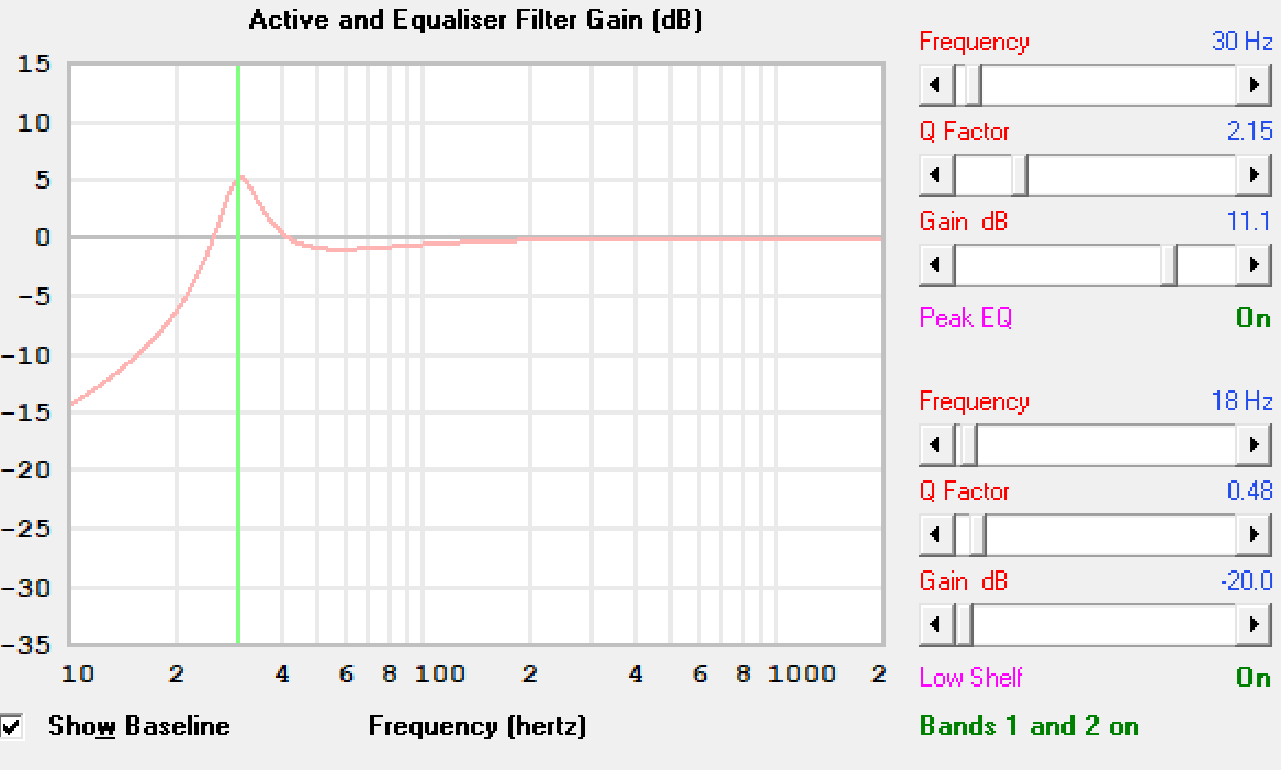

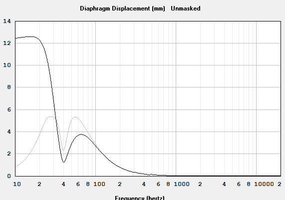

SW270 in 30 litres, Fb 30Hz:
Now Hornresp filter:
and resulting max output (xmax limit):

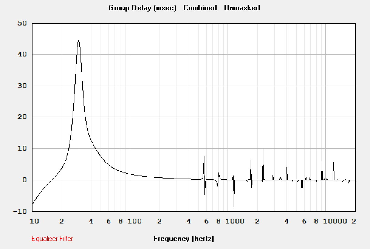

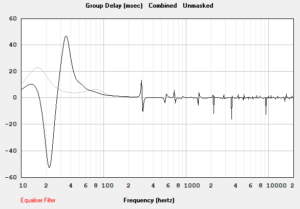

group delay: (@perrymarshall - too high right?)
The shelving filter does not lower the group delay, but it does allow for a higher max SPL because it limits power below fb where cone excursion is high. Actually, what struck me, but I did not have the time to re-read the Keele paper and compare it with the approach from Perry Marshall, was that the latter suggests to boost at fb. This might be related with the boost-dip function of the shelving filter. Keele suggested otherwise: boost above fb. This results in a quasi-lower Q of the port function, expanding its range. And the resulting group delay is less, as the boost is not doubling up at the tuning frequency of the port itself, but is rather a bit distributed.
Could be that my reasoning here is erroneous, because in my simulations, I have neglected the additional high pass suggested by Keele, because I found it to be unnecessary for my listening situation.

The shelving filter doesn't reduce group delay absolutely. It just creates a lot less group delay than a 24dB filter (half) and compared to a 30, 36, 48dB/octave standard high pass filter, it reduces it by 2/3 or 3/4ths.
48dB filters have a very audible amount of group delay. You can literally hear the "thump" of the bass drum arrive at a different date than the slap. Good song for testing this is Fear of a Blank Planet by Porcupine Tree.
When I did the math for the AX article, I found that immediately below Fb, you need to drop at least 14dB in the space of 1/2 octave, in order to ensure you're not wasting cone excursion on sub-band signals.
That's 28dB/octave so most people would just apply a 30dB/octave or steeper high pass filter.
But if you use a -16dB shelf filter with a Q of about 2, you get something like 20dB drop within that 1/2 octave... exactly what's necessary to get the job done and not a bit more. AND you get your +6dB boost at Fb as a free bonus. The filter below is perfect for a speaker with Fb = 68Hz.
Philosophically, in speaker design, I believe brute force backfires. Brute force is clumsy, not elegant. Shelf filters are elegant. Lots of DSPs have this exact shelf filter available, so it's super easy to execute.
@mark100 it's true that all identical curves have identical phase, but shelf filters have less phase shift because they level off at very low frequencies. So they're a different animal than standard High Pass.

@jzagaja the speaker building web tool just displays a result, it doesn't save woofer data or export data. You can do more sophisticated things with other tools.
Also @pelanj you could easily get away with tuning your system to 25 or 30Hz if you wanted to - just add mass to the passive radiator or length to your port, and adjust the EQ accordingly.

I did not trust my voltage-adjusted measuring mic REW results first, but as it is said that SPL measurements on iPhones are kind of reliable (due to the standardized mics used in each model), I could confirm these values and I listen at levels so low I would have never expected, as I always thought I was terrorizing my neighbors already, and probably do so. 55 to 65 dB average, 80 max/peaks for the latter, at 2.7 meters distance, which is too loud already/drunk listening/holiday fun.
I will buy me a cheap Ali Express A/C weighted SPL meter some time, but do not expect the previously tested listening levels to be wrong. You don't do yourself a favor if you build a system to specs that you would never use. What matters is how the system performs in relation to you listening habits.
