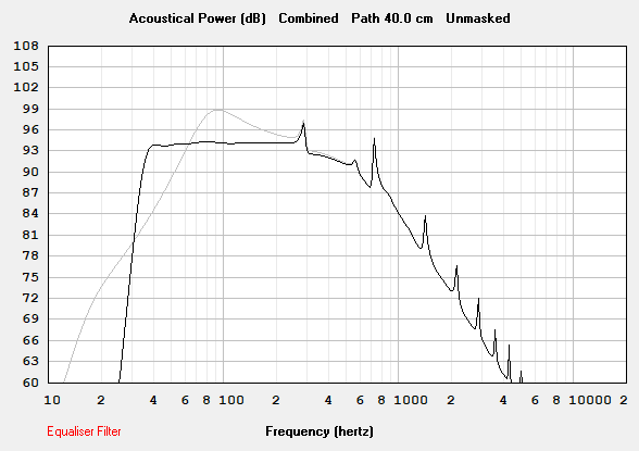

I see it this way - one (or two) shelf PEQ will make the box flat and protected from over excursion. The rest can be used for any other purpose. My goal here is to use a certain size box and get as much bass (down to 40 Hz) as possible from it. I already have a sealed 2x12 sub (also EQ'd), this 15" box is going to be a test bass unit for various large horns.
I discovered that Hornresp does have shelf filters as well (with wide range of settings) - and so does my t.racks 4x4 DSPmini - although limited to max Q=3 and min/max gain +- 12 dB. That means I will have to set the DSP by the measurement anyway, since it is showing a bit different filter response than Hornresp.
If this is what I get, then I will be super happy:

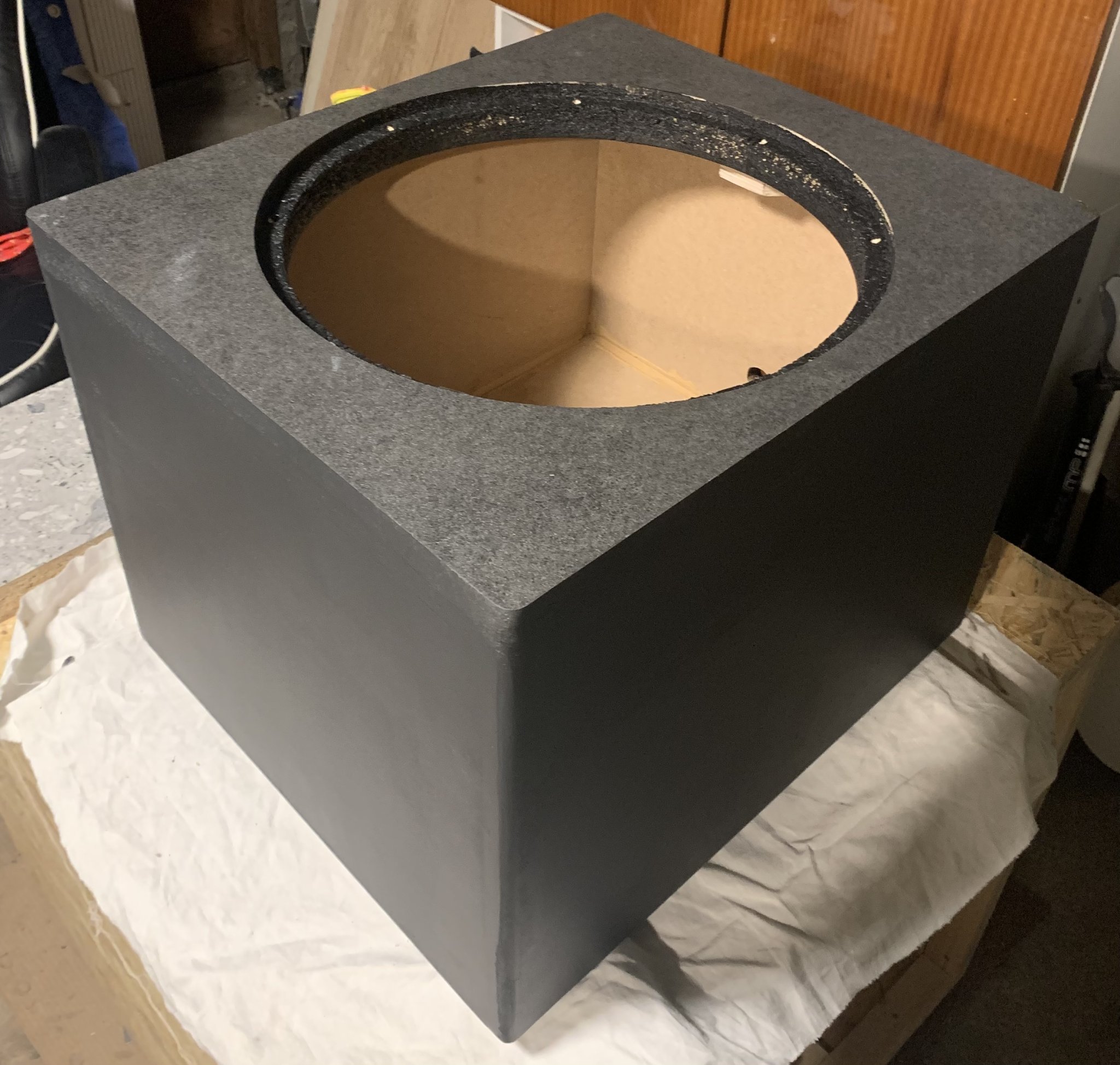

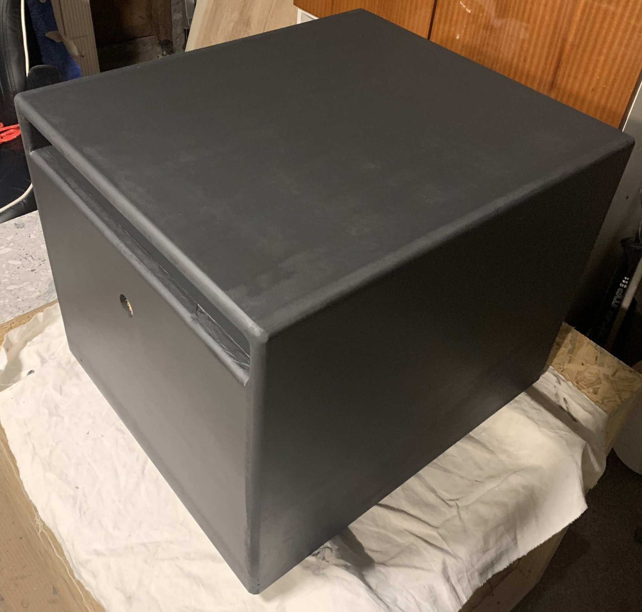

The test box is finished. The kitchen table top board looks better than I expected, I just used a random piece I bought as a discounted leftover piece. I want to do some quick and dirty measurements later today, maybe even some EQ so that it can work instead of the 2x12 sealed box I have there normally.

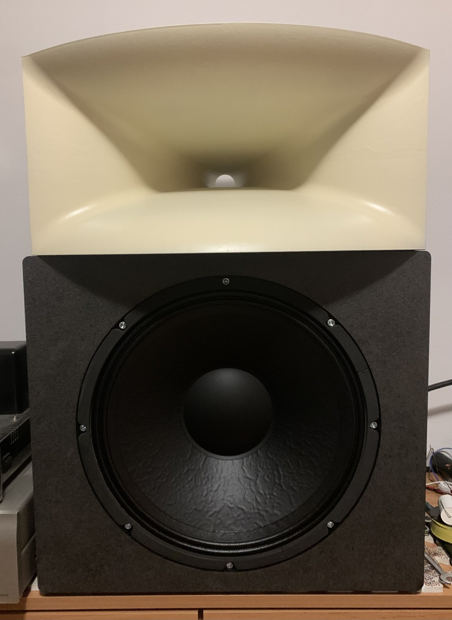

The WN400 horn prototype is waiting for the return of my DCX464 pair from the factory.

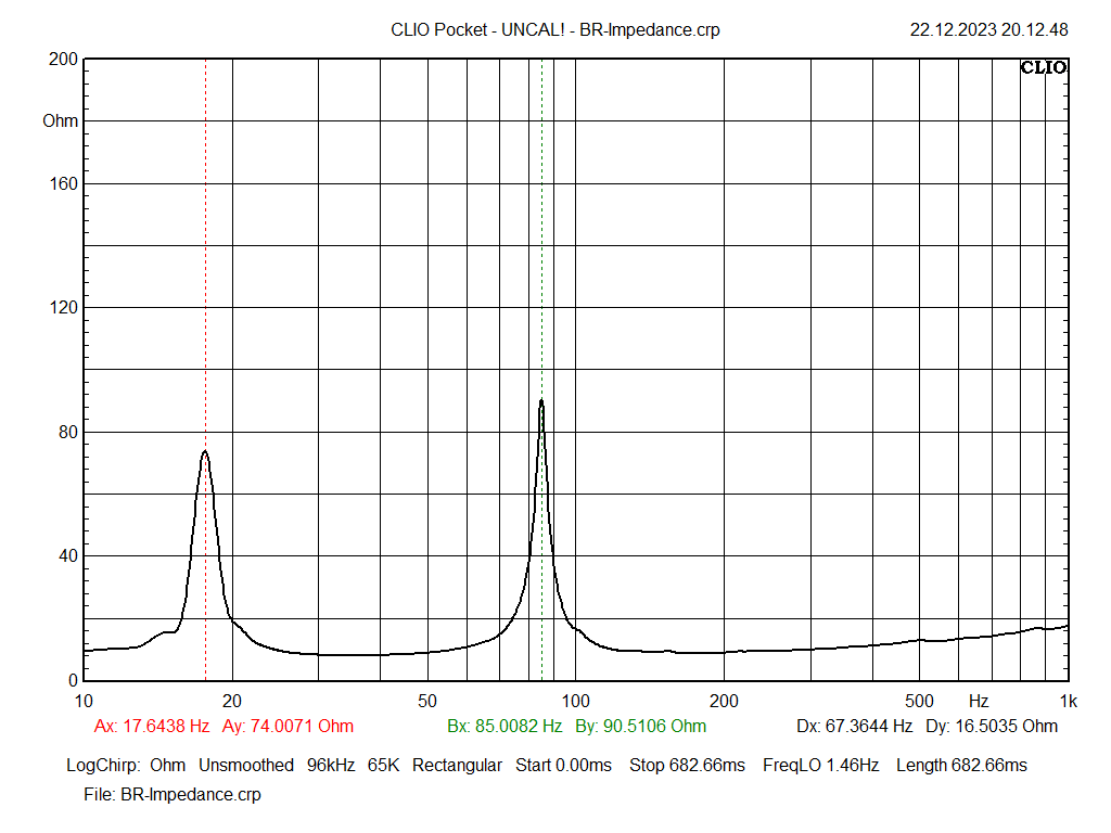

So this is the impedance plot. Can one calculate or read the tuning frequency from it? The absolute minimum between the peaks is at 35.9 Hz.
Hornresp calculated 40.8 Hz tuning, but I expected that the vent will be effectively a bit longer and it seems that it is like that. Also the woofer is new from the box, so it needs some burn-in, too. Hornresp predicts the first peak at 16.3 Hz and the second at 83.3 Hz, minimum is at 38.9 Hz.
I tried the shelf filter and listening to a few test tones, 36 Hz can be heard and felt, 30 Hz is already down. So far so good, it seems to be pretty similar to the sealed box subwoofer I had there (also with EQ). I need to find a way how to tune the DSP settings and then add some room correction / house curve to it.
