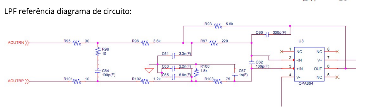

quick question - could i also use 12v for the opamp section on this dac or would this be too low? will be using dual opa827.
Yes you can +/- 12V is fine, that's what I used. Opamps need to be single channel one for each channel (L, R) if that is what you meant by dual.
Most opamps perform slightly better at +/-15V but the difference to +/-12V is usually very small.

The datasheet for the OPA827 shows 30mA (less at 12V) for output current and 4.8mA idle.

These only need a single channel opamp for each channel i.e. you can use one OPA827 per channel, do not use a dual opamp or make one with an adapter.

Yes the circuit is designed for a single channel opamp. It is not a good idea to use a dual channel opamp with one channel left floating. You can wire it so it is in unity gain config and then it should behave but why bother, just use a single channel as it was designed for.
This is the circuit from the link, see how it is a single channel opamp, there wouldn't be three pins not connected if it was a dual
![Screen Shot 2016-11-08 at 5.55.02 pm.png Screen Shot 2016-11-08 at 5.55.02 pm.png](https://www.diyaudio.com/community/data/attachments/541/541425-090fed4d1b87ad4e488e65a3017574fe.jpg)
There are a few single channel DIP8 opamps that will fit straight in, LME49710, OPA134, or NE5534 for a start use one of those.
