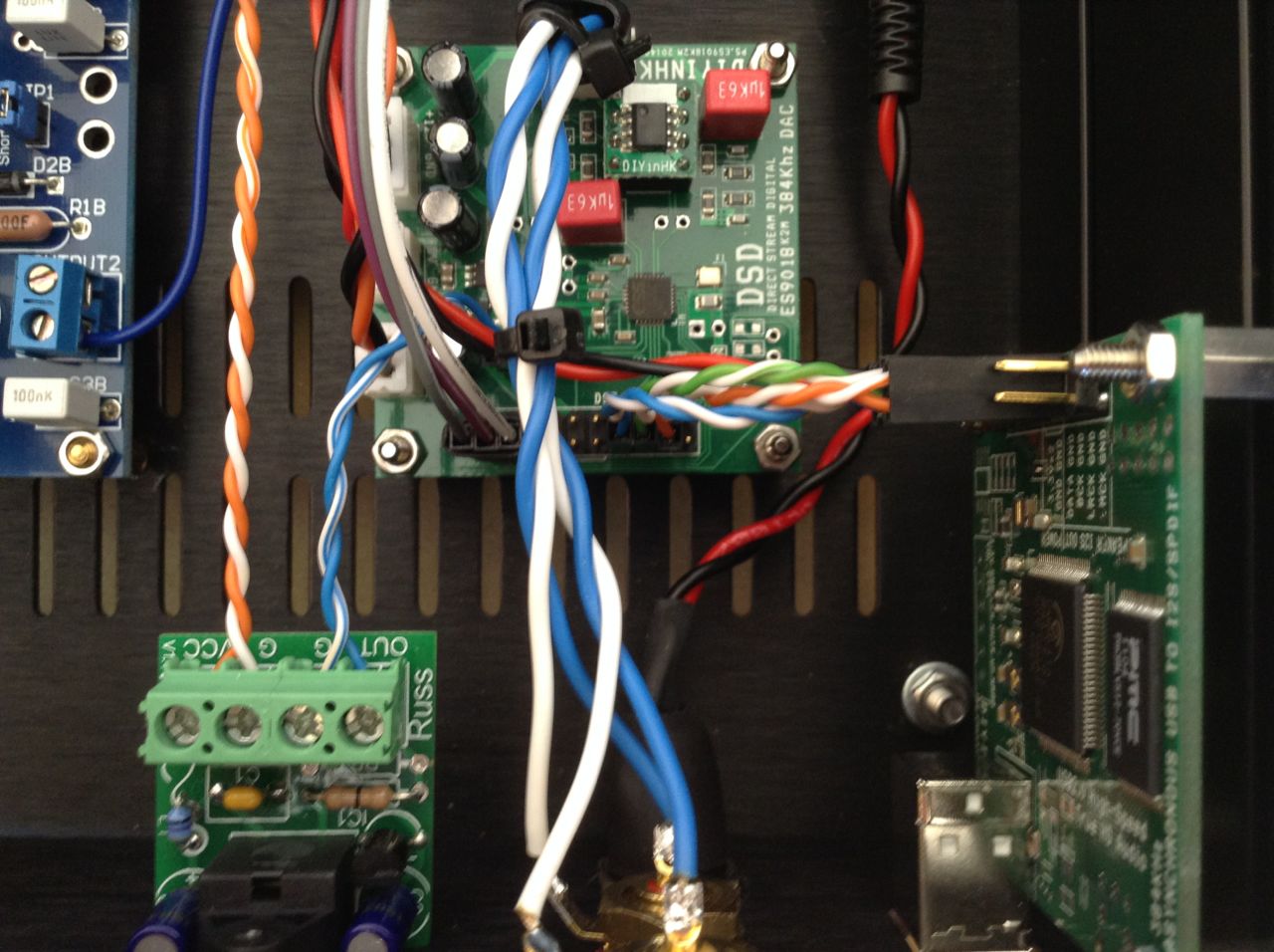

Online version of 4118 board from aliexpress successfully paired with diyinhk 4490 board. Mcu is working as well, volume and filter selection. Only thing a had to change on dac side was setting psn pin to H . Cad0 and cad1 left on default values.
Glad it worked for you!
If you have some spare cat5 cable it works very well for this type of connection and will avoid the possibility of a short in the long term.

Very nice. It seems on top of ak4118 you have an amanero instead of xmos. Is it correct?Online version of 4118 board from aliexpress successfully paired with diyinhk 4490 board. Mcu is working as well, volume and filter selection. Only thing a had to change on dac side was setting psn pin to H . Cad0 and cad1 left on default values.

right, it is amanero, initially I planed to go with waveio but decided for amanero because of easier mechanical installation.
I never had 4495 so can't compare it. Before this I used to listen same 4490 board in parallel mode without possibility to use all dac features such is volume control, dsd playback, optical input and filters, so this 4118 board was exactly what I was looking for last two years.
