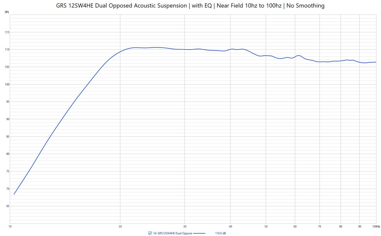

Good work, that's an awesome result down to 20Hz. Hiow much input signal dd that take to get up there? I mean your input data for boost in dB and signal input in W
2V, but that's near field. That's not at listening distance. It's noted in the heading, but just wanted to be clear. As for how I got the results, I cut away signal with the DSP and then raised the total signal level.

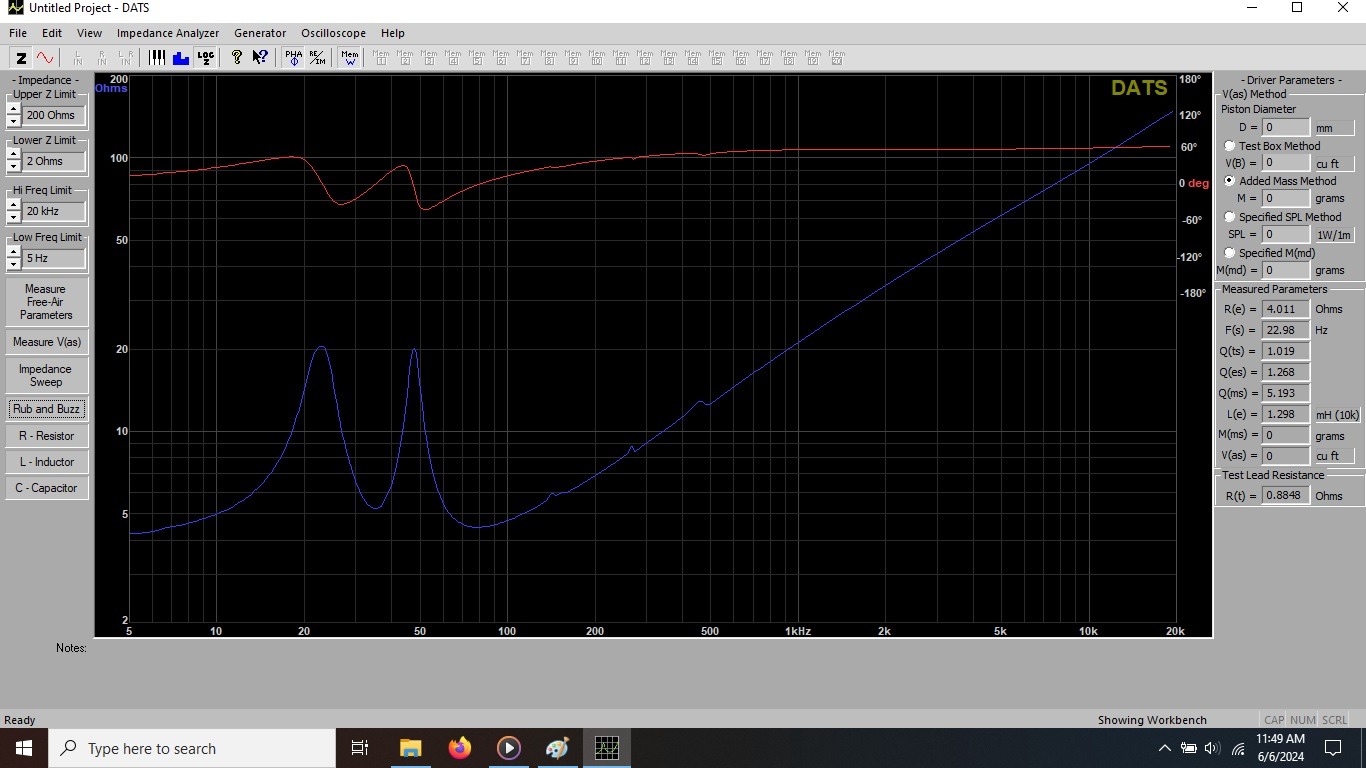

Unstuffed:
Both drivers wired together in series, 8 ohm (this was my intended design use, out of the options). This is unstuffed. I have two little ripples, around 142hz and 450hz. I noticed two of these before in the single driver measurements, but one went away.
The data sheet for the GRS 12SW-4HE shows a small bump in the impedance curve at about 470Hz or so. This corresponds to a peak in the SPL response between 400Hz and 500Hz. It appears that there is a strong cone vibration mode occurring that is also showing up in the impedance curve due to electrodynamic coupling effects.
Good eye, thanks, I wondered what it may have been!

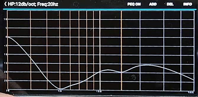

It looks like there was a lot of boost at 20 Hz — by 20dB or so relative to 100 Hz, judging by the curve shown below. That's to be expected, as the natural response of the compact closed-box loudspeaker system in question starts to roll off relatively early.

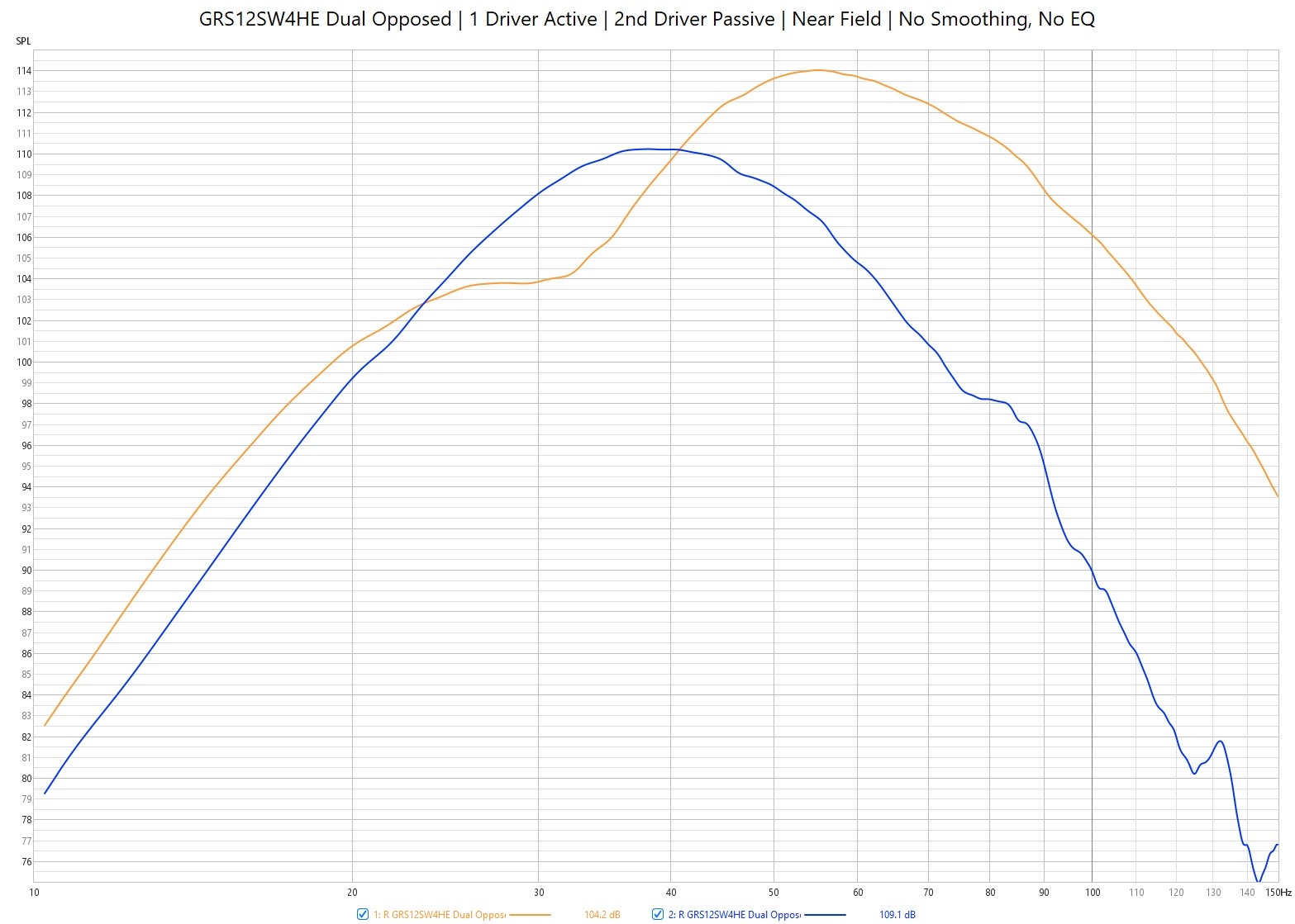

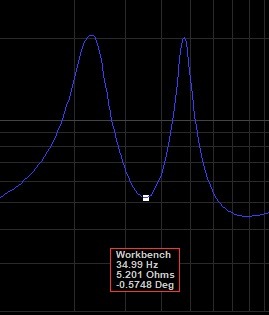

Here's the measurements when I did the single driver active and the other one passive, acting as a passive radiator:
So the Fb is ~36 Hz with one driver used as a PR.
The PR would be ~90 out of phase (lagging by 270 degrees) with the driver at Fb and more out of phase at your 30Hz vibration test frequency.
If you were to sweep upwards from 36Hz, you would find a frequency where the driver and PR excursion would be equal and in phase (lagging by 360 degrees), at that frequency the cabinet vibration would be the same (very little) as both drivers driven with the same polarity and excursion.

I just did a quick near field measurement with 1 driver active, 1 driver passive.
Red is active driver near field.
Blue is passive driver near field.
This measurement implies a tuning near 35hz. So, the measurement is close to this too, the near field active driver shows it immediately rolls off and shelves in the mid-30's hz range. Then, the blue line, the passive driver is humped up in the upper 30's hz range. Pretty neat to see it.
Note, I do have a physical low pass filter on that is dragging everything down above about 70~80hz range on the amp I'm using. But I don't care about the output up there, just to note it was active in this measurement. But no EQ otherwise.

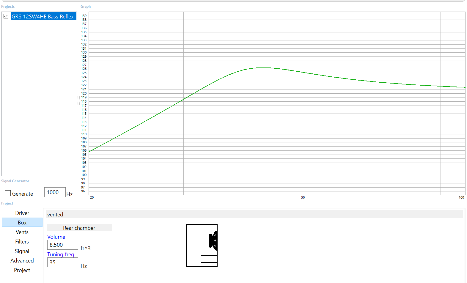

For bass reflex, it would depend on the tuning. The curve would likely be a slope unless you tuned high with so many drivers in such a small volume relative to what a bass reflex would require for most drivers. These drivers are ok in about 1.2~2 ft^3 each, but their measured Qts is much higher so they do better in more volume in reality and 8 ft^3 would be small (for these GRS drivers).
If you want the most output possible to 40hz, then ported will get you there.

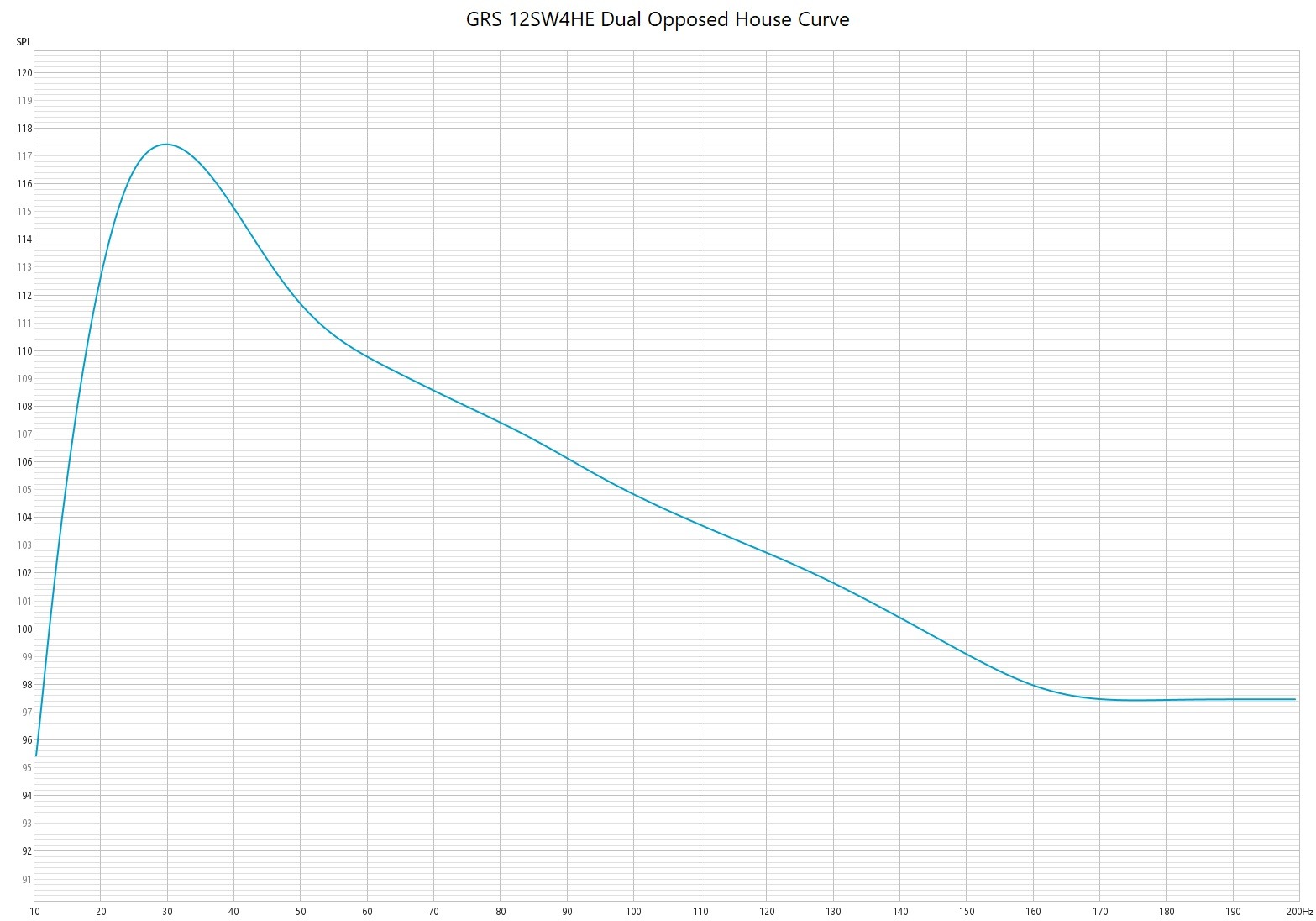

I went sealed for music, because I can shape it however I want with EQ.
For example, here's my current house curve on this dual opposed 12 that I run. It's near field, plenty of output, and I focused on 30hz output. That's the beauty of multiple drivers, shared xmax, more power handling. You can EQ them with more latitude. I prefer this for music. I can change it without worry. If I want to get 20hz output, I can. If I did bass reflex and tuned higher like 30~40hz, then it wouldn't have 20hz output. So I like having the options and I didn't need max SPL output. If you want max SPL output to 40hz though, yes, bass reflex.

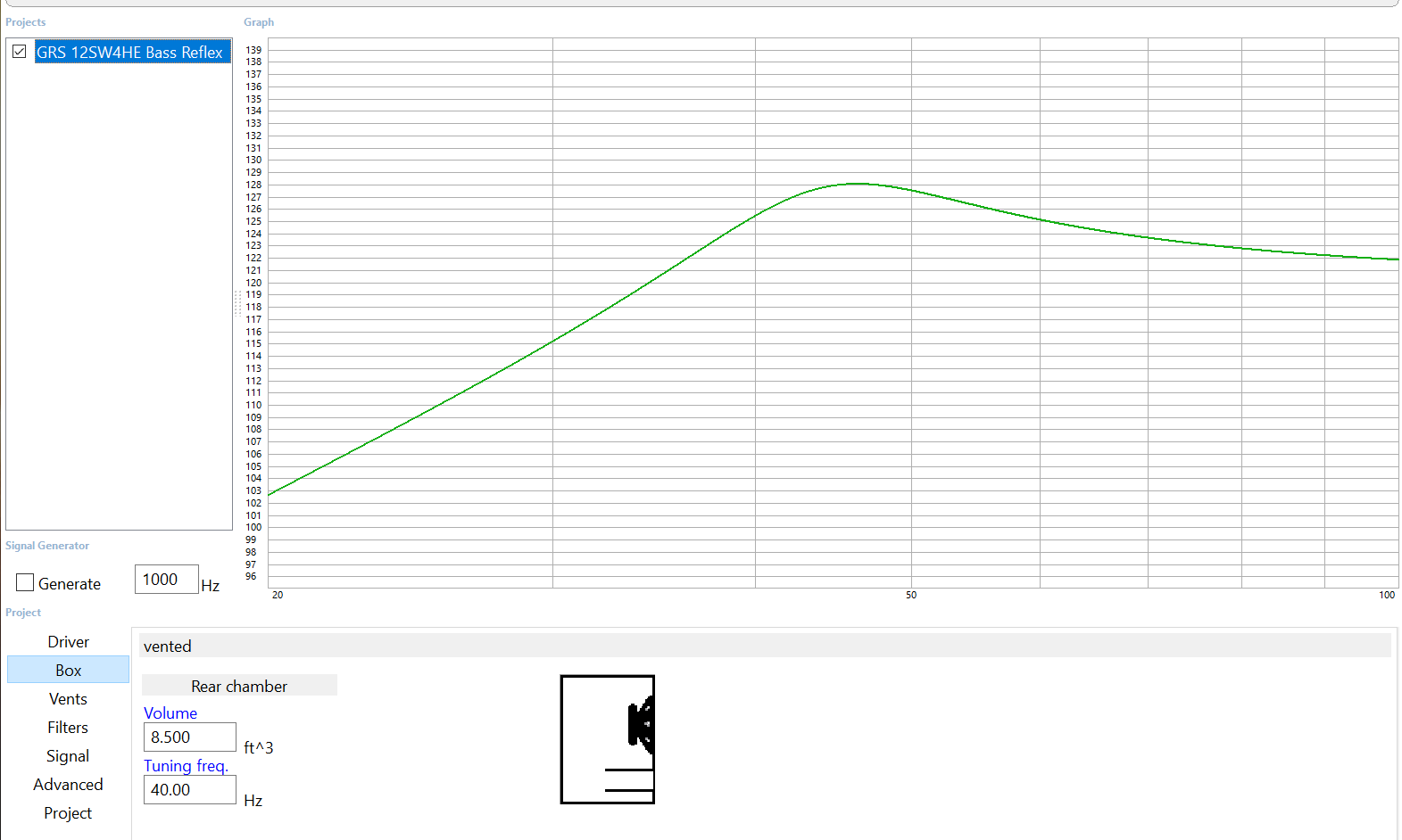

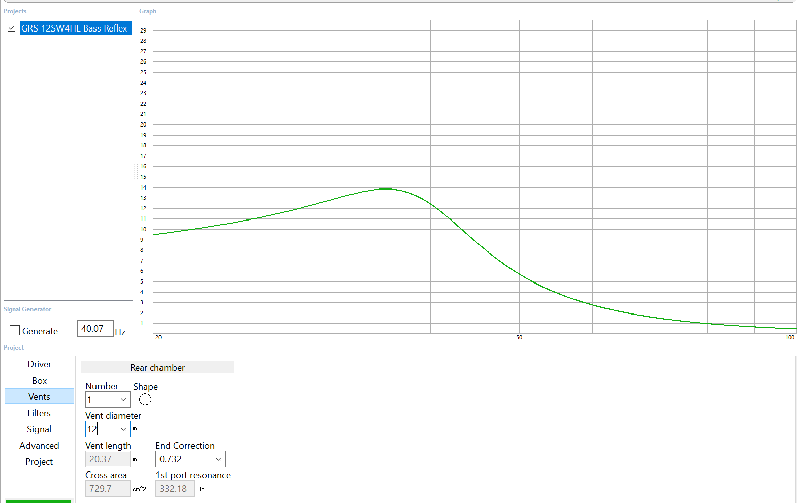

Here's simulation of GRS 12 SW4HE x 4 in a 8.5 ft^3 tuned at 40hz bass reflex with 1000w of power. See how the peak is before 40hz? It would be better if we port tuned at 30hz or 35hz, but this will result in a larger, longer port.
But the response curve at 35hz is so much better I think:

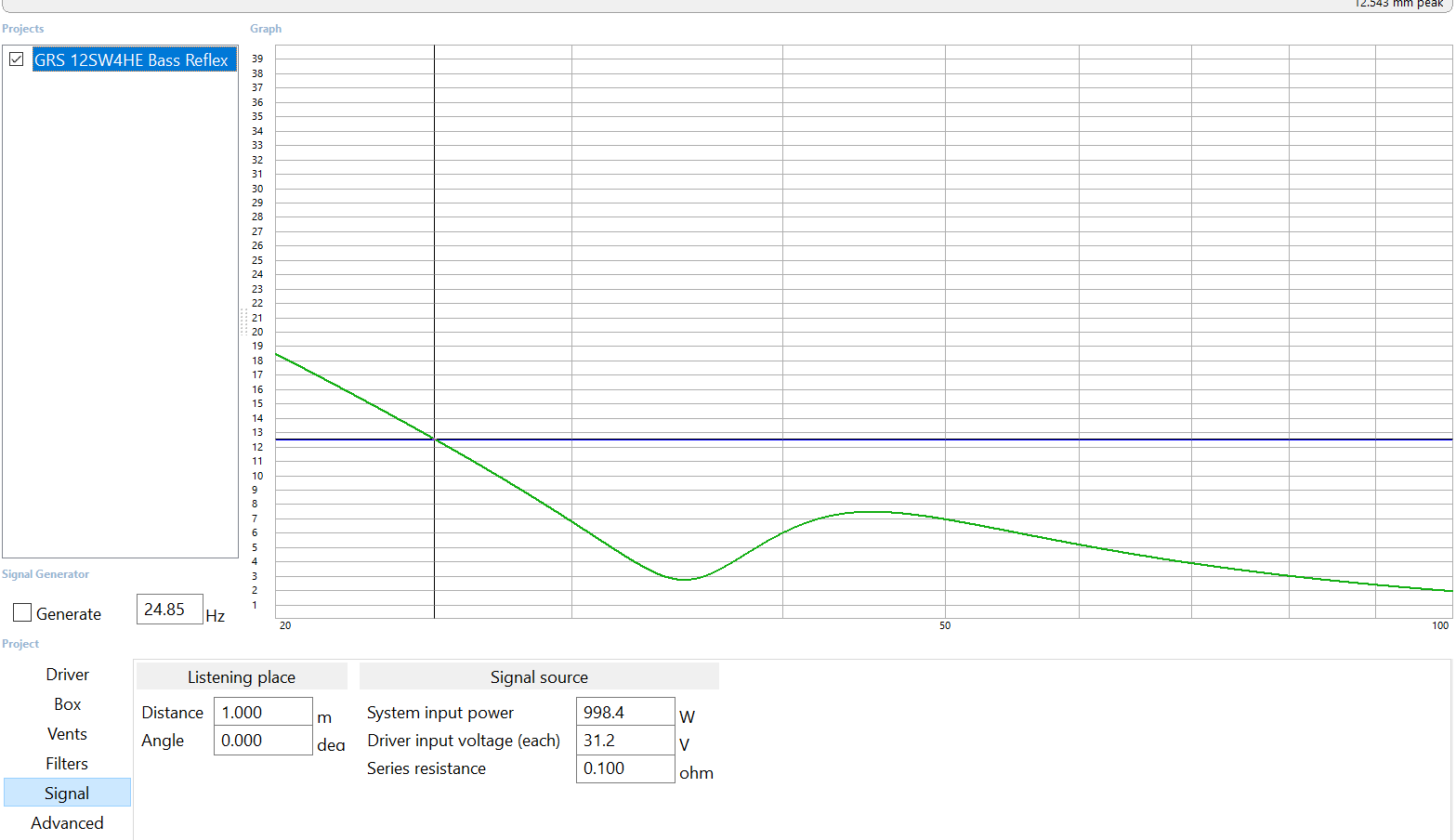

Excursion is good to 25hz without a high pass filter needed. So for music, this is probably fine.

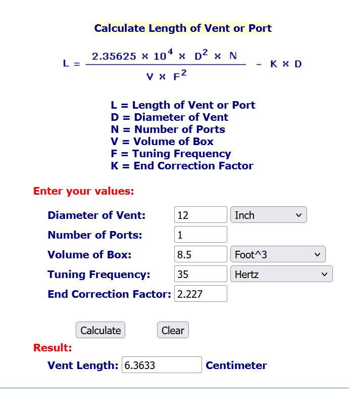

A slot port will do this easiest to get enough surface area and its length is short. I like how 12" diameter looks for air velocity here and the length. This is impractical as a pipe but as a slot port it would be easy.
Let's convert to a slot with end correction 2.227:
So maintain 12" area, which is 113.1 square inches in any slot dimensions you want, with a 6.4cm or 2.5 inch length and you get 35hz tuning in that volume. Easy port for an enclosure like this, low air velocity, clean for music, no chuffing or noise at all at max power. And it doesn't eat up a huge volume to make this.

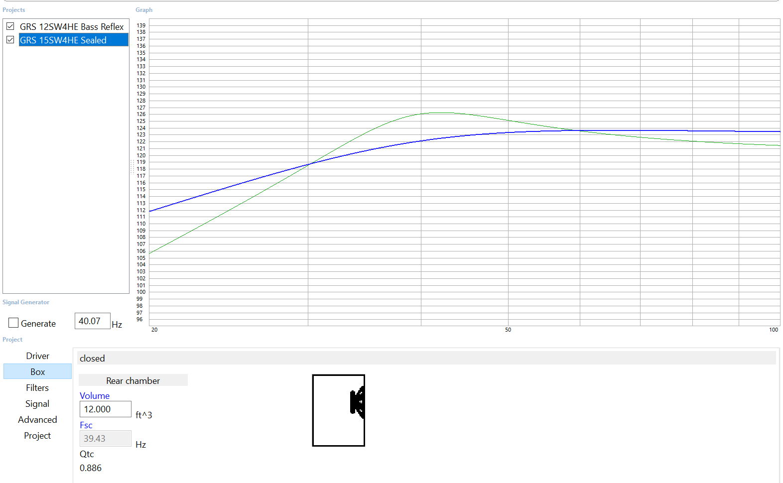

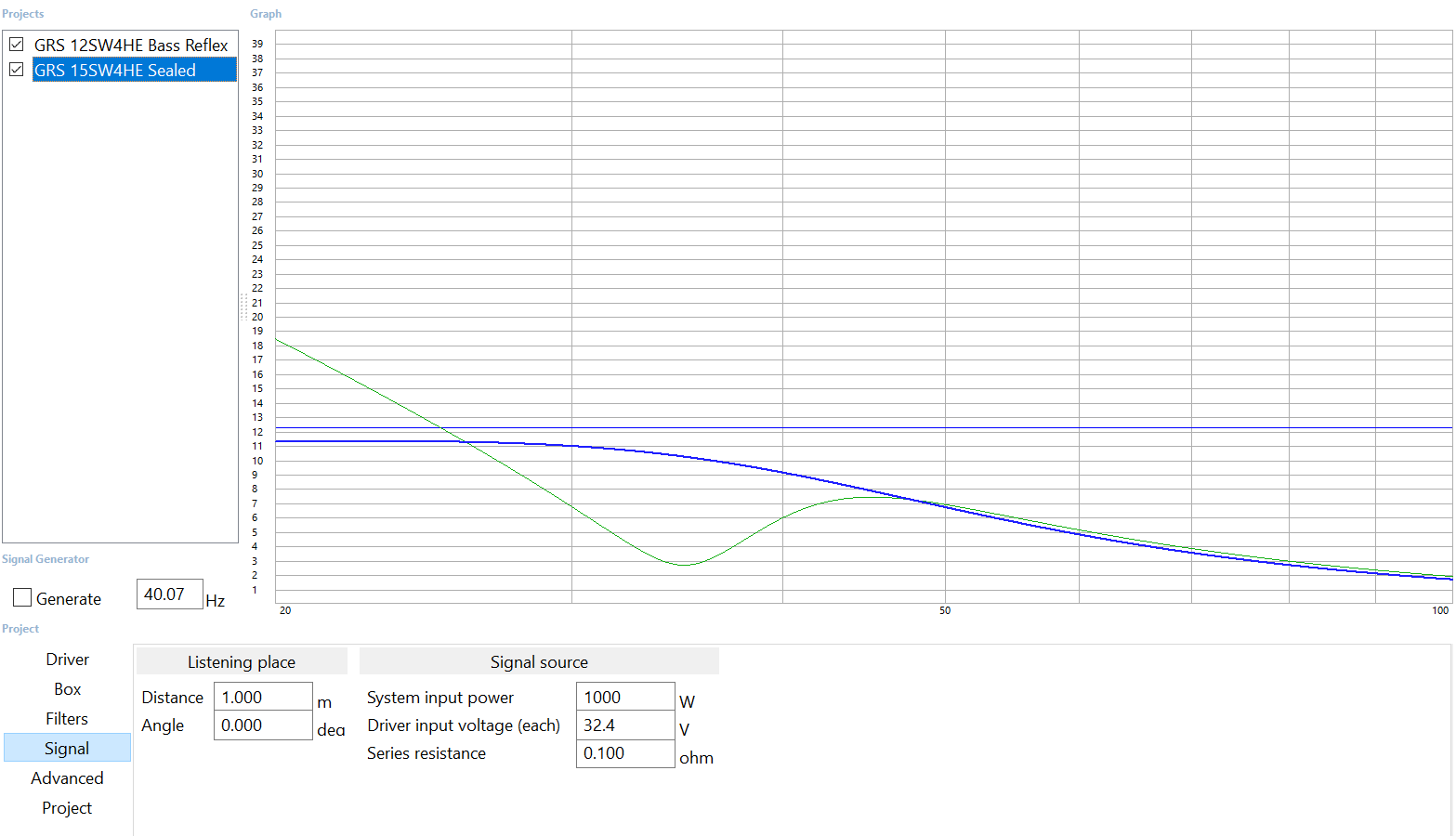

That said, look at this:
The GRS 15SW4HE is on sale for $96 each currently. Four of them in a sealed tower in dual opposed configuration (2 front, 2 rear) in about 12 ft^3 volume with 1000w of power at 4ohm gives a nice response with a lot of output:
GRS 15SW4HE x 4
12 ft^3 sealed (dual opposed configuration)
1000w at 4 ohm
1 meter
I would build this over a bass reflex for music. Yea, its bigger. But full bandwidth and no port to fuss with. EQ to your heart's whim.
