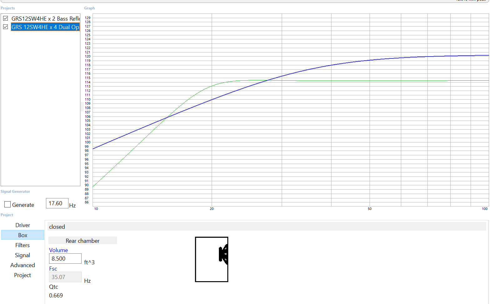

Here's what a tower of 4 x GRS12 drivers in dual opposed, sealed, looks like at 1000w:
GRS 12SW4HE x 4
8.5 ft^3 sealed
1000w at 4ohm
1 meter

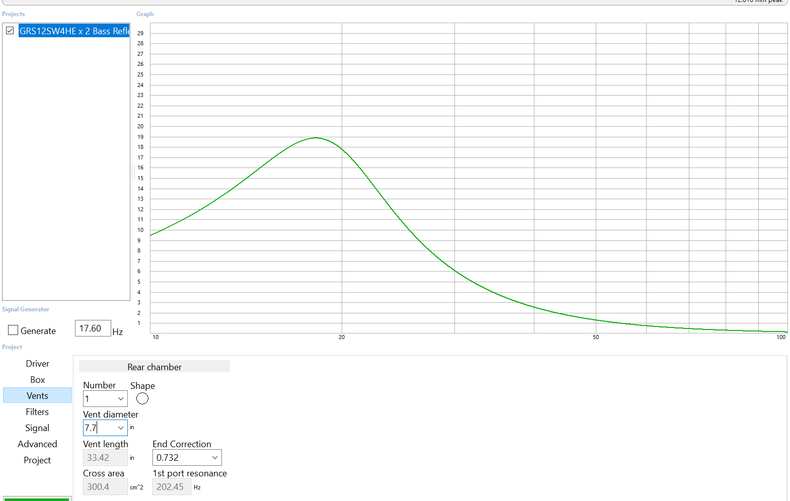

But, let's look at bass reflex again just for fun:

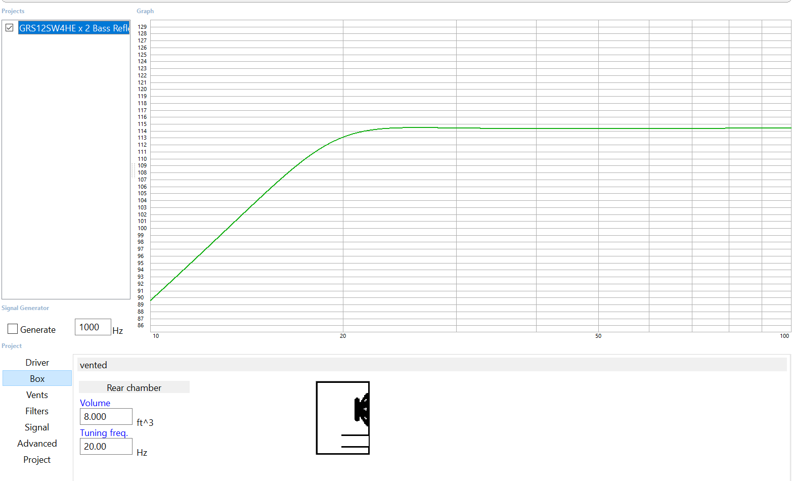

You wouldn't need 8 drivers for bass reflex. You could do 2 drivers dual opposed bass reflex and tune to 20hz no problem. Two towers with 2 drivers each.
For example (just one tower):
GRS 12SW4HE x 2 in Dual Opposed
Bass Reflex 8 ft^3 net internal volume
Port 20hz
500w power
1 meter

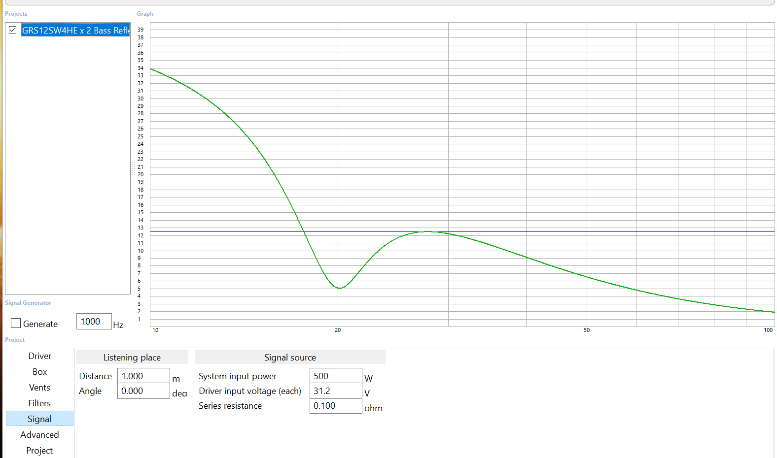

The 2nd tower adds +6db to this bandwidth.
Excursion is good to 17hz. High pass filter needed under 17hz unless you have no content happening under 17hz then you could get away with not using one. Or if your amp has one built in, that will already do it. Though with less finesse on control.

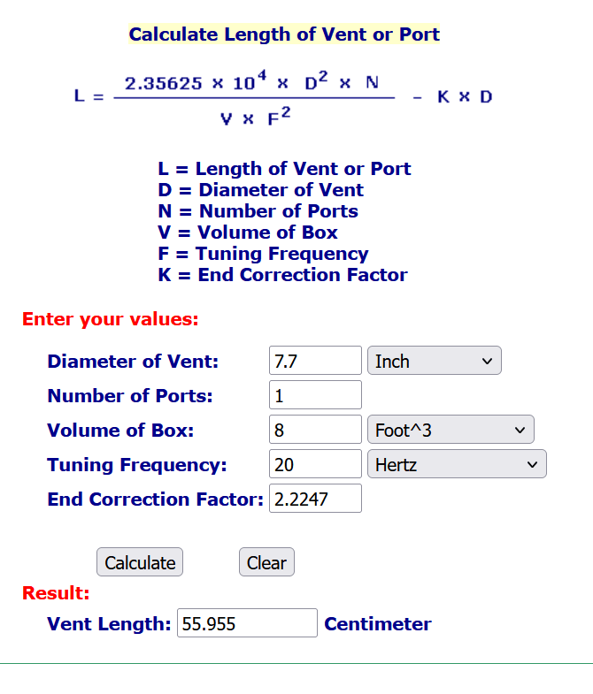

Air velocity looks good less than 18m/s at 20hz with a 7.7" diameter port at 33.4" length. Lets convert to a slot port.
Converting to a slot port:
So maintain 7.7" diameter area = 46.6 square inches area as any size slot dimension and the length of 55.95cm (56cm) which is 22" length and you have that 20hz tuning in that volume.

Four [15SW4HE] in a sealed tower in dual opposed configuration (2 front, 2 rear) in about 12 ft^3 volume with 1000w of power at 4ohm gives a nice response with a lot of output:

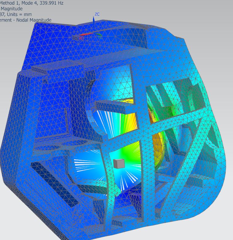

I would add some comments about vibration measurements. I am a vibration engineer that deal with vibration measurements and makes daily FEM calculations.
Usually the best is to plot velocity (mm/s). Acceleration plot is mostly used at higher frequency (above about 500Hz and used to check the limit for the electronic device, typically 5g limit). My suggestion is to drive the speaker with White noise up to 1kHz, to record the time signal and then to make the FFT of it in order to check the spectra. If you drive the system with a single tone (30 Hz) is not the best in my opinion. The reason is that basically it cut out all the box resonance that are located above 200 Hz roughly for a standard box . Please check below the a model of a dual opposite sub box a made time ago, the same of the picture a insert in my previous post. Half model shown (symmetrical). Speaker modelled by mean of rigid links + lumped mass, for who is familiar with FEA nomenclature. In that case the first resonance was at 339Hz. What happens below the first mode is just a forced response, but is a good idea to check what happen when the system is in resonance ( exciting frequency = natural frequencies of the model)
It would be great to have your experience and equipment for sure!
Do you think that matters in a system that has a limited bandwidth that doesn't ever have output at 200hz, nor 1khz? This particular system is being limited to 10hz~100hz bandwidth via DSP. I would think it would make sense to measure vibration such as velocity and acceleration in its working bandwidth?

If the bandwidth is limited up to 200 hz it is ok to stop the input signal at the same frequency, but......because of Nyquist quote "The Nyquist theorem defines the minimum sample rate for the highest frequency that you want to measure. The Nyquist rate is 2x the given frequency to be measured accurately". So please sample rates highest frequency at minimum 400Hz. Also the blue tac you are using for attaching the accelerometer has a powerful filtering effect, so everything above about 500hz is cutted out. For professional business is used wax for fast fastening, otherwise is screwed.
By the way, is better to use white noise excitation, (standard is 20-20khz, constant power over the frequency range) and then limit the post processing analysis (FFT) to 200hz than simply use a single tone at 30hz. In this way the vibration output is an rms value that takes in account everything in the operating range. The value is more significant than a single frequency
Excellent thanks, I will implement this.
