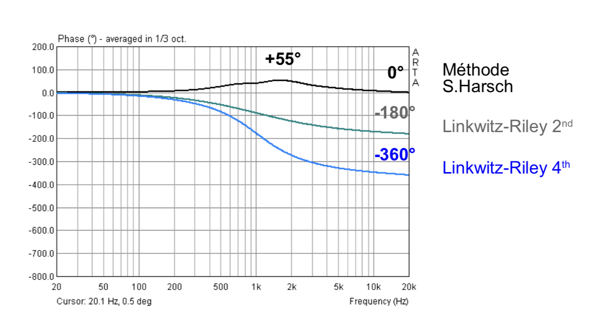

Is it really forward, considering the phase wraps over and over now?
1st order crossover is flat phase, Harsch has a 55deg bump, and LR has inverted polarity tweeters in order not to have cancellation dip.
He would have been 100% against 2nd-order or higher crossovers and ported enclosures for sure.Dunlavy would have hated that idea of "moving forward".
