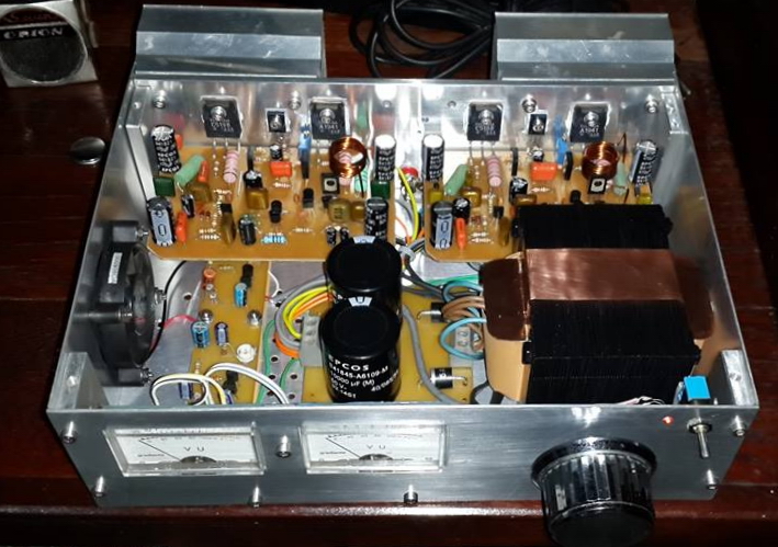

REAL diy AMP!
TIME is not my friend lately , I"d like to make something like that housig you post!
Nice , regards,
Dear Cook77 and Vrystaat, the one build was not me, was Mr. Silveira
from Brazil..... he asked me to remove because he made bad recording and this will harm the brand as audio quality is not fine.
I will ask moderators to remove these videos and Mr. Silveira will make new ones soon....of course i gonna publish them here.
Was not me the builder..i am showing something a friend did with my amplifier circuit but i gonna search for the circuit he used to the meters...i suppose was some germanium diodes or silicon diodes as rectifiers.... some nanofarads as filters and a resistor...not more than that...but i will ask the guy the schematic to post here...the meter driver schematic.
Thank you all by the understanding..will ask moderator to remove these videos...was the video owner that asked me as he perceive it is a shame the audio quality in the recording..he gonna try to make it better..less level, more absortion material around...better light, flat recording without tone controls...well...he will manage to make better audio recording.

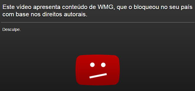

I cannot see it Bagus.... it is blocked to my country due to copyright.

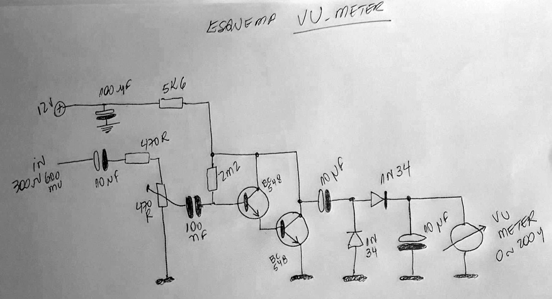

A friend asked me the VU Meter schematic.... so, dear Cook77 and Vrystaat.
Here you have it.
Capacitor in parallel with the meter will make it move more "average" like..gonna slow down the movement....may hold for a while.

This amplifier you see, the enclosure and pre amplifier is a Brazilian Quasar made from 1980 to 1988...inside there are Dx Super A modules and also a Dx Supply.... original Quasar pré amplifier is beeing used.... TL071 based circuits...tone control and filters.
