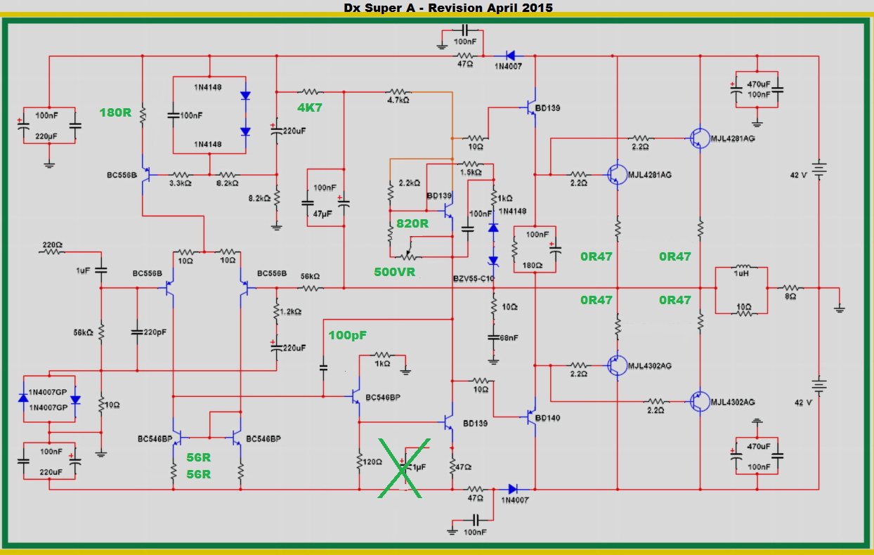

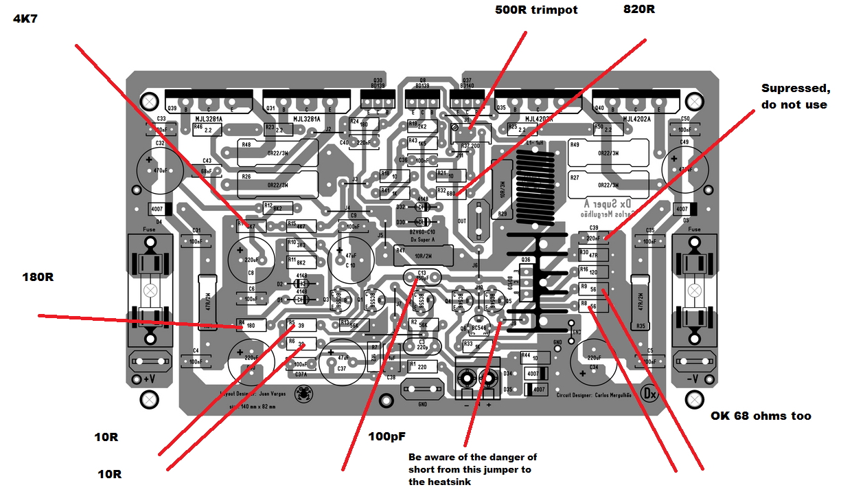

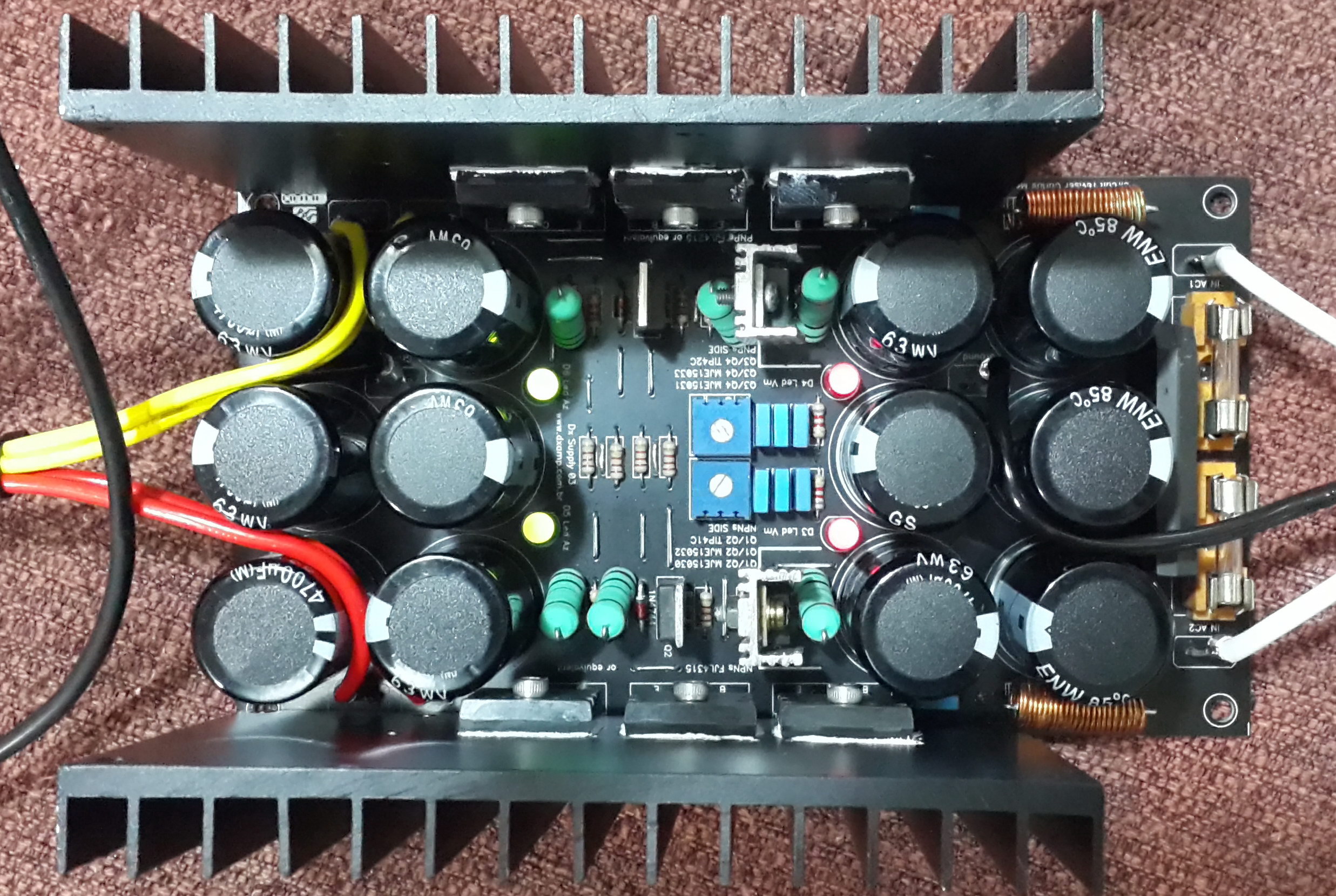

Dx Blame ST together Dx Super A
I forgot 10 ohms resistors into differential amplifier emitters
This is not the value printed into your pcboard...so..... Bill of Material fixed.
I know the value is strange..but this is what i found as the best option there...yep... 10 ohms...unusual....but use this value.
The ones dislike the heat, or cannot use this way due to small heatsinks...bad cooling or inner case heatsinks, then disconnect diode 1N4148 and adjust current to 90 mA each rail
regards,
Carlos
  • Dx Super A atualizado Abril 2015.zip

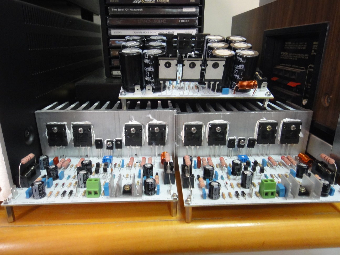

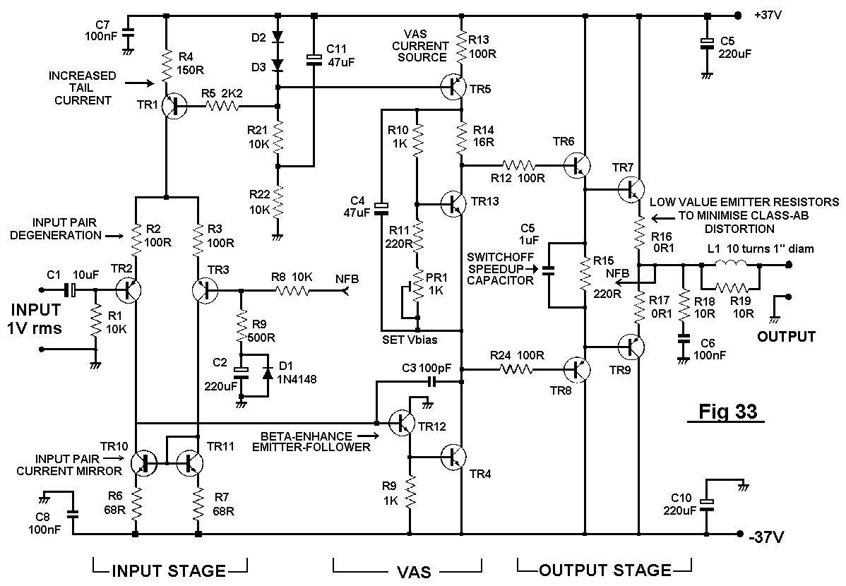

Blameless is awesome...but we made it even better
Observe that we are using higher input impedance....this reduces the input capacitor value and as a result we does not have this capacitor though 10K resistor filtering high frequencies that are sent to ground.
Higher impedance is interesting too, as people may want to use it direct to audio sources...and you find more 47K than 10K impedance in the line out from audio sources.
Our degenerative are better selected... resulted better anyway.
Input differential current reduced to better results.
The use of wonderfull bootstrap to feed VAS.
We do not have annoying C4 that bothers a lot when you have to adjust iddle current.
Our Super enhanced VAS results better too.
We are using better stop resistors to drivers.
Also using stop resistors to power units and these are absent in the concept
Rail filters included.... diodes, resistors and capacitors are there to help us to avoid variations from the power supply...not producing better PSSR but avoiding to loose too much compared to concept design CCS.
Power emiitter resistors tuned to better performance and two pair used in order to reduce, even more, the distortion
You see...it is a Blameless..no one can dennie...was based into Blameless...was developed from Blameless... this was the reference, the source of inspiration...the frame, the topology was copied..then was tested and tuned the most we could.
It is a Blameless...but play both, same level, same song, same speaker..and tell me the one has your preference.
Collect high quality musics...songs in FLAC or other high quality encoding.... or copy songs played by JBL speakers at Henrick speakers in Japan... play it using Dx Blame ST and tell me if you are not in heaven..... i do think you will not even remember me as you will be in paradise and will forget mankind.
regards,
Carlos

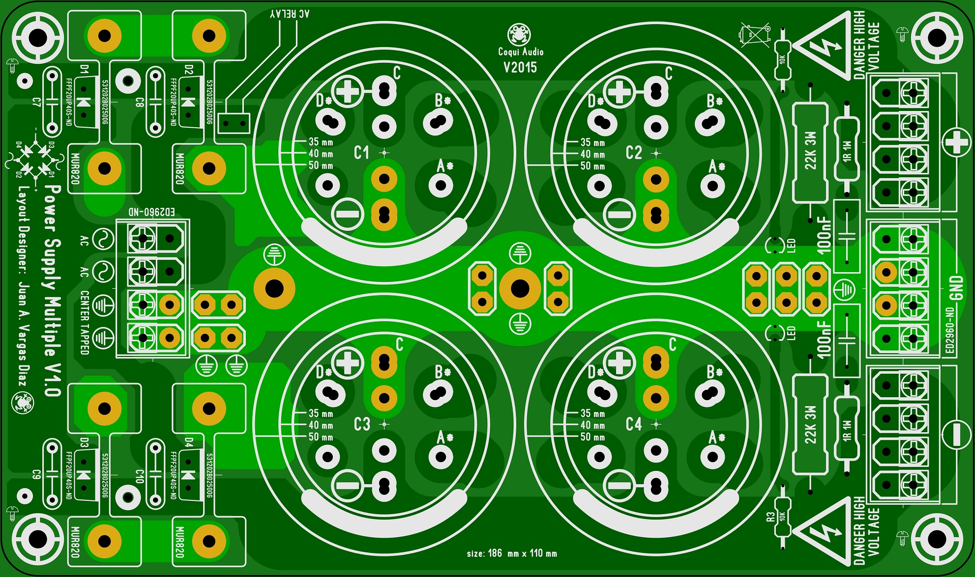

I'm goin to make a simple power supply that can have up to 44000uF here is the design image:
this PCB can accommodate larger size caps from 25 mm up to 50 mm in diameter I found that they are caps that have a value of 22000uF part number
V382LX223M080B062VS, the diodes are FFPF20UP40S-ND 400V 20A I think looks great 🙂 I'm not an expert but I always try my best 😀
Regards
Juan
Good...but be sure 44000 is no match to the Dx Supply anyway
But is always a very good idea too.

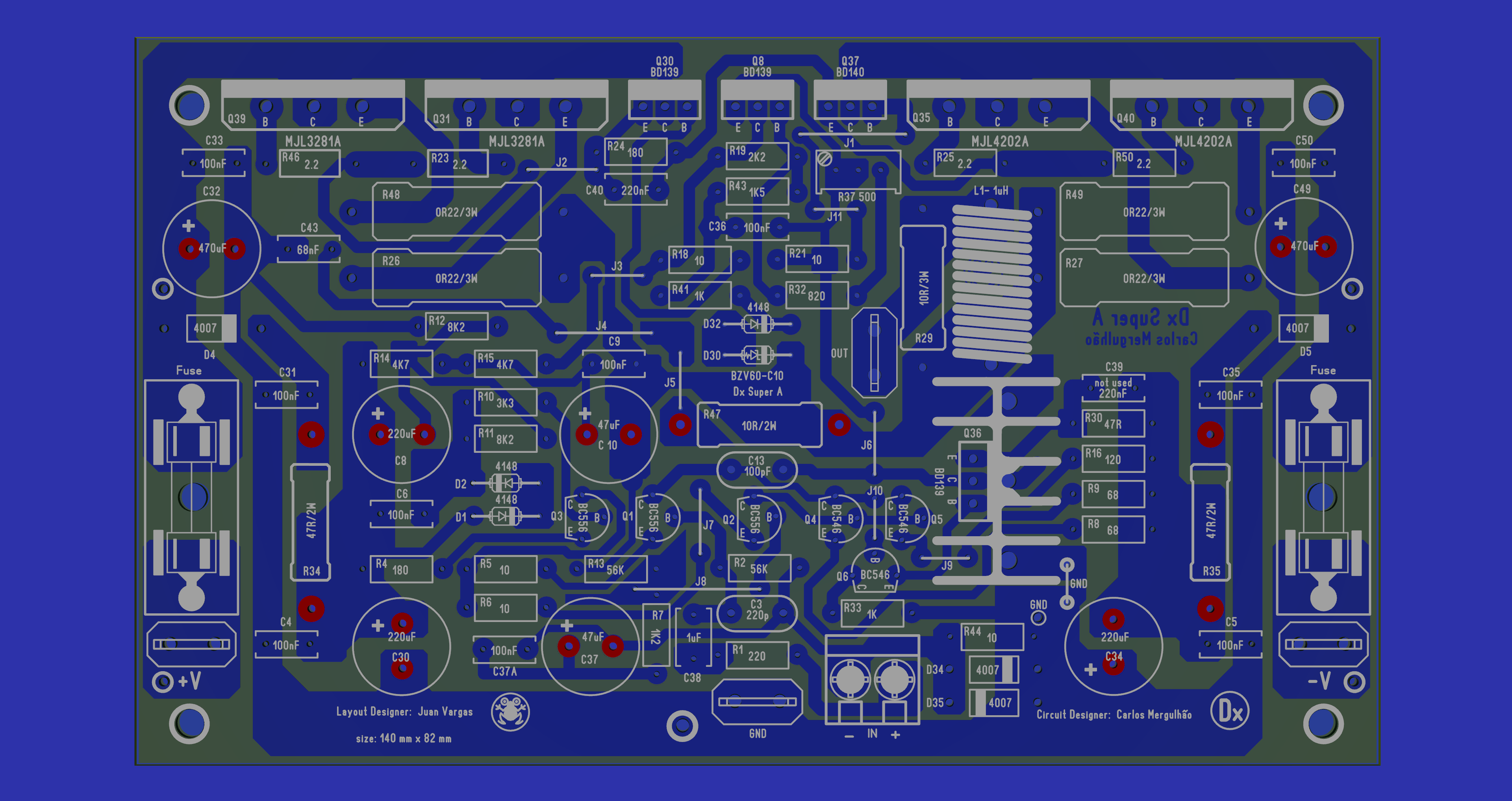

is cool Carlos don't worried man I like to share ideas even if they are good or not for others, is ok, no everyone think the same way 😀
here is the image of the Dx Super A with updated silkscreen :idea:
Regards
Juan

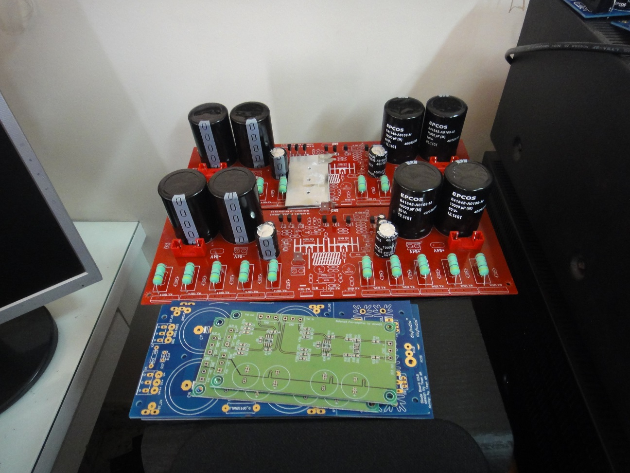

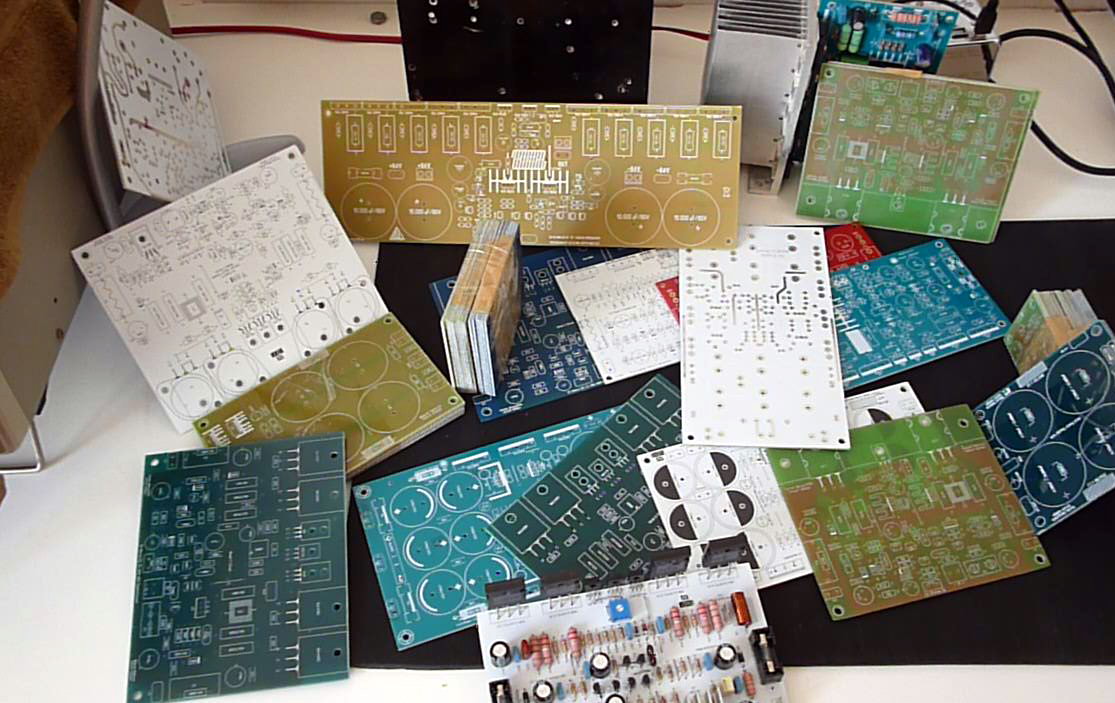

The one can sell pcboards to the international people is Juan Vargas
Fábio Zimmer, from Brazil, is the one sells pcboards to Brazil.
Here you see him...his grandfather was a German that scaped from WWII
He born in South of Brazil...a nice guy..with beautiful blonde daughters.
You can see his Black pcboards,
regards,
Carlos

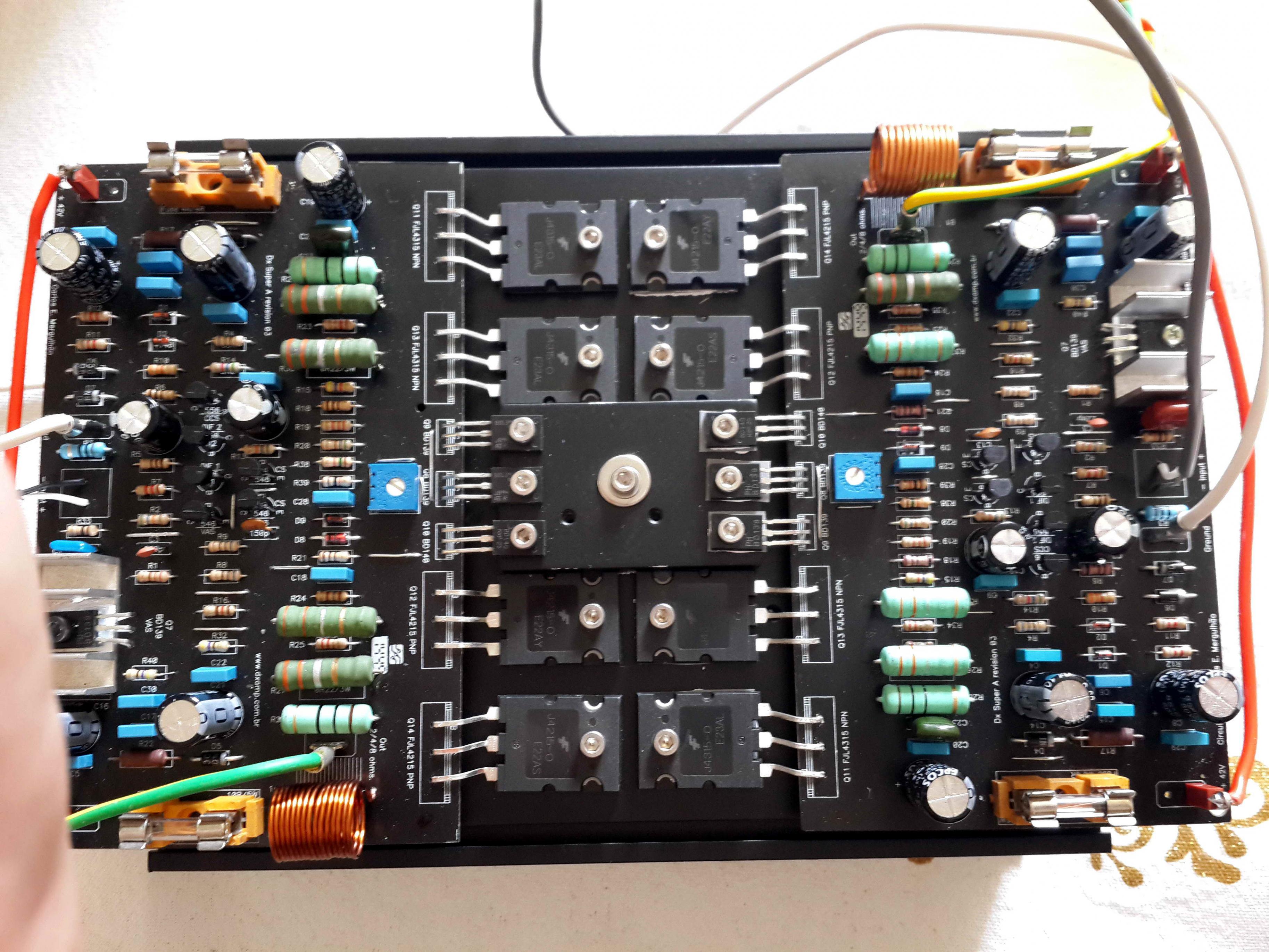

I am still creating amplifiers...this one under construction is GOT
It is an union of vintage high level of quality power amplifiers.
One from Marantz and other from Sansui.
Having fun... this one 40% assembled.
It uses dual differential, one with 2SK170 and other using BJT ... dual voltage amplifier stages, both darlington and feeded by CCS (2)... input is controlled by Voltage regulators (2), tripple darlington in the output, complementary darlington and different feedback used....it looks alike Sansui G7000 but has some difference because of Marantz influence.
These two differential are not complementary, they are dual differential stages, one following the other.
regards,
Carlos

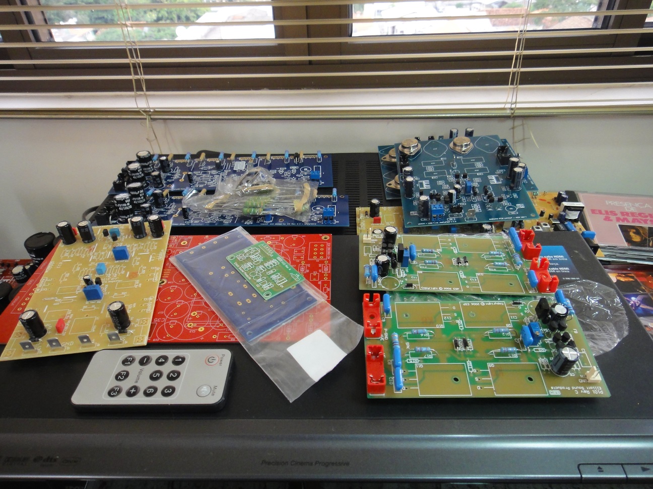

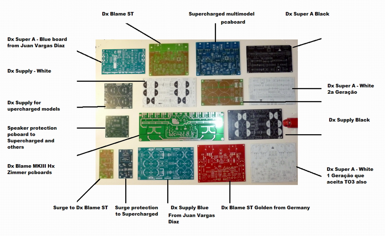

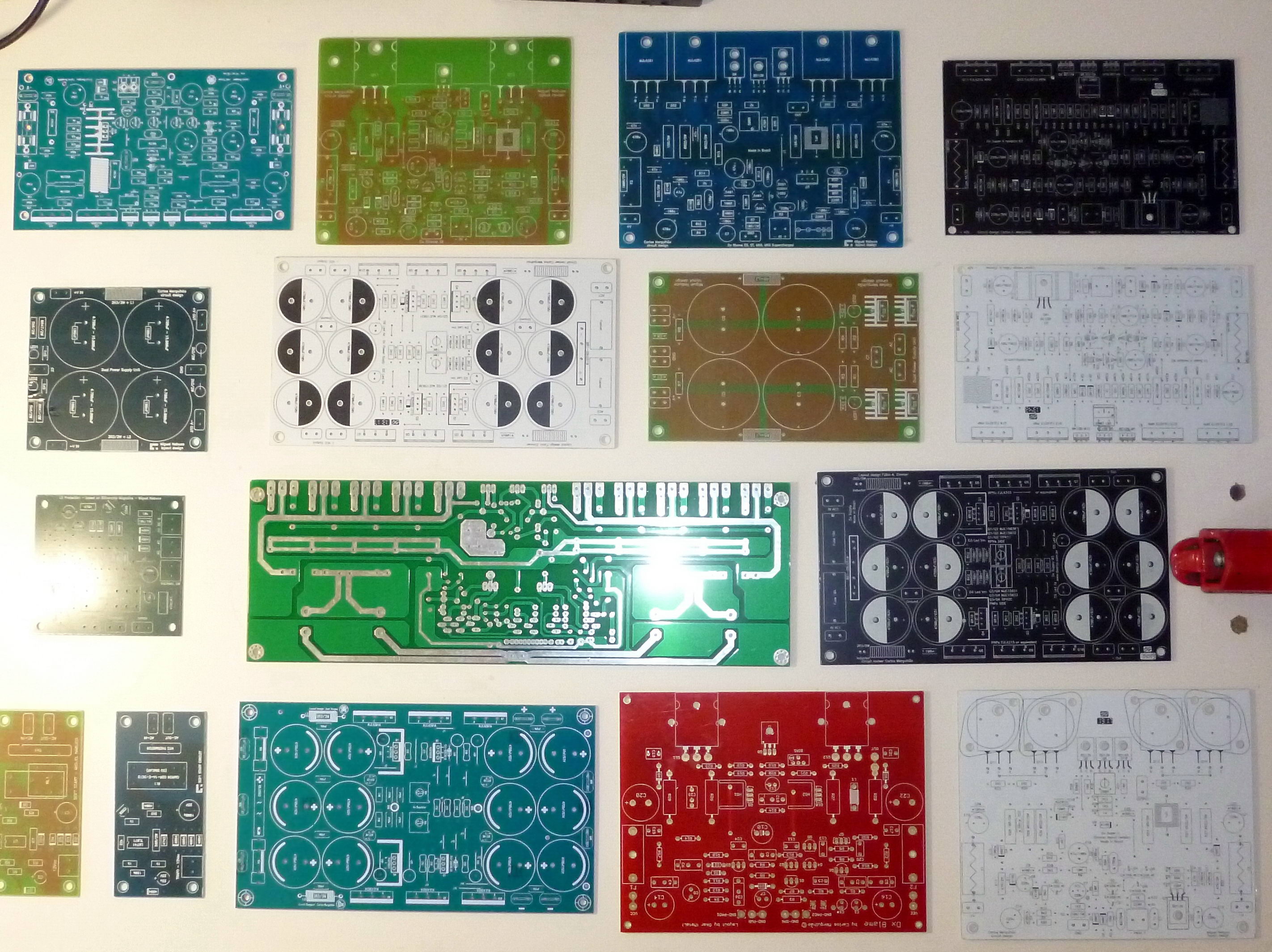

Celebrating more than thousand stereo amplifiers shipped inside and outside Brazil
Those the ones made in Brazil added to Juan Vargas Diaz production (almost all sold from second batch)
Not counting pirates in Brazil and China....there more 1000 units maybe..but these not produced by us.
Well...i am happy and celebrating.
Others have assembled etching their own pcboards..... and the ammount is also very big.
I am keeping, at least, one unit of each one produced... these amplifiers, all them published in DIY audio...there are others not published, but these ones have distributed few units.... dozen maybe because hi End and very expensive customized units.
regards,
Carlos
