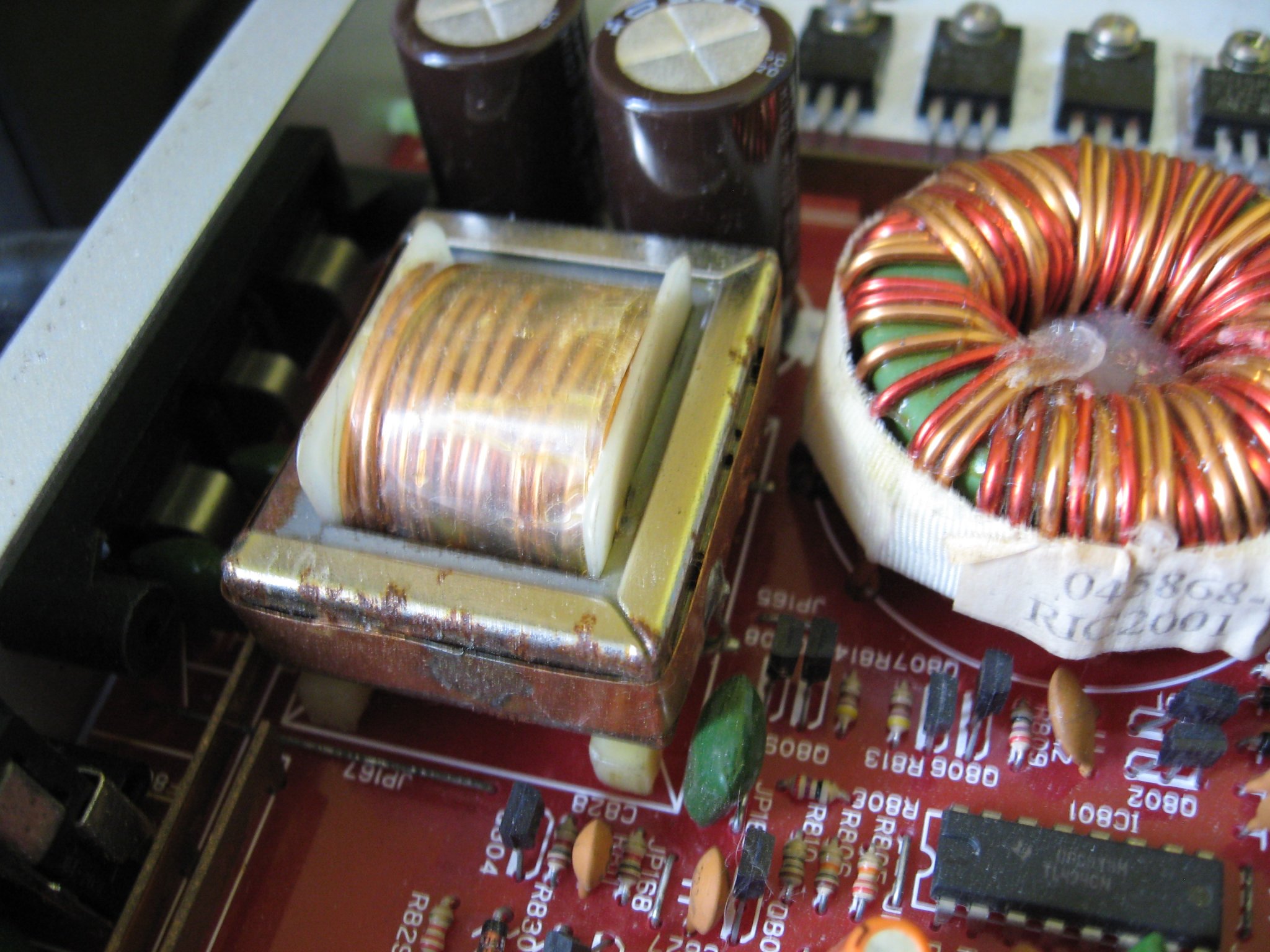

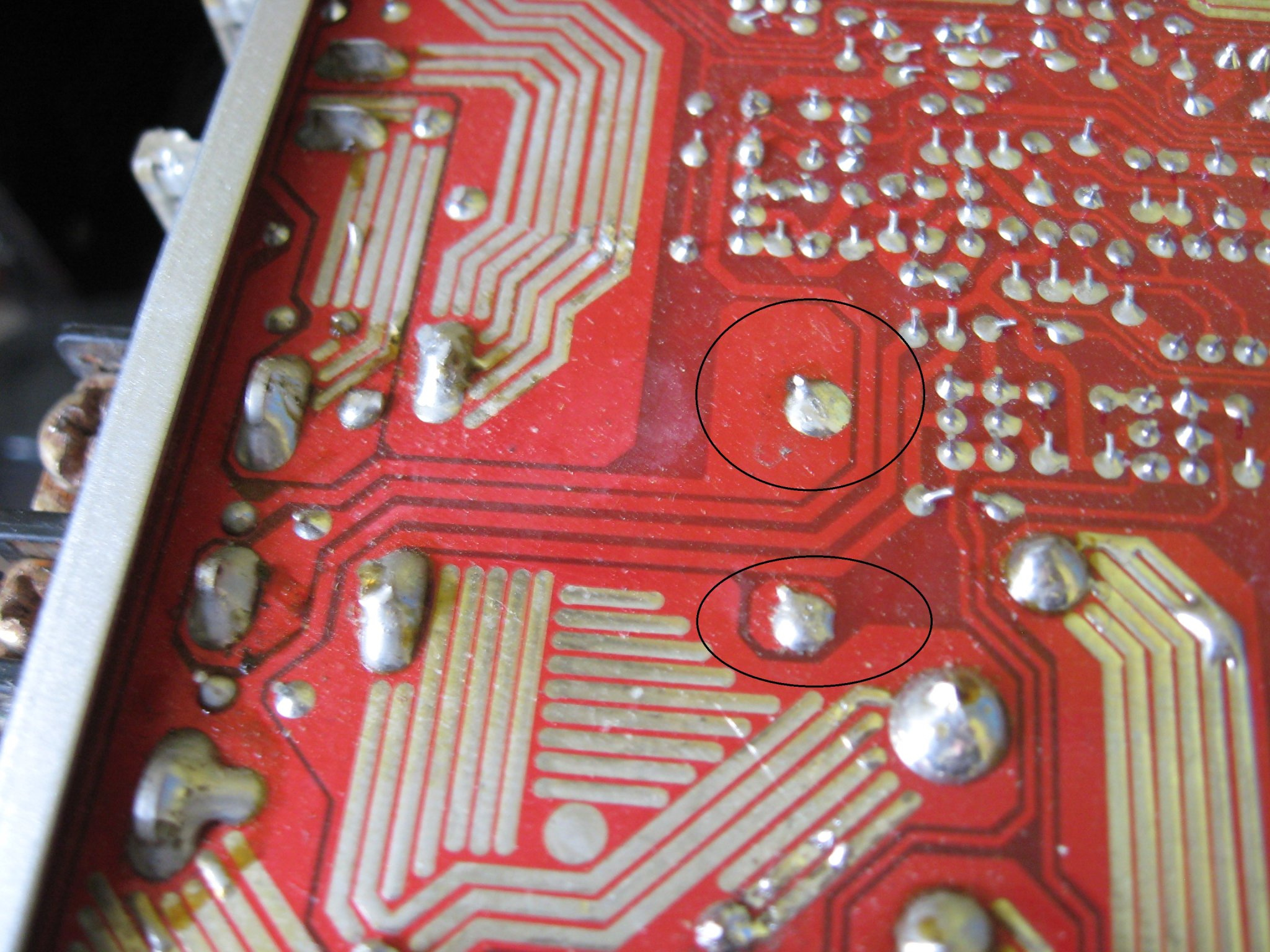

So this transformer is what powers the rails correct? If so, shouldnt have some kind of output on the secondary legs? As of now I have power on the fused side and nothing on those circled areas.
