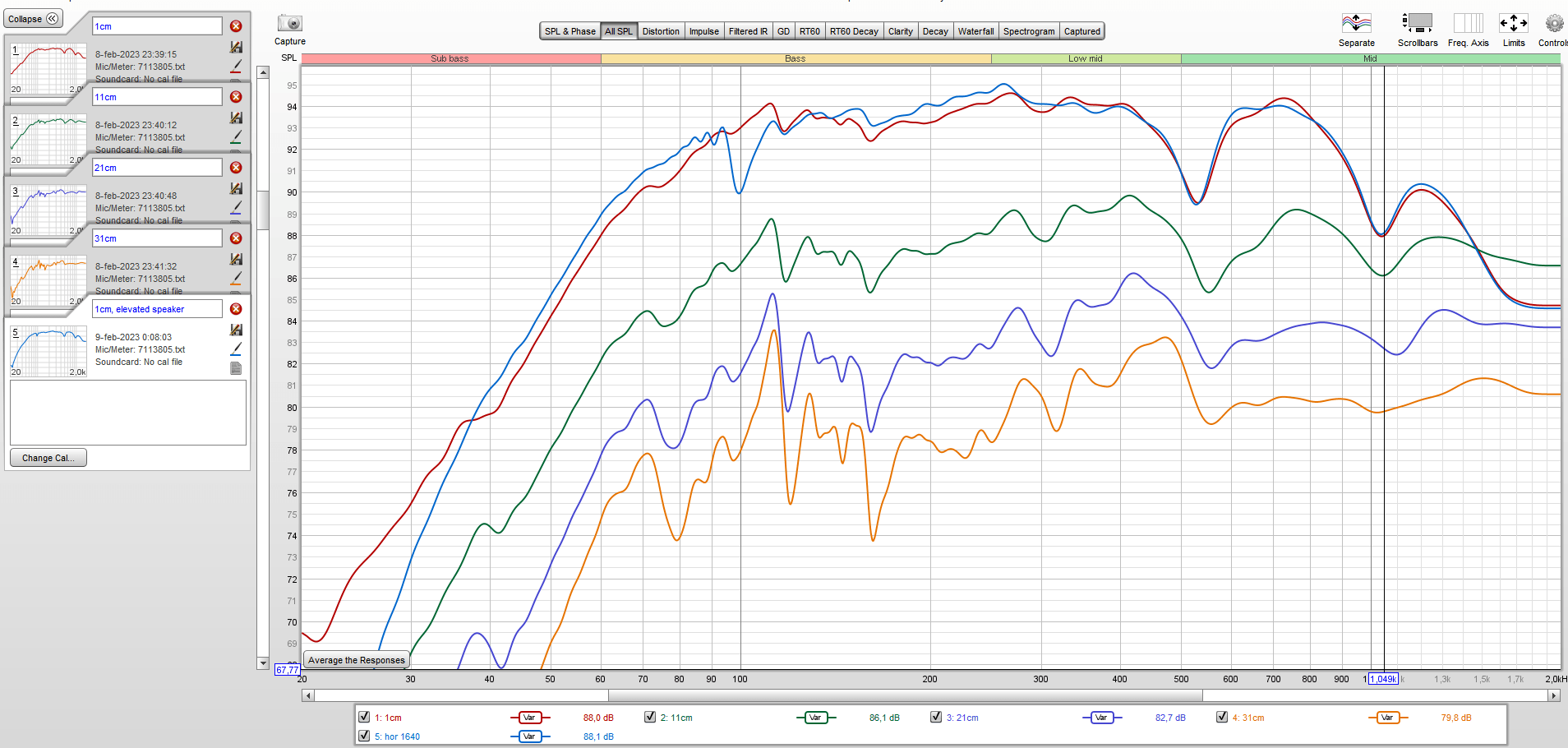

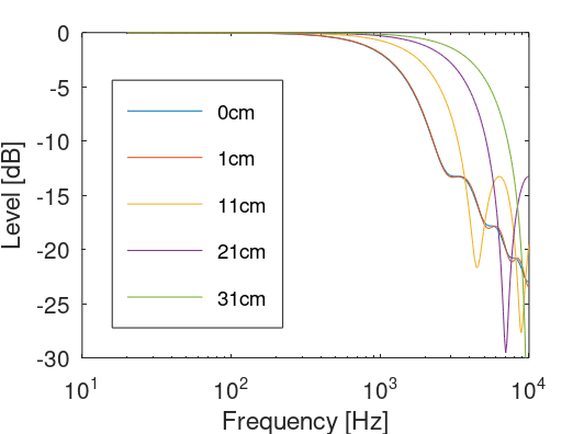

Here are some results with the microphone at changing distance and one with the speaker elevated to check whether a floor reflection is the cause.
The frequency of the dips doesn't change much. That rules out the ground reflection and according to my own calculations/simulations also the effect suggested by fluid.
Measurements:
Simulation:
Measurements:
![1675897981860.png 1675897981860.png](https://www.diyaudio.com/community/data/attachments/1048/1048283-b8b3856acc5a2ceb6372e594294db595.jpg)
Simulation:
![keele_distance.png keele_distance.png](https://www.diyaudio.com/community/data/attachments/1048/1048285-7e2f514ca4f833d4d581e1fffc89b745.jpg)
It is clear to me that the dips are the nearfield phenomena, as you increase distance away from the woofer they lessen. By the time you are at 1m plus they will be gone. Merge the closest nearfield measurement with a far field one between 200 and 400 Hz where the curves intersect the best. Vituix does a good job of this.

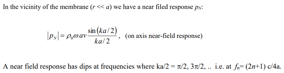

If p=0 we obviously have a minimum. And the sin function has nulls at ka/2 = (2n+1).π/2 with n any natural number, resulting in p=0. It maxes out at ka/2 = (n+1).π. So p = 2.⍴0.⍵.a.v/k.a gives peaks at every f = (n+1).c/4.a. But you had figured that out I guess?... but it doesn't explain the peak at ~1000Hz. And I also don't see why the formula shown should have minima at the frequencies indicated.
I'm having difficulties with the |pn|; I don't understand the absolute sign, not on that side of the =.
Let's assume that it is supposed to be on the other side. Then I agree with you on that point (only...).
Then we have a minimum p=0 at sin(ka/2)=0. The sine function has zeros at ka/2 = n*pi with n being any (positive) integer (including 0) .
It maxes out at ka/2=(2n+1)*pi/2 with n being any (positive) integer.
ka/2 = n*pi, so f = n*c/(2*a). That results in 343/(2*0.15) = 1143 HzSo p = 2.⍴0.⍵.a.v/k.a gives peaks at every f = (n+1).c/4.a.
The Application Note says dips at (2n+1)c/4a, which is:
(2*0+1)*c/4a = 572Hz
(2*1+1)*c/4a = 1715Hz
Note that it does not predict a null at 1000-1100Hz at all.
I reached the same derivation independently. No rocket science
. But I wonder if the formula is correct with a = radius of the piston.
If you imagine that the pathway difference between piston center and rim has to be equal to any n.λ/4 (with n>0) to get cancellation at the center, then 571Hz, 1.143Hz, 1.715Hz and so on should give the dips. We of course leave all contribution to the sound pressure in-between the center and the rim out of the question. I'd expect a square term somewhere, since the radiating area grows quadratic with the growing distance from the center. But then again, the growing distance to the mike (point sources) would lead to less contribution, those cancel out likely.
All in all the explanation of the 'peaks' in-between seems logical to me: at a certain f, you'll notice pressure cancellation of two points at 0 and λ/4 on the piston, completed by the addition of pressure of a third point further in the direction of the rim, at λ/2. And so on, just like your sim above.

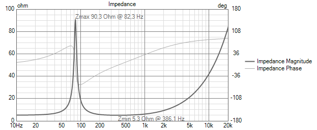

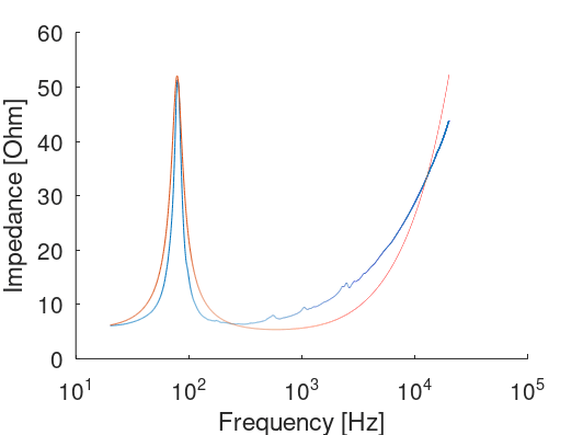

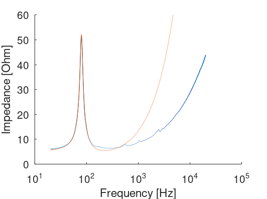

In an attempt to highlight any impedance anomalies I tried to model impedance of the speaker (in a closed box). The plan was to fit that model to the measurement and than subtract it from the measurement.
Unfortunately the fitting does not work well. The model seems off.
Model:
Fit:
Fit was limited to impedance peak.
Full frequency fit.
But the shape of the impedance plot in vituixcad does match my model:
What is going on here?
Model:
![1676842774526.png 1676842774526.png](https://www.diyaudio.com/community/data/attachments/1052/1052685-3e601773167125ab06071ba09526b2d1.jpg)
Fit:
![FiitedImpedancePeak.png FiitedImpedancePeak.png](https://www.diyaudio.com/community/data/attachments/1052/1052683-ecb544a064773c9010e941fa47b51125.jpg)
![impedanceFit.png impedanceFit.png](https://www.diyaudio.com/community/data/attachments/1052/1052684-2dba79bfacc761e2f273785017f7561e.jpg)
Full frequency fit.
![FaitalPRO 12PR320 Impedance.png FaitalPRO 12PR320 Impedance.png](https://www.diyaudio.com/community/data/attachments/1052/1052682-c2235e1269a3912f40edca5e1fe3c5fa.jpg)

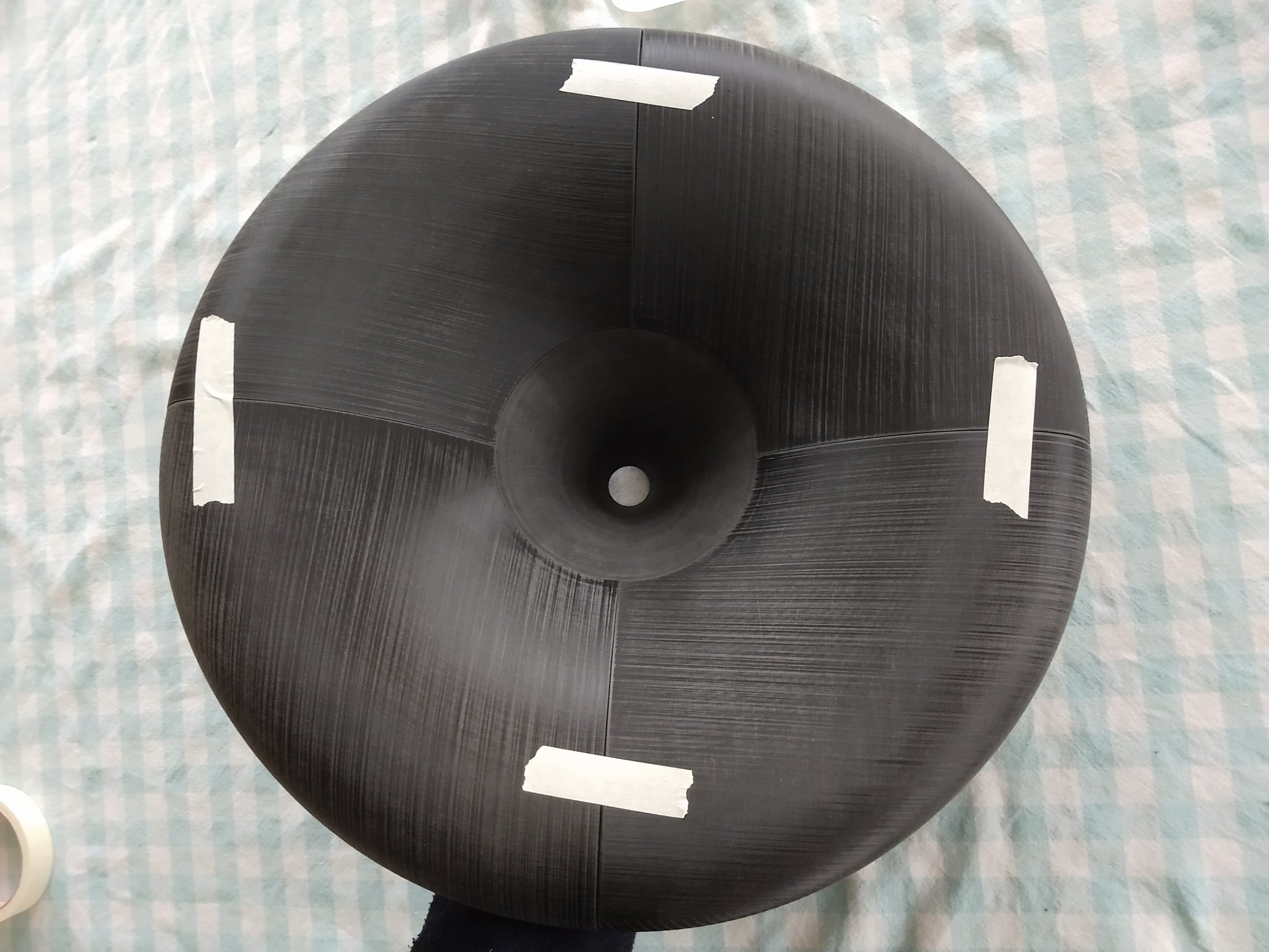

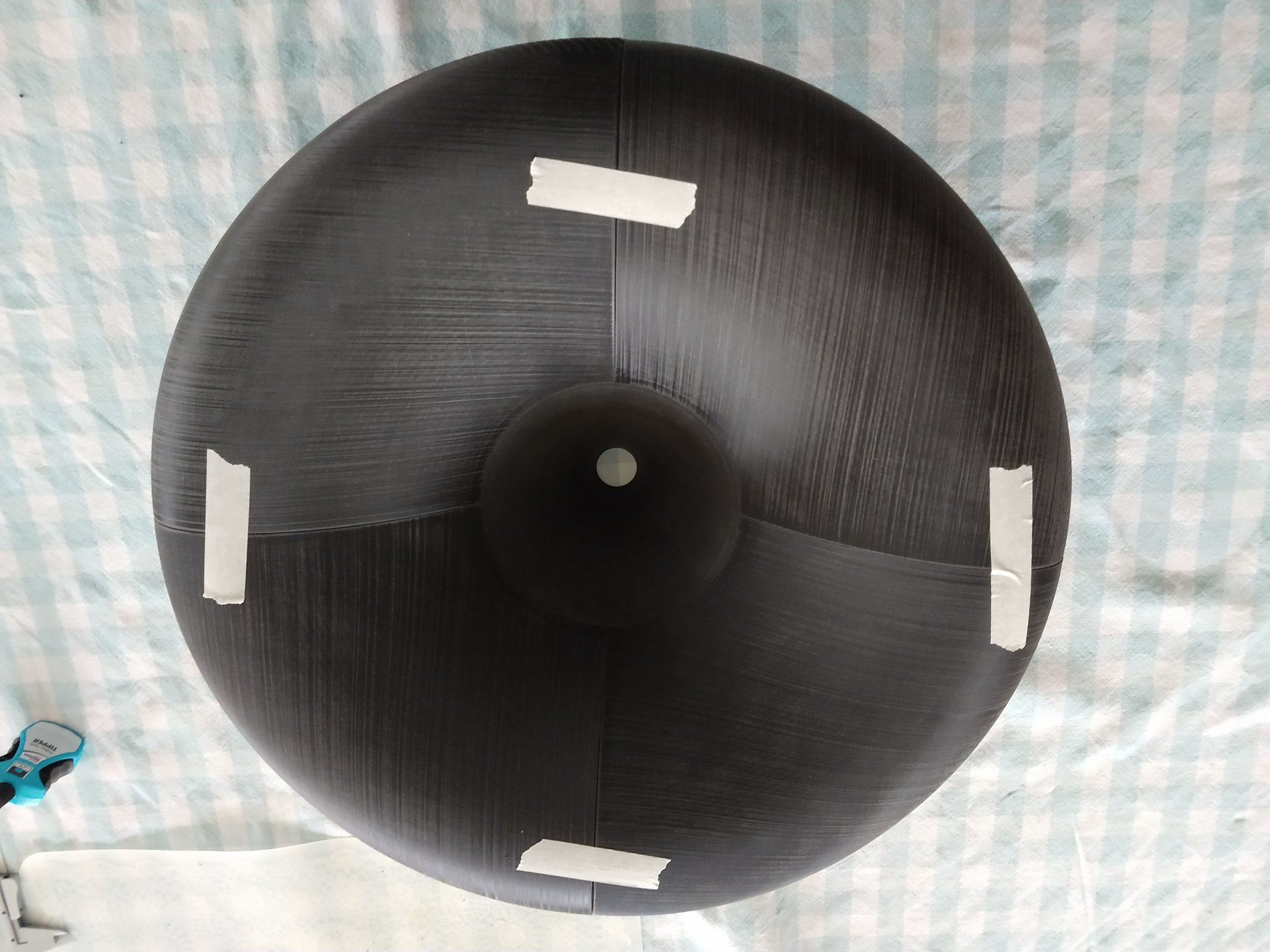

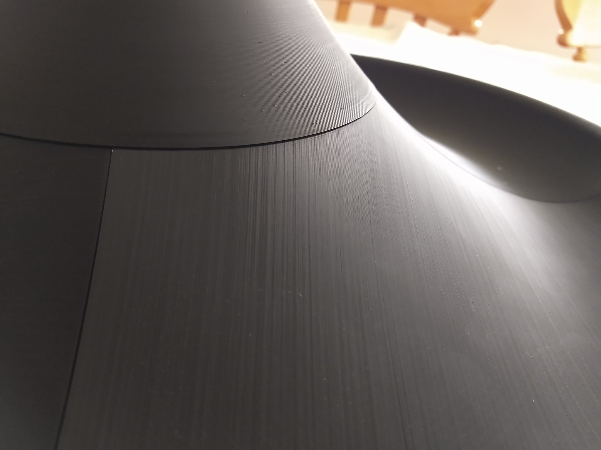

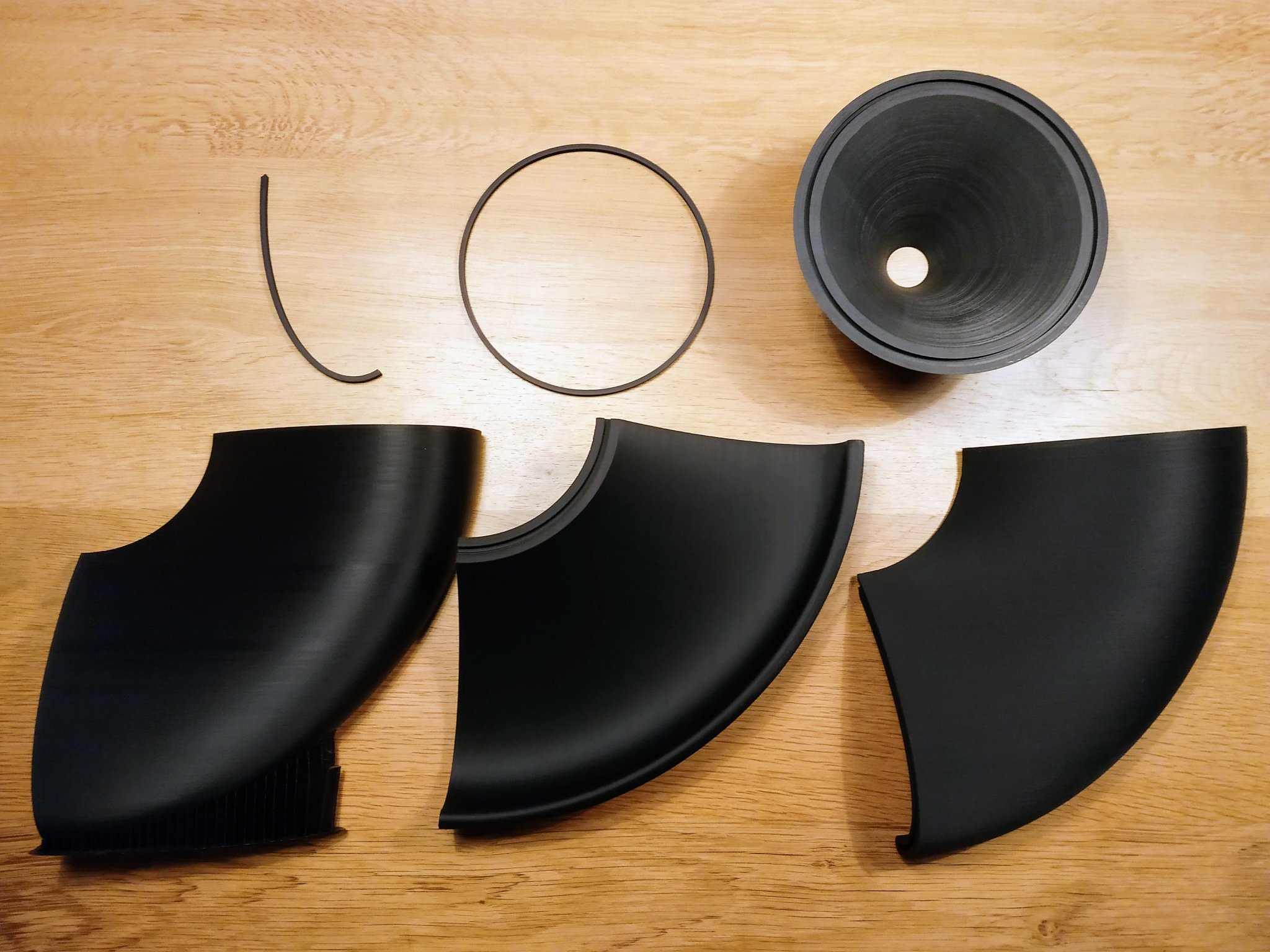

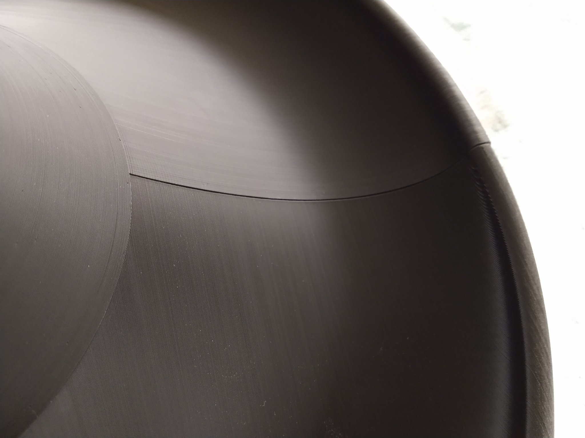

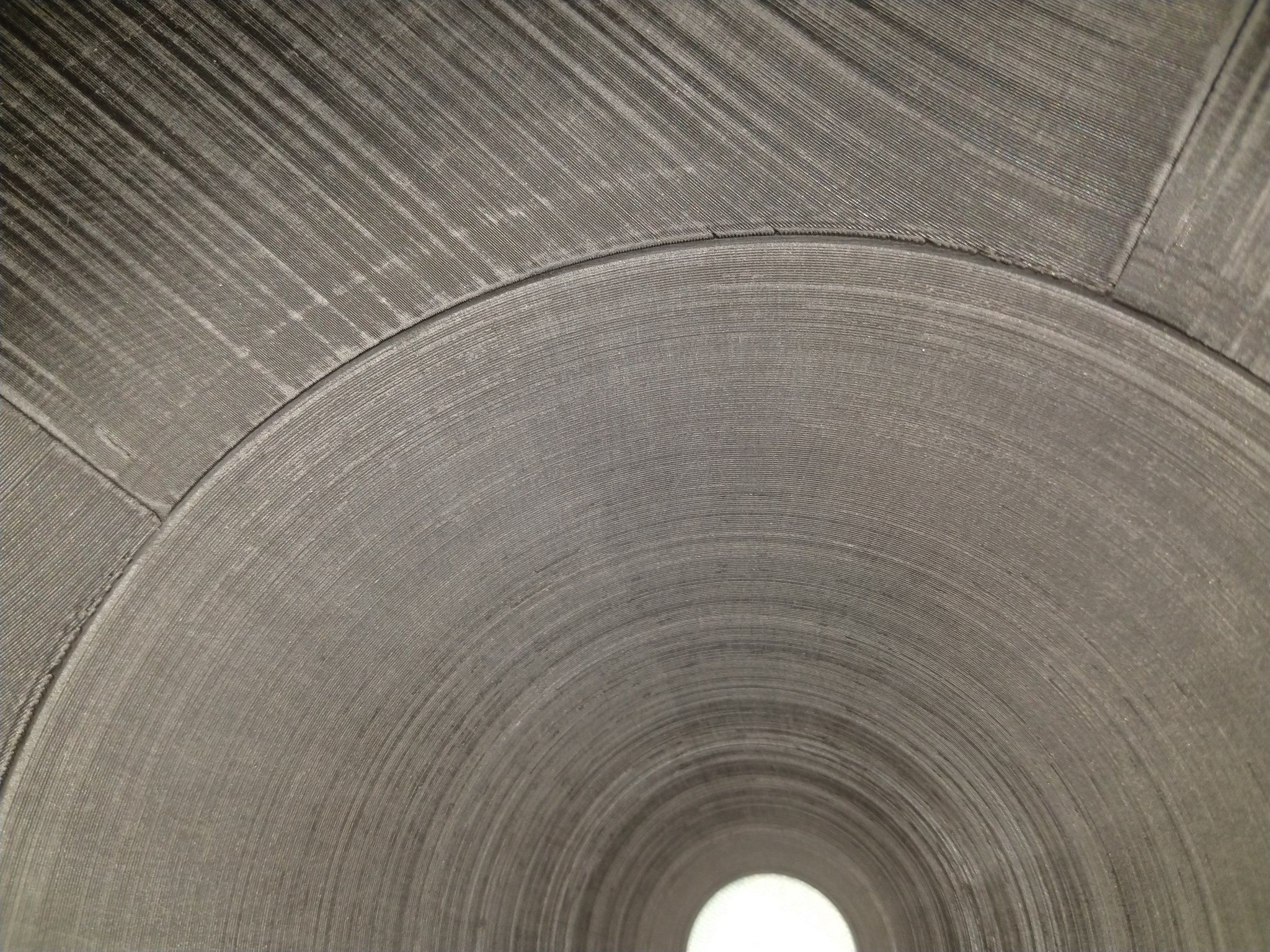

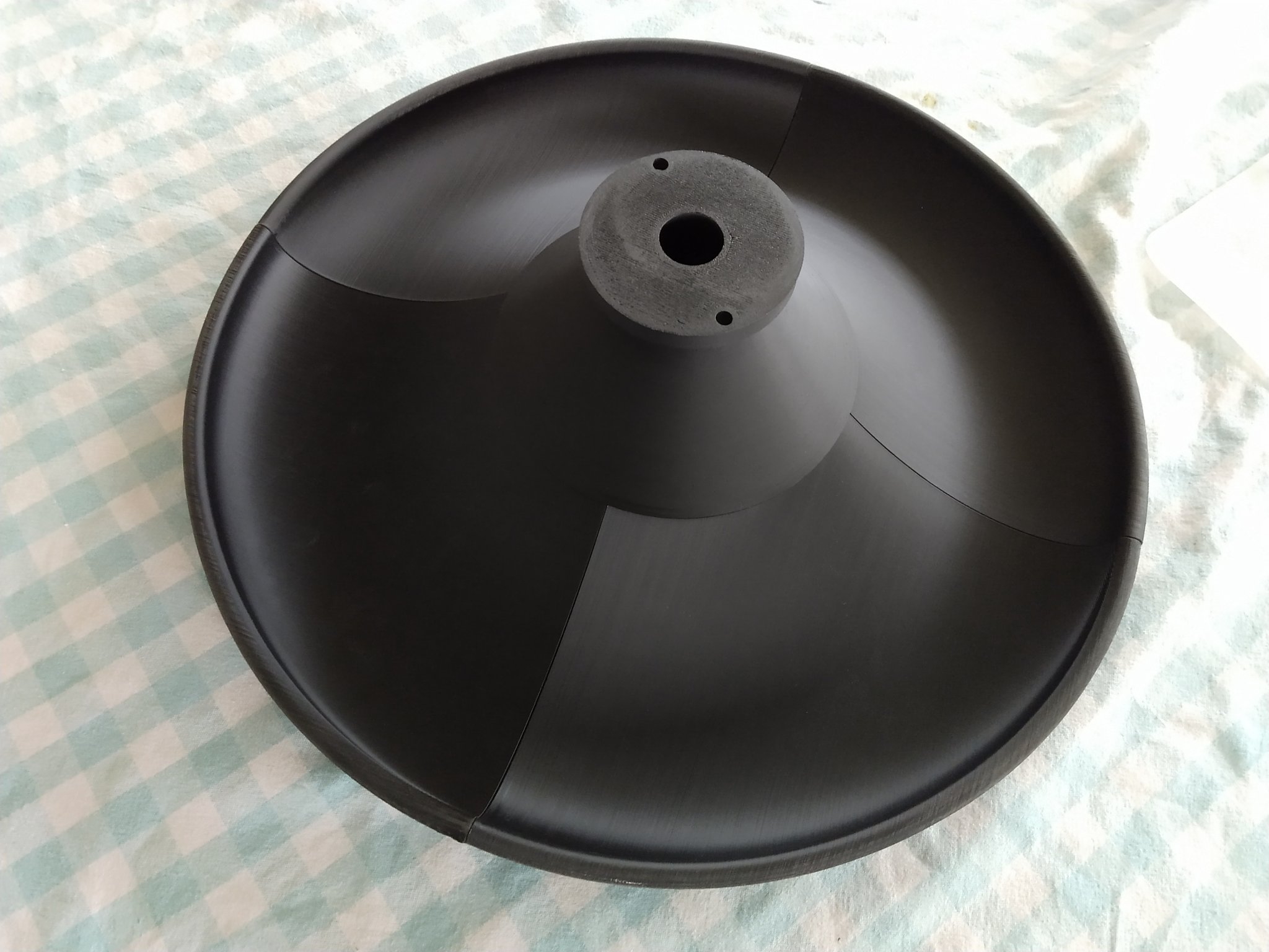

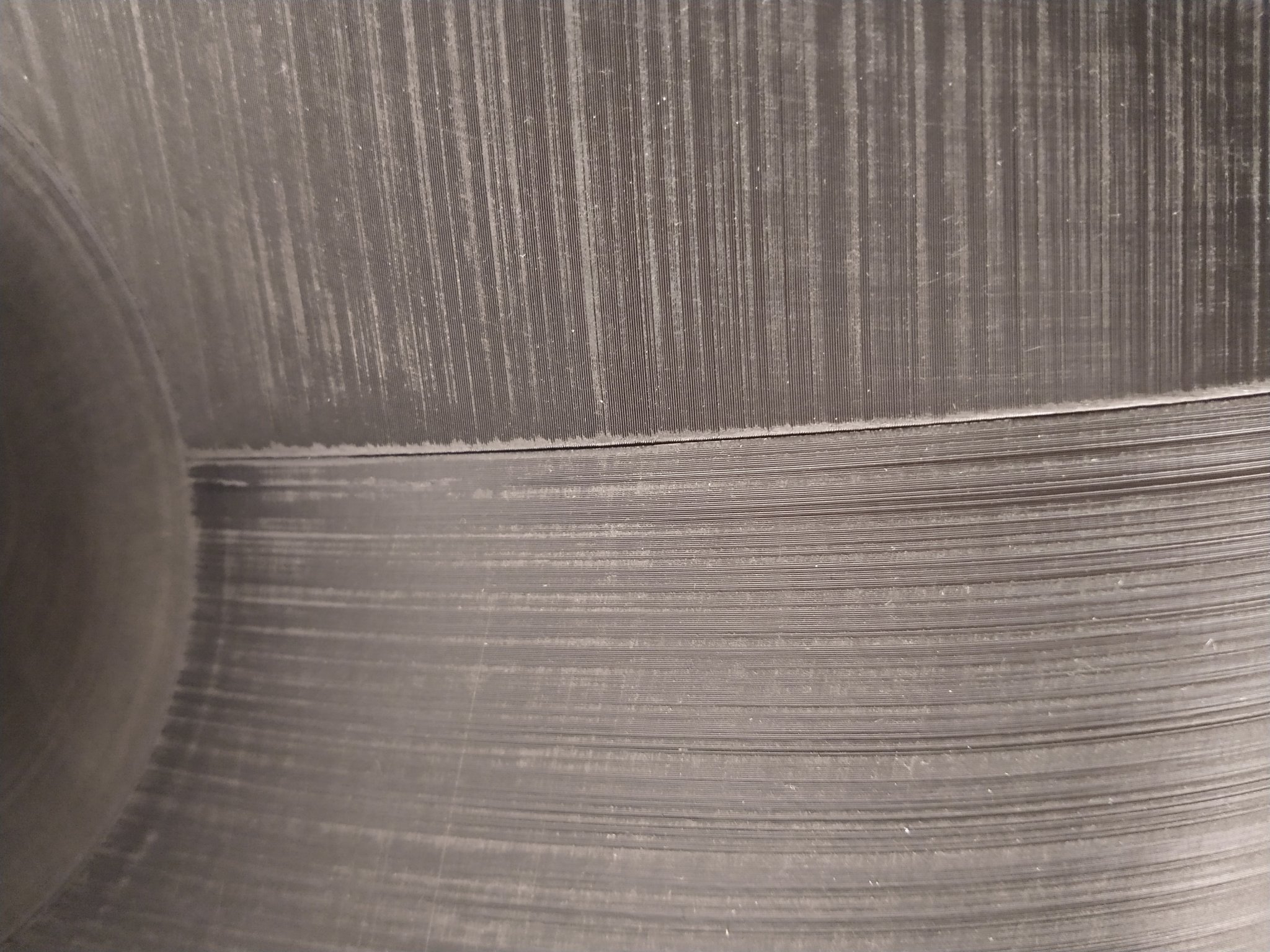

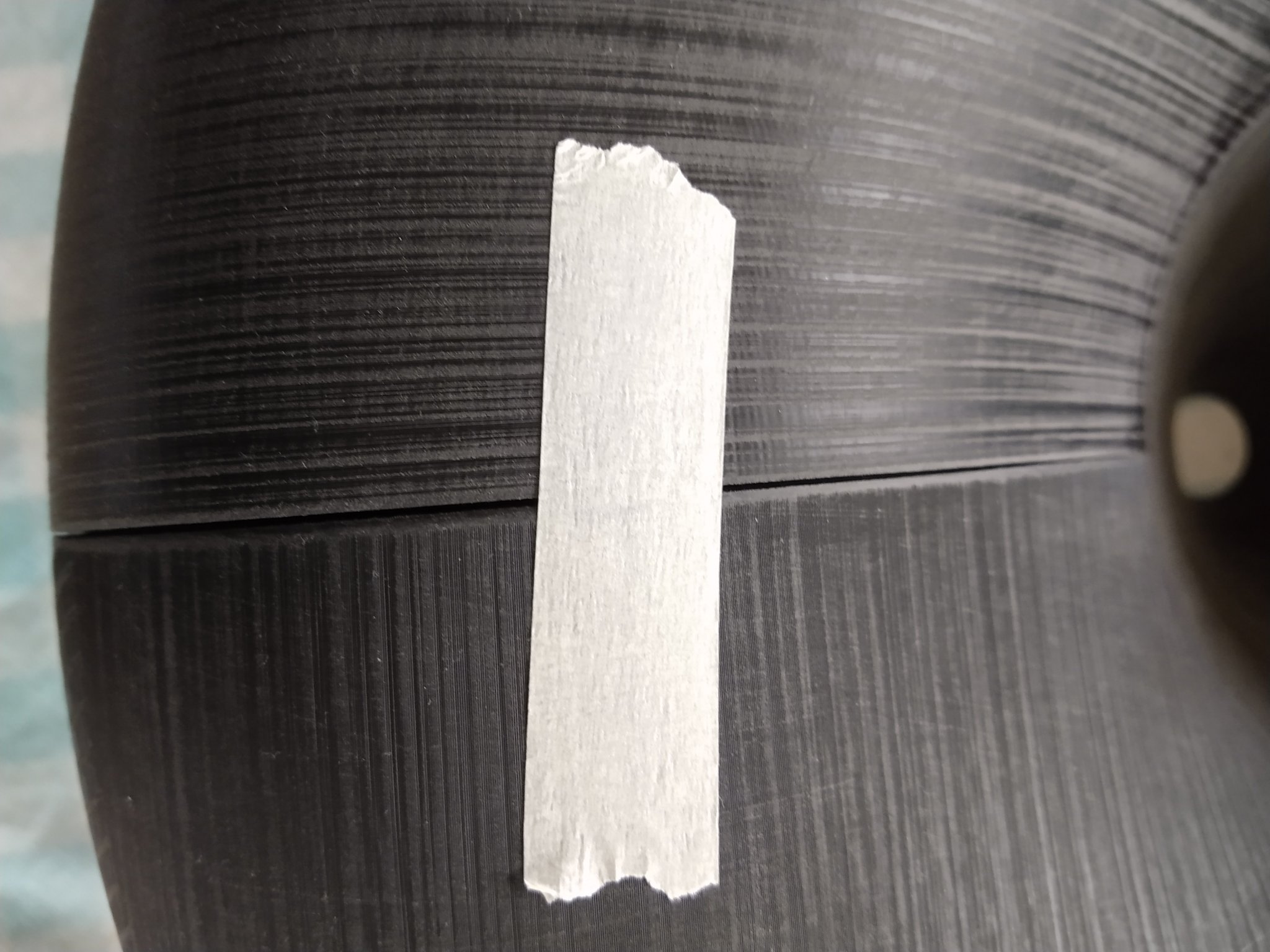

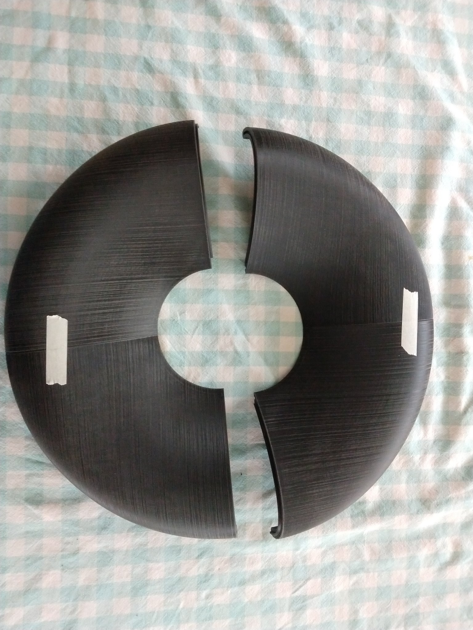

Printing is ready. Everything seems to fit really well (with a little persuasion). The first waveguide had some gaps between parts, but it somehow is much better this time. I think I'm going to use instant glue iso some slower gap filling glue.
I can handle the waveguide with just the four pieces of sticky tape.

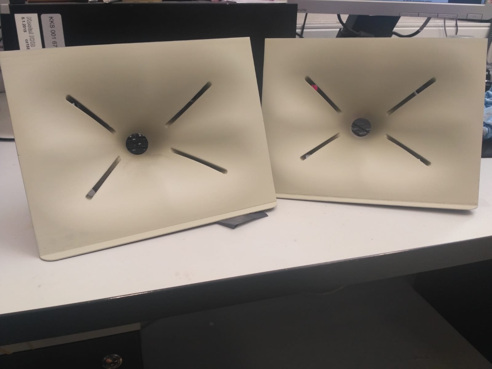

Revel Plasto and some sanding can do this (printed raw vs. putty and sanded). Cheaper alternative is acrylic wood putty.

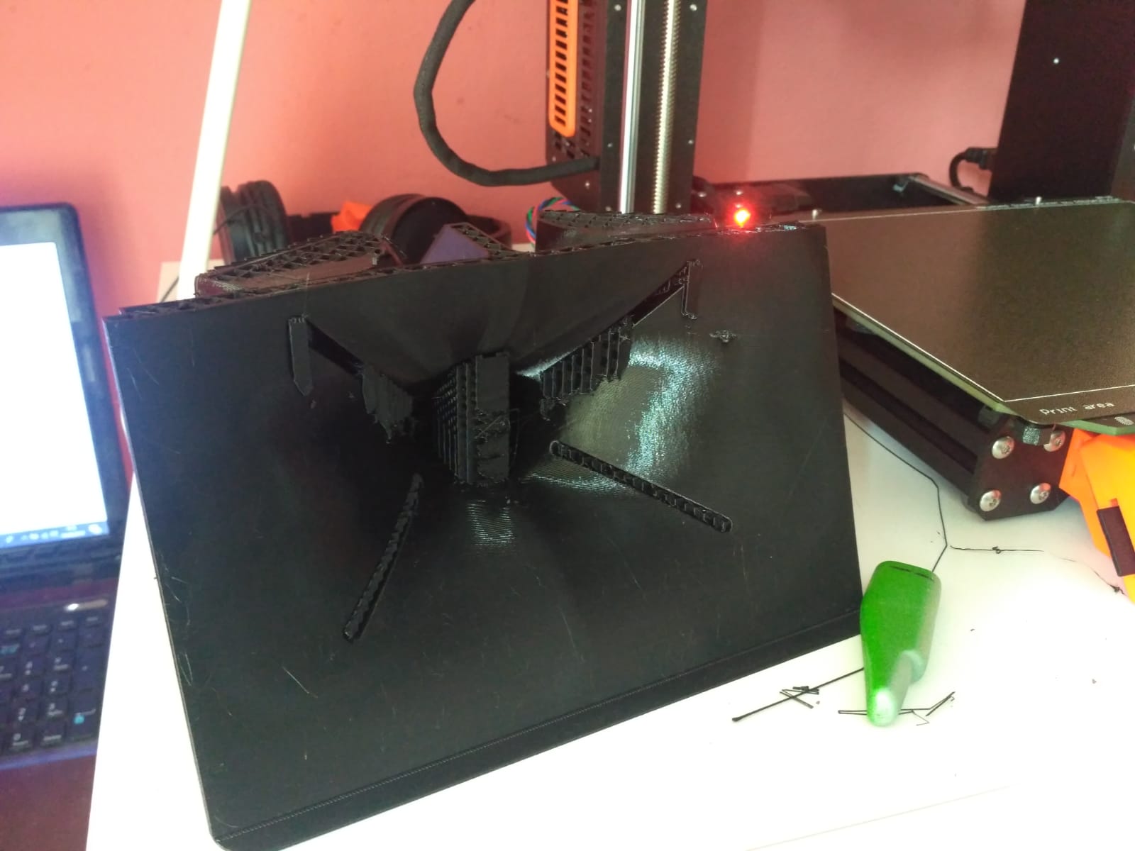

The print failed near completion, so the guy, who was printing it, printed the top part separately and glued it.
And a cool trick to get a nice surface is to use photoresin, I just brushed it on, let sit for a while and then harden with UV light.
