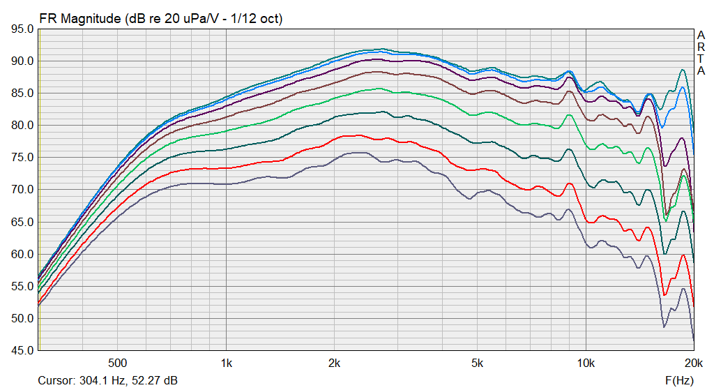

For a crossover design you will need to measure it together with the woofer anyway, so you'll see. Mic distance can also be a factor.I think the DI is very smooth. It is, however, a bit lower than expected. That would force me to crossover a bit lower, right?
Overall, the shape of the FR is strange from the beginning but I always attributed that to the driver. Maybe it's something else in your setup. Do you use any passive protection filter?
Now you know how difficult it is to measure the acoustic side thoroughly. I wouldn't be bothered by small reflections from the stand etc. - once you know there are no other major reflections, it's easy and safe to smooth that out.

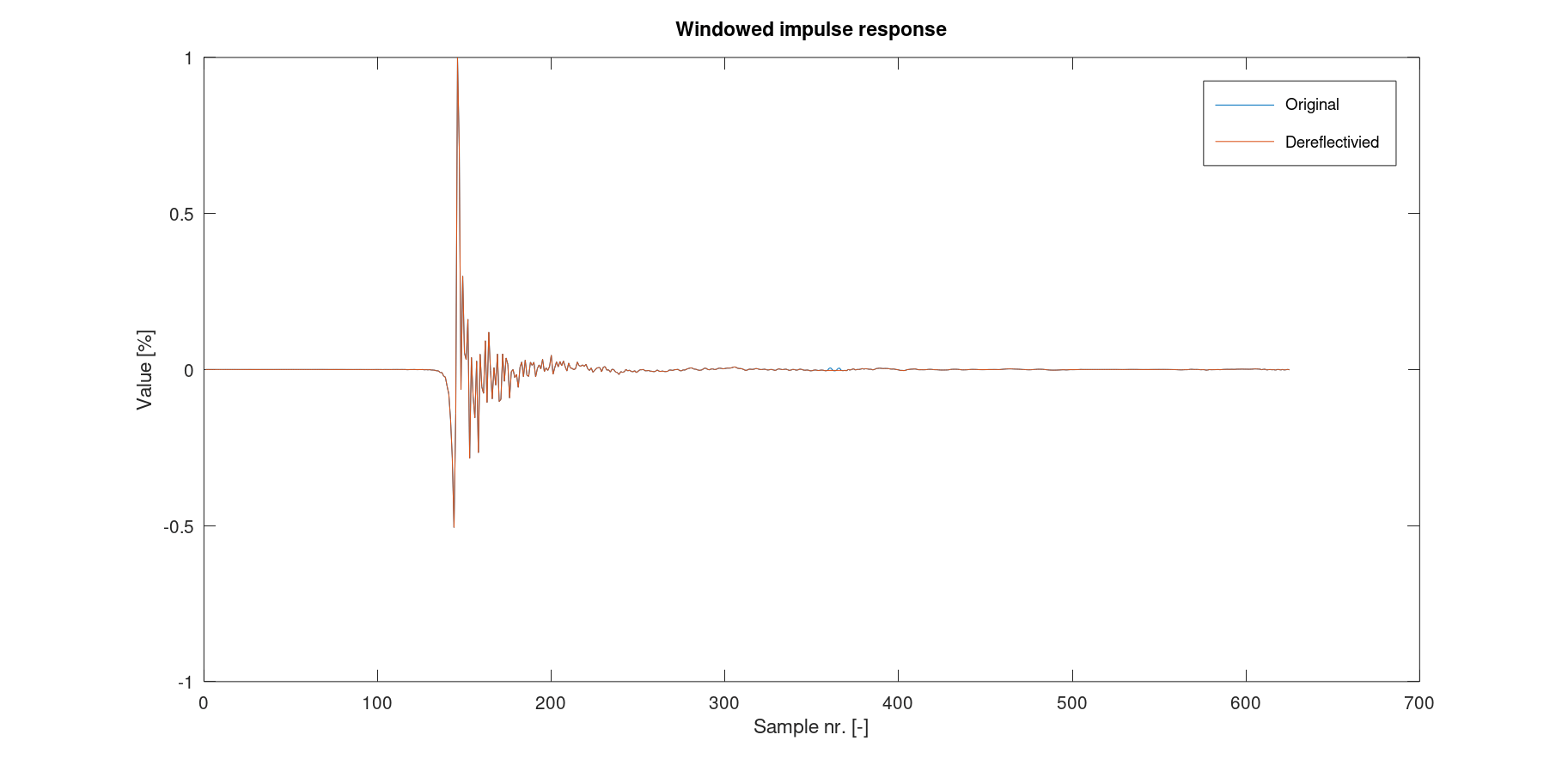

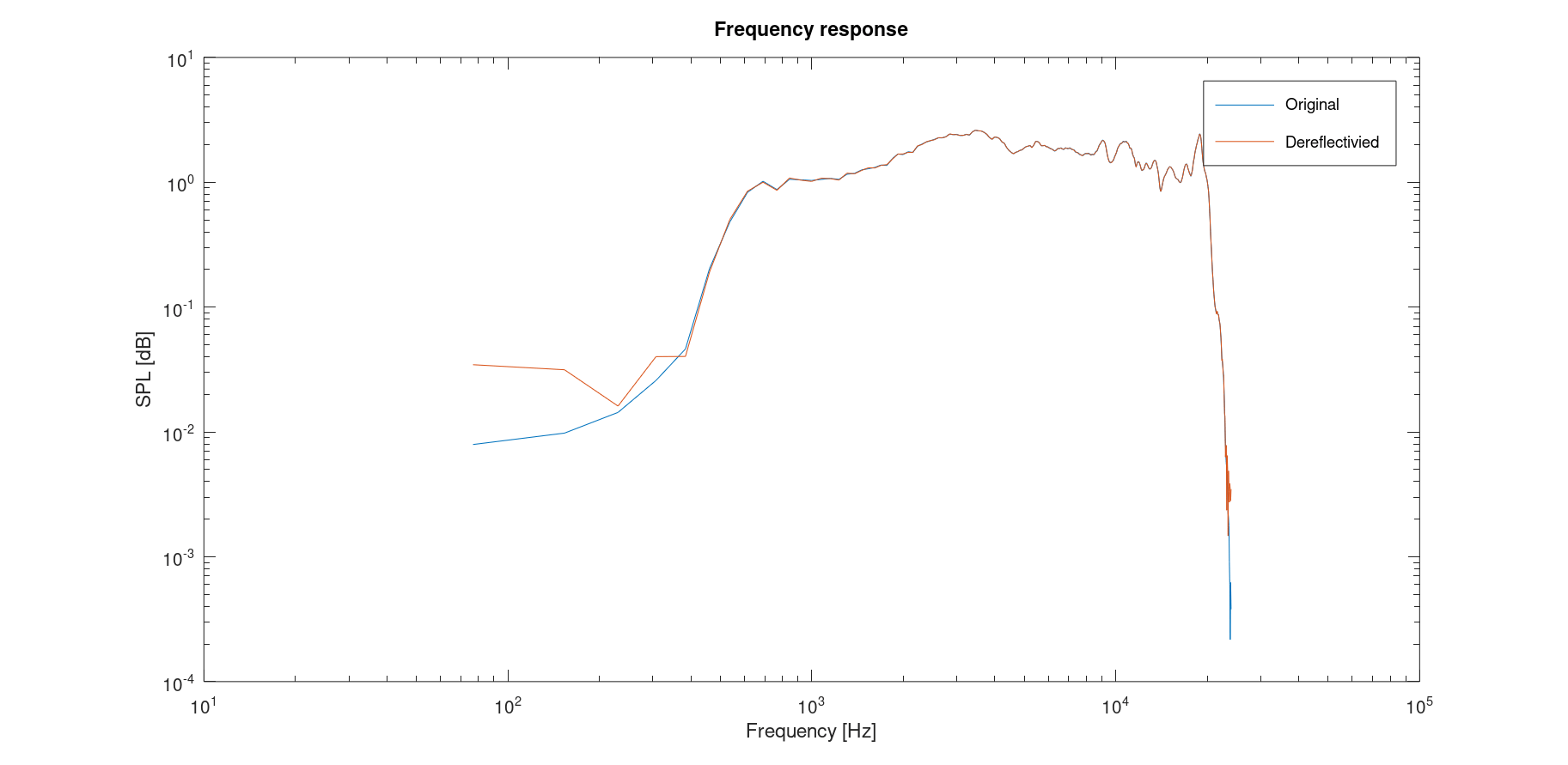

I exported the impulse response to a .txt file in REW. I imported it into Octave (Matlab clone) and windowed it similarly as REW does. Then I use the very advanced technique of just eye-balling it and repeating the last sample before the obvious reflection until the obvious reflection was over.
![impulseResponseDereflectivied.png impulseResponseDereflectivied.png](https://www.diyaudio.com/community/data/attachments/1063/1063202-e13b84c9fe4c76c94101c7169eb377ef.jpg)
The blue original shows a reflection around sample # 375.
Then I fft-ed the impulse response to get the frequency response:
![FRDereflectivied.png FRDereflectivied.png](https://www.diyaudio.com/community/data/attachments/1063/1063203-eee5821bec628b820bc0c57aa6dffb4a.jpg)

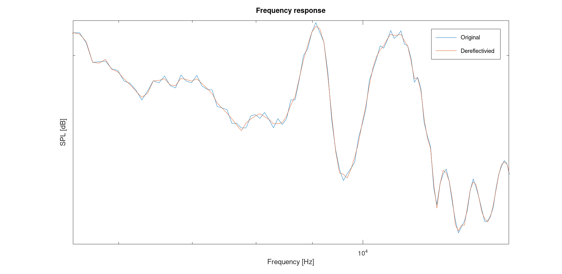

There is quite a difference in the low frequencies that doesn't matter to me. Zooming in on the portion 6-10kHz shows this:
![FRDereflectiviedImprovement.png FRDereflectiviedImprovement.png](https://www.diyaudio.com/community/data/attachments/1063/1063204-03eff806b0fe426a2a48f22aef09c071.jpg)
Here the dereflectivied signal is looking a bit smoother. I think it looks better. But it might be that 'the wish is the father of the thought' (dutch saying).

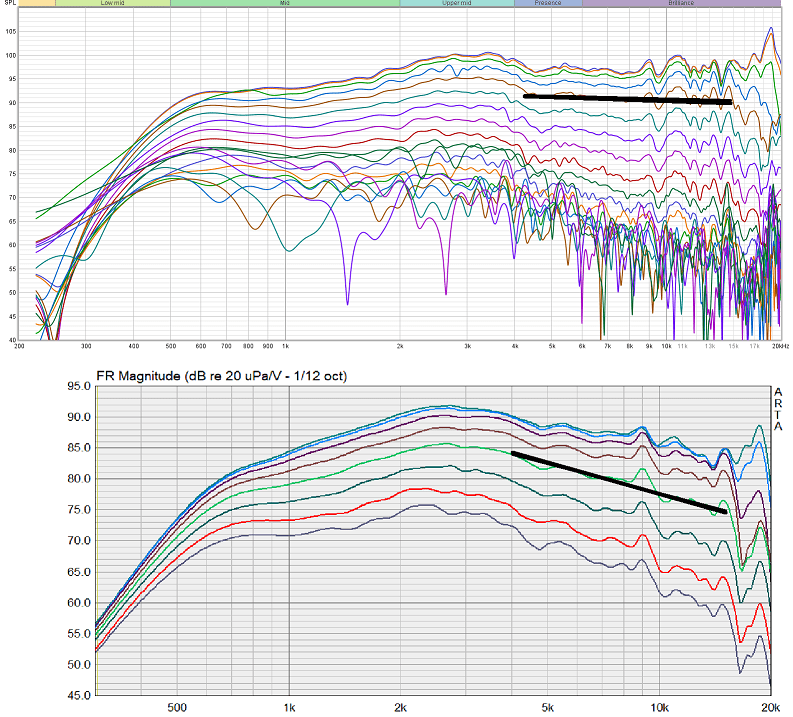

There should be no need of magic, your raw measurements of the waveguide look strange to me though, the DI and normalized directivity is as expected but everything else looks quite odd. Waveguides of that type should peak towards the lower end and fall to high frequencies without correction.

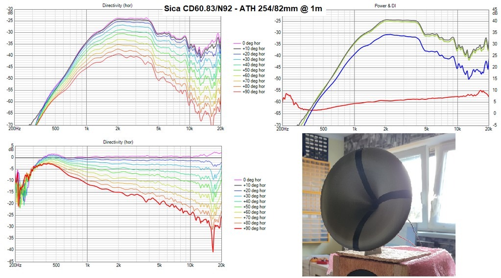

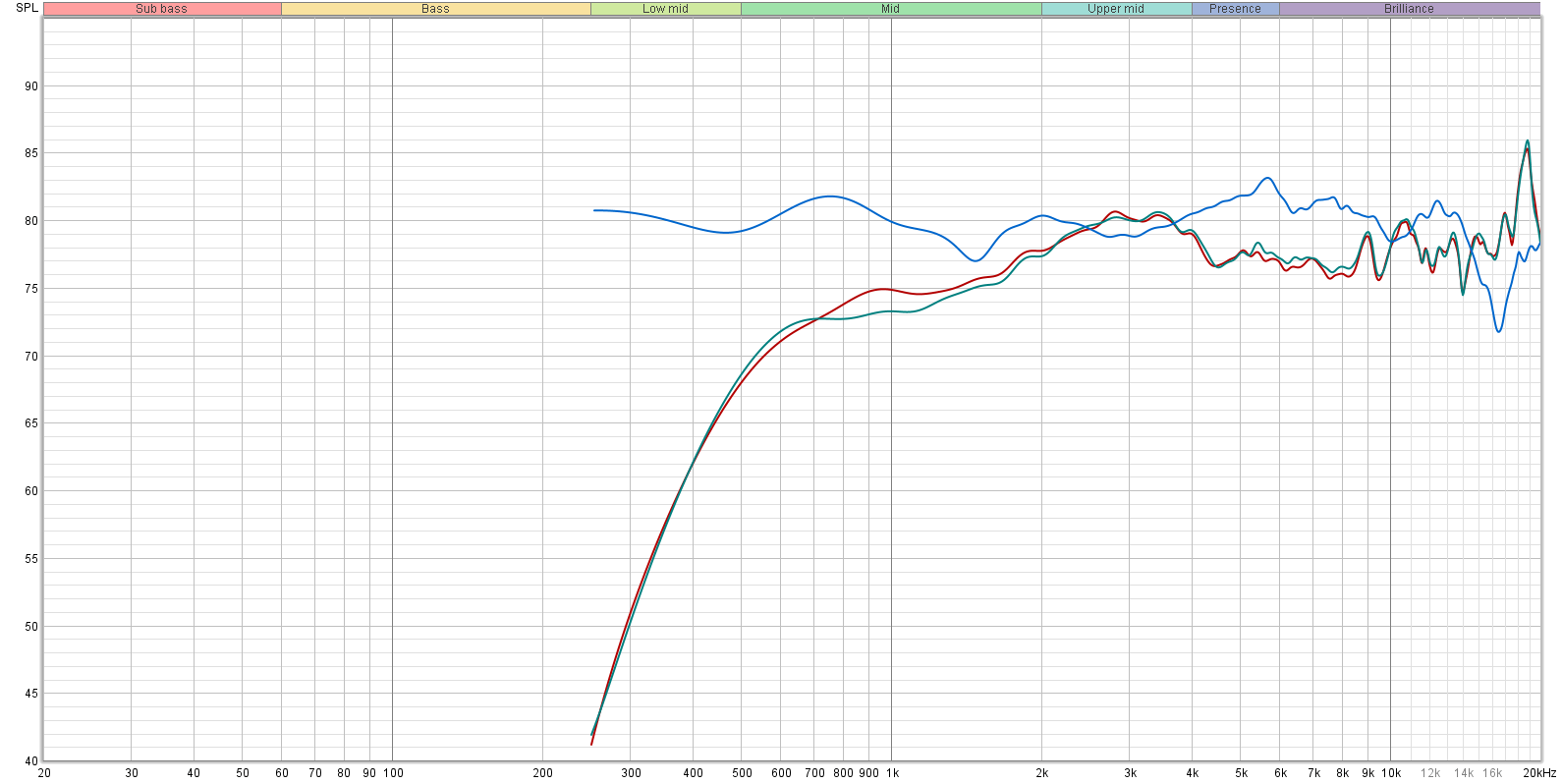

I guess you mean you expect something like this:
![CD60.83_N92_ath_254mm_volne_test_polars_sum.jpg CD60.83_N92_ath_254mm_volne_test_polars_sum.jpg](https://www.diyaudio.com/community/data/attachments/1063/1063216-9a3048504e12729cbced5d9af96cc091.jpg)

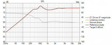

I do use a passive protection filter of two simple 100uF electrolytics soldered back-to-back. I traced the CD impedance in VituixCAD and used that together with a 50uF capacitor to simulate the sound level:
![1035082-7c3a014fc7b49cb61a0c3f0c02b49a11.png 1035082-7c3a014fc7b49cb61a0c3f0c02b49a11.png](https://www.diyaudio.com/community/data/attachments/1063/1063217-a172f6e354796b72caec96c85dc77e0a.jpg)

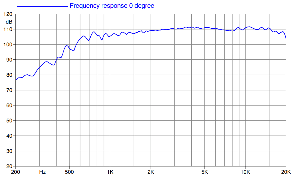

And here is the CD response as provided by Faital:

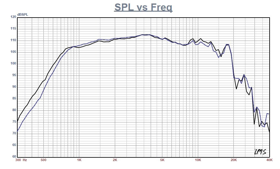

I did find this FR of a CD very similar to mine (https://audioxpress.com/article/Tes...ession-drivers-coupled-with-LTH102-60-50-horn):
That was measured with quite a different waveguide (Faital LTH102):
Can the CD be 'corrected' for a waveguide efficiency? Or is that very depedent on the waveguide shape? Any ideas how to determine what is going on? I don't have any CD's laying around...

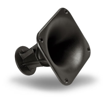

![LTH102_photo.jpg LTH102_photo.jpg](https://www.diyaudio.com/community/data/attachments/1063/1063869-e07b97fec7946f80a1c583ee1bba6a9b.jpg)
Pretty much, your waveguide simulates in a way that suggests that's what you should get barring driver differences, but that doesn't seem to be what is going on in yours.I guess you mean you expect something like this:
The fact that the directivity is measured as expected suggests that there is some kind of error or offset that is applied equally to all measurement so when they are normalized the expected result comes out. This suggests to me that there is nothing wrong with your waveguide.

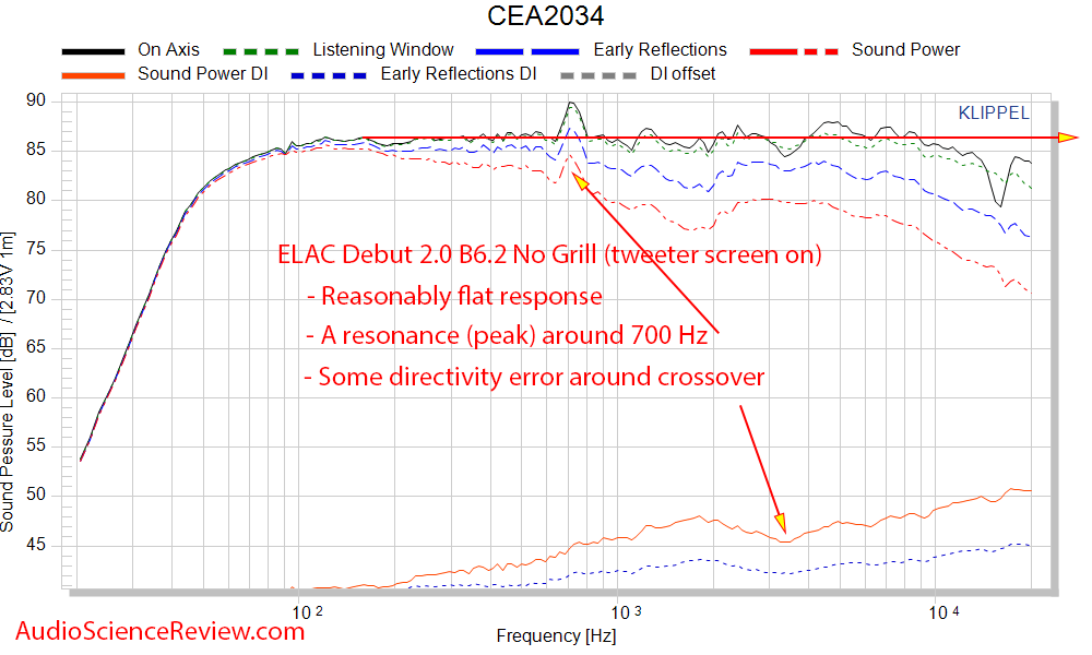

That would rule out the complete measuring chain. So I quickly tested my Elac debut 2.0 b6.2's before leaving to work.Otherwise if you have a speaker that someone else has measured you could use that to compare to a measurement you have taken.
![ELAC Debut 2.0 B6.2 CEA2034 spinorama frequency response measurements.png ELAC Debut 2.0 B6.2 CEA2034 spinorama frequency response measurements.png](https://www.diyaudio.com/community/data/attachments/1063/1063950-eb6cddac859217aa7e89e883ffdd568d.jpg)
![1679383132297_elac.png 1679383132297_elac.png](https://www.diyaudio.com/community/data/attachments/1063/1063951-57f2754e1b58dda0ea4df46c7957d748.jpg)
Based on these very quick measurements I would say my measuremt setup is ok. Waveguide is ok. That would only leave the CD's...
The HF108 doesn't usually present strangely in other's measurements that I have seen. The Faital factory measurements are made on their LTH horn which is a bit of a beamer. A flat on axis is expected with that kind of horn but not the one you made. Maybe run an impedance sweep of the CD off the horn to see how that compares to factory.

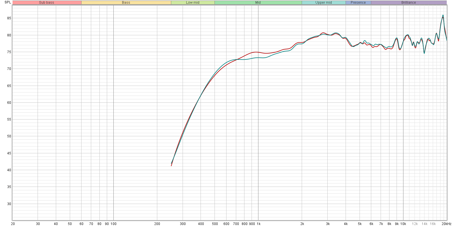

If I read the polar correctly, the rising high end only appears at the reference angle. And drops fairly steep off axis. That could well be a contribution of this particular horn. A measurement of the bare driver (however useless) could maybe prove that it has a rising top end. But I wouldn't worry too much, the measurement setup does it's work properly.
In the image above up until about 3K things look as expected and there is the beginning of a decline before the response flattens out again. Maybe the mic is not calibrated or the calibration is a little off, scaling in Vituix can make things seem exaggerated. Most cheaper omnidirectional mics start to vary above 2K and need calibration to be accurate.
