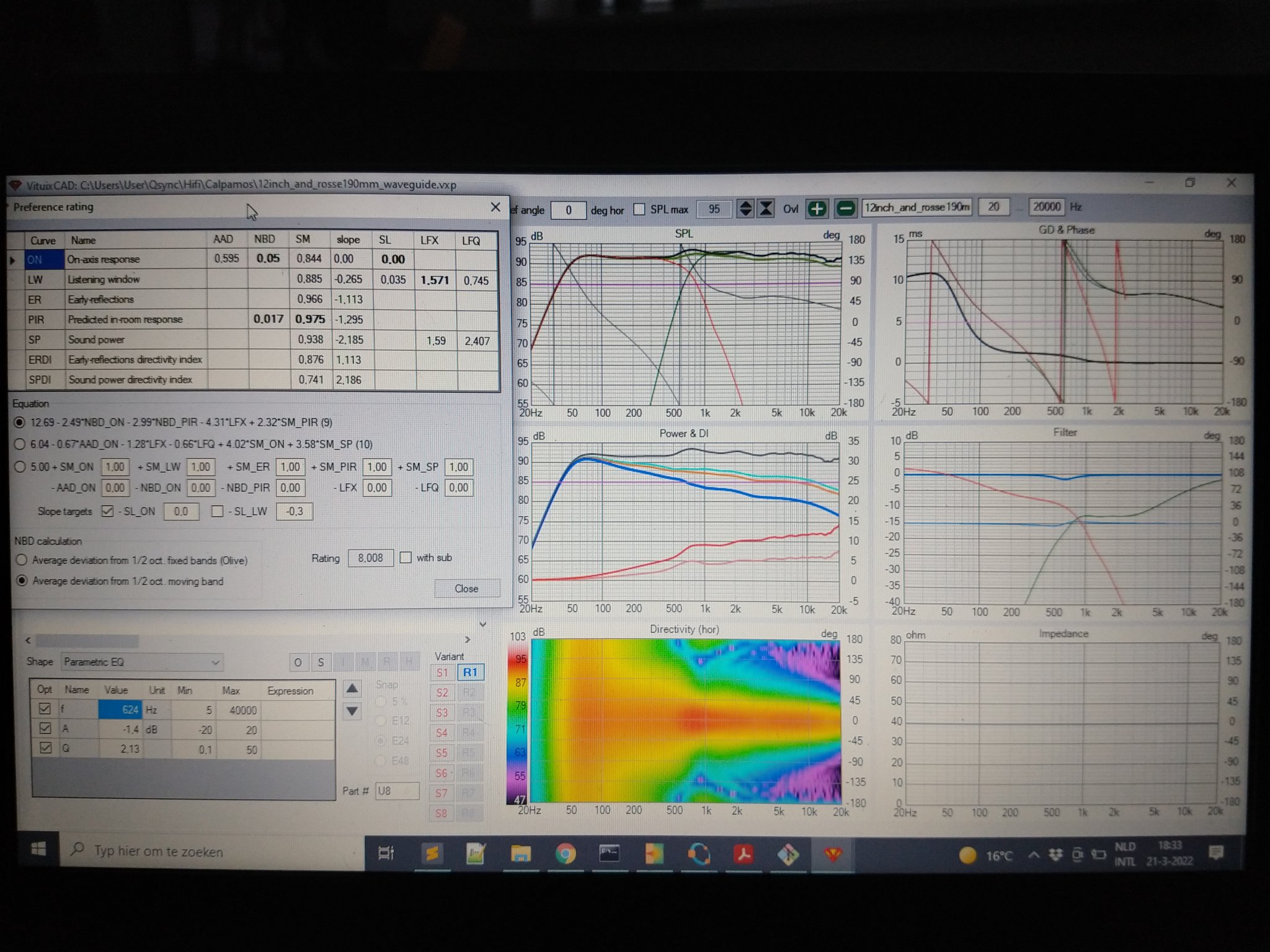

The optimizer is trying to make the blue/red/green curve more straight at the expense of the on-axis 900Hz bump.
I don't think DSP can solve that. I have been playing with other crossover points and even a 12" woofer, but I can't get much better...
Directivity Index of the waveguide seems to be very high >10db, already below 1kHz and there is mismatch to the woofers much lower DI there. You could check out if it works fine with 18" woofer, or make the waveguide smaller so that DI is falling through 10db around 1kHz to match directivity of 15" driver. Basically, check out ideal 15" driver DI (or measured one if you already have enclosure for it) and try to match that with your waveguide around the crossover, you can then use crossover anywhere you like where the directivities overlap without issues like this.
I'm not sure how the new R-OSSE works but I think there was only one parameter (diameter or depth or something) in the previous scripts which one could use to scale a design without affecting much on the response other than sliding the features up or down in frequency.
edit. Looked again the graph, this seems to be only ~2dB issue, not biggie and most speakers have worse anomalies anyway. Now that you haven't manufactured anything yet, perhaps try to scale the waveguide a little bit smaller and see if it smoothens it, which would make it as good as possibl.
edit2. you are able to simulate, try simulating woofer enclosure width and depth to manipulate its directivity below 1kHz, like emabat sims in the ATH thread recently showed https://www.diyaudio.com/community/threads/acoustic-horn-design-the-easy-way-ath4.338806/page-476.
It's obviously a wrong target, this is not a good result.The optimizer is trying to make the blue/red/green curve more straight at the expense of the on-axis 900Hz bump.
Of course DSP can solve that. What do you mean that it can't?

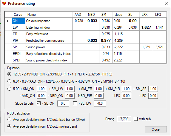

I have one of Sean Olive's preference ratings as a target.
The preference rating depends on the Narrow Band Deviation of the on-axis response (NBD_ON), NBD of the Predicted In-Room Response (NBD_PIR) and the smoothness of the Predicted In-Room Response (SM_PIR).
A DSP can solve the hump around 900Hz and will improve NBD_ON I guess. Simultaneously it will deteriorate NBD_PIR and SM_PIR as those are coupled together by the waveguide geometry. You might be able to influence it a with the cross over.

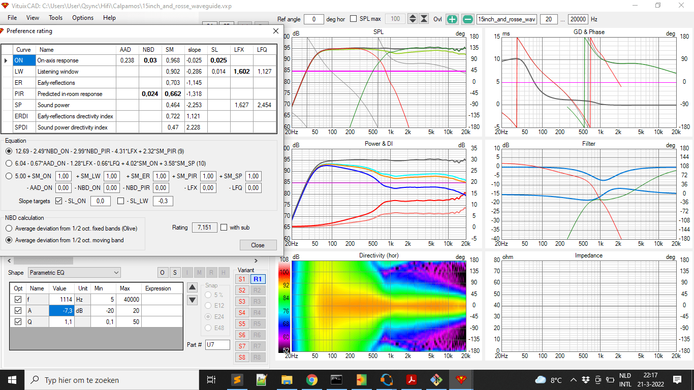

Yeah, I'm trying with 15" and 12" woofers and 38cm and 45cm waveguides, but I don't get the expected result. I might have to reject (simulated) reality or I just don't understand it (yet)...
Complete simulation in ABEC would be nice, but I don't have the hardware for it; just an old laptop. I tried to circumvent that by using VituixCAD.
yeah you should be able to do it in vituixcad. Mute either the woofer or waveguide and see the DI graph each playing alone. I suspect you see the waveguide has higher DI below 1kHz, than the woofer.
You could perhaps just change ath script and compare the DI in the standard report if it got closer to what you see with the 15" woofer.
It is like your waveguide is too good 😀 just make it bit smaller to match directicity of the woofer better. For 12" youd need even smaller waveguide

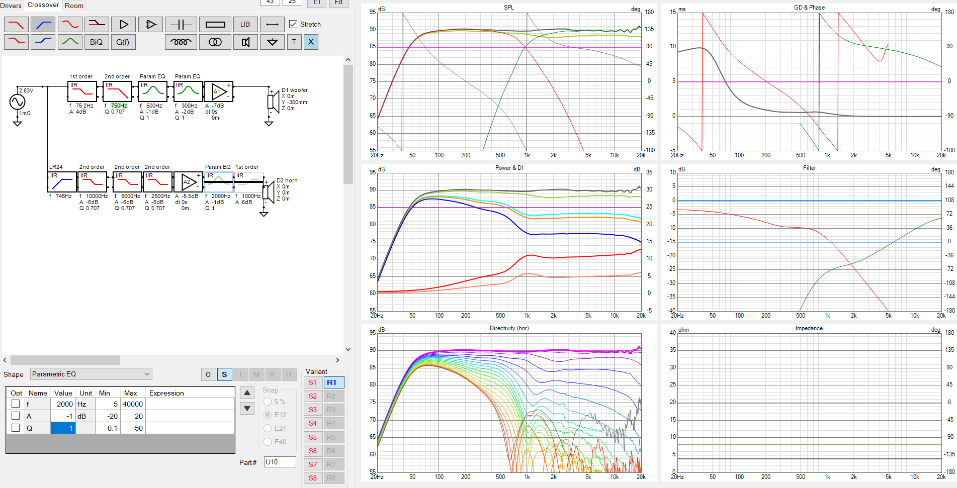

I would try to shift the high-pass knee of the tweeter a bit higher and shape the response so the summed response is more or less flat. You are still far from what's possible, IMO, and that's still what you can do with the DSP. I would leave the Olive metric at this point, it can easily lead you astray as it obviously only works up to some degree. You just can't follow it blindly.
That's still the same and easily resolvable problem, IMO. Just play with the filters manually (including the "Q" of the HP knee - try a lower) for a while and you should get the idea quickly...
What is happening is that the optimizer is using EQ to try and get a smoother more even slope to the PIR which funnily enough is exactly what Earl is warning against in the quote.I have one of Sean Olive's preference ratings as a target.

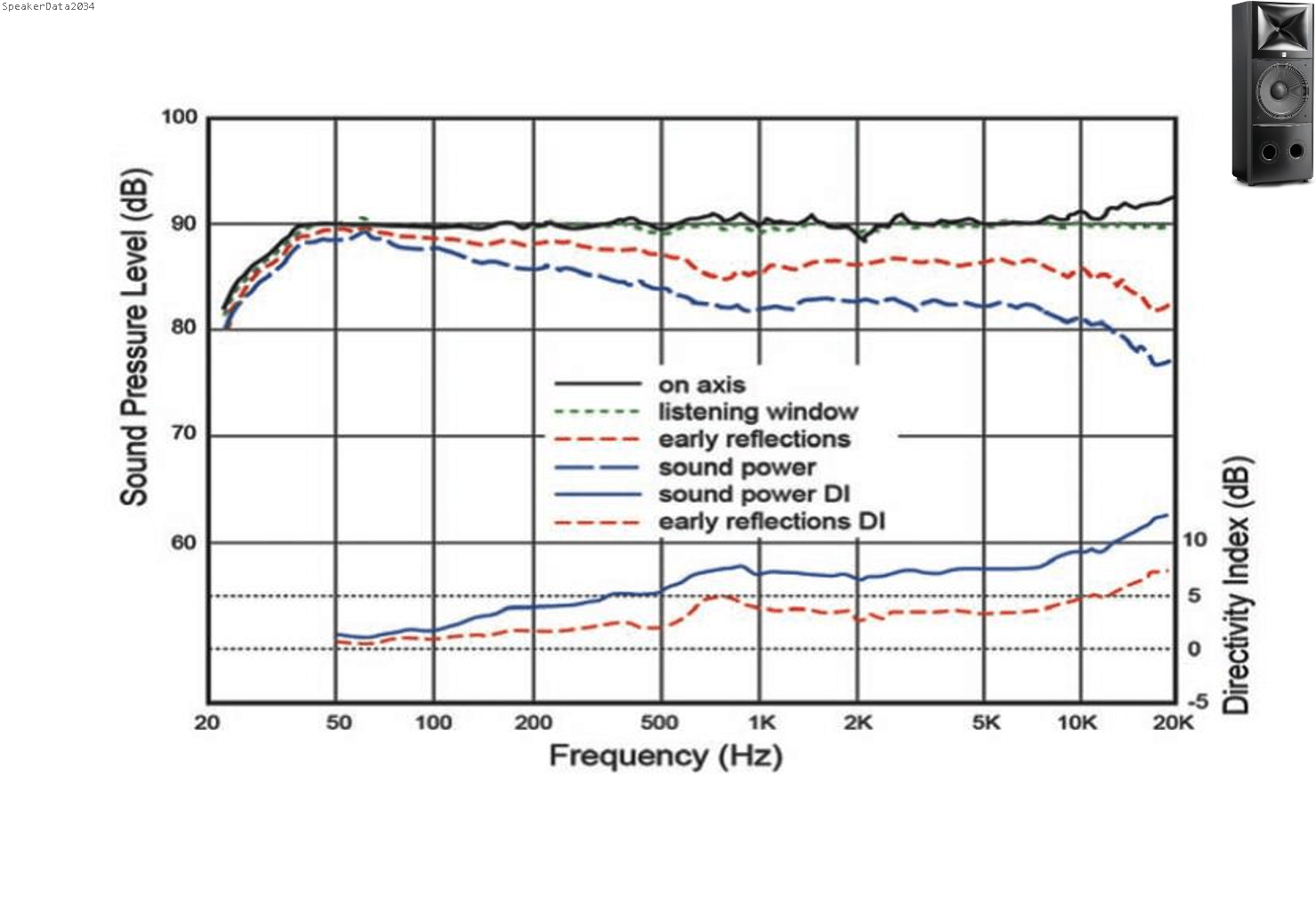

You have to be careful with optimizing to the preference ratings with a speaker design like this, JBL's own M2 does not score as highly as it may rate in actual performance.
Optimizing to the score works better with rising DI speakers, that should not be a surprise as the majority of the data used in it's creation came from rising DI speakers. You see this also in your 12" example.
A good target to start with for the bigger waveguide would be a 0.2dB/oct fall to the listening window response as the DI is pretty flat. There will be a kink in the PIR and power response where the woofer has less directivity. That is OK and not a problem to be solved by making the direct sound worse.
When optimizing to the score runs contrary to the findings of the research that went into making it it's time to pick a different target.

This what JBL does with the M2 and I am suggesting to do something very much the same except slope the on axis and listening window down by 0.2dB /oct
Learning the lessons of the research done is what is important and not prioritizing the score. Have a look here at Pierre's auto EQ algorithm on the M2 data. His algorithm targets a specific slope to the PIR to improve the score. Floyd Toole would not like the resonance created at 4 to 500Hz.
https://pierreaubert.github.io/spinorama/speakers/JBL M2/JBL/index_vendor.html

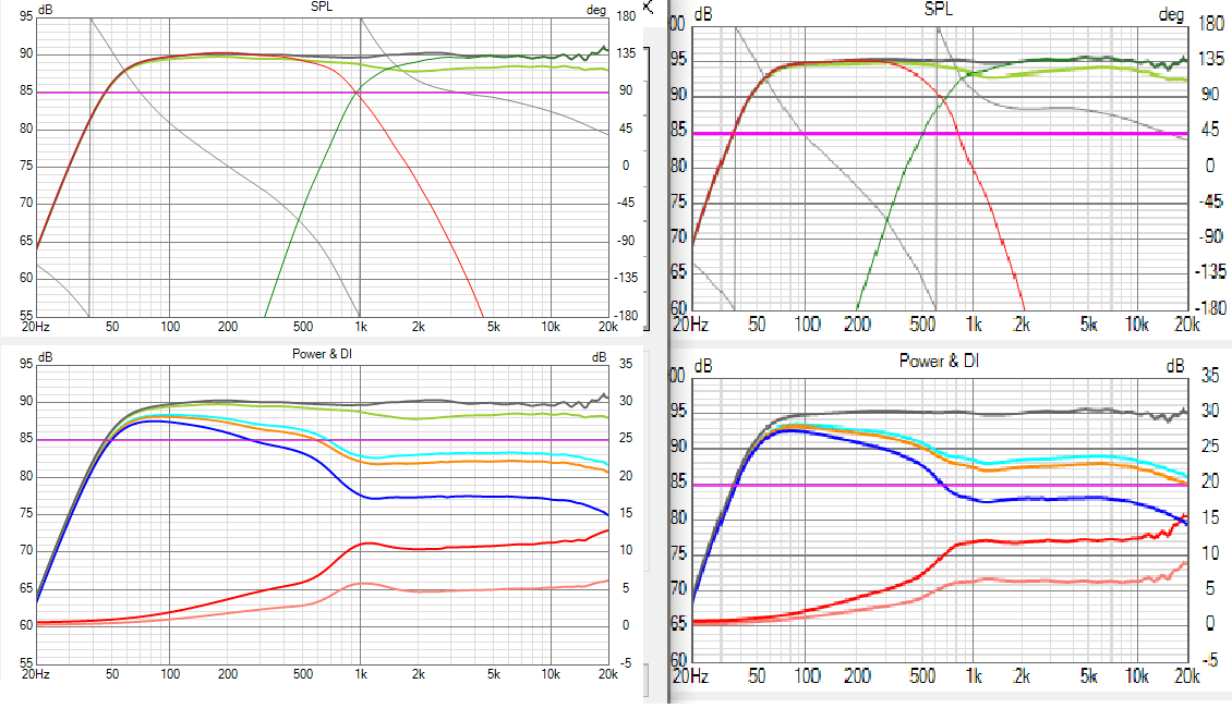

I've had a look, the raw waveguide response is a bit odd, I'm not sure that would reflect reality but if it does it will be a bit tricky on the low end. I had to use a bunch of shelving filters instead of a 1st order highpass to flatten the waveguide. I think you can see the general idea. I didn't go any further because the low end of the waveguide is making things awkward and I would mainly be compensating for that.
As you were looking at it the preference rating is 6.7 rising to 8.6 with a sub which is not bad considering, and shows most of it is due to lack of low end from the woofer pulling the score down.
After having played around with it, your version has compensated the woofer / waveguide directivity to be smoother but because of the slightly odd waveguide response it introduces a bow to the listening window making it peak by a few db's around 6 to 7K. In mine the waveguide is flatter in all curves until the directivity of the waveguide starts to rise. I think this would better represent reality.@fluid What is wrong with my version and what were you trying to achieve with your version? To the untrained eye, and I have two of those, they seem pretty similar.
And what is weird in the raw waveguide files? Should I be worried?
If you look at the raw response on the low end the roll off after the peak levels out to a steady state level. I think this is either due to your data export or vituix interpolating data that was not in your file.
