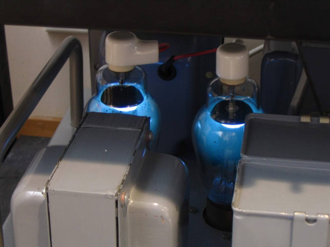

Bluey Baby Huey off at last.
Addendum.
In action at last.
Faulty Chian 5AR4 blew fuses. Replacement gave healthy 330V B+.
But: casual measurement of EL84 cathodes revealed one with a figure of 40V and rising 'til switch-off....aaarrrggghhh
What next!!
Replaced all sand on affected board to no avail. About to call on Ian for help, when had a flash of insight, and measured '84 grid voltage. Sure enough, one leaking green Russki coupling cap.
An RS replacement, and at last another reasonably well functioning amplifier, and a few less grey hairs.

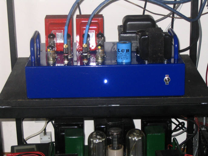

Square waves OK, but there's some ?oscillatory patterns on one channel; pleased to show if anyone's interested.
Hard to determine power output,being only either 4 or 16 ohm output and measurement setup is for 8, and the RMS AC voltmeter awaits repair. Seems about a clean 7W,with not-so-clean 10W headroom.
The pic shows her feeding an ancient pair of Concertos, and sounding a bit rough to be frank,but is it the amp or the speaks??
Bass is terrific though, and sound very detailed,if top heavy.
In conclusion, thank you to Ian for his inspirational design, and the welcome help of others in this enterprise. Now for a much simpler PPEL34 amp.....

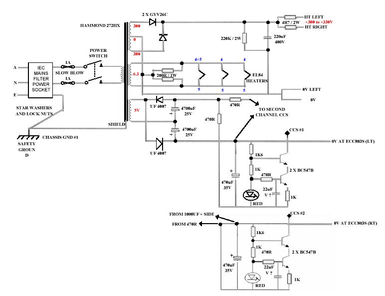

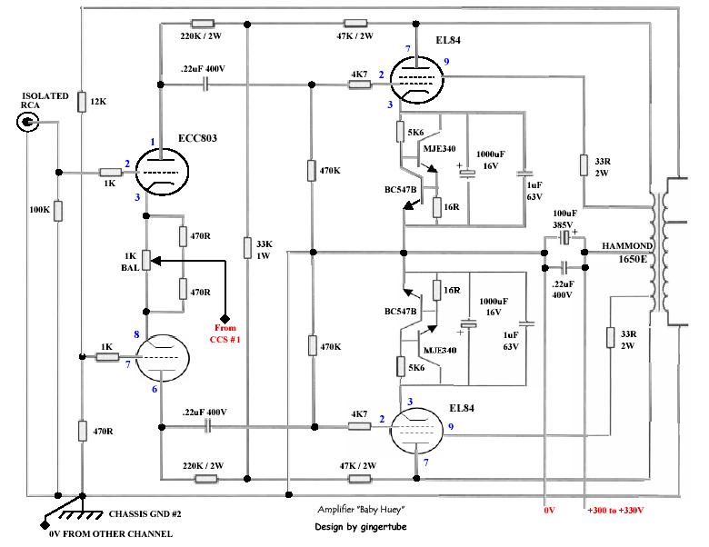

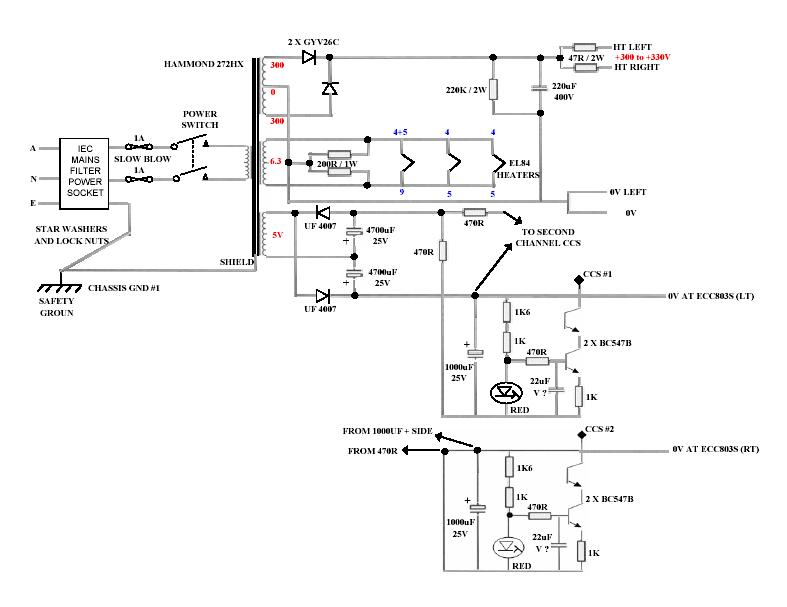

Hello gingertube and others. After reading through this thread I am curious if the attached scheme is correct. Also I would like to use a pre amp and wonder if I have this correct without the log. Sorry I am very new to this stuff, so trying to learn as I go. One question I have is where does the 0V at chassis ground #1 come from on the other channel? Any input would be greatly appreciated.
dstockwell,
Schematics you posted look good except for:
On the Power Supply sheet there seems to be a missing connection from the bases of the top CCS transistors to the junction of the 1K6 and 1K resistors.
The Hammond 1650E you list is 15W rated and MAY give better bass, however if you wish to save a few dollars the smaller Hammond 1608 would be OK.
On my current tweaked version of the EL84 Baby Huey I have:
1) A&R 4016 Vintage Oz potted Output Transformers (8K:4 ohms, 43% UL taps).
2) The 18K shunt feedback set resistor shown in your schematics is 33K.
3) There is no global feedback
4) The bypass capacitor network across each EL84 cathode currentsource is 1000uF/16V Blackgate with a parallel 1uF Polyphenylene Sulphide (PPS) cap.
5) The series resistors in the High Voltage feed I use are 4R7 2W but 47R will probably be OK. If the amp seems to lack some bass impact and slam try reducing this resistor - otherwise leave it at 47R.
On the earthing:
There MUST be a Chassis Earth #1 - Safety Ground close to the mains input socket and mains filter etc.
The will be a second chassis earth connection (for the 0V rail) preferrably near the ECC803 and toward the opposite end/corner of the chassis from the safety ground.
From this chassis connection a left and right channel 0V buss runs out and eventually join each other again at the main filter capacitor 0V connection. The earth wiring is in the form of connection along the 0V buss follows schematic - that is closest to the 0V chassis connection will be the shield of the cable which runs back to the isolated RCA input connectors, then the ECC803S grid resistor 0V side, then the cathode CCS 0V connection etc.
This Scheme keeps the high return currents such as the main filter cap charging currents at the far end of the 0V buss and away from the sensitive input circuitry.

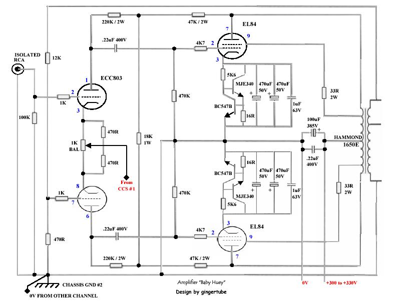

Ian
On the earthing:
Ian
Yes,
I would suggest that you remove that 12K global feedback resistor from the output transformer secondary. Leave everything else to that triode grid as is. You can always put the global feedback in latter if you feel you need it after listening.
The cathode bypass capacitor shown as 1000uF/16V - this value is just what I happened to have in my Blackgate capacitor box when I was experimenting. Either 470uF or 1000uF caps can be used BUT I would be happier if they had bigger voltage rating - say 25V rated minimum.
Higher voltage rating caps generally have lower ESR so - for example, if were using common electrolytics which can be bought from the local electronics store I would use 470uF/63V or 1000uF/63V
Watch the output tube dissipation. For a rail of 300V to 325V what is shown is fine. If the rail is 330v to 350V then change the 16 Ohm resistors in the "ring of two" current sources in each EL84 cathode to 18 Ohms to drop idle current from 38mA to 34mA
Ian
Ian
