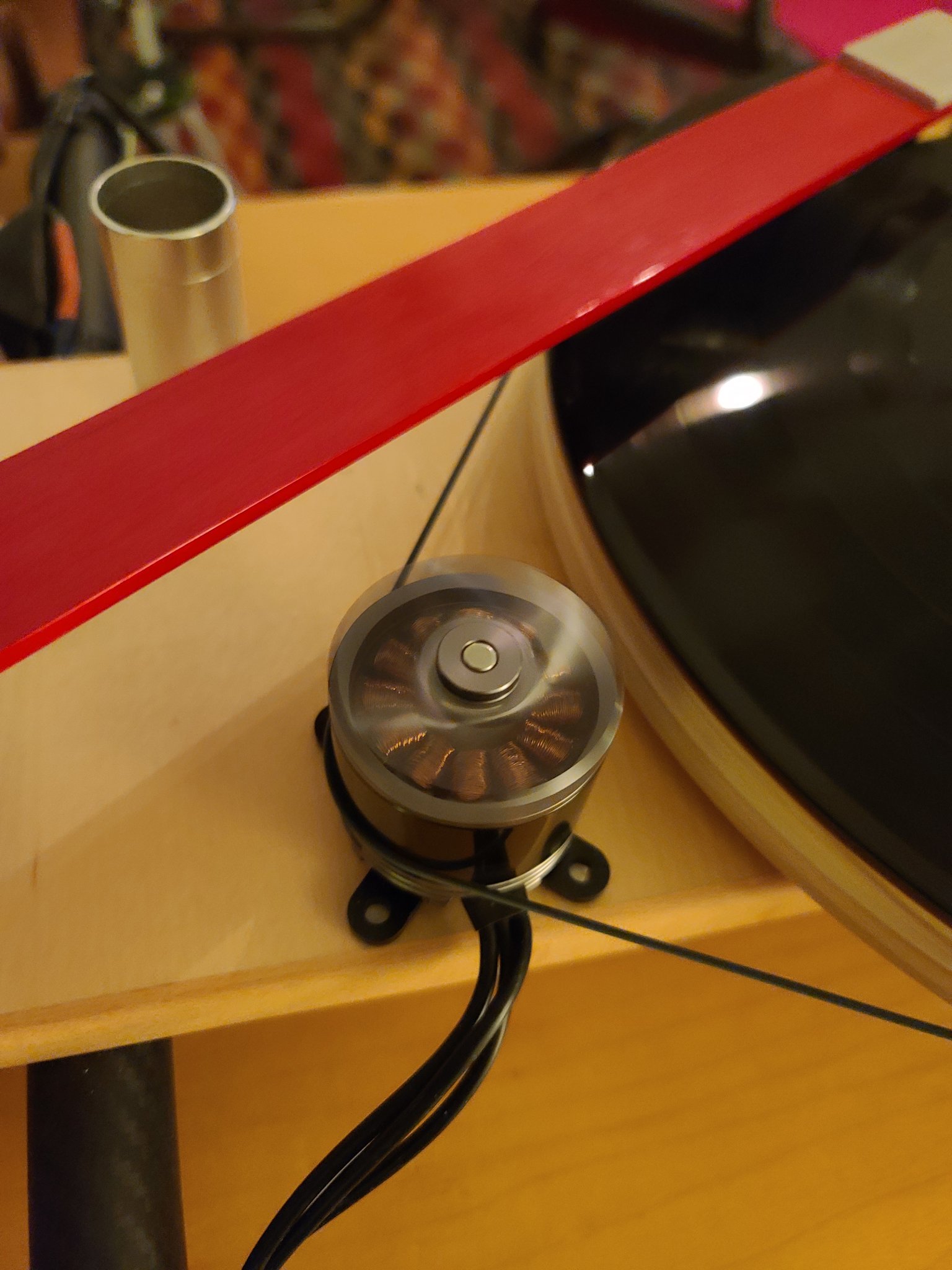

The Anaheim BLDC motors have sinusoidal BEMF and produce very little torque ripple (see attached); they are extremely smooth and quiet compared to a PM AC synch motor. The RC controllers drive a BLDC motor as a DC motor and uses block commutation (trapezoidal) so they will have torque ripple and the speed will slow under load. The speed is determined by the DC voltage and the load. When driven this way, you will need an encoder attached to the motor or accurate speed control.A BLDC motor is the wrong motor to use in a TT, you need to PMSM motor. BLDC motors have a trapezoidal back EMF which causes high torque ripple. PMSM motors have sinusoidal BEMF and when controlled properly have very low torque ripple. Doing this from scratch I would use a microcontroller someathing like an STM32 and use FOC. STM have all the libraries and hardware to do this out of the box.
The motor in the Technics SP10mk2 has sinusoidal BEMF so is PMSM not BLDC.
The SG4 (and RichB's solution) drives the BLDC motor as a 3 phase AC synch motor so the speed is determined by the drive frequency and is synchronous so it does not slow under load. The SG4 thread has links to a 3 phase amplifier that will drive one of two different Anaheim motors; it only works with those motors. If you attempt any other motor solution you would be on your own.
Sorry guys it wasn't my intention to open a can of worms I tried the BLDC motor and failed (not happy with result) and gave it a pass end of.

Ahhh I think you need a Sensored Motor with a Sensored ESC - that will give you a very good start stop, Also some ESC like Castle MambaX have programablitiy to set the starting Torque ( punch ) and Breaking strenght. though these ESC are expensive a Set of Motor with ESC is around $250.I do prefer DD turntables so much so that I even bought an hoverboard to test one of the motors that turned out to be a big failure because the motor (BDLC) has small neodymium magnets that causes steeps like a stepper motor.
You live and you learn...
Other ESC + Motor Combo ( sensored ) is hobby wing ( chinese ) but many of the Brands are using the stock ESC from this firm
Look up Amain hobbies or Hobbywing website or LHS
If it has sinusoidal BEMF it's a PMSM motor NOT BLDC by definition
Don't tell me, tell Anaheim Automation; their website must be wrong.If it has sinusoidal BEMF it's a PMSM motor NOT BLDC by definition
It's BLDC. It has hall sensors. AA sells BLDC controllers to run their motors. Not all BLDC motors have trapezoidal BEMF.
I'm done with testing I went online and bought a EDS1000 with complete wiring and it runs like a champ, steady and quiet and the investment is not that different from starting from scratch with any time of motor (DC, BLDC,PMSM or anything else) and controller combination.
