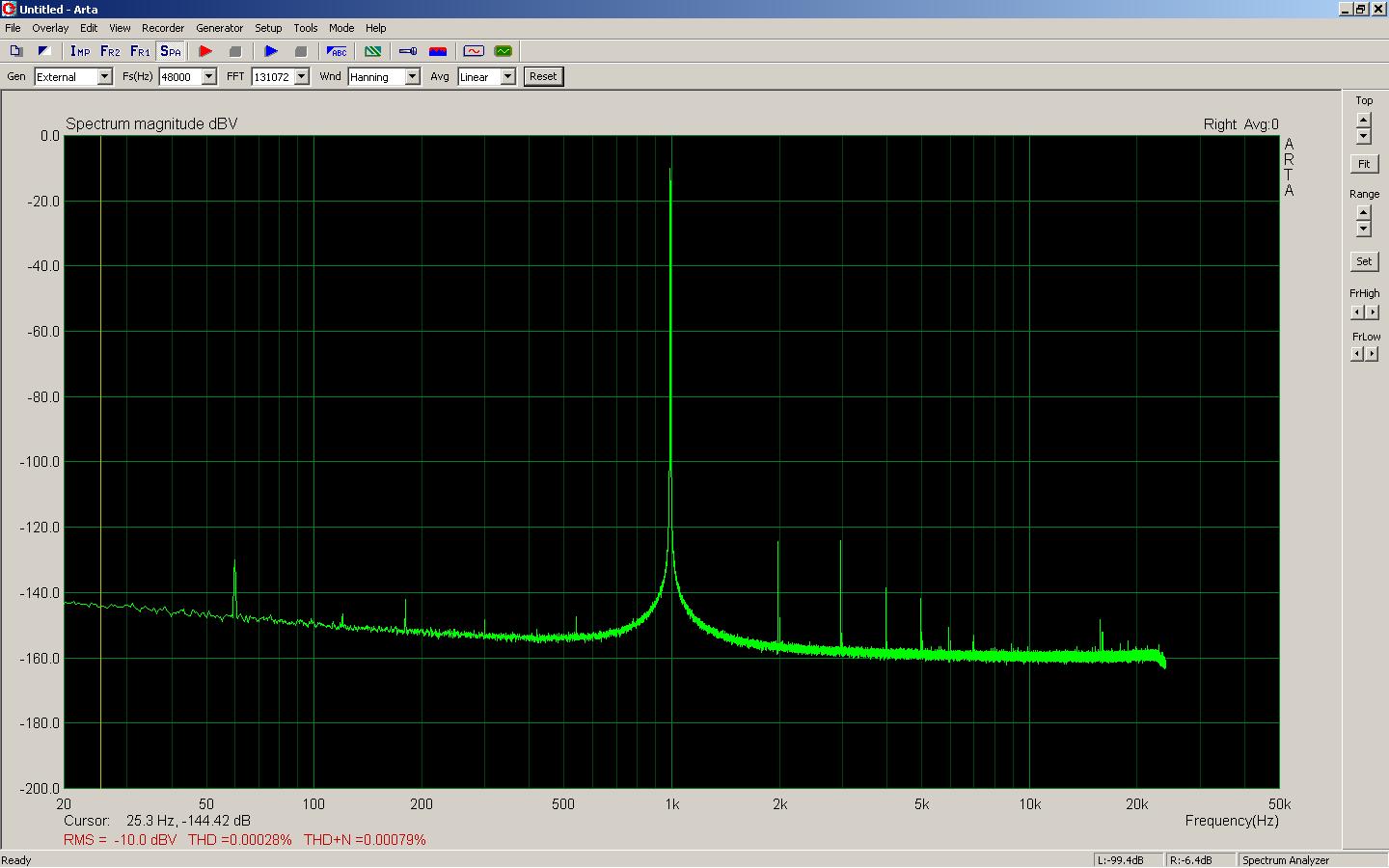

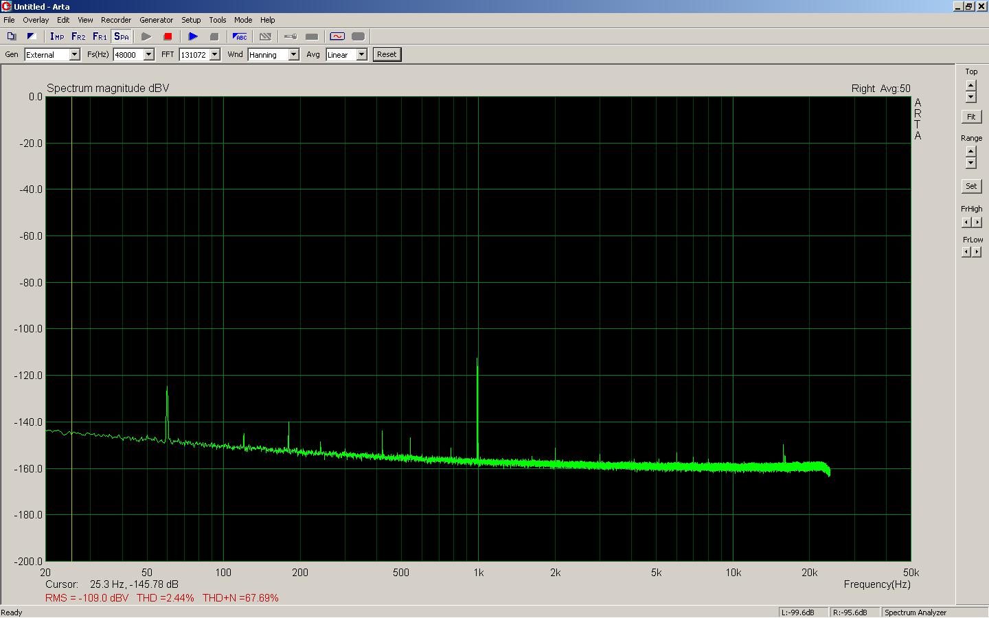

You should be able to clean up all that grass above the harmonics. The loop back might be creating this. Do you have an external oscillator you can try? The EMUs are very sensitive to grounding.
This is the unmodded channel set to 0.1Vrms FS
Unfortunately I don't have an external oscillator that performs better than the EMU's own DAC. The 'grass' is almost all harmonic content - i have a feeling it might be caused by ARTA only having a 20bit dither or just a hardware limitation of the DAC but i'm not an expert on the topic :p
One weird (to me) thing that i noticed is that the 1/4" jack is a stereo one. The 'right' and 'left' terminals from the socket go to the opamps and the 'ground' terminal goes to AGND. The 'right' terminal has 10k between it and AGND. I guess this is so it still works with differential/balanced outputs? Any idea what affect this would have on using a stereo vs mono cable? I'm using a 30cm mono cable from the 1/4" 'right' output.
edit: the original circuit is perfectly well behaved when driven by a balanced input. It only becomes a problem when one input is tied to AGND. Both of our mods cause it to become asymmetric when driven by a balanced input. I guess there was method in their madness.

If you could put a schematic up it would be easier to answer that question.
ok, some schematics.
Standard circuit, driven single ended. The tip of the connector is the + of the sine voltage source
, the ring is the - of the sine voltage source, and the sleeve is connected to AGND.
Shorting the negative side of my input source directly to GND makes no difference in the simulation compared to just letting it ground itself through the 10k resistor (I haven't traced out where this resistor is on the board yet).
Standard Circuit driven with balanced input - tip and ring are a balanced pair, sleeve is GND.
As you can see, it doesn't suffer the same problem.
If someone wanted to, they could remove that 10k resistor wherever it is and have a HighZ balanced input. This would probably then cause problems if it was driven single ended and the sleeve was left floating.

Well the ring should short to sleeve which is ground in single ended use. If you plug in a mono plug this is what happens unless Emu used some funky jack that doesn't.
