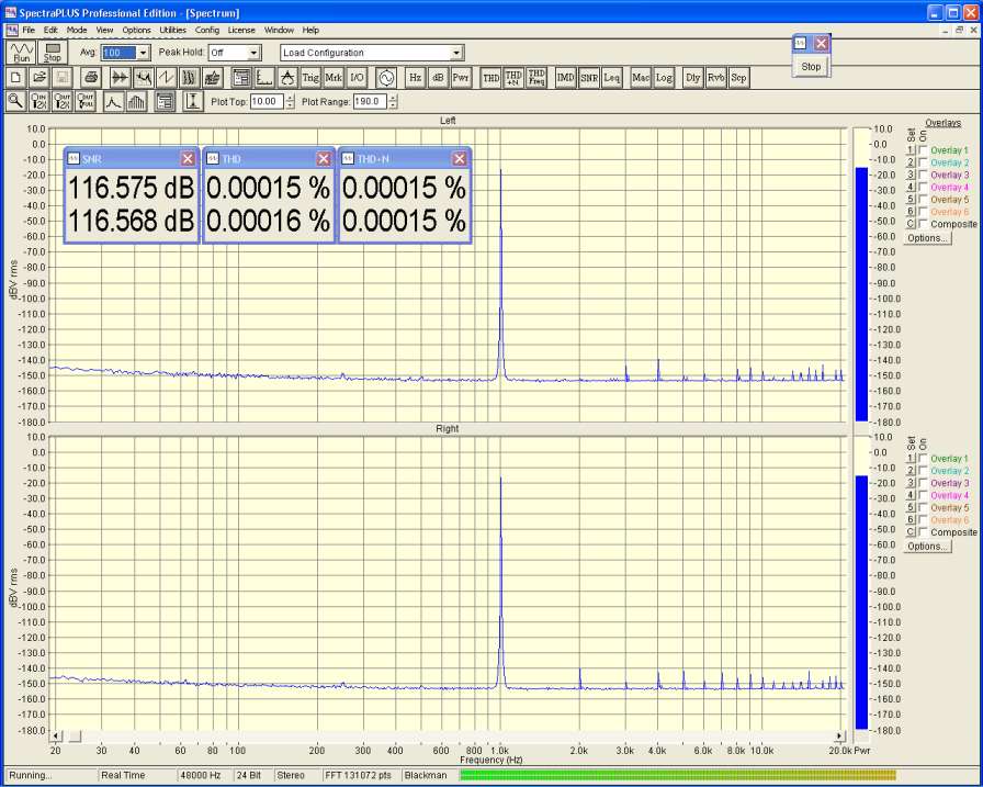

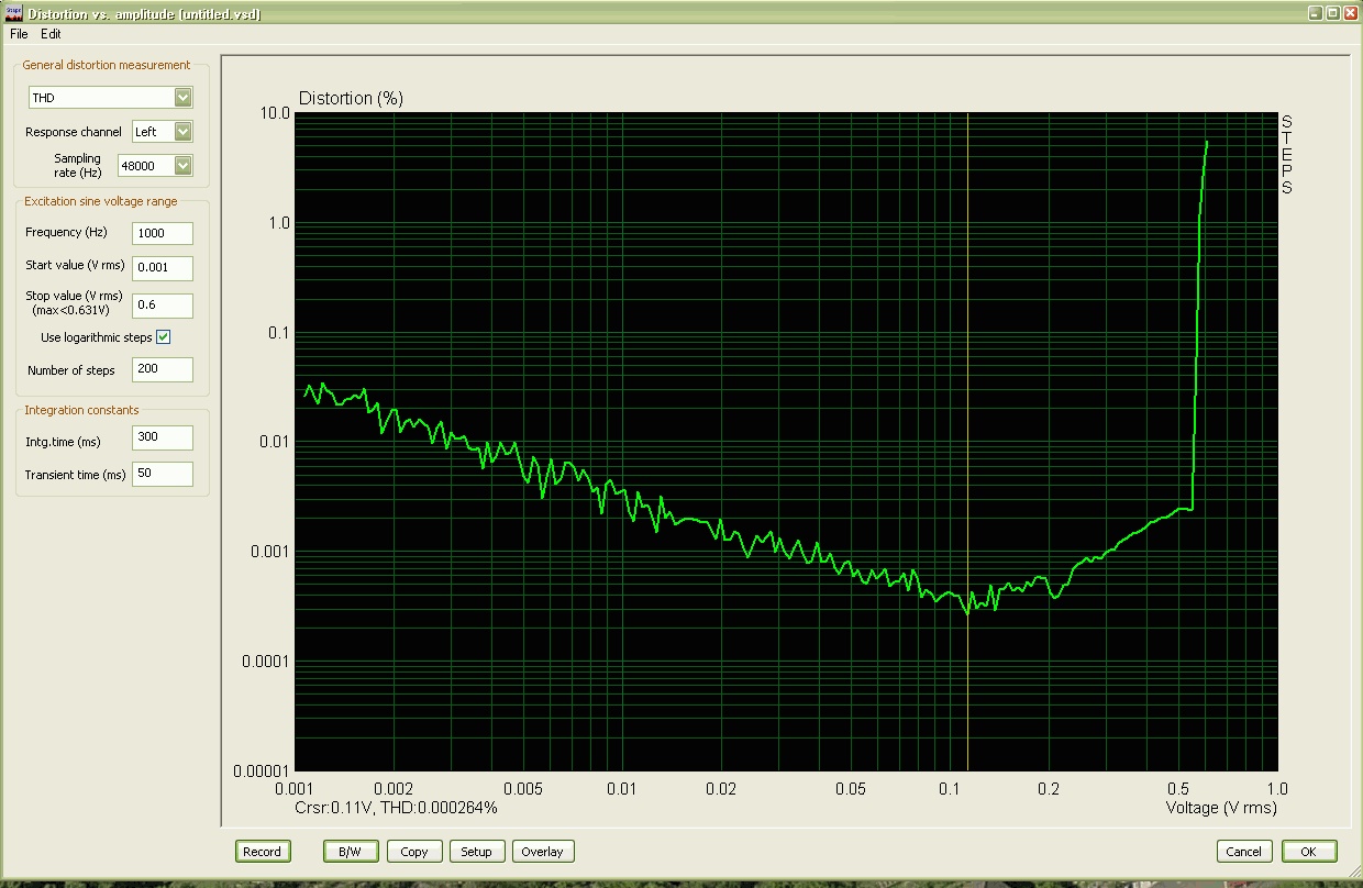

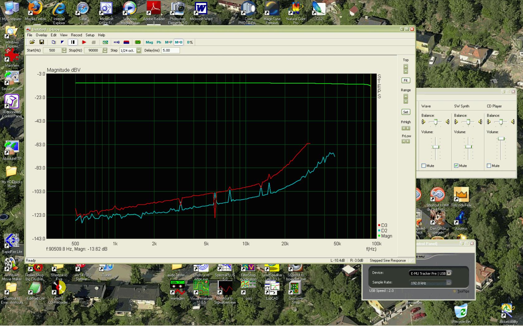

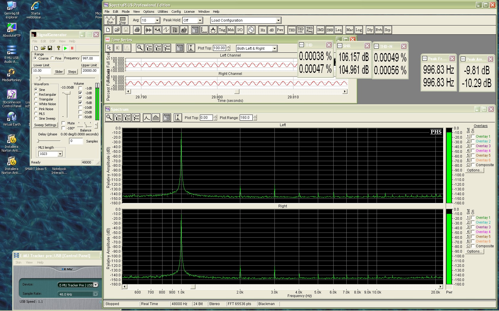

Here are a few of my own Tracker Pre measurements in loop back I did in 2011. Both with 48k and 192k. 48k gives lowest THD. 192k is only for testing.
Still not good enough.
/S
