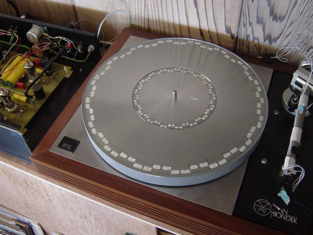

OK, I've been looking at this thread from time to time, but have had trouble understanding the details of the project and process.
Let's see if this is right:
Mostly right? Corrections from Bud?
Question: If doing the treatment on a non circular surface, like a baffle edge - how many pairs of blocks? What size blocks?
Thanks for sharing this with us Bud. I just want to be sure I under stand the process before I try it.
- Blocks have 2:1 aspect ratio.
- 2 rows of 36 blocks.
- Blocks in 18 pairs per row.
- Block size scaled to fill circle circumference with 18 pairs.
- Gap between blocks in each pair = ??
- Gap between pairs equals length of one pair.
- Rows offset with gap in one row being aligned with block pair in other row. (see photos)
- Gap between rows equals ??
- Paint used is "Polly-S" acrylic paint for scale models. Polly Scale is now owned by Testor. Should be found in any hobby shop. Other acrylic model paints should work.
- Calligraphy pen tip used to apply paint. Choose tip size to correspond with needed block size.
- Treatment applied at edges and/or shape changes.
Michael.
You have almost all of the needed information quite correct. Here are my comments, organized by your bullet points.
The aspect ratio per block is correct
Some times three rows, but only where there might instead need to be four rows. The junction between cone and center dome or dome and noticeable surround. The center row is placed right in the valley of that junction with an offset row on either side, mirroring each other. Otherwise two rows of 36 blocks total.
Blocks in 18 pairs per row, so a triple row would have 54 total blocks.
Blocks are scaled, a pair equals ten degrees, four degrees per block and two degrees for the space between each block in a pair. The block thickness equals this two degree space so the space between two blocks is roughly a square.
The space between rows is also equal to two degrees of space width at the block gap, of the lower pair.
The gap between pairs in a row equals one pair.
The Poly S paints have been my historic choice. The paint seems to stick to all materials and forms a hard surface without shrinkage. This can be very important on delicate woven domes. I use only flat paint because it has the highest solids content and flat clear because it has no pigment in it to soften it. From the activity of some people here on this forum it would appear that I do not have to take so conservative a stance, but it is what I know works.
The A series calligraphy pens work the best, held upside down as is shown in the Lowther treatment pictures, from the link embedded on page 13 of this thread.
Choice of calligraphy pen should be made based upon the pen tip that is narrower than the 1 degree width of the block you are going to draw. You do not need to change pen tips for blocks in different, adjacent rows.
Pattern rows should happen at or near every reflective interruption of a surface, that has transverse waves moving across it. You can do too much here and a surface that has been treated with a row, at one edge, does not need to be treated again till the far edge is reached. You may have treatments around specific discontinuities between these edge treatments, like driver bezels or design cracks but you may not be able to tell if it was really needed.
You need to be aware of some exceptions. For the center of a dome a two row ring should circle a center dot of paint. That dot should be small, 1/16" diameter for a 1 inch dome, up to 1/2 inch for a four inch dome. These two rows are comprised of no more than 12 block pairs total, six per ring and no fewer than six blocks total, or three per ring. Their purpose is to force the energy off of the dome before it can emit from the center point in a beam. I always place a small dot of PVA (Elmer's White Glue) here and put a single coating over the pattern, center dot and nub of PVA.
If you are treating irregular edges or rectangular edges treat them as if they were a diameter of a circle and determine the block size by dividing the edge length into 36 spaces and using the above relationships for block size and spacing. This works well until you get into very large surfaces. You can fake it when you get to corners that are difficult or did not align with the pattern lengths perfectly.
This is not a demanding pattern. You can make all maner of mistakes and pen blobs without causing any harm. Best to try out your hand skills on either plain paper or cheap cones. One interesting thing to do is to treat the dome and inner well of a small cone first. Then hook the driver up to a musical source and begin to draw the outer rings. As you get close to closing the rings listen carefully to the changes. When you do close the rings, the sound will "pop up" off of the cone surface with an almost holographic presentation, that you can hear down into quite easily. Just an amusing thing to do, but you can be certain that driver is properly treated.

The distance between the patterns rings are not the same. If this also works, I'm sure any broken pattern will work. Actually it looks more cosmetic and a chatting subject. But mat design is a much different beast. Soft mats don't provide the proper support to extract signal details from LPs. Treating a mat like that provides just a different sound balance due to change in the vibration modes.
