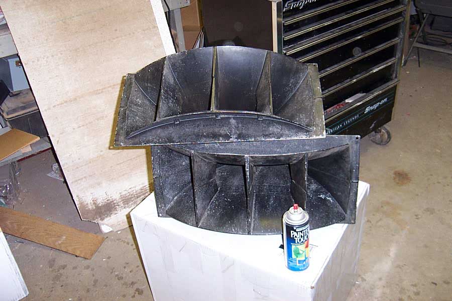

I plan on putting into service a pair of Altec 511b horns in the future. In addition to horn damping, I am interested in trying your EnABL process. Are you familiar with the horn and if so, would you offer any suggestions?
Thanks,
Marc
Edit: I just scrolled back and I see a lot of requests for specific suggestions! If you don't find the time to reply I certainly understand!

I have very limited experience with horns. Every one of them I have treated ceased to have the horn sound coloration that some had more of than others. The resultant sound was a bit more detailed or a lot more detailed, depending upon the treatment level and the design sophistication of the compression driver assembly.
The other important result is the increase in intensity. The intensity is solid right across the angle of the horn, so the "sweet spot" increases to that included angle and directly on axis looses it's extra emphasis. This was true with rectangular, oval and conic horns. Also true of what drove them, with even piezo electric horns becoming crystal clear. I still don't care for their sonic qualities but they are quite clear about them, after treatment.
Look at the white paper here.
http://www.positive-feedback.com/Issue21/standingwaves.htm
About two thirds of the way through, a patent drawing of a typical horn treatment is shown. This will give you an idea of how to go about this process.
If you are interested in greater intensity and dispersion I do recommend trying it out, since you can remove it if you are not impressed.

Thank you for your reply Bud. Yes, I had seen the paper which is what lead me to the question. I should have been more detailed in my question. Attached is a pic of my beater 511Bs. You can see that they are divided. These divisions do not go as far as the throat - they are only about 1/3 the way down from the front of the mouth creating cells - almost. Should I treat each 'semi-cell' as an individual entity or should I ignore the dividers and just treat the mouth ?
Also, I will be applying a new finish. I was going to use just a flat black BUT I am wondering if maybe a glossier surface may improve the effect of the treatment?
Thank You

Go ahead and finish your horn to taste, allow it to cure for a while and listen to it until you are familiar with how it performs at low levels, with occasional excursions, of course.
Measure the entire flare end size and, using polar coordinate paper, derive a general length per block. This is the size to use for a single set of block rings at the flare aperture. To treat each cell you take a single cell dimension and convert it into a round circumference, find the radius or diameter and find the appropriate ring on the Polar paper and, using the radians divide a 10 degree block up into 4 degree, 2 degree, 4 degree of arc sections and then measure the length of each 4 degree block arc. This is the general block length you will need to use to make a straight line pattern, whose block size suits the edge being treated. Use this same activity to derive blocks for a full flare end treatment also. Regardless of the calculated block length I would not use an individual block sector, of 4 degrees, larger than an inch in length, no matter where you might be putting it.
Applying rows of blocks to every cell will provide greater impedance to the horn boundary layer and you will likely have to use the Micro Scale, Gloss Coat acrylic paint to increase the thickness of the boundary layer. You will get the greatest amount of control with this scheme, but, you may not need that much control over the energy moving down the horn attached to the boundary layer. In addition you really do want to treat the horn throat as well, right where it attaches to the compression driver. Definitely coat the pattern rows at the throat with Gloss and maybe the blocks at the flare end if it is a single set for the entire flare end. If you go for the cell patterns you will have to coat those and may have to coat the entire inside of the horn, at which point you might as well take care of the cell entry edges also. You could get quite extremely crazed here and with only a modest benefit over the pattern applied to the whole flare end.
The hardest task here is not to do too much, best to do just enough and leave it at that. Then, as you improve the rest of your system using these newfound tools, you might do more to top it off. Just take it slow and step by step is my advice, but definitely treat both ends of the horn terminus's.
Bud
