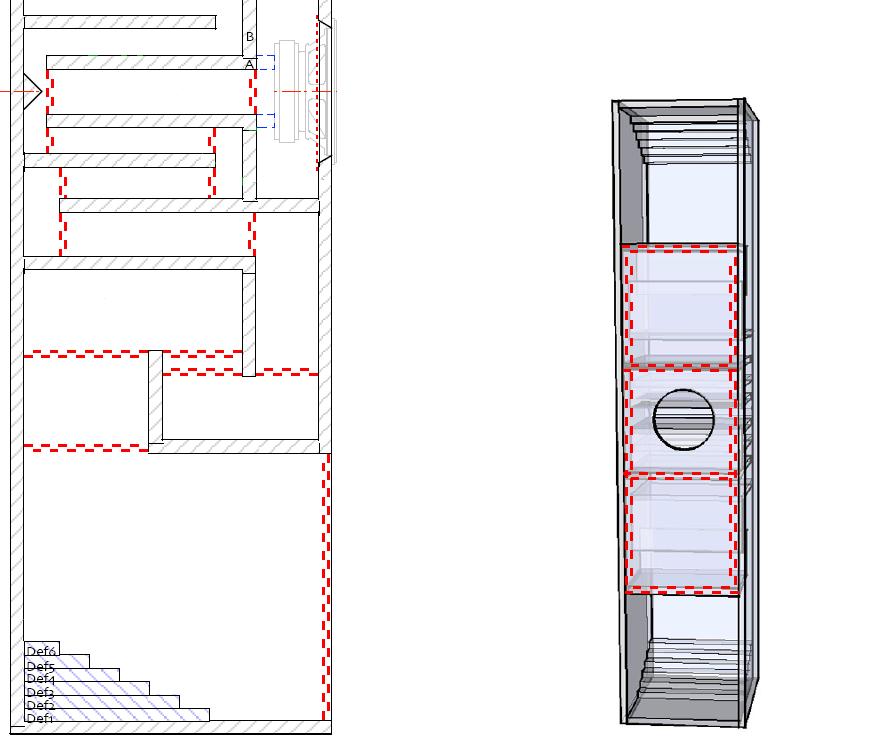

Alan Hope said:I am about to make Sachikos. These are double folded horns with stepped resonators. What if I EnABL'd bothe ends of all the resonators?
Hard to see any possible down-side here, and wouldn't be particularly hard or time consuming. Problem is I wouldn't have a before/after.
Still haven't EnABL'd my phase plugs yet. Getting my ears/brain round the current sound in detail before I do that. The phase plugs themselves made too much difference to let me evaluate EnABL for them.
I think - if EnABLing the phase-plugs makes a difference, then I will also do the resonators in my Sachikos.
OK guys, lots of hyperbole from Bud in his own unique style, but it's still a black art for us all so what the heck! Just read between the lines and don't even try to take his "science" at face value.
G'day Alan,
I've attached a picture of where I would try EnABL the horns.
This is a massive amount of work to EnABL the horns this way.
I'm thinking that EnABLing the horn this way may help to minimise the resonance of each section.
Let me stress this is just an idea which has flowed from my experimenting with baffles, ports and compression horns - so results are unknown for BLH.
Picture on left - I have only drawn the bottom half because the top is a mirror image.
EnABL pattern is in red and goes around all four sides of the horn duct (ie. the circumference of the horn) at the places marked.
The dotted red line behind the driver is EnABL on the back side of the baffle immediately surrounding the driver.
Picture on right - shows EnABL on the front baffle.
This is how I would tackle this:
1. Make both horns with a removable side panel.
2. Listen to the horns untreated until you get an idea of how they sound.
3. EnABL one horn only and listen to them in stereo and A - B in mono - you will hear the changes.
4. Adjust according to what works - and tell us about it!!
As for the stepped resonators near the mouth I would leave them as is.
Alex

Thanks Alex.
Hmmm. I will not be able to EnABL one and leave the other for A-B comparisons because the EnABLing will have to be done during the construction process. Sorry guys.
It now sounds like a bit of a risk to me. The resonators are central to the speaker design so I may mess things up here.
Dum de dum ... what to do ...
What the heck - The EnABL effect on sound has produced very little in the way of critical comments. So I WILL EnABL them. Live dangerously.
I can only then report on the speaker sound in relation to other DIY hobbyists reports. Just need a break in the weather now to start construction.
Got my silver in teflon hook up wire ready, and silver plated binding posts. These are going to be my final speakers.
Maybe
