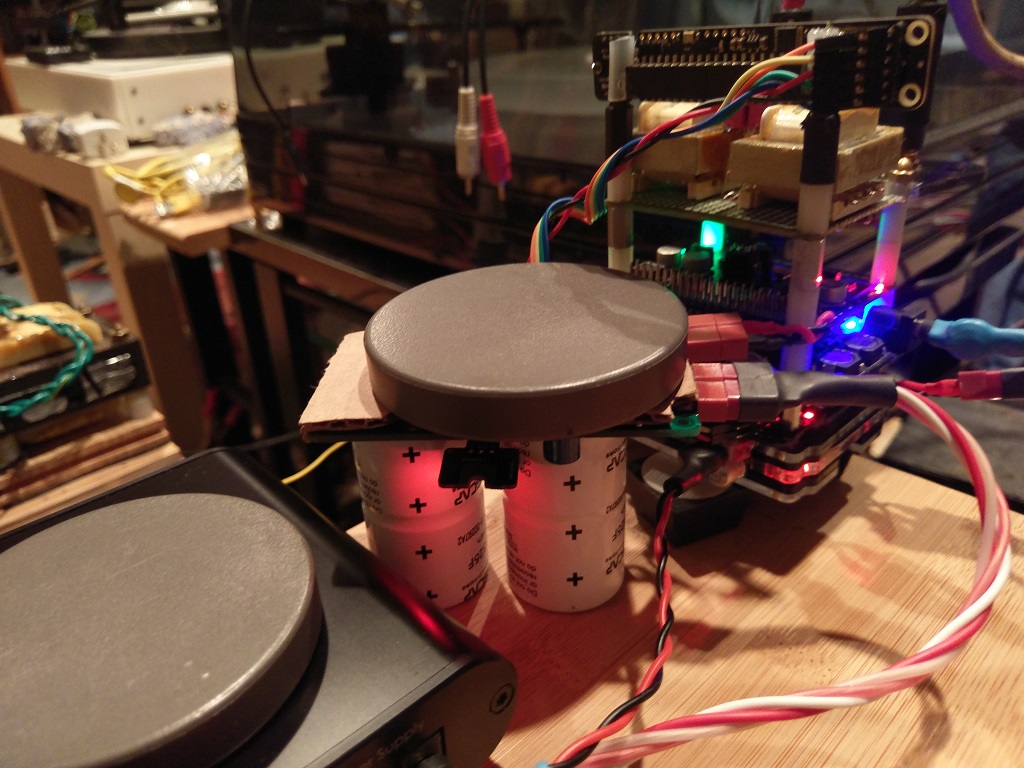

To followup on our emails earlier this week, I have run your prototype ES9028Q2M DAC board I have here using one of the UCPi boards I built up here... Very nice.
I charged them up from an Uptone Audio LPS-1.2 and did try the setup with the charging voltage connected and disconnected... with these, I heard a little degradation, but not much. AND I tried it with both an earlier LPS-1 and LPS-1.2... I slightly preferred the LPS-1 as a connected energizing supply.
The connected charging results are preliminary and I'll go over that a few more times to confirm... and Ian likely will too.
OTOH, the SQ with the UCPi powering the DAC card is pretty definite... my advice is don't try this unless you want to spend the effort and $ to set this up in your setup powering as many source components as you can. My next try with this is to use the other 2 UCPi I have to power the IsolatorPi and Allo.com Kali in the stack separately and see how that sounds. In both cases they are currently powered from an LPS-1.2 each AND they have local LDOs, so I'd be feeding them 5V.

Hi Greg,
Nice set up. Me too have similar experiences to you about the UCPi.
Ultra capacitor and LifePO4 direct power supply are so far the best power supply solution for DAC projects. Nothing can compared. Even the ultra low noise LDO are far from. Because the key thing is not only the noise, but also the load response performance.
Agree with you, once you switched to this solution, you will never get back.
Both solution have unbelievable improvement to the sound quality. Ultra capacitor solution is a bit expensive and complicated. LifePO4 will be cheaper and less complicated and also smaller good for a power supply integrated total solution.

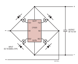

Your comment about AC-DC conversion noise reminds me of a solution I don't see used very often in audio: the use of mosfet "smart diodes" in bridge rectifiers. While the designs add complexity, they provide noise advantages over conventional rectifiers and much lower losses.

That's actually a super smart solution! I might buy the eval PCB and try it out on DAC or preamp.
Do they have the same for more current applications such as an amplifier?
Do
The current is really limited by the mosfet choice, and they claim up to 100 Amps can be achieved. The LT4320 chip has an upper limit of 72 Volts, so it should be fine for most power amp applications.
There are 2 main advantages: 1) the switching of the mosfets is synchronous with both the AC input and the load voltage, so there is little or no reverse recovery noise or ringing as exhibited by conventional diodes and 2) using low Rds-on mosfets results in very little heat dissipation and voltage drop.
The data sheet is here for those interested.
As mentioned, there are eval kits available, but I think to build a very high current bridge, you would need to roll your own and worry about the thermal aspects of the mosfets.

Yes - that is pricey! If you are OK with PCB layout software, you could probably get your own proto board made cheaply. I am thinking about this for my next project PS.

Good find! Yes - you would need to add filter caps, and there does not seem to be any info on the mosfet types he used. Also - it is hard to tell how much dissipation the board can handle - although it is 4 layer, so should have a fair amount of copper.
You can probably email the developer with questions - take a look at his github page. Bersh (Illia Bershadskyi) / Repositories * GitHub
I think this would be a good way to prototype an ideal rectifier.
