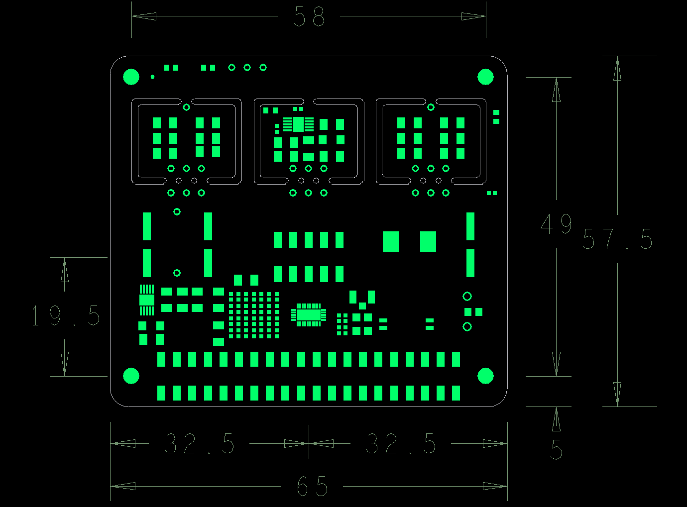

ES9038Q2M dual mono DAC HAT
I did some ESS DAC HAT comparison test a couple of months ago.
https://www.diyaudio.com/forums/pc-...i2s-dac-hats-raspberry-pi-31.html#post5440848
Based on the actual listening test. I found the ES9038Q2M dynamic performance and quality was not as good as ES9028Q2M. The output impedance of ES9038Q2M is 774 ohm higher than ES9028Q2M's 403ohm. I suspect that is the main reason.
So I designed this ES9038Q2M dual mono DAC HAT. In this configuration, the internal impedance of ES9038Q2M will become 387 ohm, lower than ES9028Q2M.
I'll do a comparison test between signal and dual mono configuration ES9038Q2M DAC HAT very soon to see if there is any improvement.

Hello Ian,
Really enjoying reading about your experiences. A note on DAC output impedance - for a current output DAC like the ESS parts, the output impedance is supposed to be high. In fact the impedance of an ideal current source is infinitely high.
A possibility is that one of the DACs is producing more harmonic distortion than the other, giving the impression of greater dynamics. All sorts of other possible reasons too.

Hi Markw4,
Thank you so much for the suggestions.
Yes, I've already noticed that ES9038Q2M sounds very good when it's playing native DSD music. AK4137 is an interesting SRC chip which can up-sampling PCM into DSD256 on the fly. There are some AK4137 boards on eBay. I'll buy one to give it a try once I get time. If I'm happy with the result, I'd be more interested in figuring out how to run it at synchronized mode rather then ASRC.
As you mentioned the 100MHz Crystek clock, I think you are still using ESS DAC at async mode. I would highly recommend you trying the true sync mode, it really makes big difference.
Regarding to the sound quality of power supply, I found passive power supply such as ultra capacitor or LifePO4 battery are superior to any LDO or voltage reference. So I open a new R&D thread which is here:
Develop ultra capacitor power supply and LiFePO4 battery power supply
I believe your LME49720 AVCC buffers following an LTC6655 3.3v reference is also very good. But maybe you are interested in getting them compared to see what's the real difference. Both ultra capacitor and LifePO4 battery cell are very easy to be tested in a system.
BTW, I still have 6 or 7 of the ES9038Q2M prototype PCBs, and maybe also a couple of standard OP amplifier I/V stage PCBs available for sharing. Please let me know if you or any other community members need them for your/their project. PM me the shipping address, I can send them to you for free. I'd be very glad if they can be any help. For the well known reason, no schematic will be provided. But I don't think there is any problem to figure out.
Ian

@soundcheck
That sounds very reasonable. I'm fully agreed with you. It seems you did a lot of research into ESS DACs. Thank you so much for sharing.
To get best sound quality out of a given ESS DAC, I think the following three things are very important:
1. Power supply;
2. master clock;
3. I/V stage
Talking about the DAC chip itself, I normally tend to design this section as clean and pure as possible to keep the style of that particular DAC no change.
I'm not against having a DSP or SRC before DAC, but they should to be designed as optional and independent module to make it easy to switch back to native stream. Also, have to run them in sync mode and make sure do not degrade any to the clock quality.
Ian
