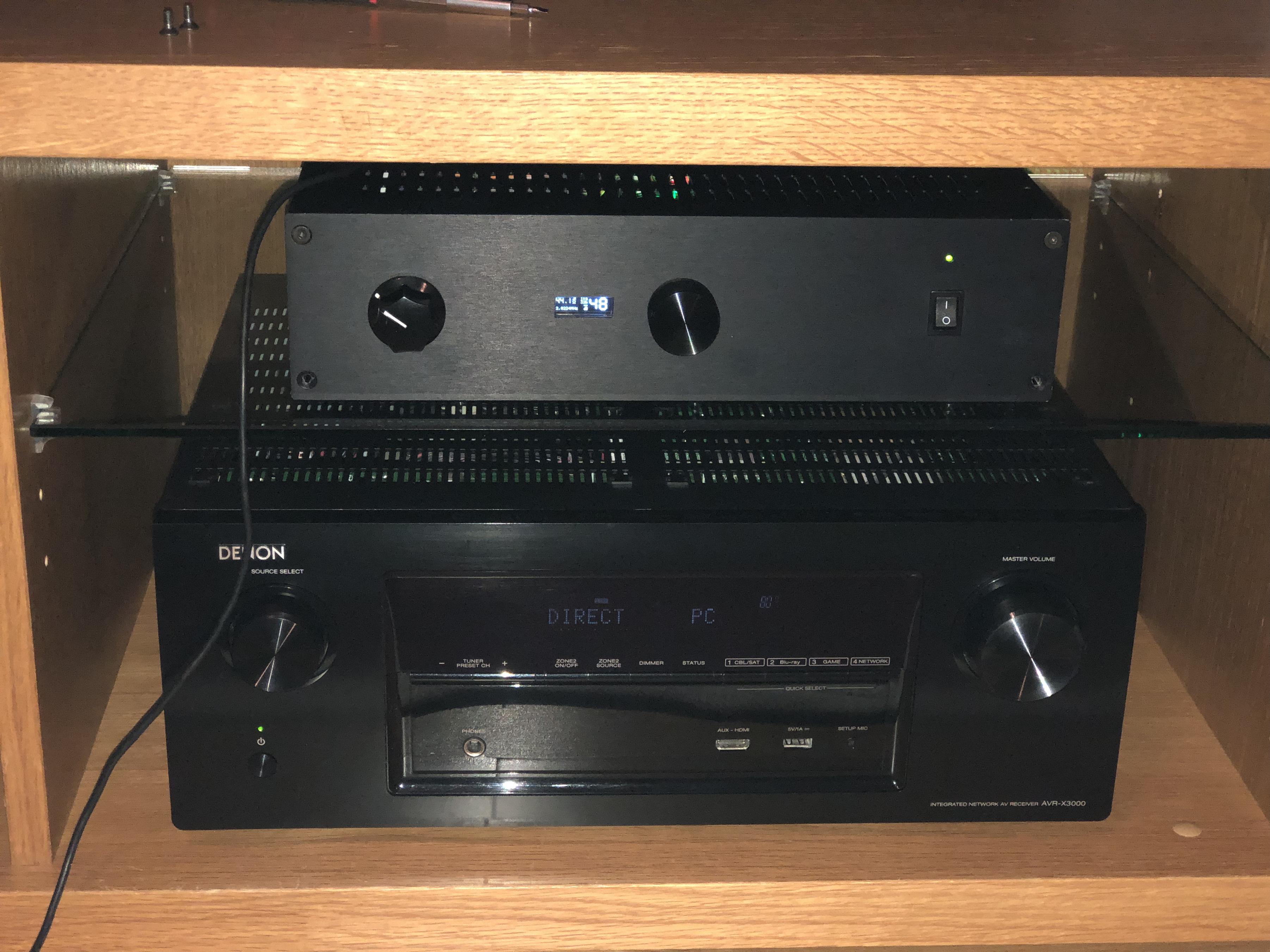

Yay! It’s making some sweet tunes. Thank you very much Ian.
@ Morde,

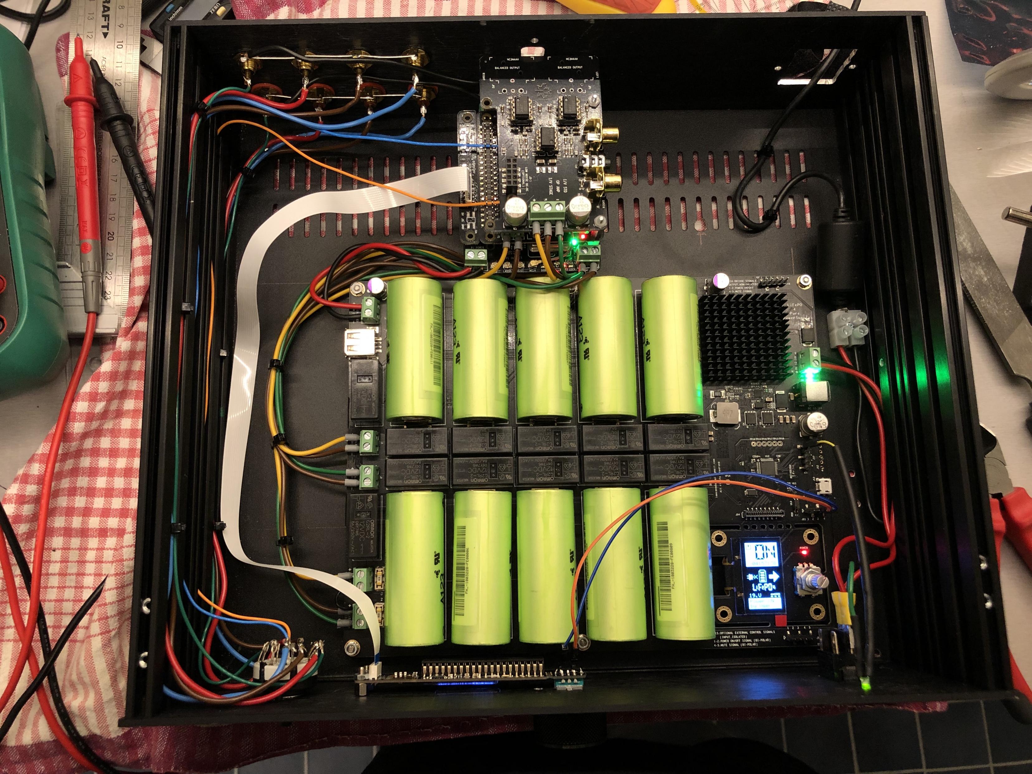

It looks great! You did good job. Much better than my hard wood base
Maybe you can also move the OLED board of the LifePO4 power supply to the front panel.
Looking forward to your new upgrade.

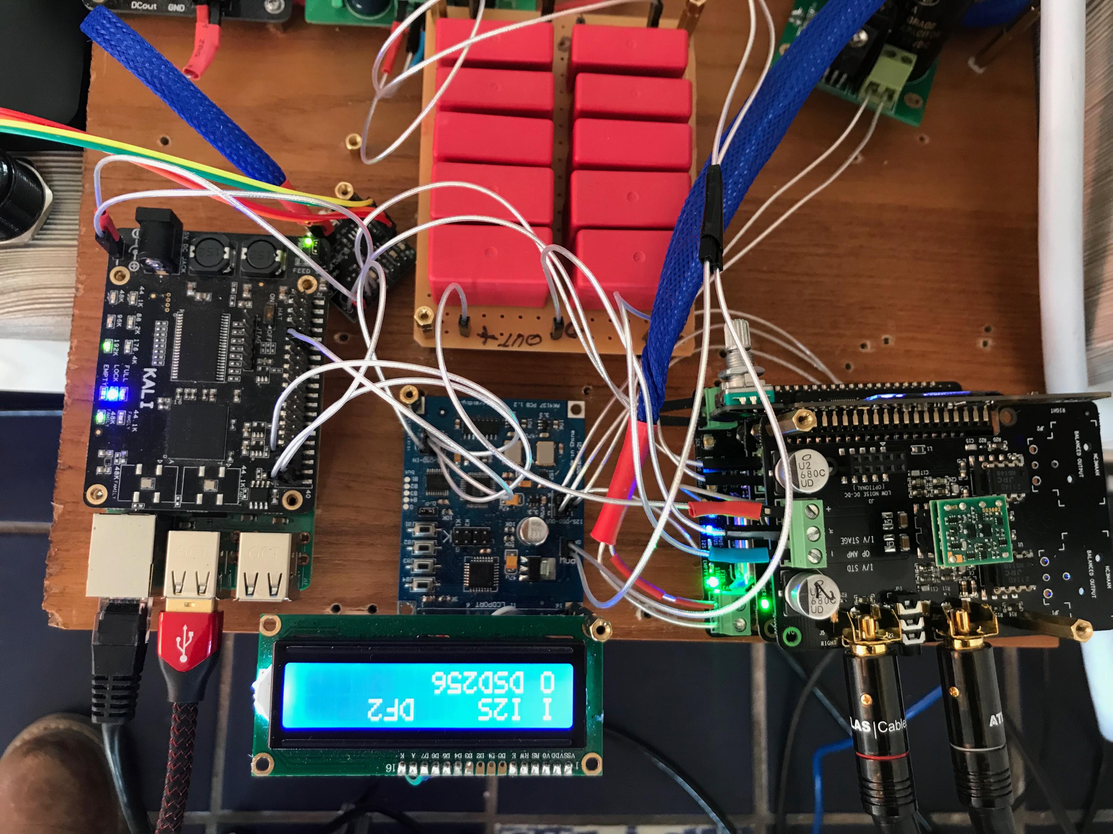

Hi guys,
Just tried Ian 9038 dual mono + fifoPi + ak4137 upsampling to dsd256 + Markw4 Film bank for +-15v + 1 sparkos 3306
And it sounds very very good to my ears. More details and more softness all together. Very nice separation of instruments too.
I think I prefer it over my Katana THD. But I have to listen more.
Upsampling was also a real improvement on my cheap chinese 9038q2m.

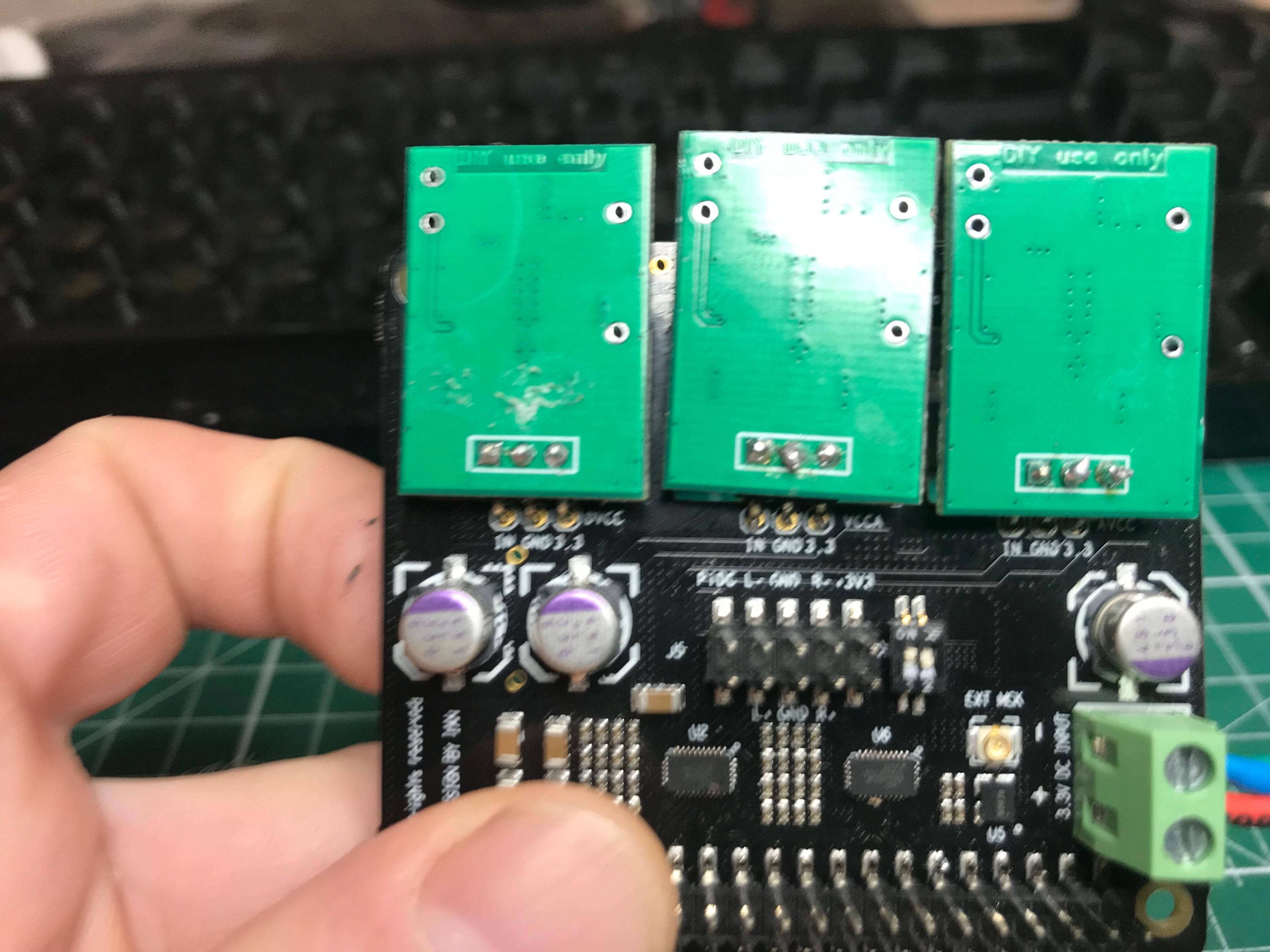

I will try to add TP 3.3v regulators to the dac board, Could some of you confirm that it is the right way to do it(see picture)?
thank you

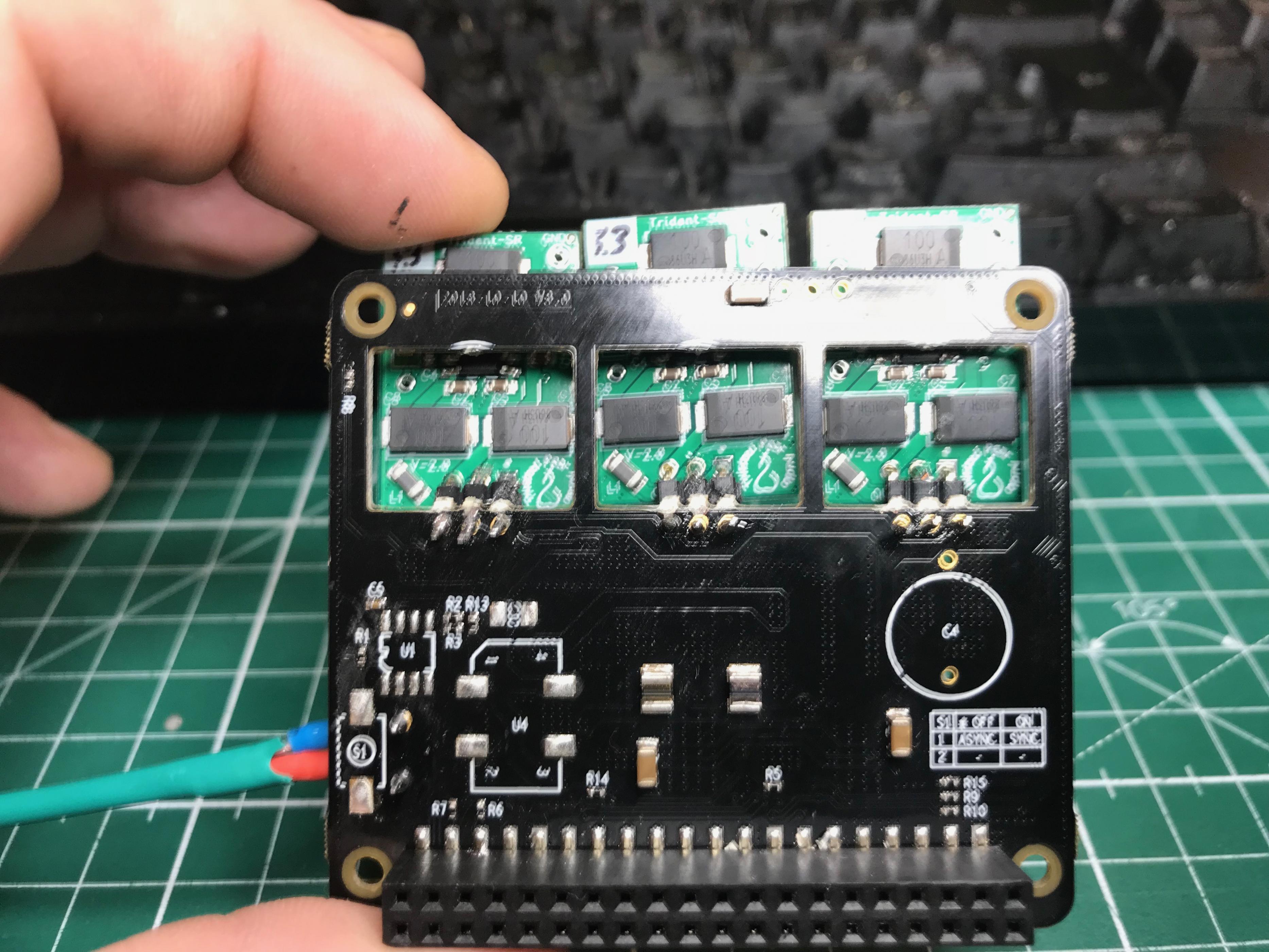

Hi guys,
thank you
Looks like you're powering the regs with the higher voltage (say 5~6V) to the DAC board's primary DC input terminal. You may want to check with Ian just to be sure it is okay (e.g., see if any caps along the way are rated for that voltage) although it should be, as I'm powering the three rails separately using 3 battery rails and with no connection to the primary DC terminal.

@terry22
Looks very nice, you did good job. Congratulations!
How do you like the ak4137 real time upsampling to dsd256? What the impress of the sound quality by comparing with original PCM/I2S?

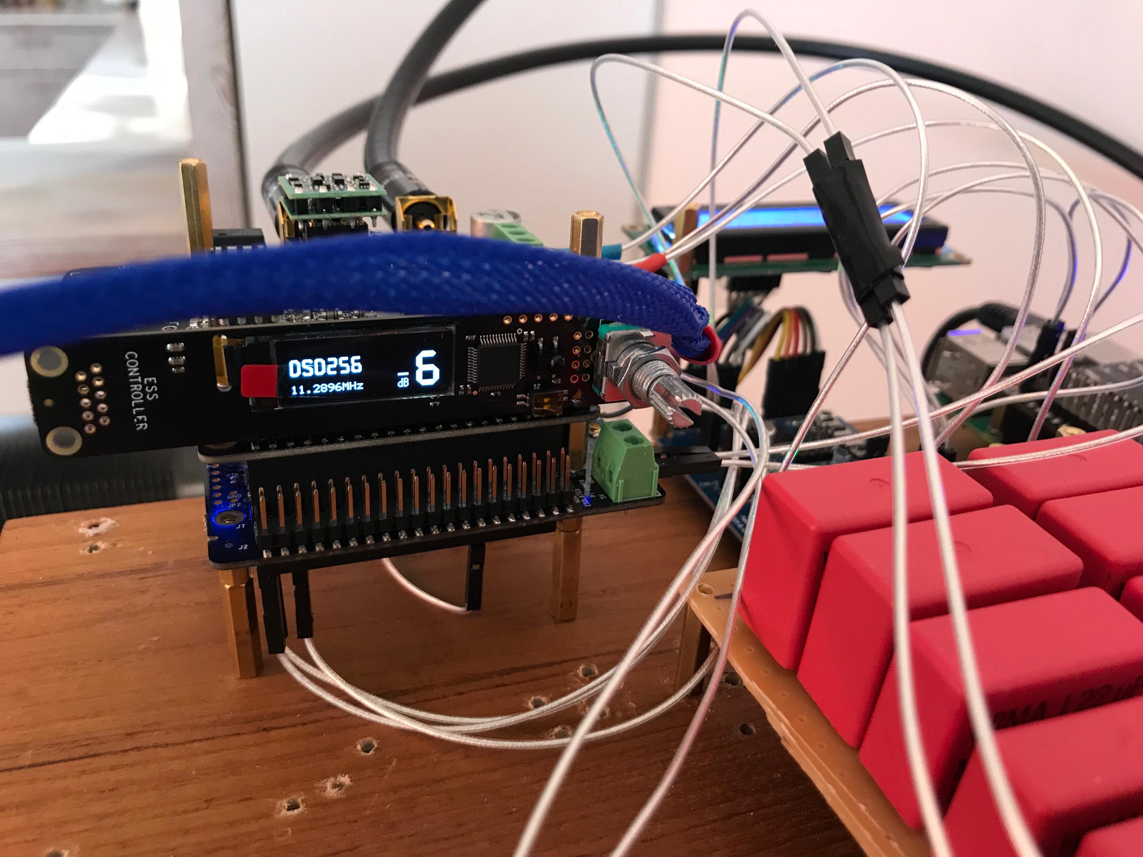

And what was showing on the ESS controller OLED screen when AK4317 is in working?
@jacklee,
I saw he has three low noise regulator boards on the ES9038Q2M dual mono HAT. So it should be no problem for 5-6V DC input.
Theoretically three 3.3V pure battery rails would be a better option. But will need at least two LifePO4 power supplies. How do you like this configuration? How much improvement on sound quality do you think by comparing with only one 3.3V battery rail?

Hi Ian,
the controller is showing DSD256/11.2896MHz
As I said in my message, to my ears it is a real imrovement.
More "airy" sound, more detailed and more softness in the highs.
it is difficult for me to describe it weel. But it is noticeable.
I didn't tried upsampling without the film bank. So it's a mix of the 2 mods and I changed an opamp too. I would have to test each mods separately.
But for now, I prefer to enjoy the great music it plays
Thank you again for your great work.
I will now try the tp regulators and next I will try better clocks when I'll receive them.
Hi Jacklee,
At start I wanted to power each reg separately but I need one more PSU to do that. Maybe I'll try it later.
Did you compared SQ between powering the card in 5v and powering the 3 regs separatly?

@terry22
That's really great. I would be interested in trying the AK4137 later when I have time.
BTW, I saw you plugged the ESS controller directly on to the DAC HAT. What I would suggest is to plug it into the non-isolated GPIO of FifoPi, it will become an isolated ESS controller under this configuration

@terry22
BTW, I saw you plugged the ESS controller directly on to the DAC HAT. What I would suggest is to plug it into the non-isolated GPIO of FifoPi, it will become an isolated ESS controller under this configuration.
Ian
Thanx Ian, it was just for testing. it is now on the fifopi.
terry22,
Please let us know when you try the new voltage regulators. They should probably work well for DVCC and VCCA.
I would be most interested to see how sound quality associated with AVCC turns out (since ADM7150 is sometimes use for AVCC on PRO chips). Don't know if the lower current draw of the Q2M chip will interact differently at all with the regulator in terms of audibility. The reason I say that is sometimes regulators may sound better if operated at some current reasonably above idle. In some cases, adding a suitable resistor from the output to ground has been reported to help.
@jacklee,
Ian
The main benefit from separate battery rails for the DAC HAT is eliminating the last bit of digitis - slight grit in the high frequencies. The sound becomes much more liquid and smooth, definitely an improvement (a must I'd say) and worth adding an extra battery board just for that (although one can also do that w/ a single battery board if the transformer output board is used).
Hi Jacklee,
Yes, see my reply to Ian above. Btw, if one is using battery (3.3V) then bypassing the on-board reg already brings a step-up in sound - more clarify and definition (see Ian's manual for how, 2 solder joints). The 3 battery rails take it further still.
