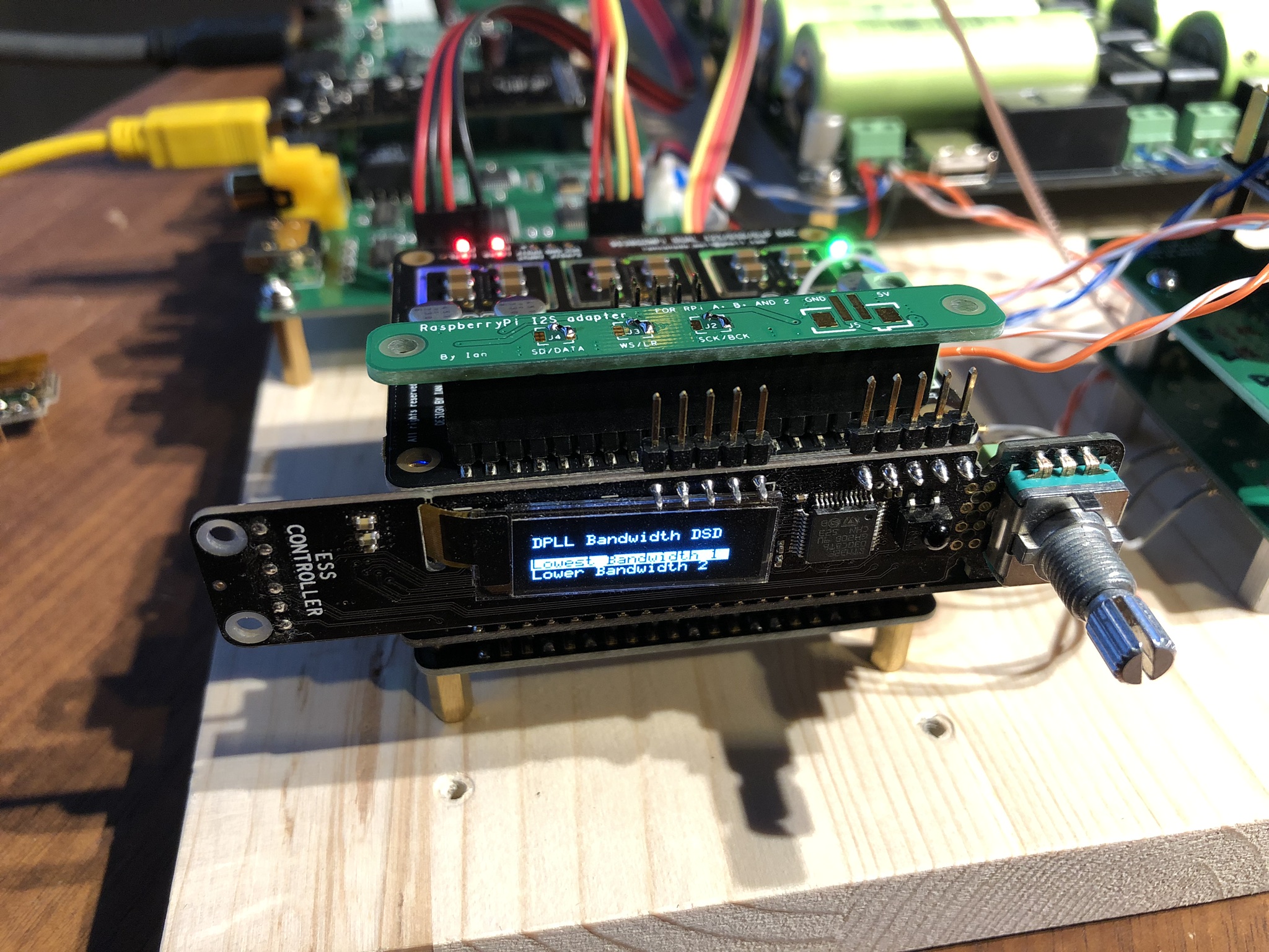

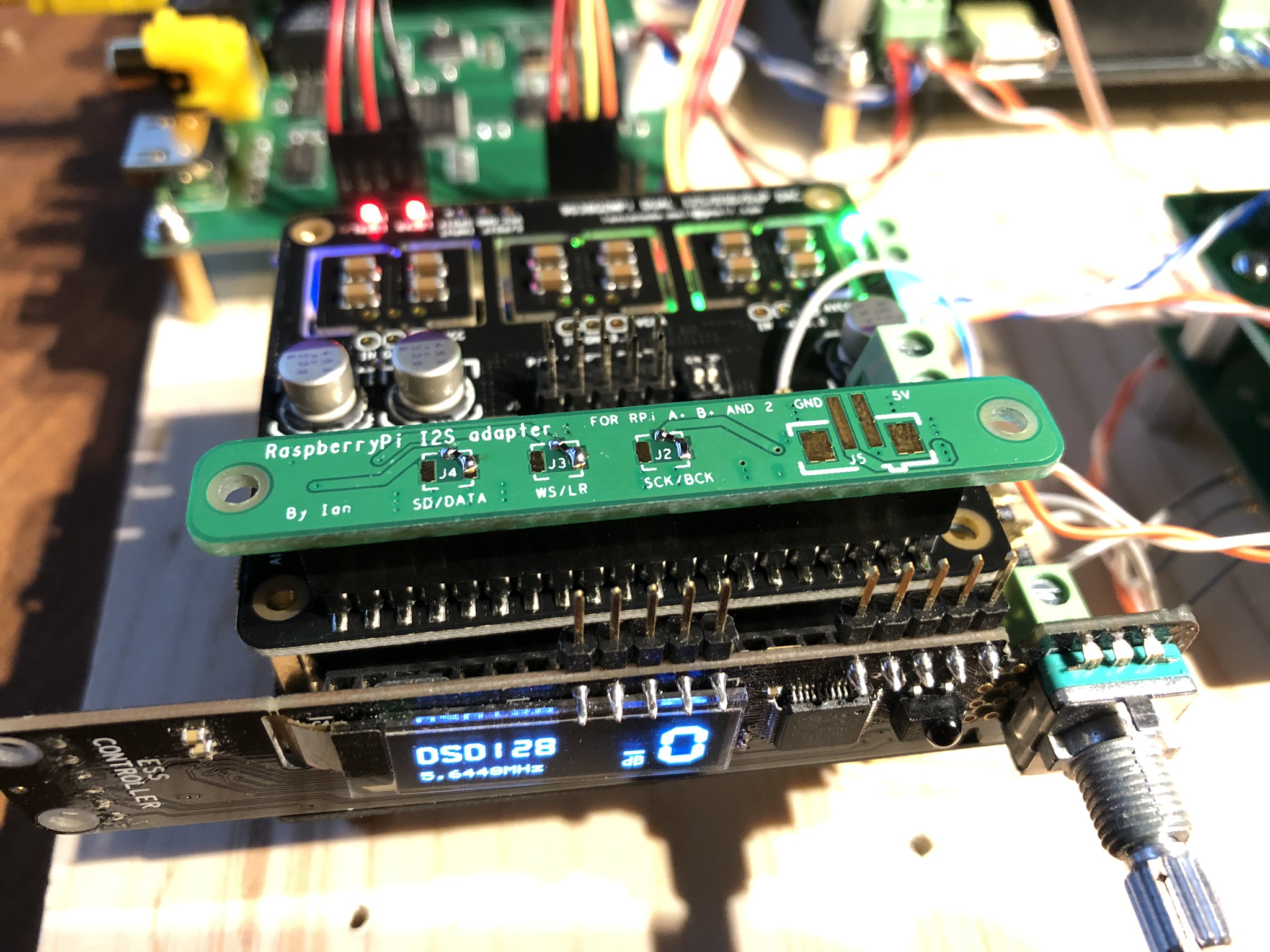

I may have solution for you.
ES9038Q2M DSD DPLL was designed not as good as PCM DPLL. It's very sensitive to the waveform of input signal. ES9028Q2M DSD DPLL was also confirmed better than.
With this solution, I have not problem locked to DSD128 when set to lowest DSD DPLL bandwidth=1, at sync mode with FifoPi and ES9038Q2M dual mono. Even with supplied XOs.
This solution also explained why you have no problem when plugged the ESS controller into GPIO of dual mono ES9038Q2M.
Please see pictures for details.
Ian

Hi Ian,
I can confirm your solution works. No more lost locks. But because I didn't have a spare raspberry pi adapter I used the ESS Controler extension. Do you have a spare raspberry pi adapter lying around? Or is there another way to achieve the same effect?

@ian,
I'm just curious but what exactly does the adapter do to solve the problem, given that it's not even connected to anything else other than plugged into the GPIO bus?
The reason I asked is that if it improves signal quality then perhaps it could also improve sound quality even if it's not DSD128.
Thanks.

It's all about signal integrity. If we think the digital audio signals in a RF way, GPIO is not a perfect. The adapter board with some termination resistors is for some compensation to the impedance of GPIO to improve the signal transmission quality. I'm not sure if it has business with sound quality, but you can try.

What resistor values did you use?
For compensation, the resister values will be up to the real situation of the GPIO connector load and PCB trace impedance of the real application. They could be in a range of 100 to 500 ohm. I use 200 ohm 0402 chip resistors in the picture and they work fine. You could try some thing else for better result. Resistors in 0603 package are also good for easier soldering.
