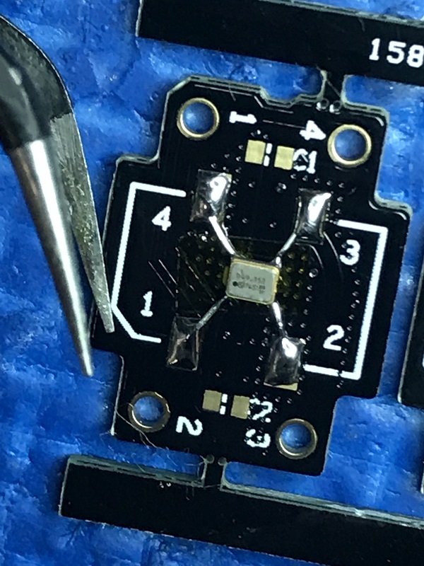

Hi Ian,
I got my DAC finally hooked up and working properly using Ropieee for Roon. Just changed the SE output opamp to OPA1612 for now but planning on testing the Sparkos one. I'm resampling everything to 32/384 using Roon DSP. Normally upsampling everything to DSD256 but in this case, the Pi does not make it possible.
I still have to change the clocks to higher quality ones. I've ordered some NDK SDA 45 and 49 from Lorien (on this forum) and received my first order, but then realize they are very tiny, they must measure 4mm x 3mm or close to this... and they won't natively fit your Crystek adaptor without adding leads on each side. Do you know if I do this, do I install all the smd caps on the adaptor as well?

It needs some skills to assemble the NDKs. Maybe I will design a dedicate NDA adapter, even though it still not that easy. Just hope some other community members can share their experience.
Yes, you'll need those capacitors.

Here's one of the NDK SDA clock mounted on the clock adapter board... Not too hard but required some good magnification... Look at the tweezers beside it.
All the other smd components are also mounted (not pictured). Since I'm currently upsampling everything to 32/384, I only needed to change the 49MHz clock for now.
All the best!
