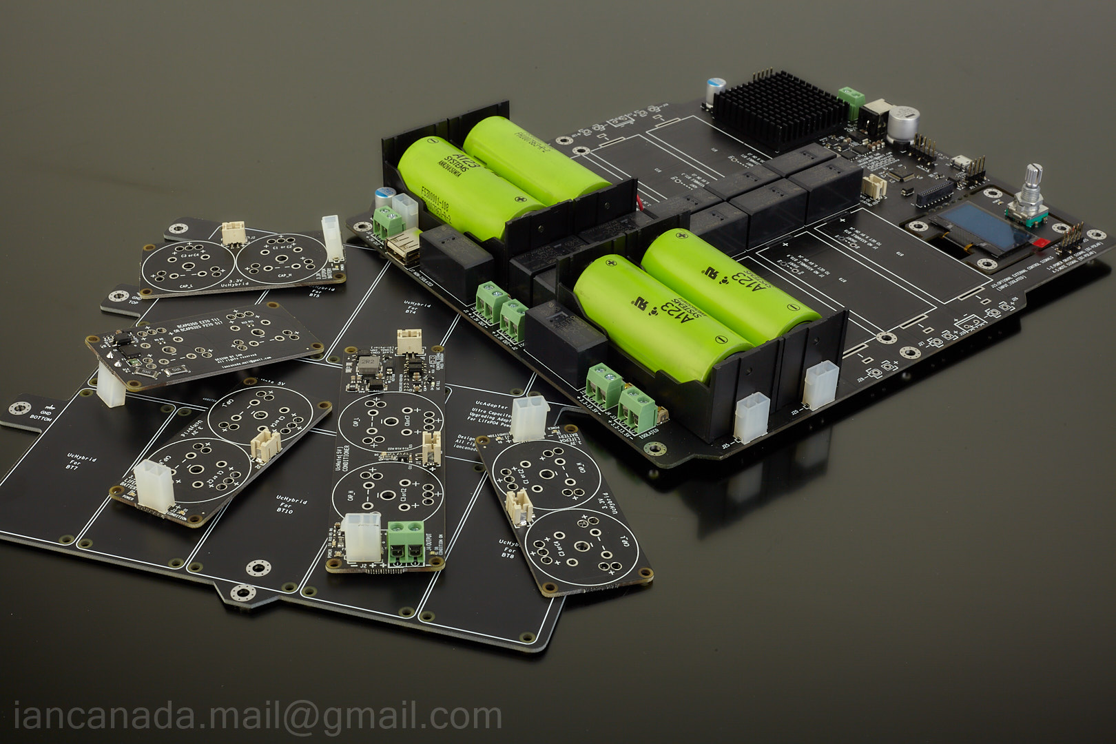

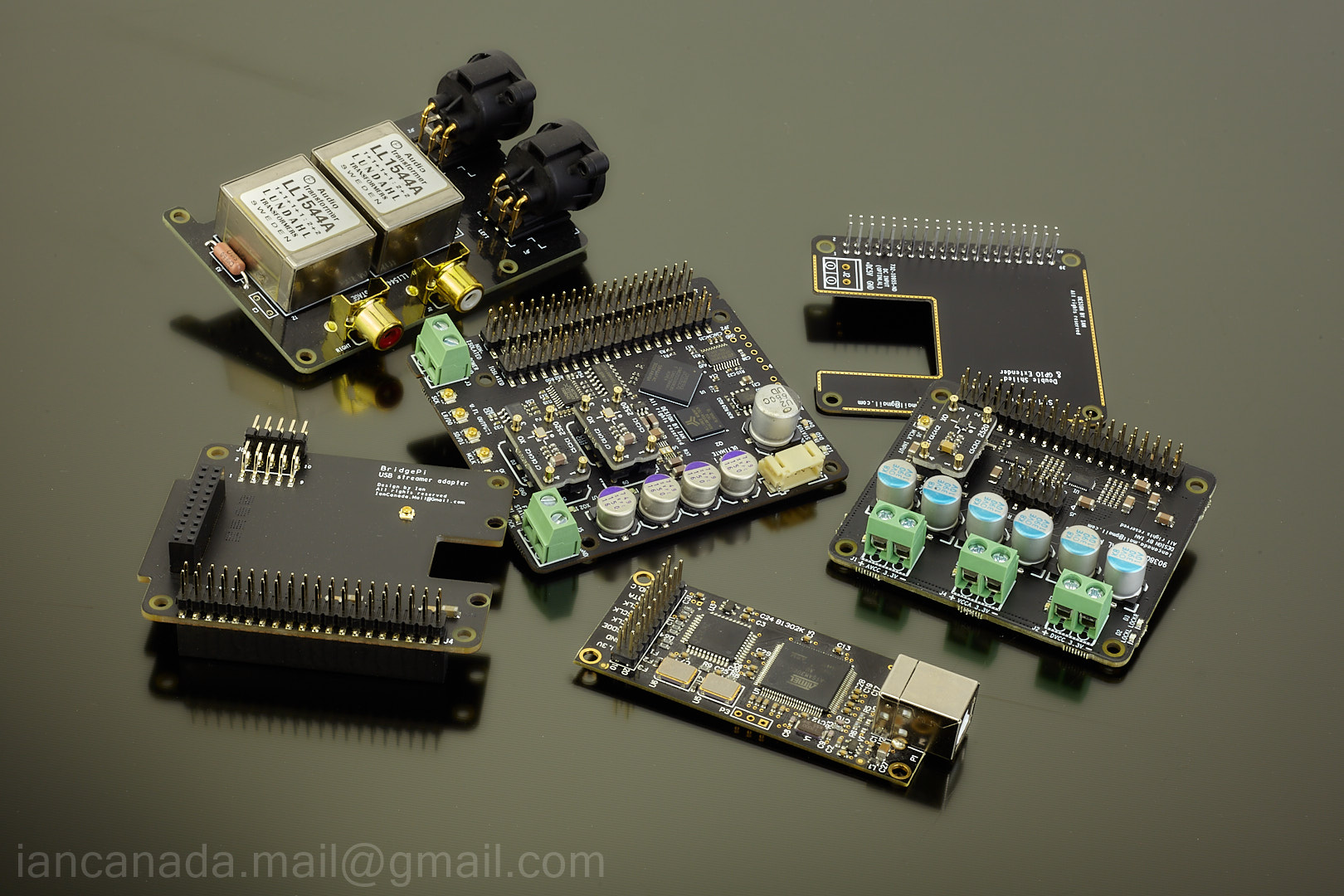

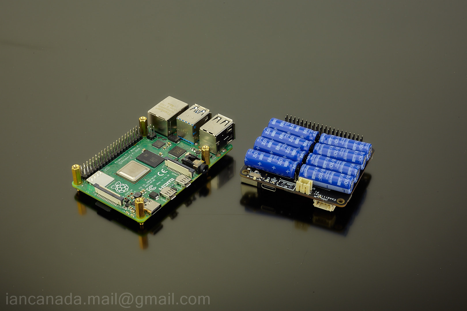

Using BridgePi to setup an USB based RPi DAC project
With BridgePi, making an USB streamer based RPi DAC is possible.
This DAC can be connected either to a RPi or to a Mini PC, would be more flexible. And USB streamers support native DSD rather than DoP so also be more interesting to play with.
I'm gonna start a new DAC project with this idea.
DAC section:
1. BridgePi
2. FifoPi Q2
3. ShieldPi
4. 9038Q2M Dual Mono Plus
5. Transform I/V
6. ESS controller
7. USB streamer (XMOS or Amanero)
Power supply section:
1. LifePO4 Mk III
2. UcMateConditioner
2. UcHybrid
3. UcAdapter
Player section:
1. Raspberry Pi4
2. ConditionerPi
or Just a mimi PC
Ian
