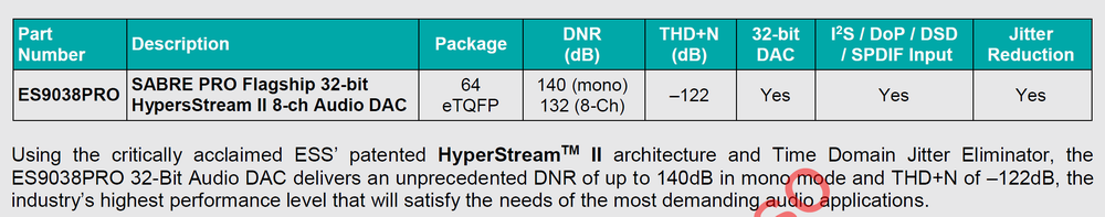

The ES9038Q2M datasheet only mentions the DNR of 129 in stereo mode, and does not mention it in momo mode. May I ask where the 132dB (theoretical) you claimed came from.Just one question. From the spec sheet the 9038Q2M in dual-mono (2CH in parallel) mode has
Output impedance: 387 ohm
DNR differential current mode: 132dB(theoretical)
THD+N differential current mode: -120 dB
The 9038Pro in stereo mode (4 channels in parallel) however has
Output impedance: 50.5 ohm
DNR differential current mode: 137dB
THD+N differential current mode: -122 dB
4 CH in parallel
How did you arrive at a DNR of 140db?
http://file2.dzsc.com/product/18/05/25/829029_170233543.pdf
In fact, the manufacturer only mentioned that the DNR of ES9038PRO in MOMO mode is 140. In other words, I am not sure, is a DNR of 140 the theoretical limit value?
![NFB777specs.png NFB777specs.png](https://www.diyaudio.com/community/data/attachments/882/882065-15d07dc60e3bec5caf64cc416e6255a8.jpg)
Let’s take ES9038Pro for example:
The DNR of ES9038Pro is 137dB when it’s configured in stereo mode. But when ES9038Q2M is configured into dual mono mode by paralleling both left and right channels together in each DAC chip, the DNR will be boost to 140dB. 140db equals exactly to 137dB + 3dB.
Now we know why sound quality can be significantly improved by paralleling DACs.
Have a good weekend.
Ian
In fact , the DNR of ES9038Pro is 140dB when it’s configured in stereo mode.
![NFB777specs.png NFB777specs.png](https://www.diyaudio.com/community/data/attachments/882/882093-15d07dc60e3bec5caf64cc416e6255a8.jpg)
