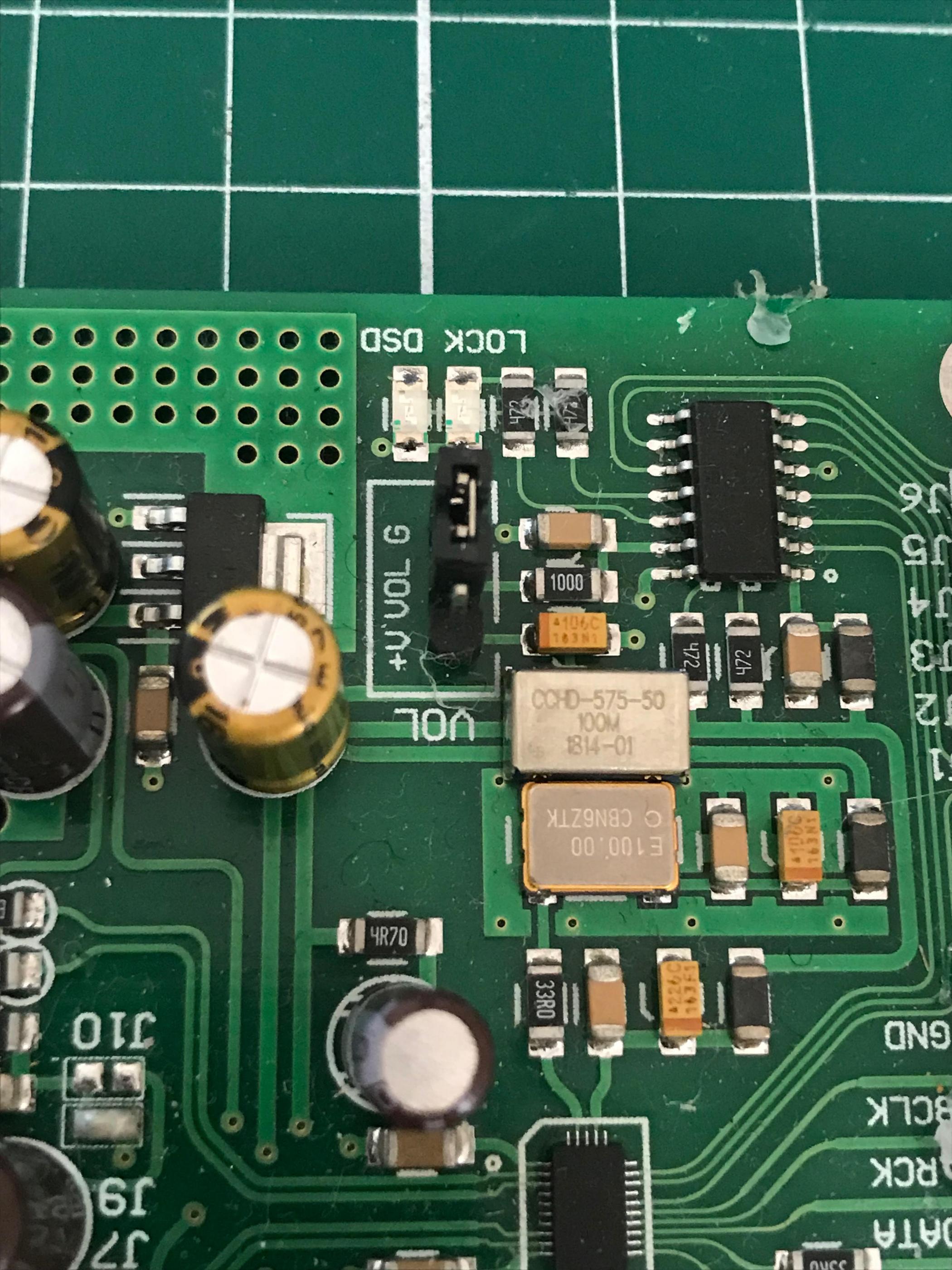

I just received my new clock today.
As Mark told me it is bigger than the original one.
I will try to make some place for it without messing the board...

Ok. Bad news this morning my board wasn't working anymore.
Blue leds were off.
After doing some measurement, it looks like the 7805 regulator is only sending about 1V and not 5V anymore.
the Vin is still 15V.
Do you think I just need to replace it, or it may have another cause?
Either something is drawing a lot of current or the regulator is bad, it sound like.
Does anything on the board feel warm to the touch? Sometimes filter caps can short. About the only thing that loads the 5v supply is the 3.3 volt regulator.
The difficulty with troubleshooting what might be a bad regulator or what might be a short somewhere is that you typically need to cut traces or remove components to figure out the problem.
You could also try turning off the power a measuring for a short to ground at the output of the 5v regulator. If you do find a low resistance to ground you could start by lifting the output pin of the regulator or cutting it and seeing if that changes anything. The short could be inside the regulator or outside of it.
If you don't find any low resistance to ground at the output of the 5v regulator that could mean the regulator is bad, or that it takes more voltage that a multimeter puts out to cause high current draw.
if you have another 5v power supply you could lift the output pin of the regulator and use another 5v power supply to power up the 5v bus and see if it comes back to life.
Also, maybe good to know that the 5v regulator only feeds the 3.3v regulator and the 5v power hole/pin at the I2C terminals.
Probably the preferred approach would be to try measuring for low resistance loading first and if nothing found then substitute another 5v supply. If you have a higher current 5v supply that might heat up anything causing a short or heavy load on the 5v but, or it might cause something to open like of fuse. If you proceed carefully chances are good you can fix it okay.
Just remember if you lift the 5v regulator output and apply +15 power to the board then the regulator might oscillate without an output capacitor hooked up to it. For that reason cutting a trace after the output capacitor might be a better place to interrupt the circuit.
Also, it should be possible to hook up another 5v supply without turning on the +15v power. In that case the +-15v would only be needed by the opamp which won't be hurt if the 5v is on. Or you could pull it from the socket.
EDIT: it could be andora76 suggestion is good too, although sometimes you can see a regulator that fails only with more loading than 10k. So, you might have to come back and look at that again if you don't find anything else. There is more than one way to start troubleshooting something like this.
