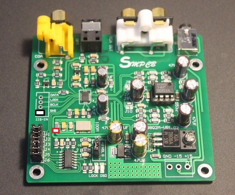

ES9038Q2M Board

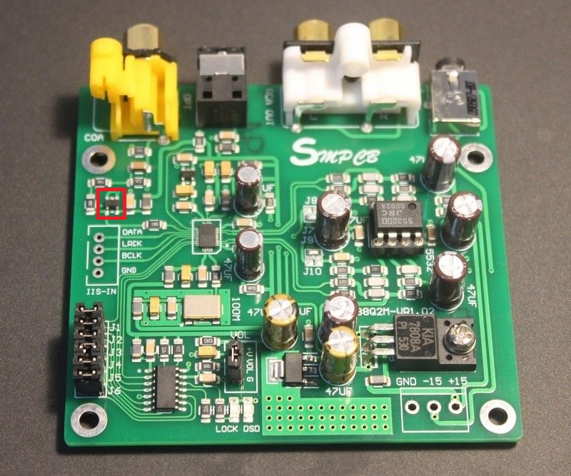

Either something is drawing a lot of current or the regulator is bad, it sound like.
Does anything on the board feel warm to the touch? Sometimes filter caps can short. About the only thing that loads the 5v supply is the 3.3 volt regulator.
The difficulty with troubleshooting what might be a bad regulator or what might be a short somewhere is that you typically need to cut traces or remove components to figure out the problem.
You could also try turning off the power a measuring for a short to ground at the output of the 5v regulator. If you do find a low resistance to ground you could start by lifting the output pin of the regulator or cutting it and seeing if that changes anything. The short could be inside the regulator or outside of it.
If you don't find any low resistance to ground at the output of the 5v regulator that could mean the regulator is bad, or that it takes more voltage that a multimeter puts out to cause high current draw.
if you have another 5v power supply you could lift the output pin of the regulator and use another 5v power supply to power up the 5v bus and see if it comes back to life.
Also, maybe good to know that the 5v regulator only feeds the 3.3v regulator and the 5v power hole/pin at the I2C terminals.
Probably the preferred approach would be to try measuring for low resistance loading first and if nothing found then substitute another 5v supply. If you have a higher current 5v supply that might heat up anything causing a short or heavy load on the 5v but, or it might cause something to open like of fuse. If you proceed carefully chances are good you can fix it okay.
Just remember if you lift the 5v regulator output and apply +15 power to the board then the regulator might oscillate without an output capacitor hooked up to it. For that reason cutting a trace after the output capacitor might be a better place to interrupt the circuit.
Also, it should be possible to hook up another 5v supply without turning on the +15v power. In that case the +-15v would only be needed by the opamp which won't be hurt if the 5v is on. Or you could pull it from the socket.
EDIT: it could be andora76 suggestion is good too, although sometimes you can see a regulator that fails only with more loading than 10k. So, you might have to come back and look at that again if you don't find anything else. There is more than one way to start troubleshooting something like this.

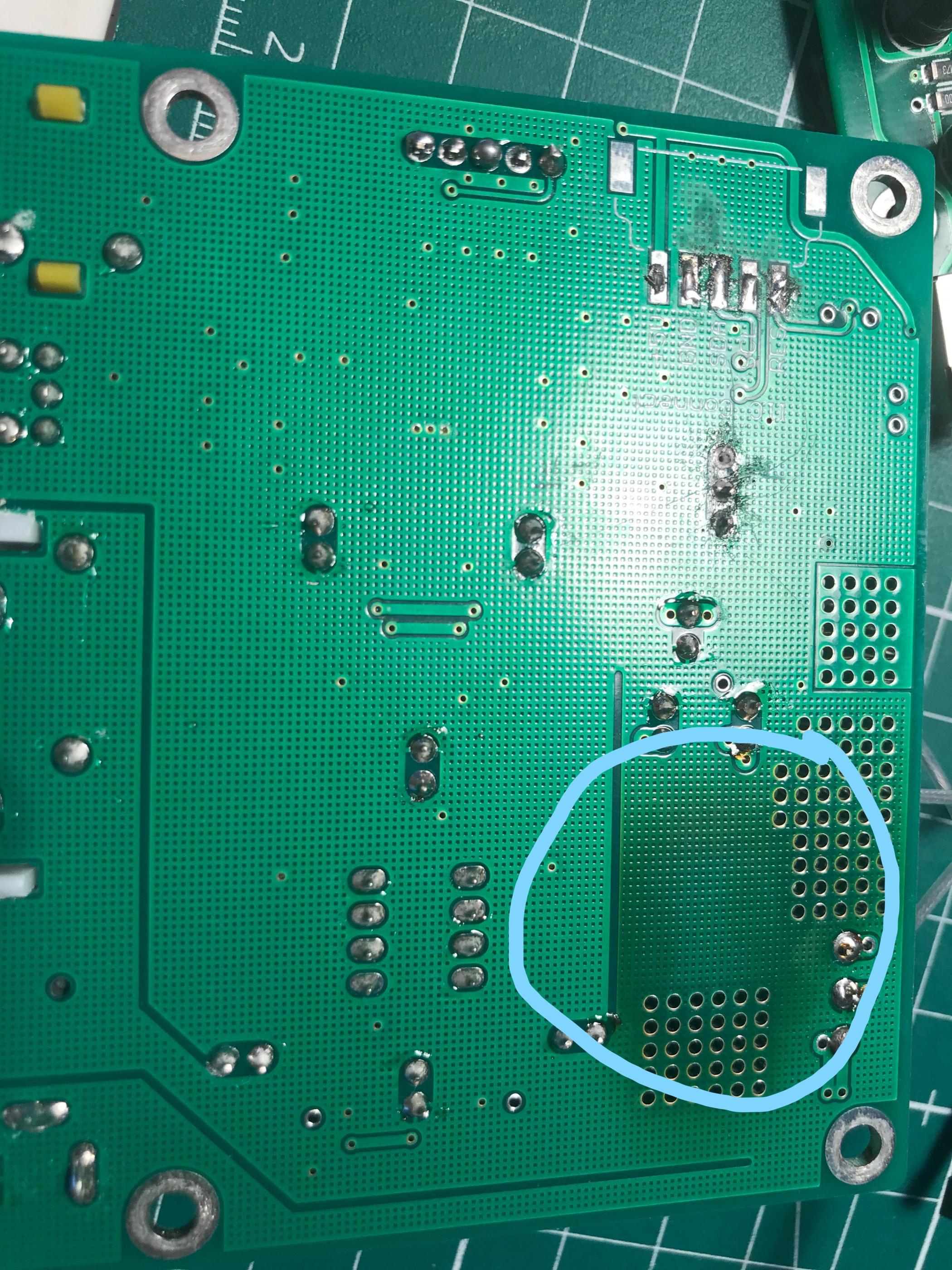

I just check the other side of the board and it looks like that there was much heat at the 7805 place. So I guess that it is damaged for good.
I'll made measurements tomorrow.

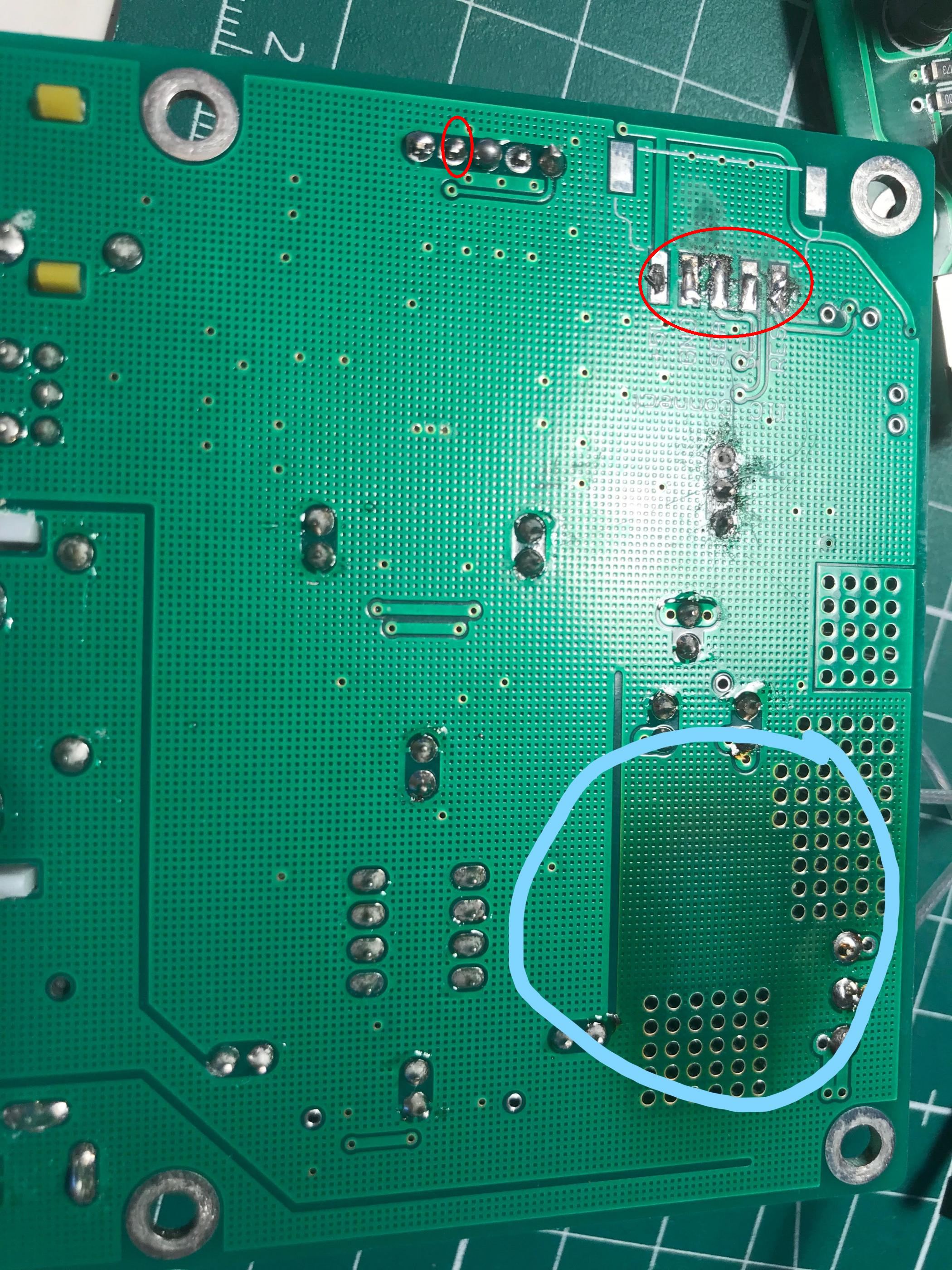

Looks like there is solder on the bottom of your board where the 5v could potentially get shorted. You should probably clean that solder up with some solder wick to help prevent any problems. I have circled some suspect areas in red below. Also, don't know why you would need to have the 5v PCM/I2S terminal soldered for anything.
In addition, looks like you could benefit from some more practice or instruction in soldering. If you know anyone good at it you might ask them for a lesson. Or, maybe youtube could help.

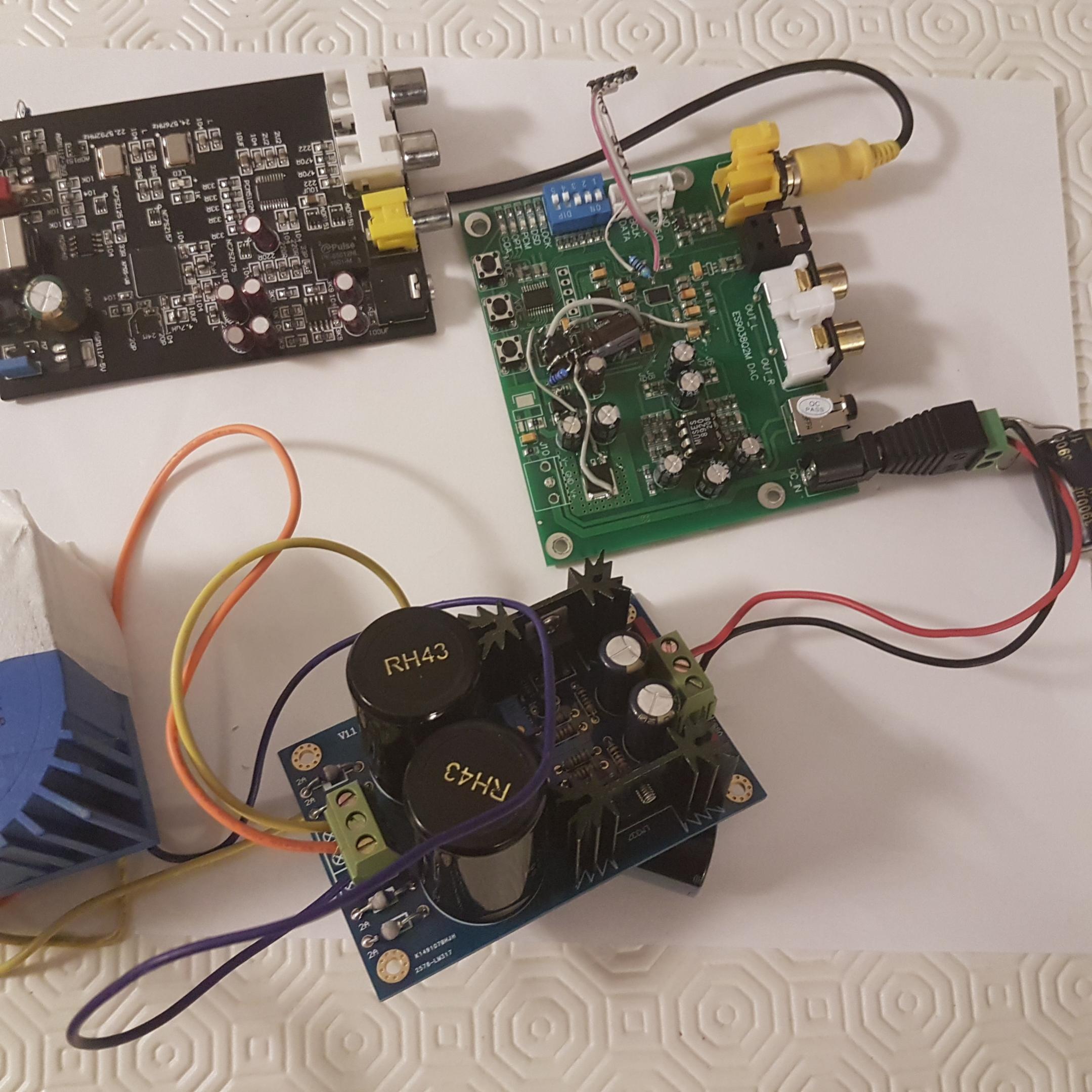

@system54, I will post your pics below so they can remain part of the thread over time. It looks like the 10uf you added close to the clock will also affect the entire 3.3v rail, including things like AVCC. Whatever difference you hear is probably due to cleaner 3.3v power for multiple things, not just for the clock.

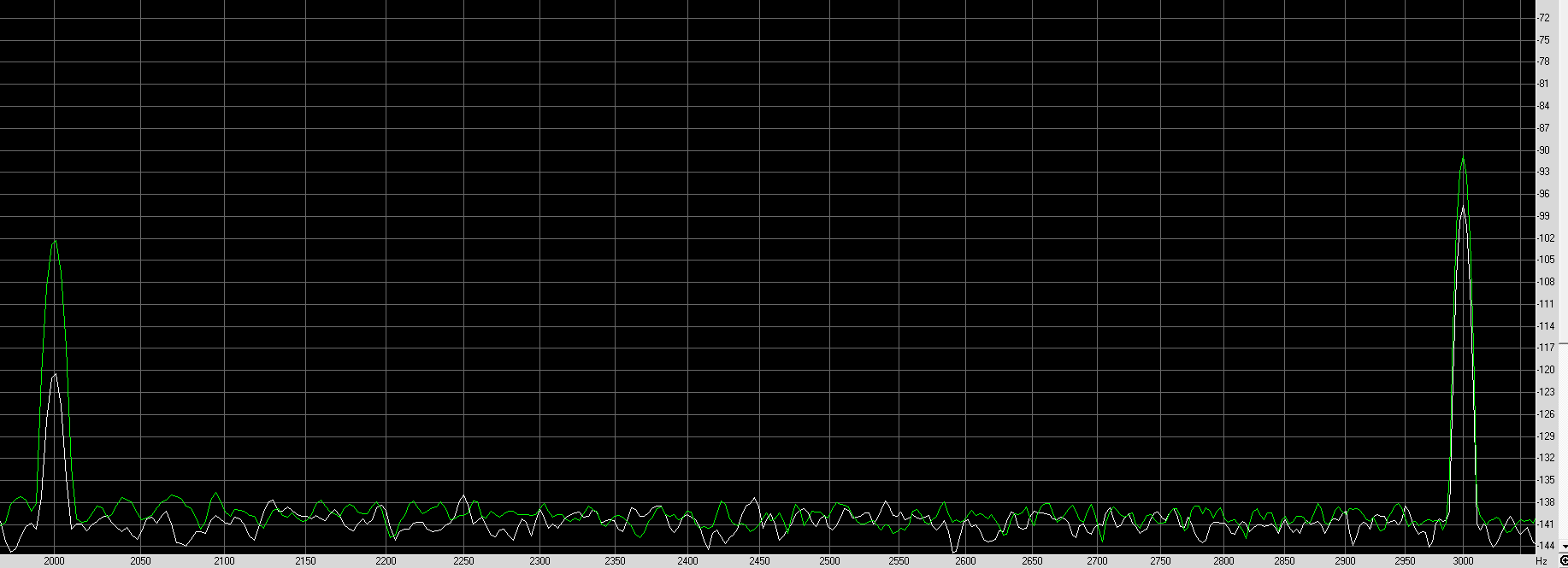

THD measurement @1Khz -3dbfs
I've done measurement with a xmos usb to spdif ( isolated, 24 bit 96Khz ) and Asus xonar soundcard ( using Rmaa) . You will find harmonics before and after the avcc mod ( aop lme49720na). the difference on C3 is about -7db and -18db for C2 , not to bad. The board has a lm317 supply, it's much better than a wallmart ...
I've also tested few aop swap for the buffer stage ,no difference in measure ( stock NE5532, LME49720na) .
I've also tried a muses 8920, the C2 harmonic has disapeared on the left channel !!! but the C3 was unchanged.

Wow, $35 is a good price for all that! Thank you for the picture, too.
Of course, you probably know what I am going to say because I want our other potential modder's to do very nice, very careful work. Have to say I notice the AVCC supply you show in the picture could be laid out a little more clean, with shorter wires, preferably on the other side of the ground plane where it would be better shielded, and so on.
With long wires hanging out in space and the opamp right next to the noisy digital microcontroller, there are a number of opportunities for performance problems to creep in. You don't worry about those things? I know I do for the board I have been working on here.
Also, what about the future of the board in the picture, any plans to do more work on it? Maybe clean up the AVCC supply, add an I/V output stage, etc. Since you have the board, may as well do a little more with it, wouldn't you agree? It will sound much better for sure.
Whatever you may decide to do next if anything at all, thanks again for letting us see what you have so far. I hope other people will let us see pictures of what they have been doing too. I don't want to scare people off that their work might get criticized a little, but at the same time we would like to encourage everybody to get the best sound quality possible which means layout is part of what has be considered too, not just the circuit schematic. Hope you are okay with that.
