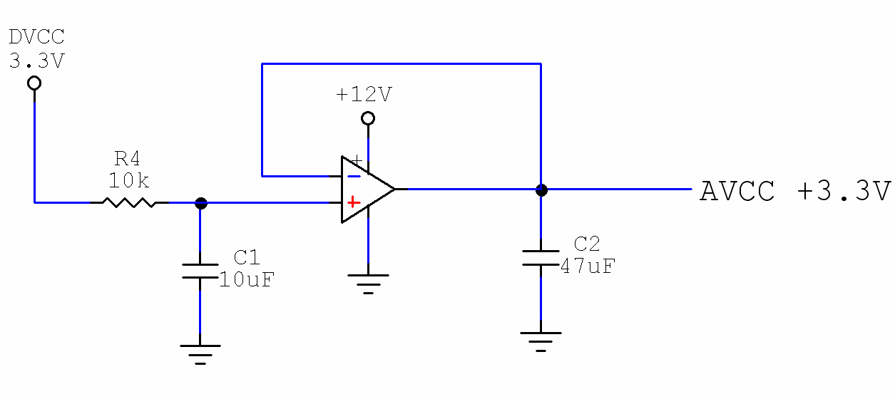

Mark can you please make a complete shema .
Well, a quick and easy full AVCC schematic could be like the one attached below. However, some of the lines are very thin so it may display most clearly using Adobe Reader.
Someone would certainly be welcome to redraw it in an easier to read format.
Someone would certainly be welcome to redraw it in an easier to read format.![]()

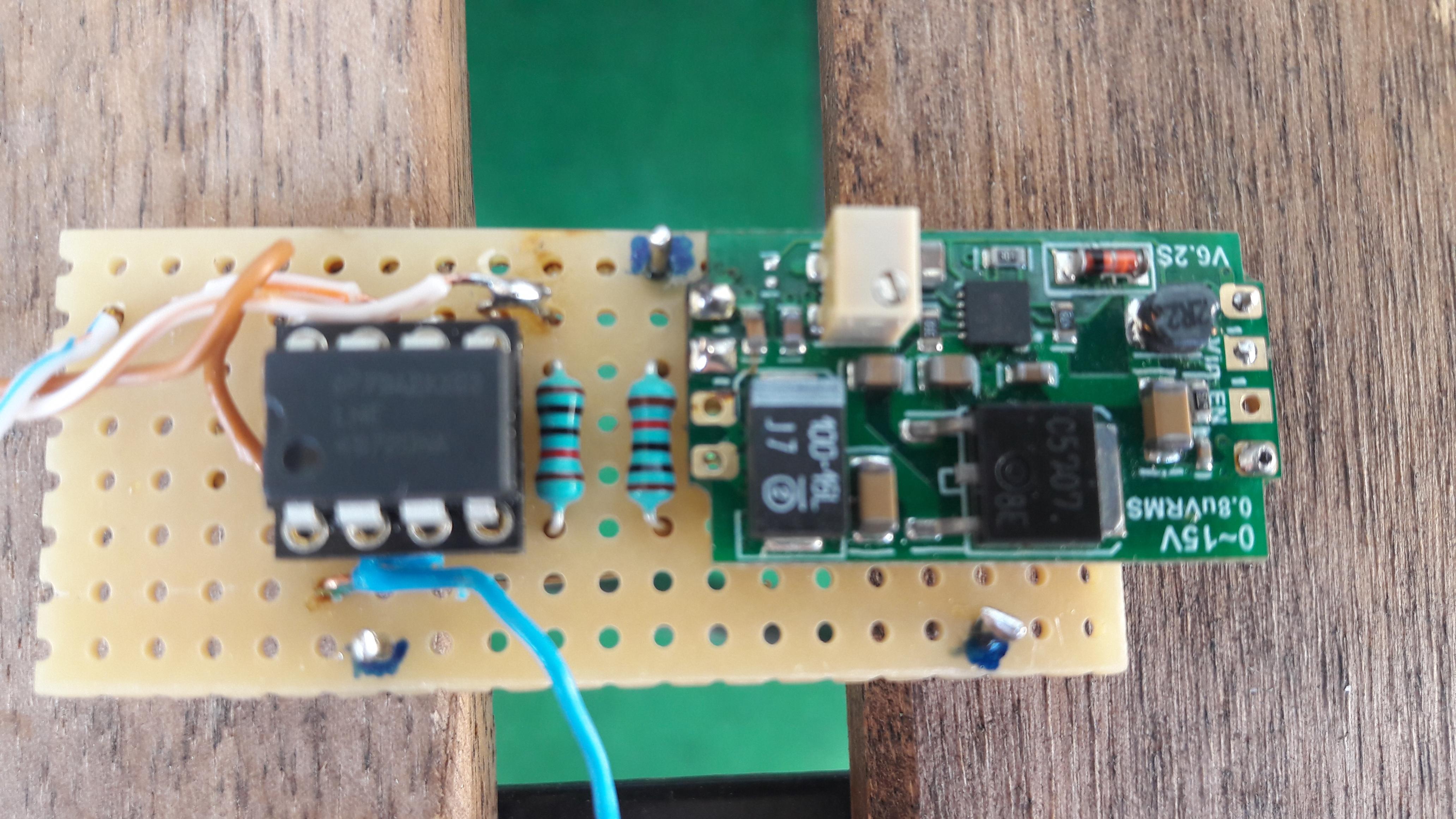

Hi Mark!Right. The LTC6655 gets input power from the +5v supply, and the dual opamp runs on +-15v rails. Also, it turns out the opamp +-15v power needs a very low impedance path back to the big 1,000uf filter caps or to the power supply output. The last change I made to my existing SMD AVCC circuit can be found here: ES9038Q2M Board - Page 229 - diyAudio
I'm a bit confused because on the ESS AVCC schematic I see single +12V power for opamp. (?)
Hi Mark, as you wishHi Deenoo,
Good to hear you have ESS recommended part already done.
May I ask if you think you might by chance be willing to post some pictures of your modded board as it is now or maybe after you install the LTC6655 so we can see your approach to laying out the circuitry? I think readers are usually interested to see how other members do such things.

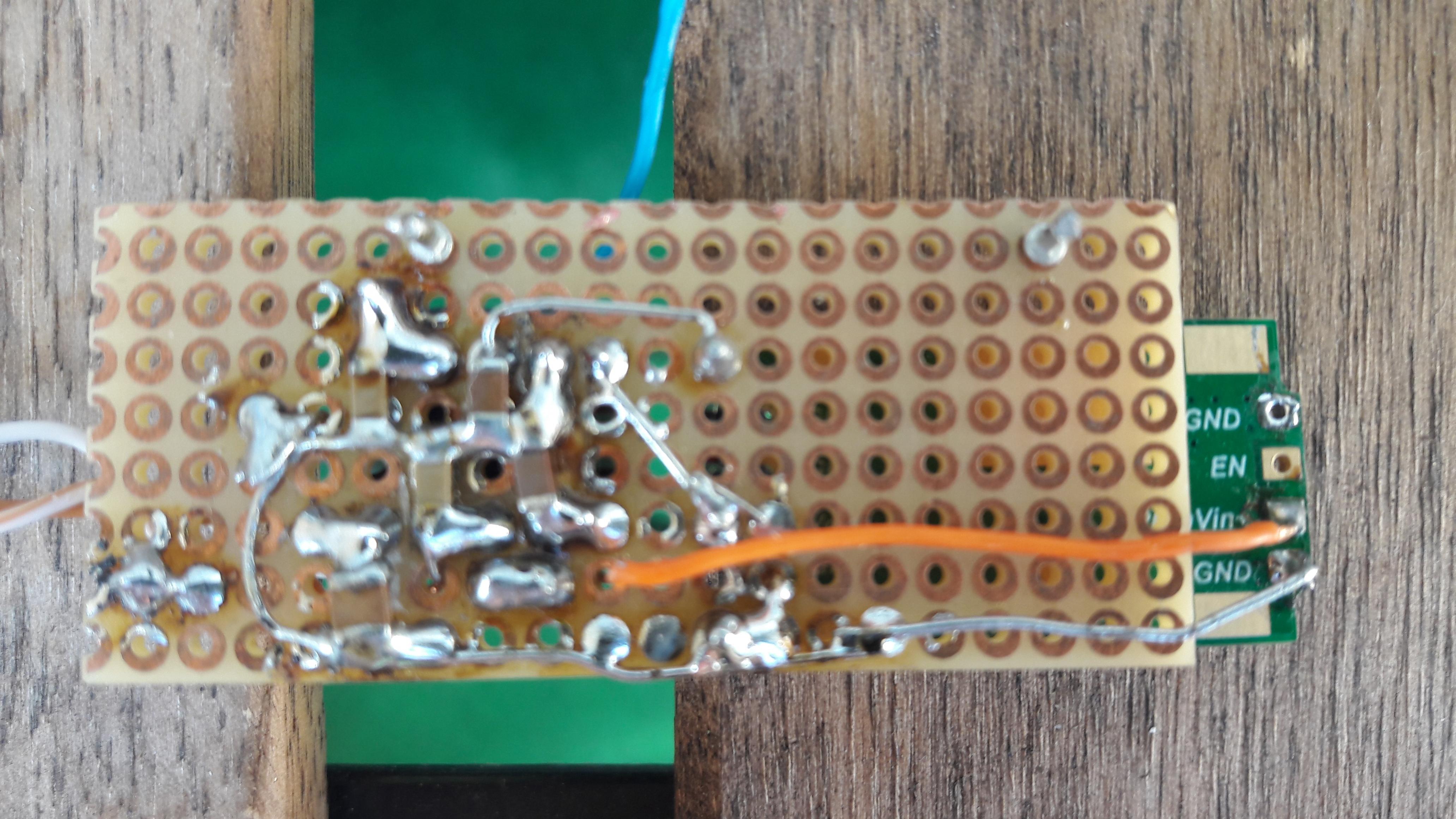

Hi Mark, as you wishI'm waiting for LTC6655 till end of october
because not in stock. This is a AVCC board with 3042 ref. On the AVCC schematic i didn't see decoupling cap for the opa power rail. It is omissible? But I'm soldered in 10uF X7R. Thx. D'
Hi Deenoo,
Thank you for the picture. Just checked and it looks like Digikey has LTC6655 in stock: LTC6655BHMS8-3.3#PBF Linear Technology/Analog Devices | Integrated Circuits (ICs) | DigiKey
Also, for decoupling opamps, unless the data sheet for a particular opamp says otherwise, we always use 10uf tantalum in parallel with .1uf X7R ceramic directly from each opamp power pin to ground. Best if there is a ground plane, of course.
However, if the effective leads are very short 10uf ceramic SMD might be okay. A reason for using two caps is because one cap can become self-resonant at some frequency. If using a large cap like 10uf, a small cap like .1uf in parallel will help prevent self resonance of 10uf from becoming a problem. Also, lead length plays a big part in self resonance. If no ground plane then power wiring can provide the necessary inductance in series with a cap to create resonant conditions.
Hi Mark!
Most modern opamps can run from a range of supply voltages. The opamps we typically use such as LME49720 could run on 12v or +-15v, and also some other voltages. So long as the supply voltage is okay for the opamp then it should not be a problem. If unsure, please check the data sheet for an opamp you may be considering for use to see what supply voltages it is rated to work with.
True, for AVCC, 5v and ground should work too, at least in theory. However, very low impedance power rails back to the supply matters and is important for best sound quality it seems. At lower voltages it might matter even more, don't know haven't tried it.

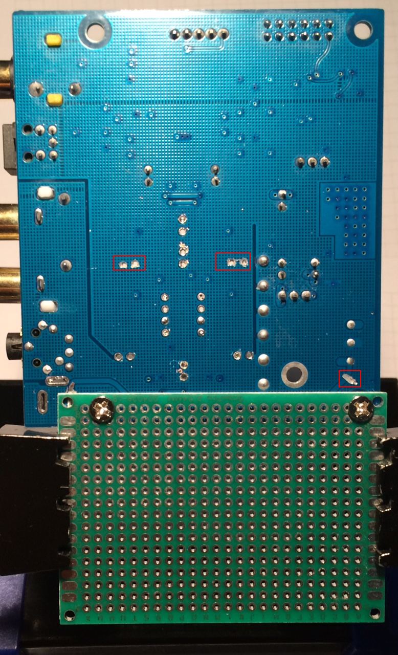

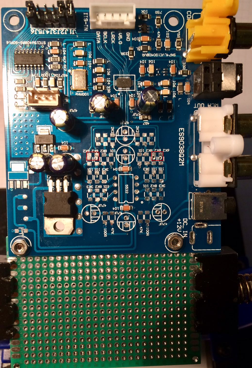

In further preparation for the through hole component output stage, did some work to get the dac and output stage boards ready. Two pictures below show the modifications so far.
First, all unneeded components from old dac output stage were removed from the top side of the board, as was the +15v power input jack.
Holes were drilled in the output board to line up with existing holes in the dac board. The +15v trace that ran over to the jack was cut so that the output stage board could not short out the power. The cut point is outlined in a red box.
Also outlined in red boxes are 4 holes to bring down the dac output signals to the bottom side of the ground plane so they can be run down to the output stage board from there.
With the two boards securely attached together and the +15v trace cut, it should now be safe to scrape of some of the solder mask on the bottom of the dac board in preparation for soldering the output stage ground plane to the dac ground plane.
Next steps will probably involve positioning the opamp sockets, then laying down some strips of ground plane leaving openings for tantalum caps and power connections, and for any other circuit nodes I may decide to attach to the board.
Also, since I am using some of the dac board mounting holes to attach the output stage board, I may work out some way they can also support standoffs, or I may decide to use some holes on the far edge of the output stage board as mounting points to help support the entire assembly.

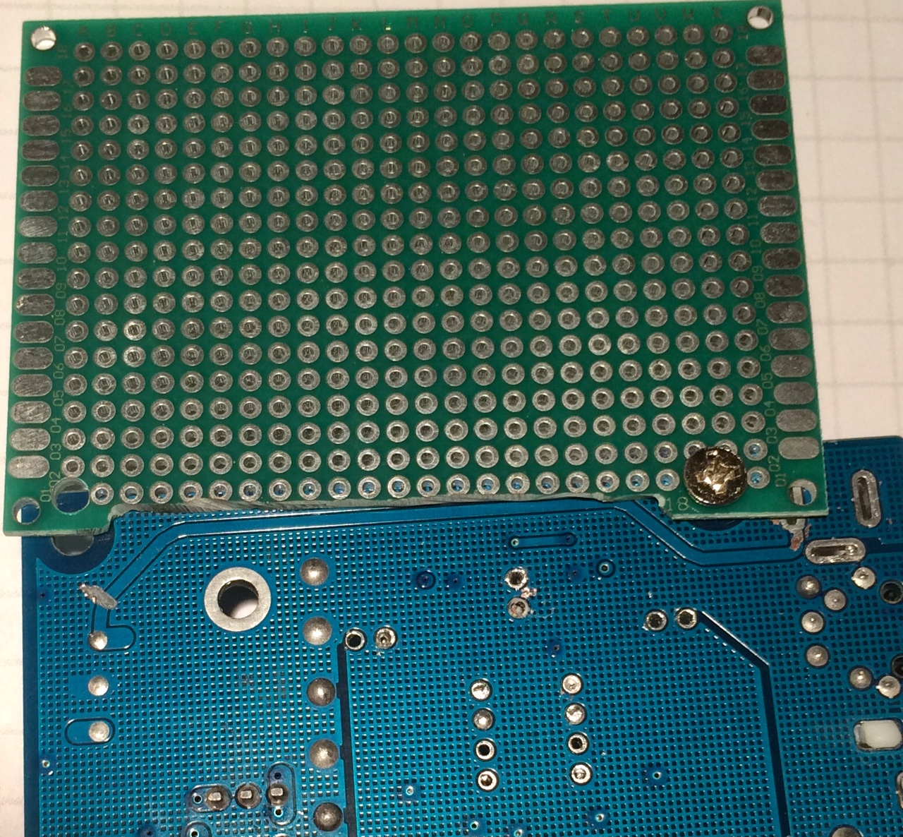

Looking at where to two boards meet a little more closely, decided to trim back some of the output stage board, so maybe I can try to attach the ground planes together right where the dac ground plane ends next to the power trace running across through there, and just before I start getting into an area where there are a lot of holes to work around. Time will have to tell how that ends up working out.
Also, there is a little horizontal trace on the dac board right in there where I would like to solder the output stage ground plane down. I may cut the traces on top leading to that short trace on the bottom, and solder jumper wire on top to restore the circuit connectivity. That way I don't have to worry about shorting out the little bottom trace, as it will at that point no longer be in use.
