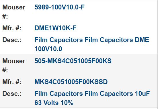

Given how expensive LT6655 parts are, I would say the cheapest 3.3v one will be fine. What is also expensive are proper output filter caps for it. I ordered a couple of those that are recommended in the applications section of the LT6655 data sheet and they were about $5 each, not to mention they are physically large. For the original dac board I used a X7R output filter cap which I know will cause piezoelectric noise, but it was all I had in stock at the time. When I do a through hole component AVCC supply I will use one of the big, expensive through hole caps that I have.
Also, unless you are very experienced at soldering very small parts I would definitely recommend soldering LTC6655 to an adapter board as I tried to show in a previous post. I soldered some of the pins of the first one directly to the dac board ground plane and I think that was about has hard as anything I have done.

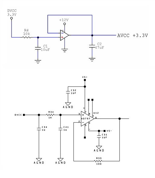

Hi Mark, i found this two AVCC buffers, so the "basic " firs one one would be enough to feed both AVCC L and R. Basic question: would be better to use two separate independent power supplies 3,3Vfor example from LT3042 3.3V and then after it use two avcc buffers one for each avvc channel ? i assume that using two separate supplies (combination 3042+opamp buffers) would cause more improving in SQ then one united power supply 3.3V + LTC6655+buffer opamp for both avcc ?

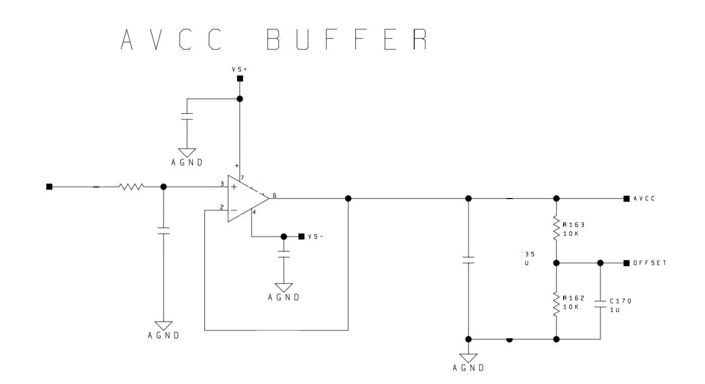

@Blackfear,
The correct AVCC circuit information is shown below. Both schematics are the same, except the second one also shows the AVCC/2 voltage divider and filter cap Vref signal that is needed by the output stage (it is labeled 'offset' in this schematic) .
There needs to be two AVCC opamp circuits, one for the left channel, and one for right. There will also be two AVCC/2 reference voltages. One dual opamp is enough to make both AVCC circuits.
Also, please note the text information on one of the pictures below. That is good information regarding AVCC and output stage component selection.
An LTC6655 reference if used requires only one which would be shared by the AVCC circuits for both dac channels. The LTC6655 would replace the connection on the left side of the first schematic labeled 3.3v DVCC.

Mark can you please make a complete shema .
Serge
Guess I could a little later. Or someone else who understands it could. If someone beats me to it that would be great, then I could double check to verify everything is good. Not much to it actually.
Will will also be needing through hole component layout and board mechanical attachment to dac board plans.
Thanks, now it is clearer, one power supply + one LTC6655 reg. and then two separate opamp circuits for avcc 3.3 left and right@Blackfear,
