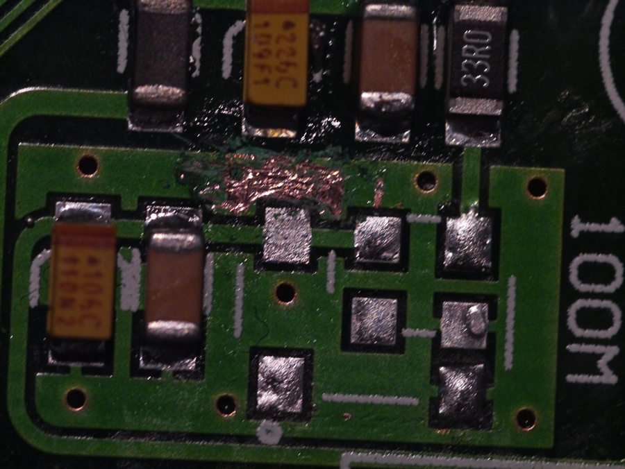

just instALled the crystek , its hard but i thought it would be harder
the sound improvement is audible, especially the bass![]()
Wow, good for you Paul! I was afraid that might not be so much of a useful mod until other things had been done first. Congratulations on getting through it. If you can do that, I suspect you will find you can do most things including somewhat smaller SMD.

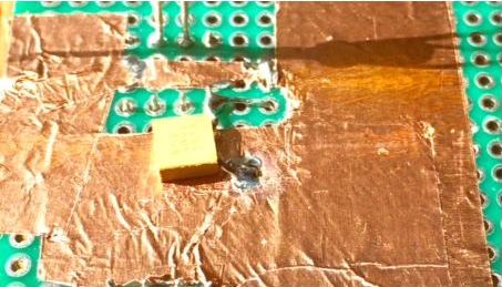

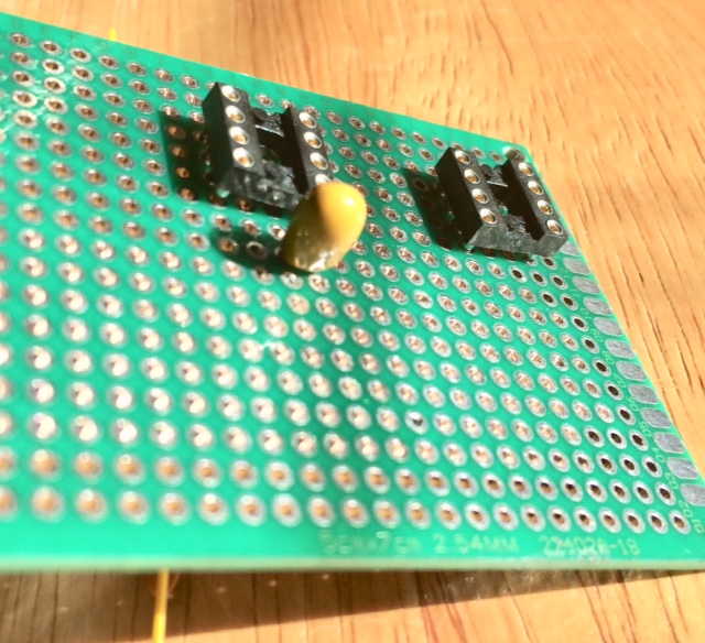

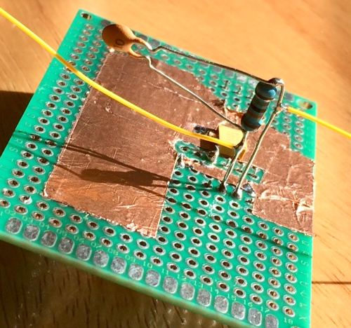

Getting back to actual dac modding again, and with regard to the through hole component output stage board, I would like to put up few pics to show conceptually (once again) how I would probably be inclined to do my layout if prospective builders think it will be okay, something they can do.
First picture shows a filter cap on top of the board but hopefully not too close to the socket. Second picture shows where the cap is attached to a socket pin, as is a smaller value ceramic cap (which might have been more out of the way if flipped around). There is also a hole between where the tantalum lead comes down and the socket. A power wire might come down there, or it might be soldered to the tantalum lead on top. Third picture shows an exaggerated example of a resistor, cap, and some signal wires connected to two opamp pins. If I were to do something like that for real I would try to make the leads much shorter, but I just wanted to show the idea. Also, I might fold the assembly over and lay it down next to the board, which might be mechanically preferable.
Also shown are a few strips of copper foil with the seams not yet soldered together. But, that is about how they should go, all around the opamp and between the rows of pins (I left out a piece in the foreground, but one should be there). Really small ceramic bypass caps might be soldered to that thin strip if no room elsewhere.
So, question would be, is this type of thing doable for beginners who don't want to do SMD?
No problems with that Mark.. looks eminently doable.
Yes it is really doable job for me.
