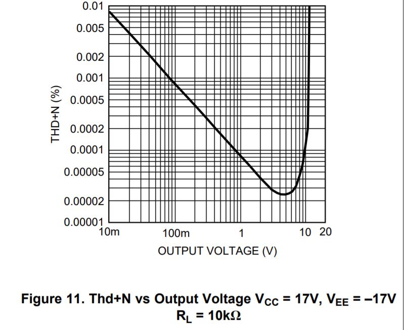

@Mikett,
Looks like this might be a good time to try to explain something TI didn't tell you about in that app note. Attached below is a graph from the LME49720 data sheet.
What the TI guys noticed is that it shows minimum distortion using the highest possible VCC and the highest possible signal swing. (there is a different graph for each VCC, but higher is better for these graphs.)
What does the graph show and what does it mean for I/V design? Well, at the right we see that as the signal is increased distortion keeps getting lower until it rapidly starts getting higher. Why? Because they test it with a sine wave, not music. A test sine wave is at a fixed amplitude so it can be adjusted to sit and the minimum distortion point. Makes app note distortion numbers look very impressive, but it is not accurate for the distortion you will get with music, since music is not all at one fixed level. In fact, almost all of music is at a lower level where distortion is higher.
Also, distortion is going up and down all the time as music signals go through zero crossing and increase to some peak and then go down through zero to a negative peak. Happens every cycle of a tone, and every cycle of even a fixed sine wave. The distortion is dynamic and always changing.
Over at the left side of the graph we see that distortion is very high when signals are very small, as happens all the time as tones and frequencies pass through zero.
So why is the distortion so high for small signals? I will say it is because when you run an opamp on a bipolar supply, the left side of the graph shows what happens when the opamp output is going through the cross-over region.
How about if we could avoid that cross over region altogether?
The reason distortion changes with signal level is because the higher the signal level is, the less time the signal spends with the opamp output in the cross-over region. If and when we avoid that, we avoid the main source of distortion.
Okay then, the way to get minimum distortion for all levels of signals found in music is to never allow cross-over to occur. We could bias the opamp to avoid it by running in class A, but then the output would be offset, and we would need caps in the signal path which might sound even worse than the cross-over distortion.
Ah! But with an I/V stage we are already offsetting the opamps to AVCC/2 so we have an opportunity to run the opamp outputs in class A all the time and always have minimum distortion for our music signal.
What we need to do is to choose the feedback resistor so the opamp never goes closer than a few hundred millivolts from ground. That means we will get minimum distortion in this stage if we select the resistor for about a 3v or a little less peak to peak swing, and so that's what we do.
Now, let's get back to the TI app note. Suppose we are TI application engineers that have been asked by marketing to help sell more opamps. If we look at the graphs in the opamp data sheet we see that we should use maximum VCC and maximum signal levels. So we build a test circuit and using a fixed sine wave test signal we verify the distortion is really low using a signal that is right where we expected. Of course we did not try signals down at 3v swing with real dac AVCC/2 offset and all that, because we don't need to in order to write up the app note. All that stuff we can just model and sim. Unfortunately, it provides the wrong answers if designing for music!

Oh, while I am still in the first transimpedance stage. If you are a keener, you will want to look carefully at specs of different op amps and study the aspects of how the output voltage and THD varies as it approaches the rail voltages. Some retain their linerarity better than others as the output voltages approaches the rail voltages and are more linear "up there". In the past, this was of hardly any consequence because most op amps in audio are not driven anywhere near the rail voltages. However in transimpedance stages in DACs, it is an engineering choice of how high you want to go. Some op amps though speced better for lower line voltages appear not to be as good for transimpedance stages when they are driven hard. Again look carefully at the specs and bahavior and choose accordingly for your application.
Look at the noise model. Running that low a voltage will degrade what you will want to do.
If I look at other similar op amps, the behaviors all follow that pattern.
I'll stick with with the design guys at TI who as best I can glean sell both the LME as well as the OPA series. So would they be fooling both the same customers.
The designer of the OPA1622 was in some forum and I also read what he had to say and that is when I took the time to look and try to understand. He seemed to be a genuinely serious audio guy and yet a sober engineer.
The ESS circuit and as best I have gleaned all have essentially the same IV circuit including the chinese ebay pro sabre dac boards. Layout is a different issue. It would be good to take the cover off the DAC 3 and see if we can identify similar IV circuitry inside and see what values they are running. You are capable of that since you've got a DAC3.
If you look at the I/V stage ESS designed into the ES9038PRO evaluation board, it is for about a 3v peak to peak swing. Why? Because if you look at distortion at the differential summing output with a variety of test signals and including for IMD, the distortion is lower that way. If you need really low noise too, you use all 8 output channels in parallel which reduces noise by 3dB with each doubling. Most likely, I would expect when TP releases it's 8-channel output stage for 9038PRO that will be an option.

Maybe consider this: Why are decaying cymbal sounds so revealing of the sound of electronics? Because they are mostly very low level, almost entirely down where distortion is in fact audible.
Also, running that low a voltage will *not* degrade what I want to do. Music is at a low level during parts of every cycle, and during quiet passages. What I want is class A if I can get it.
And, no, I am not taking apart DAC-3 to suit you. Anyway, it has a mulitlayer board and tracing out circuitry in the case can be very difficult.
As I suggested in another note, take a look at the Sparkos discrete opamps. They are inherently class A and have two pole compensation. Expensive, yes, but if you are looking for the ultimate in what can be achieved, they are worthy of consideration. He also has "pro" versions which are even better, but larger form factor.
