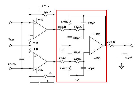

Maybe Sparkos would be a good choice for the differential summing stage. They don't have as much open loop bandwidth as I would like to see for the I/V stages, but the existing opamps are fine there being offset as they are. There has already been some HF filtering before the summing stage, so that would probably be my choice for where to try Sparkos.
If you look at the I/V stage ESS designed into the ES9038PRO evaluation board, it is for about a 3v peak to peak swing. Why? Because if you look at distortion at the differential summing output with a variety of test signals and including for IMD, the distortion is lower that way. If you need really low noise too, you use all 8 output channels in parallel which reduces noise by 3dB with each doubling. Most likely, I would expect when TP releases it's 8-channel output stage for 9038PRO that will be an option.

If you have the eval board for the 9038PRO then you will have the schematic. What Rf is shown for the feedback value that ESS has chosen for the transimpedance stage?
I don't have the board. Feedback resistors are 562 ohm, so maybe they are using more swing. Still not convinced that is path to lowest distortion. There is a problem shown in the distortion graphs that just can't apply to music. Remember, the opamps may be used for oscillators and test tone buffers and things where only low distortion for a fixed high level signal is important. Music is none of those applications, so the graphs should not be misused to conclude things that are incorrect. If ESS is using excess swing, it only shows they are using fixed test tones too. Doh!

adding I/V similar to Markw4 outlined, brings THD down to -93dB. 3rd harmonic is gone with this. sound is good and match to PreBoxS2 Digital, which measures about -92dB with stock PS.
It is probably buried somewhere in this thread, but which opamps are you considering for the I/V stage?

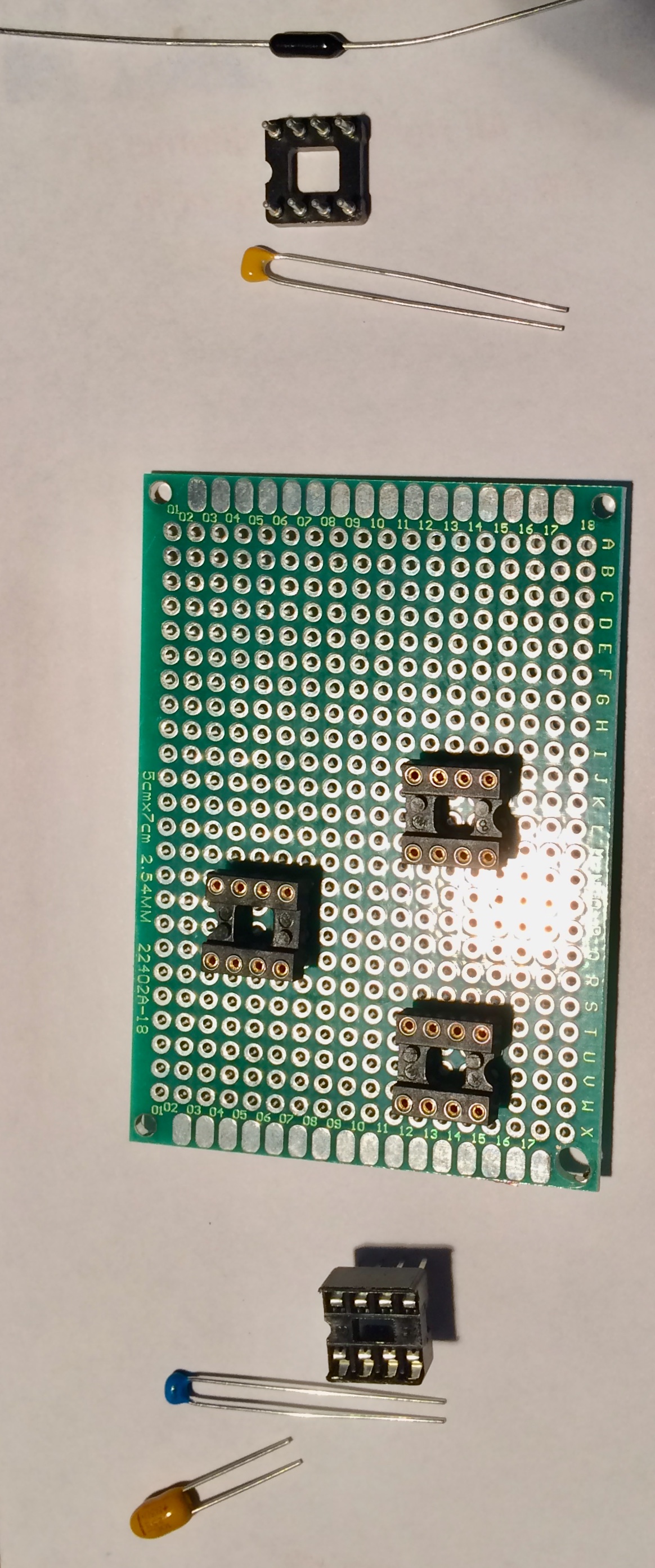

Through-hole, or perhaps better referred to as 'leaded' components arrived today.
Anyone interested can take a try at a prospective layout. Attached is a pdf of some graph paper that can be printed out. Also included is the pinout diagram of a dual opamp, and a picture of the I/V stage feedback resistor and cap, and also the two bypass caps that go at each power pin. Last picture is the prospective output stage schematic.

The idea is we want a layout on graph paper showing the bottom view of how we would physically locate components to solder them to dac socket pins. Rules are there will be a ground plane made from copper foil on the bottom of the board covering all perfboard holes that do not have any wiring passing through them. That includes ground plane strips in between the two rows of pins for each opamp socket.
Power wires will be run on the top of the board, and signal wires on the bottom.
Graph paper line intersections will represent holes in the perfboard. Using a pencil, the idea is sketch socket and component dimensions on the graph paper as seen from the bottom side of the board. Power pins need to have one tanalum and on ceramic cap in parallel to ground. They have dimensions as shown together at one side of the component picture.
A hole will be left open in the ground plane next to each power pin to allow power wires to come down from above.
The feedback resistor and capacitor have dimensions as shown on the other side of components picture. The resistor and cap should ideally be mounted on the bottom side of the board and directly soldered to the opamp socket pins. Same for the decoupling caps unless it is preferred to mount them on the top of the board where the power wires come down to the opamp power pins. In that case the ground plane can have an opening for the caps leads to come down and attach to the ground plane.
Feeback resistors could stick straight up in the air from the bottom of the opamp sockets or be arranged laying flat adjacent to the ground plane as is preferred.
Resistors and caps for the differential summing opamp will have similar dimensions. Some filter components may need to be mounted on the top or bottom of the board attached to plated holes without ground plane covering.
The final rule is that there are no rules. All the above verbiage is suggestion only. Contestants should sketch out their proposed component layouts on graph paper using pencil (colored pencil or felt pens, etc. are okay too -- since there are no rules). There is also no contest, but everyone is encouraged to give it try. I won't always be here to do one for you so now would be a good time to try and get some feedback on your layout ideas. Please post a picture of your graph paper with any notes you might want a technician follow. We will give it maybe a couple of days, unless more time is requested, then review the pictures that have been posted. I will post one too at the last second.
It would also be my suggestion to first place the most critical components, then less critical ones and interconnection wiring. The most critical components at the opamp sockets are power decoupling caps and feedback resistor and cap. Keeping leads short length and layout reasonably compact should help maintain good opamp stability.
Everyone who wants to build one of these through-hole components boards should give this layout task a try. It would also be helpful for me to see what you think you would be able to solder together. I might use leaded components to make a very tiny circuit, but someone else might feel that would be almost as hard to assemble as SMD. So, good to show me what you think would be about right for what you consider your assembly and soldering skill level to be.
Please have fun and ask any questions you want. The idea is to learn, have fun, and get comfortable with doing this type of DIY activity.

While those who are interested in thinking about output stage board layouts mull over how they might arrange electronic furniture in the output stage circuit board space, doesn't mean we can't continue to discuss other things.
With regard to the output stage, I have sort of been thinking about putting some decoupling caps on top of the board, but I just don't want them sticking up too much if really close to the sockets. Reason is because I might want to try some different opamps in the sockets including some that are on adapter boards or that are bigger than typical integrated opamp packages.
In some cases with bigger than usual socketed devices they can need more clearance around the sockets in order to be able to be plugged in. If tall caps are sticking up next to a socket, that can in some cases limit what might be plugged in.
I am thinking that maybe laying the tantalum caps on their sides on top of the board while soldering the smaller ceramic caps directly on the socket pins, down on the bottom could be a good way to go. Probably not necessary or that helpful for the I/V opamp locations, but the differential summing circuit has more components around it, so freeing up any space close to the underside of it's socket might be more helpful.
Another thing to remember about typical dual opamps is they have one end where the outputs are and the other end where the inputs are. Nice to point the sockets with the pin-1 and pin-8 end so that the opamp outputs are closest to wherever the signals need to go next. And similarly, to point the pin-4 and pin-5 end of the socket towards where the input signals will be coming from. In some cases that might not be best, but often it turns out to convenient.
Lot's of little things to think about and consider, maybe not critical things, but some that can help make a less cluttered and more functional layout.
